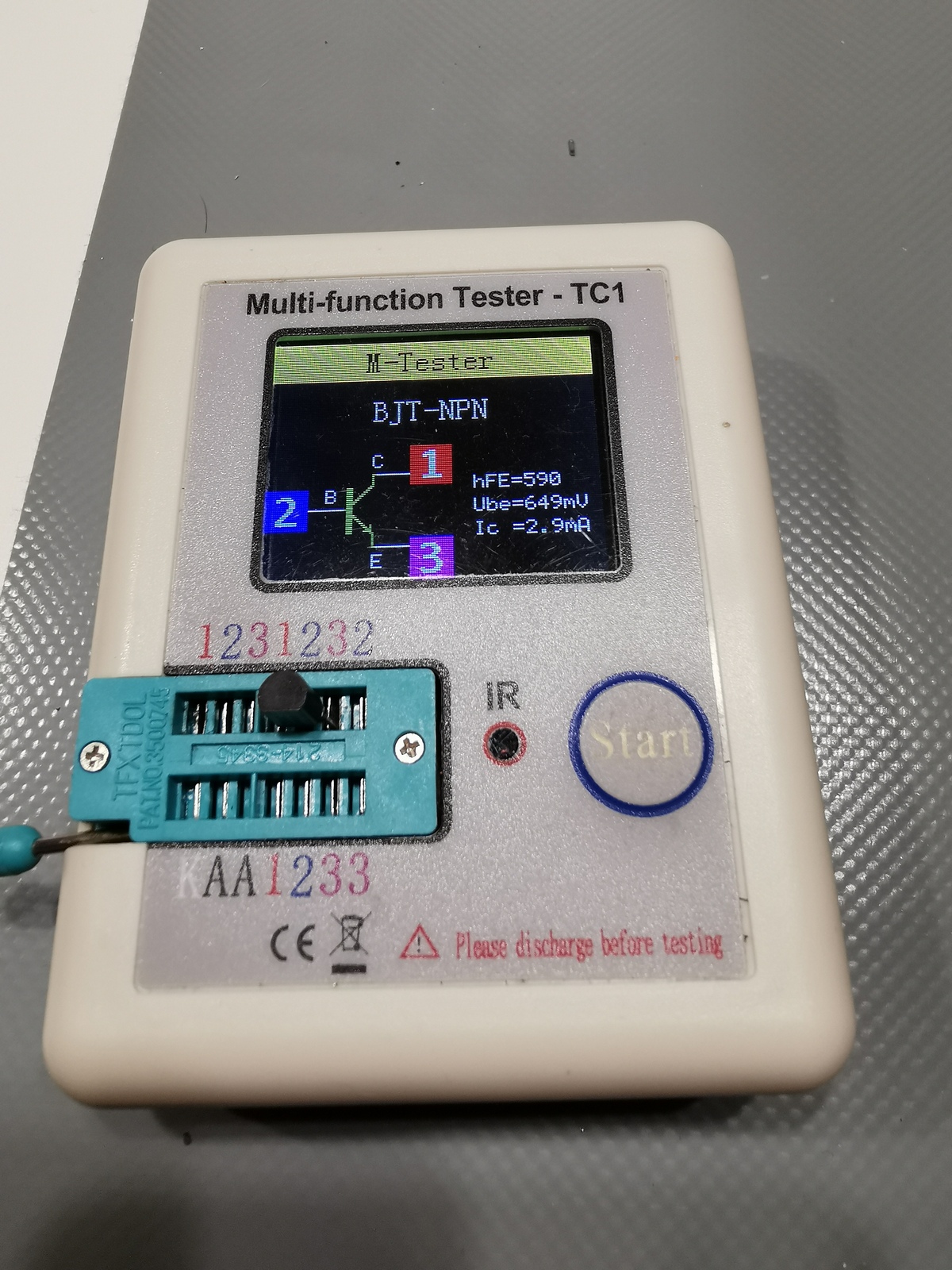

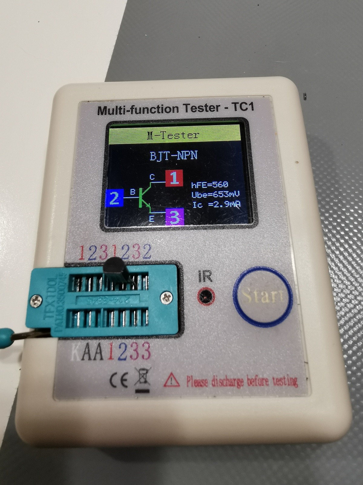

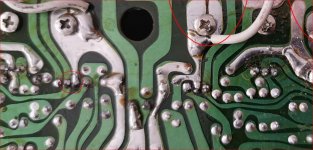

I doubt Q405 or Q406 were ever a problem and I am still waiting for a reply on Q401 and Q402 both BC550C's - are these working properly.
I just pulled both 401 and 402 from the circuit and tested them. They seem to be fine (attached pics)

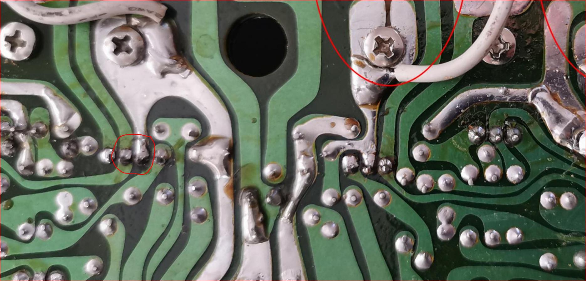

It appears that one of the driver transistors has a solder bridge between two of the leads. If so you need a solder sucker to remove it.
That was just rosin... I did check for shorts and now that you've mentioned it I cleaned the excess rechecked for shorts. All seems fine.

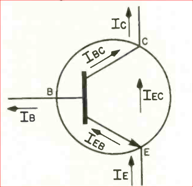

In the meantime I am attaching the image of a transistor showing the directional flow of external and internal current which is opposite to the direction of the emitter arrow.
One point not mentioned in the text is that the collector region within a transistor is more heavily doped than the emitter or the base regions so heating on the collector will release more electrons in a NPN transistor and make the region more conductive.
In a homotaxial transistor I think the collector doping would be reduced near at the extremity point to make this less conductive and the device less susceptible to secondary breakdown.

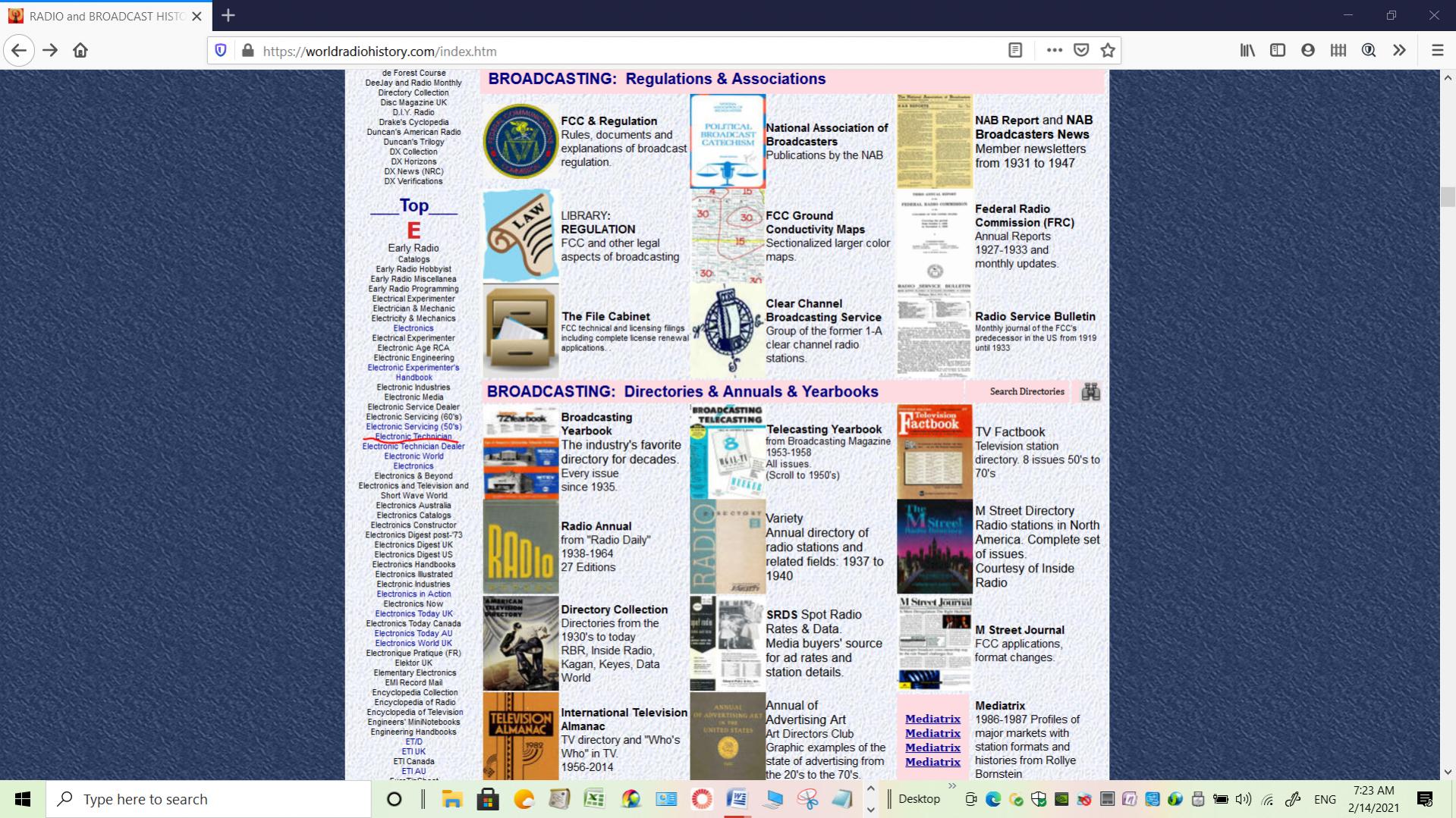

The reference book I mentioned is Semiconductors from A to Z by Phillip Dahlen based on a series of articles in Electronic Technician magazine first published in book form by Foulsham-Tab in 1968 and revised in 1973 - the edition I have.
Electronic Technician magazine is one of a number of Electronics magazines in World Radio archives.
The home page is shown in the image. When you click on Electronics Technician you have to scroll down to 1966 and view the September issue which is the second chapter article in the series entitled "Semiconductor Characteristics".
The third chapter is entitled "Determining Semiconductor Characteristics discussing Emitter Current Gain and Base Current Gain - understanding these and using them for trouble-shooting.
The fourth chapter is entitled "Frequency Limitations".
The narrative is down to earth and I like the clarity in this. Others reading these sections might find this as interesting as I have.

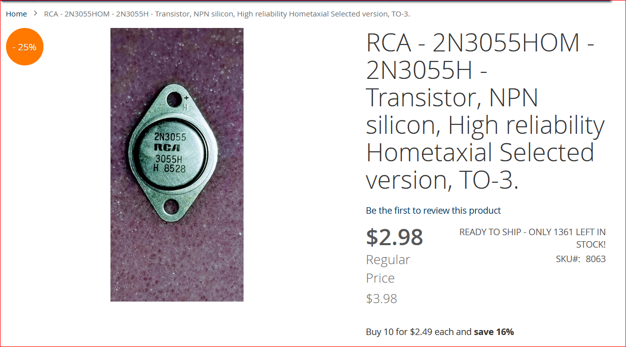

Re hometaxial 2N3055's, Western Electric a US surplus stocks clearing house in Ohio is offering over a thousand of them for sale. Full contact details are given on their web page.
