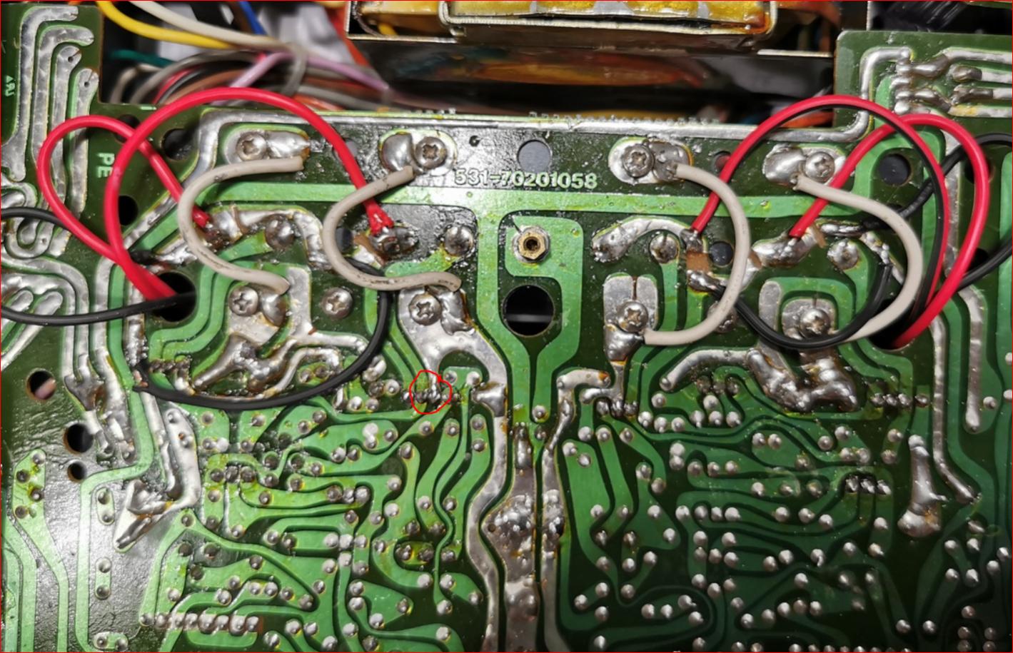

I doubt Q405 or Q406 were ever a problem and I am still waiting for a reply on Q401 and Q402 both BC550C's - are these working properly.
I have looked back through the thread to see if any detail might have been overlooked and arrived at images shown on post 32 on page 4 and post 7 on page 70 the last image after the first emitter resistor modification.
It appears that one of the driver transistors has a solder bridge between two of the leads. If so you need a solder sucker to remove it.
It is good practice to remove old solder rather than to reheat joints and remake them with fresh solder.
It is also bad practice to use solder as "glue" as this can conceal joints that have not set properly.
I appreciate there are places where there is no through the hole access from the top of the pcb and that is just part of the design which makes the job somewhat harder.
