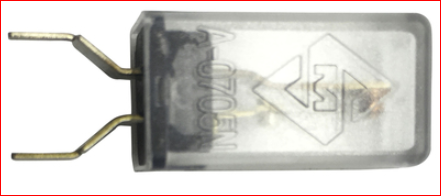

I just pulled both 401 and 402 from the circuit and tested them. They seem to be fine (attached pics)

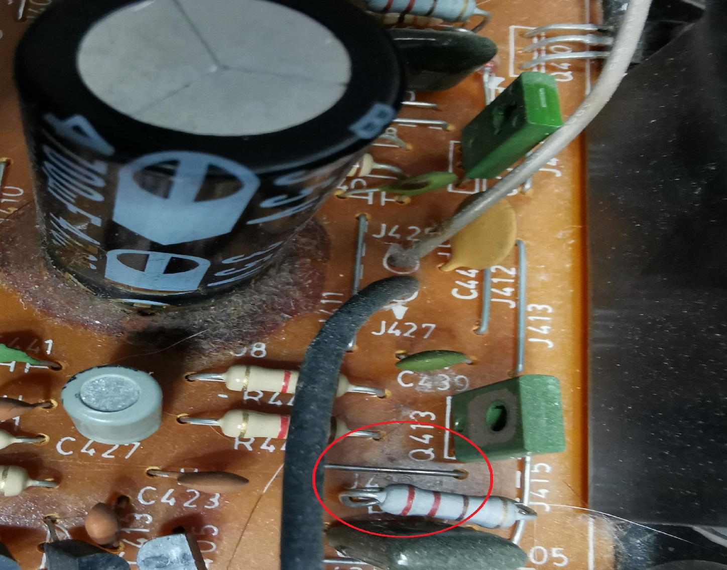

It appears that one of the driver transistors has a solder bridge between two of the leads. If so you need a solder sucker to remove it.
That was just rosin... I did check for shorts and now that you've mentioned it I cleaned the excess rechecked for shorts. All seems fine.

I know from experience that carbon film resistors can burn out without showing any visible signs and have witnessed that these do smoke and smell when they blow. Lower resistance value ones would conduct more current and be more at risk if there is a surge in current like those you have witnessed yourself.
