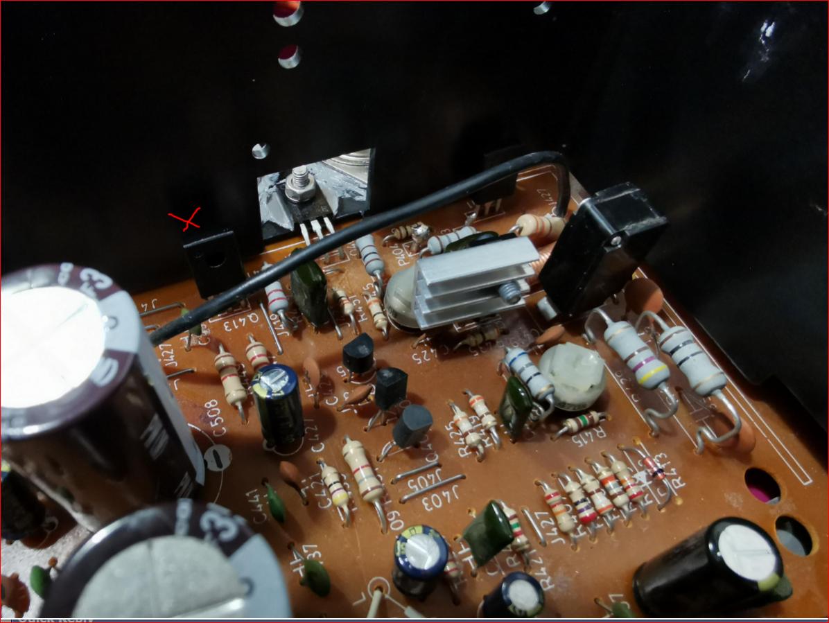

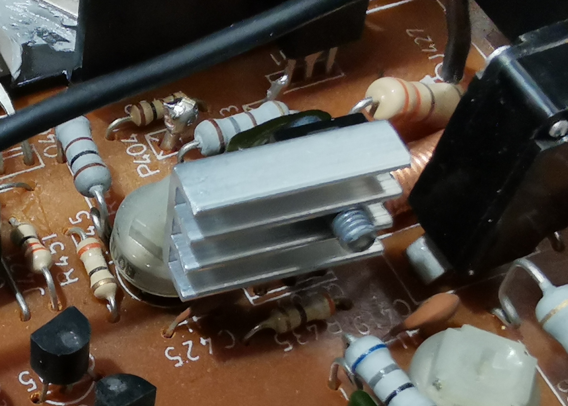

Because one of the heatshinks is for a different package I had to mount it horizontally.

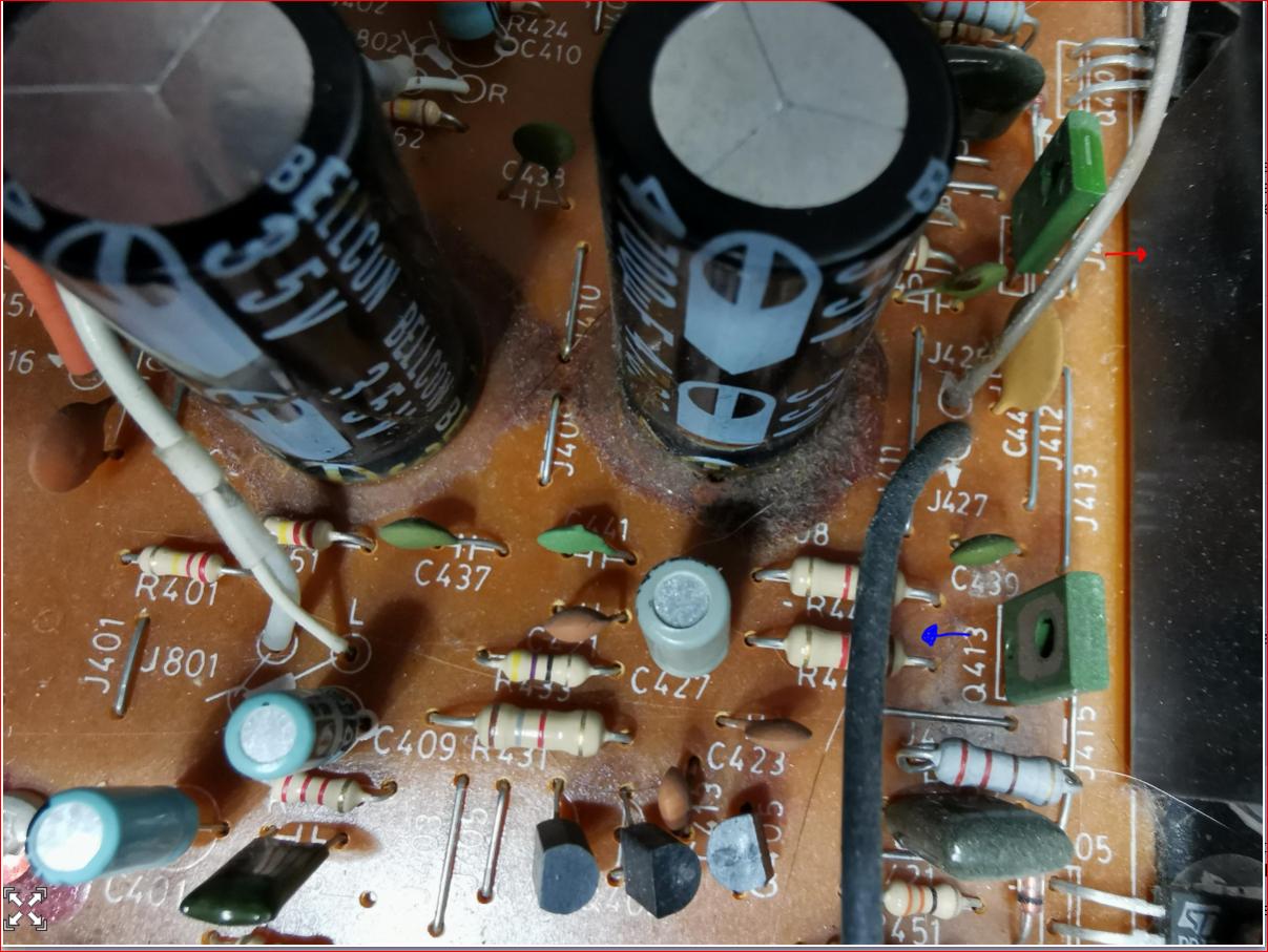

Comparing this shot with that in post 1, I noted Q413 the metal faces away from the heat sink.
In the present post the light is not good enough to see that the orientation is the same. I would have thought there should be some visible reflection from the metal.
Check the orientation of Q413 and Q414.
I only have a clear photo of the original: their position is mirrored (as all components for the two channels, except the transistors that are mounted on the heatsink).
In the last photos I posted you can somewhat see that one heatsink (the U shaped one) is bolted on one transistor's side towards the main heatsink (towards the left side of the amplifier), while the other is bolted on the opposite side (towards the right side of the amplifier).
It's just that the U shaped heatsink allowed me to mount it with the grooves oriented vertically, while the other one was quite a bit longer so I had to mount it with the grooves oriented horizontally (I don't know how much that actually matters from an air flow point of view - probably minimally in this case)

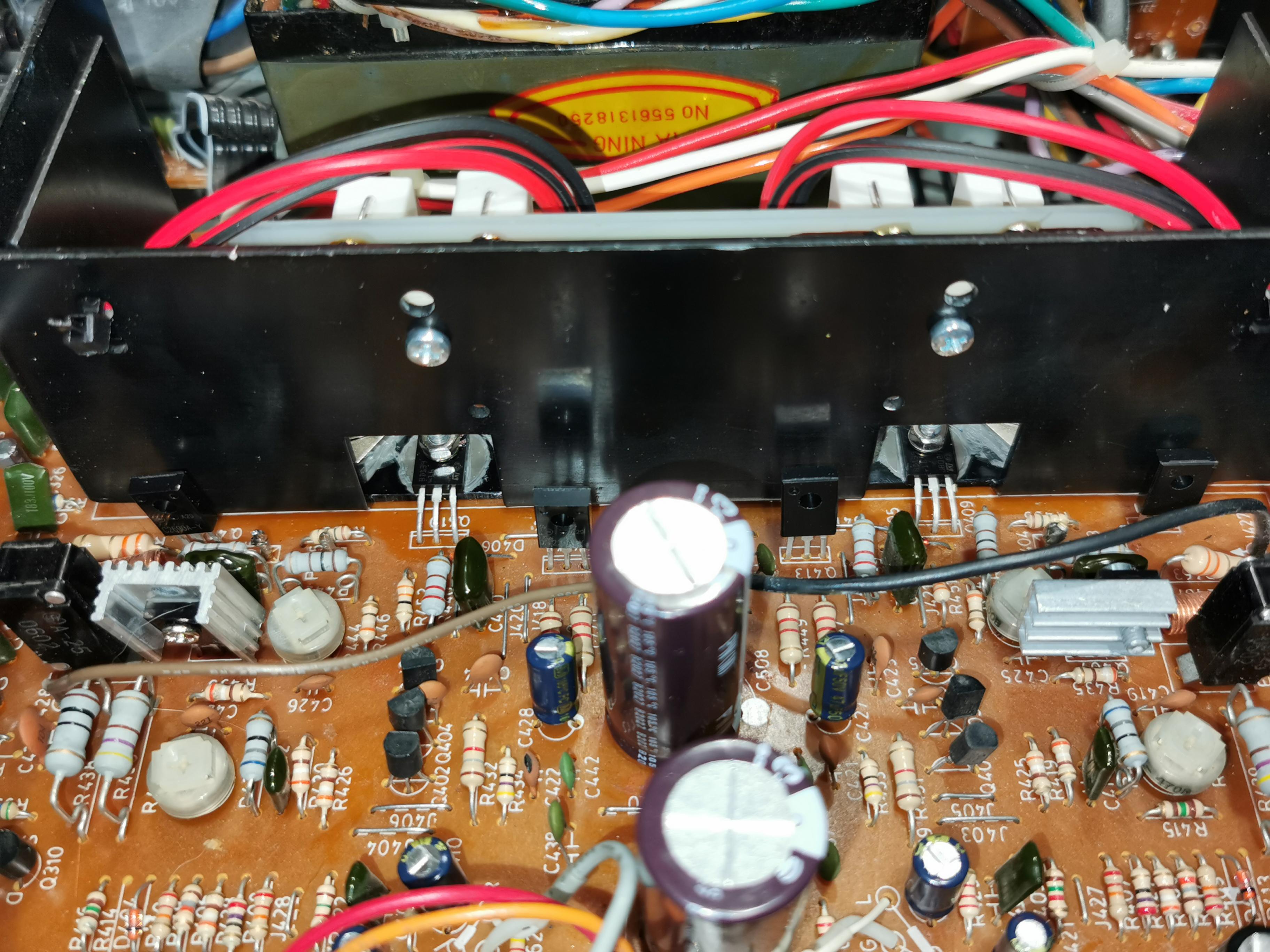

If you got the heat sinks on the metal side of the TO126 transistors of whatever number, and used heat transfer compound, that is about the best you could do. If the TO126 transistors were that F ceramic case with no metal, they are still more conductive than plastic case. If you didn't use heat sink compound that is still better than the nothing NAD installed.
The heat sinks you used were a lot bigger than the ones I put on the TO220 VAS & drivers in my ST120. Mine were about 1/2" long, made out of 5/8" aluminum channel with holes drilled in. The amp with those ran 14 hours a day every day for several years before a wire popped off and & started humming. Put wire back to "ground" but not the right one, apparently, still hums annoyingly. Peavey PCB's in $35 amps are an easier fix.
Only risk to your huge heat sinks, if you slam the amp around the transistors will break their legs. Not usually a problem in home service.

It is still possible to have the Q413 an Q414 facing in opposite directions and have the base and emitter connections transposed.
In post 1, Q413 has the rear with the metal strip facing toward the camera - in the opposite direction away from the main heat sink.
In the first image for post 100, looking at Q413, from an aspect similar to that in post 1, all you can see of this is black.
If the metal strip is on the opposite side of Q413 then both drivers have their base and emitter leads transposed.

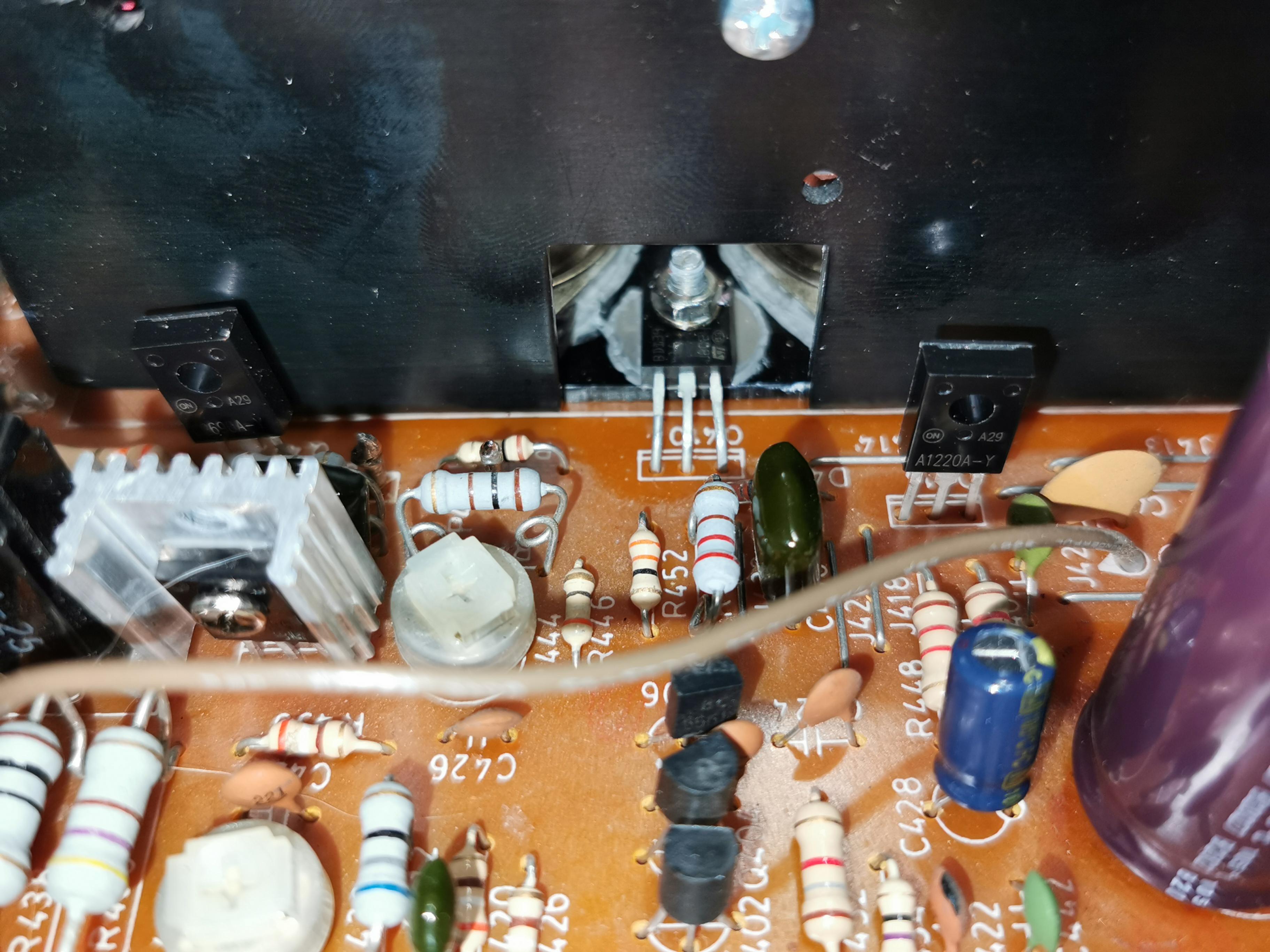

You are looking in the wrong place to see the point I was making. In post 1 Q413 side with the metal strip faced away from the main heatsink. In the image shown in post 106 it looks likely that the strip for the replacement Q413 faces towards the main heat sink.

In that case the legend showing KSA1220AYS appears is on the side that faces the heat sink. I have some transistors in that style of case and it is hard to read the legend in reasonable light.
It may seem pedantic for me to ask you to check that, but trouble shooting is a case of leaving no stone un-turned - a process of elimination taking one step at a time.
