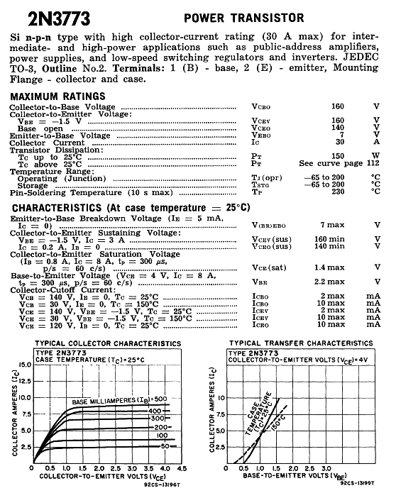

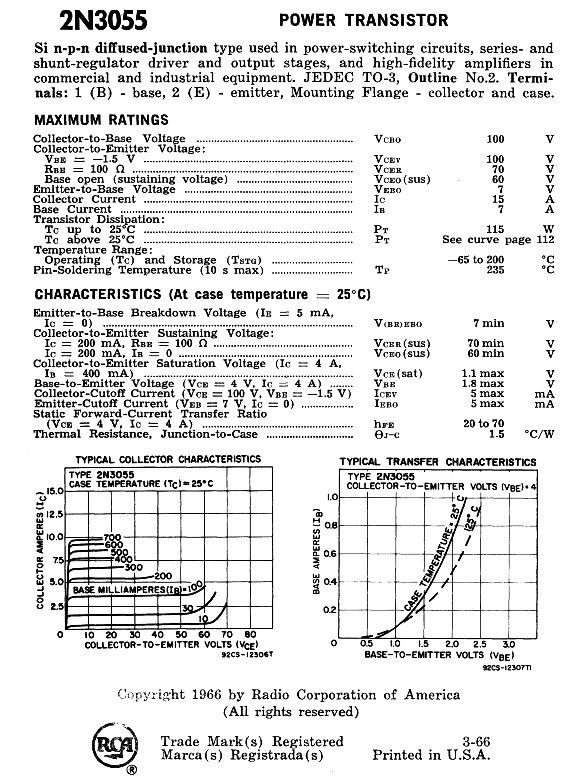

> The RCA hometaxial was rated at 150W
RCA 1966 (hometaxial) 2N3055 was rated 115W.
This part shows ~~1.3Vbe at 5 Amps Ic, so "acts like" 0.14 ohms internal emitter resistor due to significant parasitics.
2N3771/3 was rated 150W.
You are right, that figure was quoted in another source. I should have checked this in the RCA Handbook. There is no MJ2955 hometaxial complementary device in this Handbook.

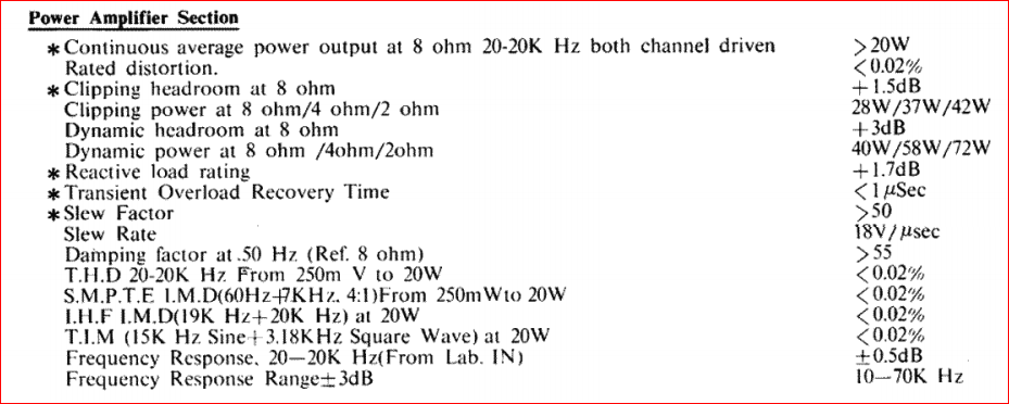

You say the output transistors used in the Dynaco ST120 output did not help IMD - officially quoted as less than 0.5% the same as for THD.
The 1978 RCA Power Devices handbook gives fT as 800kHz rather than the 200kHz you quoted. The latter figure would align with the RCA 2N3773.
If we accept 800kHz for the Dynaco and ditto for the NAD 3020 "speculative" hometaxial output transistors, the constraints on the gain bandwidth level and distortion results would be similarly affected.

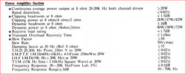

That is not the case when one compares the specifications attached for the NAD 7020 which speak for themselves.

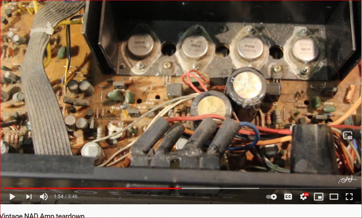

I have searched for detail in a NAD 3020 youtube re the maker and date codes of the output transistor pairs - these RCA devices described earlier as hometaxial.
The giveaway to this theory is the devices have 1985 date codes. If anyone wants to check that see Vintage NAD Amp teardown - YouTube

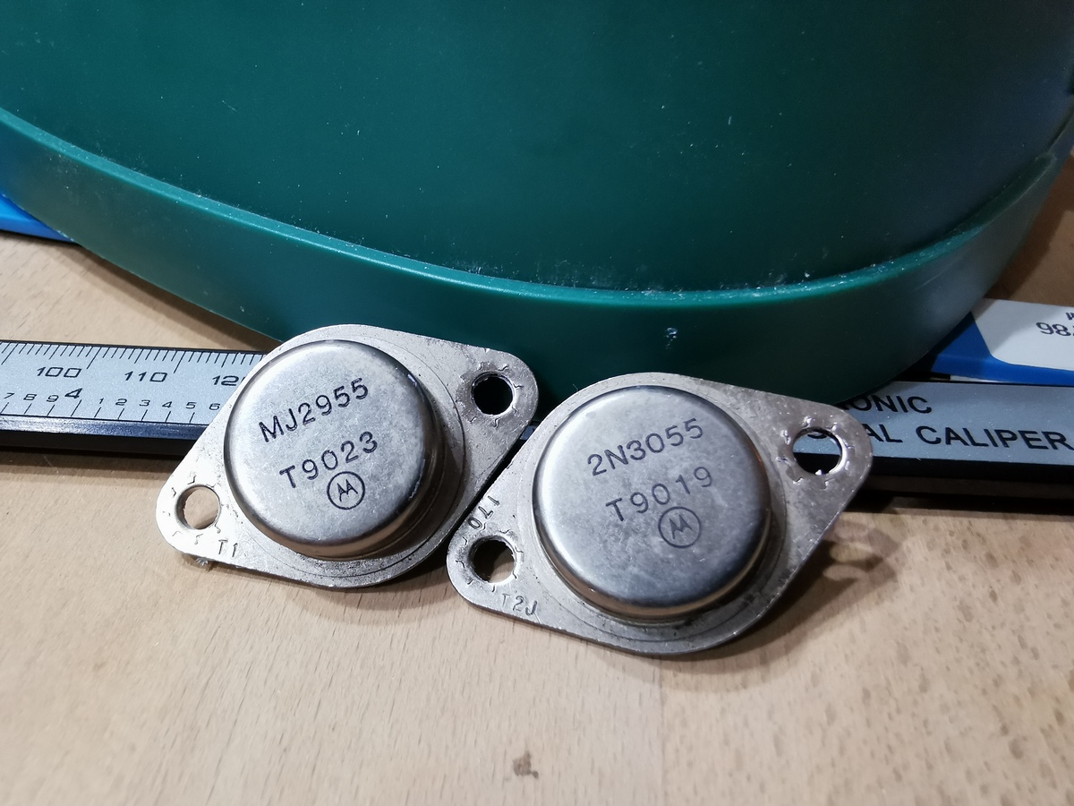

If you still have the defunct power transistors could you post an image or otherwise tell us what brand these are and the full part numbers.

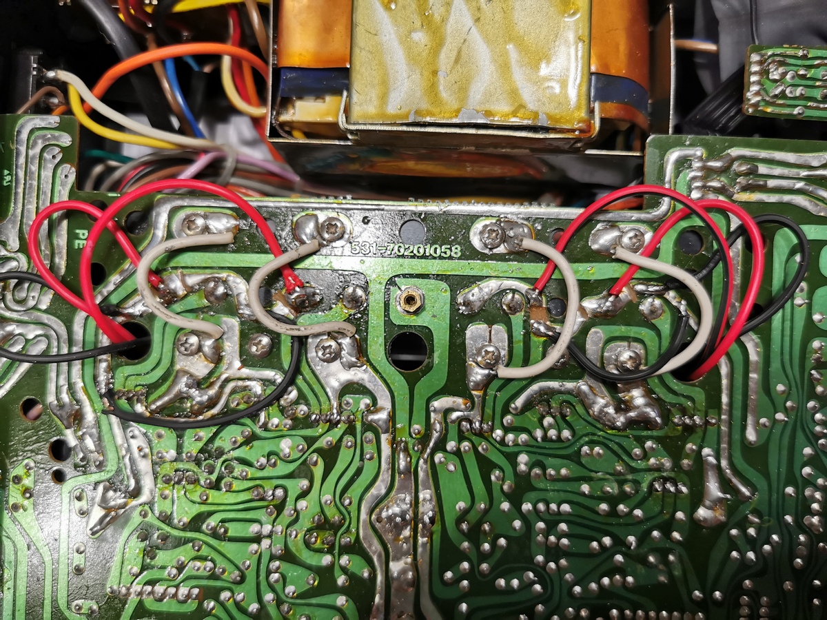

yea, I added a picture of them.

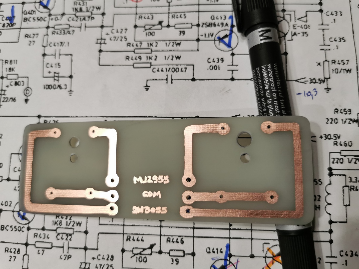

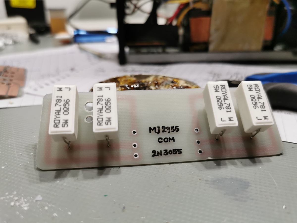

as for emitter resistors I found myself in a bit of a 'real estate shortage' on the board so found a good workaround (as the main heatsink already had M4 and M3 holes drilled in it). I etched a small PCB, soldered the resistors to it, bolted the PCB to the heatsink and then routed wires to the backside of the main PCB, cut the traces and soldered the wires. I didn't play any music yet (it's 2AM here), nor measured DC offset or idle current again, but I did plug it in and the DBT showed no misbehaving.
I only had .33 3W and .56 5W resistors and went for the .56 but I can always swap them for a different value if needed (and recommended)

also, are the 0.56ohm resistors ok in value or too much? (I didn't go for the 0.33 3W I had because I have no idea what make they are. If a smaller value is needed I might be able to find a couple from the same local seller that had these .56 ones)

The outputs that came out of zenzaman's amplifier are clearly Motorola 2N3055 and MJ2955 which are epitaxial according to datasheets and the Motorola Selection Guide
The year code in the images give the year code as 1990 so they were not old stock at the time of manufacture and the NAD 7020 company part numbers end with M.

The higher the emitter resistor value the higher the local negative feedback signal will be and THD will also be affected because this will cause the output and driver in each output have to have reductions in base emitter voltages.
You will then have to re-bias the output stage. The ideal set up voltage drop across an emitter resistor is 26mV at room temperature which is 25 degrees C.
You'll likely have to adjust the bias pot to get 20 ma idle bias current. 20 ma across .56 ohms is 11 millivolts. Looks like pot R444 may do the job but possibly a pot parallel to R442 may be necessary. Possibly a higher value of R442 may be necessary. Put two clip leads on one of the emitter resistors and measure this voltage cold and hot. You can speed up hot with a hair dryer.
Higher emitter resistor values cut peak watts slightly. Since the ear responds logrithmically, this is practically inaudible at the top of the volume range. My ST120 pries 72 w/ch out of a single pair of output transistors with .51 ohm emitter resistors, but that is with 70 v rail and a 437 VA transformer. Your 7020 appears to have +-30 v rails which adds up to 60 v. Bargain products may have transformers that sag in voltage more near the maximum wattage.
10 ohm base stopper resistors on the output transistors are only required if the amp oscillates ultrasonically. Nigel7557's Mapes amplifier oscillated when repaired with epitaxial transistos, but this one may not. Ultrasonic oscillation can be detected with a scope, or with an analog meter. If a measureable AC voltage occurs on output on a VOM while the unit is silent, music will pass through a .47 uf cap but not through a 390 pf cap. Ultrasonic oscillation will blow right through a 390 pf cap. DVM may miss ultrasonic oscillation entirely. The expensive RMS fluke meters are specified to not respond to frequencies over 7000.

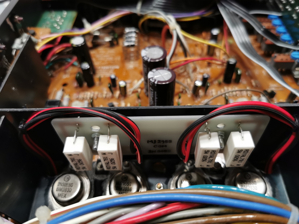

LE: DC offset hadn't changed after inserting the resistors, but for the idle current the voltage across the test points dropped to about 22mV.
Since I don't know or understand yet how the resistors I placed may change the measurements, I thought any info might help you spot mistakes on my part.
