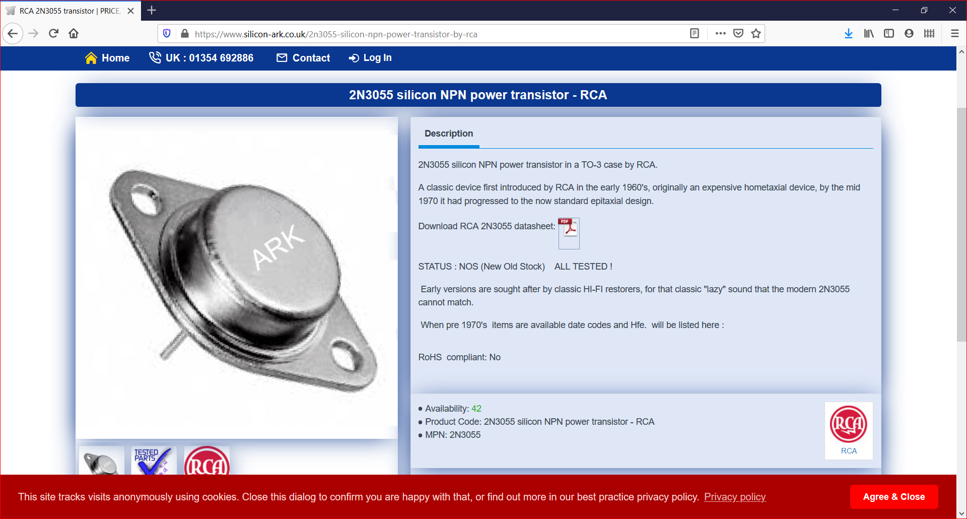

Although RCA is history there are still advertisers having component stocks. One can see how legends arise as in the attachment.

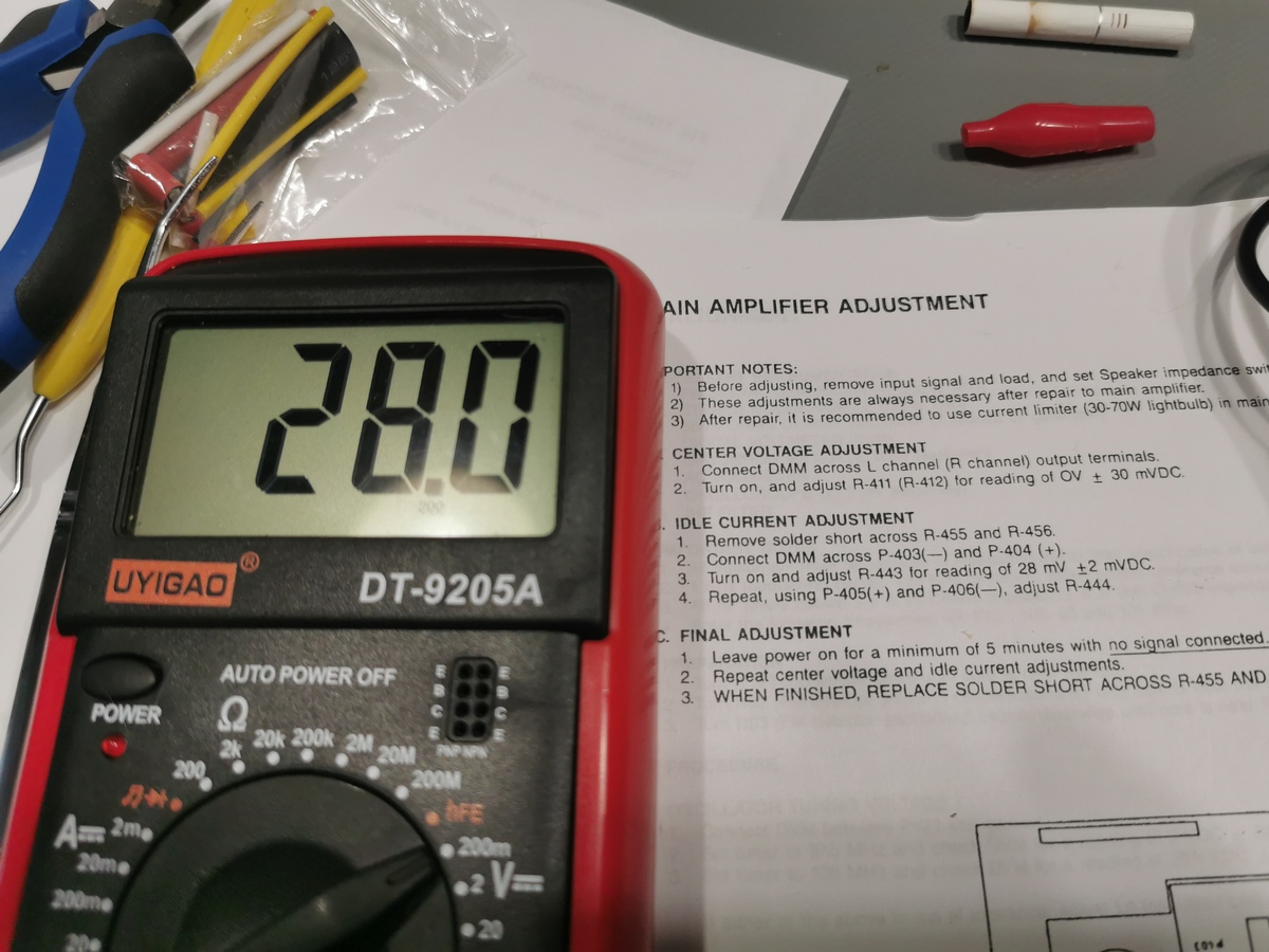

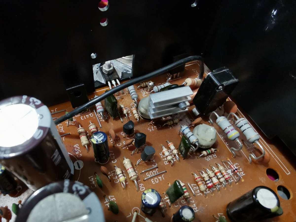

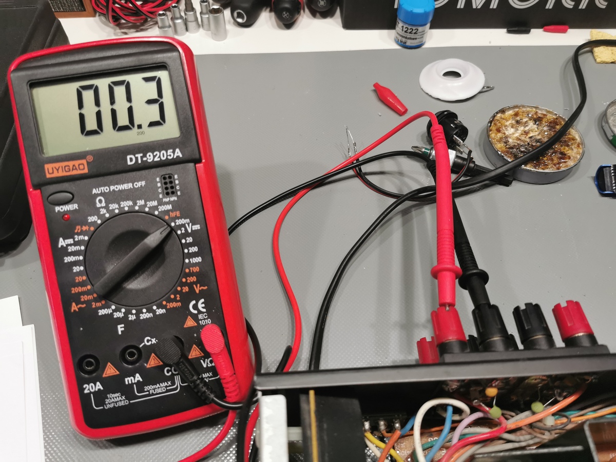

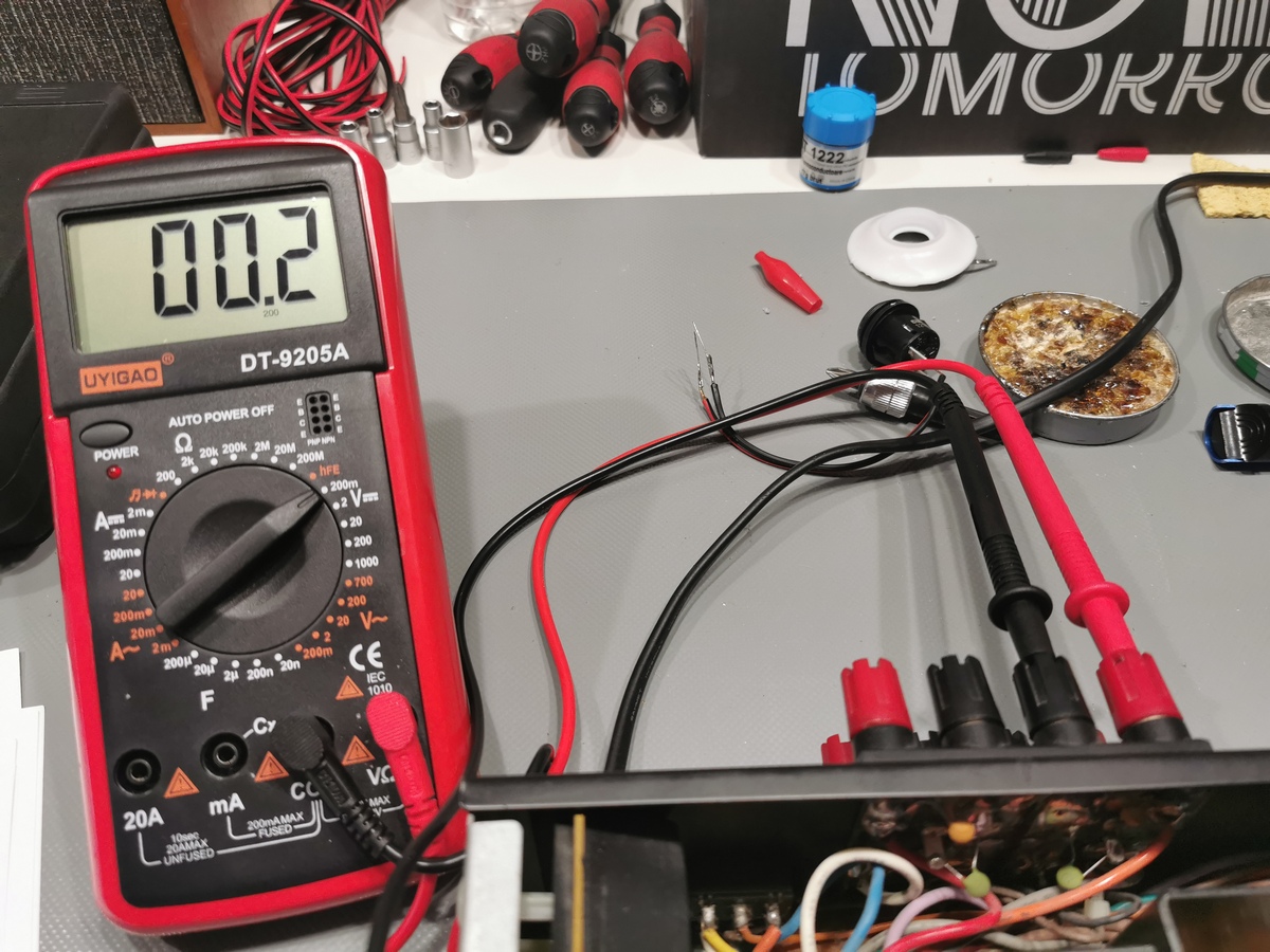

I went for the outputs you suggested. The amp has undergone a full electrolytic recap, all outputs replaced, all BD139 changed. So far so good...
I managed to set both DC offset and idle current as specified in the service manual with the original trimmers. I also added some heatsinks to Q408 and Q407 as they were getting really hot (barely could keep my finger on them), while those mounted on the outputs' heatsink were all rather cool.
My only big question is related to emitter resistors. AFAIK hometaxials were replaced in the late 70s and my model was launched in 1991. If there's no real need for them I'd rather not mess around with the PCB.
Any opinions?

Every other brand used .1 to .51 ohm emitter resistors on epitaxial transistors. Brands with a reputation for reliability on the stage like Peavey used a lot of .50 ohms. Just because you don't see any "H" on the package doesn't mean NAD didn't source homotaxial transistors from some small semi house. Were many small semi houses 1980-1985. Now in To3 package there is On, ST, and the jolly roger sources.
If cutting the PCB and installing the emitter resistors is beyond your skill, buy something more reliable. NAD go $150-800 here on ebay, Peavey's with emitter resistors go as low as $30 for parts or repair plus freight. I don't know the market in your country, but you should be able to find some amp beat to death on stage, but reliable when cleaned up and upgraded such things as overage TO3 sockets, 30 year old overaged mica washers, dried up ecaps, or worn out fan.

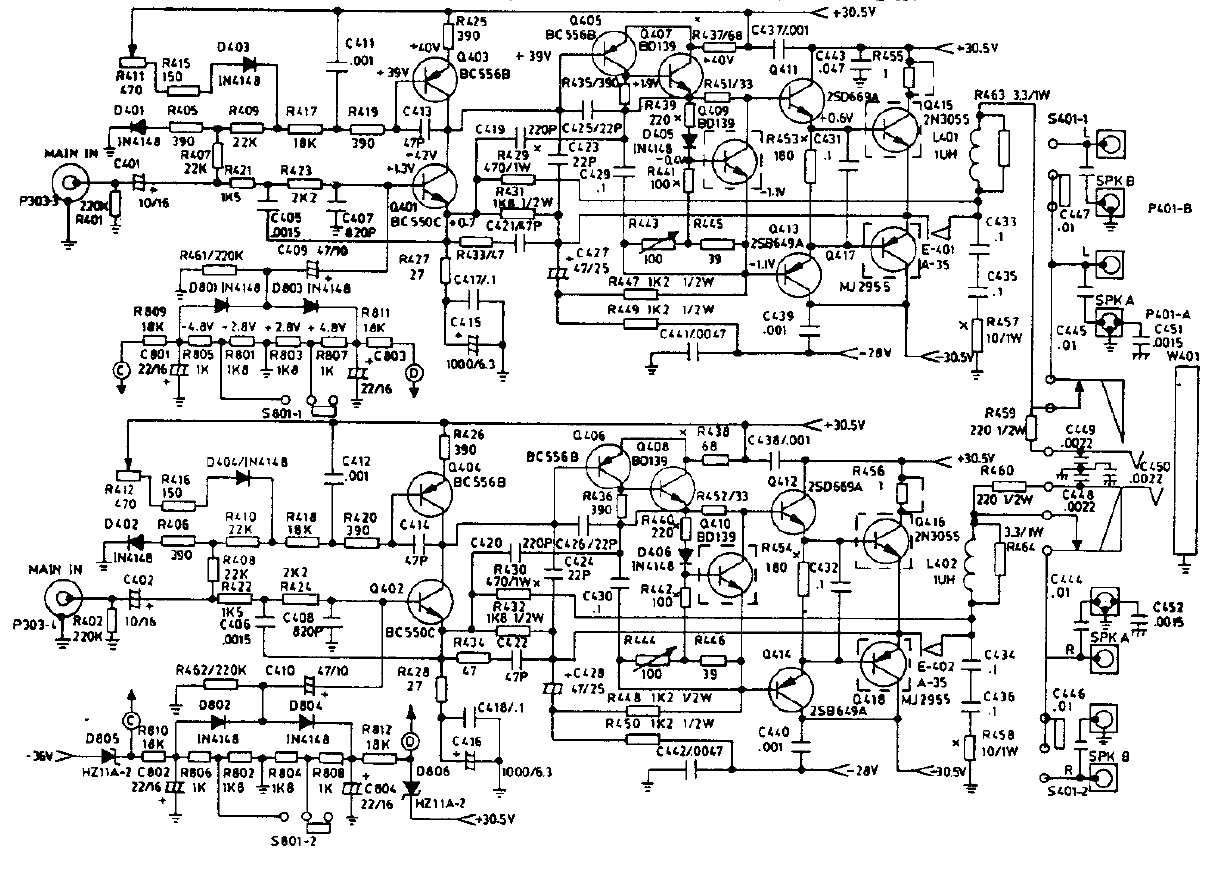

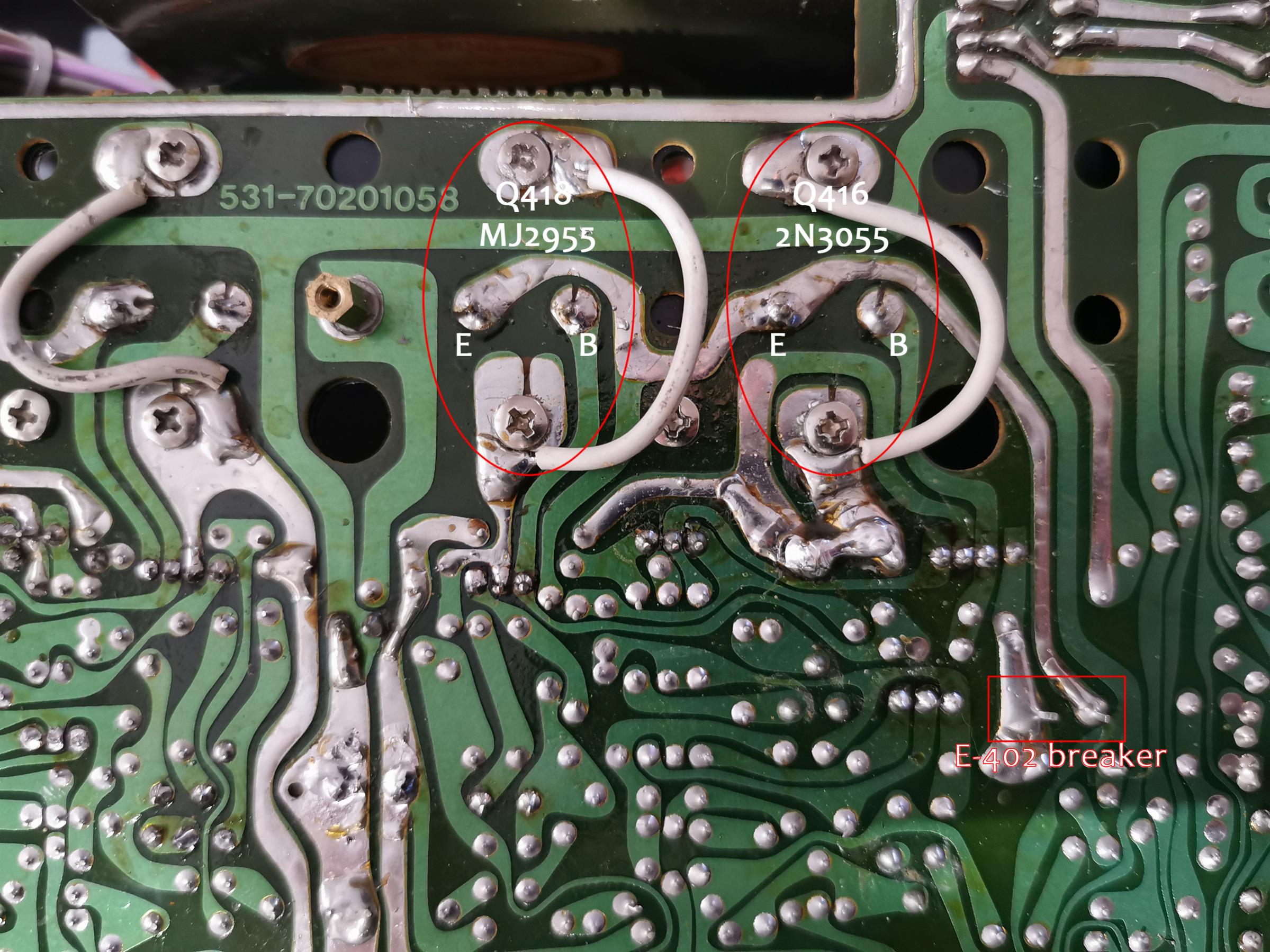

I'm sorry for the stupid question, but I'm not really sure where to put the resistors. The first picture is what my PCB looks like.
Since the emitters are in series with the breaker, placing one resistor for each emitter doesn't actually mean that the emitter of the MJ2955 has a resistor double in value? And wouldn't it be possible to add a single resistor between 2N3055 and the breaker for both outputs?

The feedback leg that wanders off to C428 doesn't matter much, but both Q416 and Q418 need their own emitter resistor. There can be cross conduction between the emitters if the driver circuits are not well behaved, and that doesn't go to the breaker and out. So you need two resistors. I'd put the two 3 to 5 watt resistors over on the right where those big holes are. Then cut the Q416 418 emitter leads short, drill holes through the board near the emitters for patch wires, and run wires through the board and bend them over to solder to the cut lead. Then the wires go over the the emitter resistors.
I can't really visualize your solution :(
A photo with a modded PCB would help a lot but I only found a couple of older versions of the 3020 that seem to have different traces on the board (emitters in parallel with each other, going to a common point before the breaker, making it easy to place the resistors along the way)

I'll try to describe it another way. Perhaps it will help with understanding the actual requirement when trying to follow suggestions here.
Like it suggests, each resistor is located at each output transistor emitter, inline or "in series with" the emitters and before any other connection. This means you will need to cut the 2 existing PCB tracks connecting the emitters together at the large pad where the output and feedback circuits also connect. You could use a miniature hacksaw blade or whittle away at the solder and copper with a scalpel or craft knife to do this, if you have no better option but use a suitable size drill for proper through-hole secure mounting of the resistors. You don't want them falling off or developing a bond failure in some overload situation.

After another look, I realised the R side power transistor in your pic. has traces connecting from both sides so you need to cut both tracks to the R side transistor emitter there, then fit the resistors on both L and R transistors but add a short link of insulated wire or heavy flex from the isolated R side trace to the common point between the emitter resistors. It's messy but so is any circuit modification to a power amp.

If you're going to fit modern epitaxial transistors to these amplifiers, you MUST add emitter resistors. If you dont, the amplifier will suffer thermal runaway and blow the outputs again.
