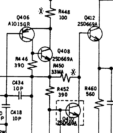

so the transistors i changed yesterday,Q409 and Q410 are the multipliers? and the drivers Q406 and Q408?
Q406 and Q408 are the VAS or voltage amplifier stage. Q410 is the multiplier and Q412 and Q414 the drivers.
ive not got long today, people coming round, but i have checked all the transistors apart from Q404 and Q402(i can if you think it is worth doing) and all of them are fine.
one thing i havent worked out yet is R 450 seems to be quite important as ,if im reading it right, should be 33ma across it, or am i reading it wrong
well neither channel has that, the faulty one is 180ma and the other channel is 110ma across it.
R446 ,450,452,460,462,454 all check out fine

Lets stick with this and be sure we both know what is going with those measurements.

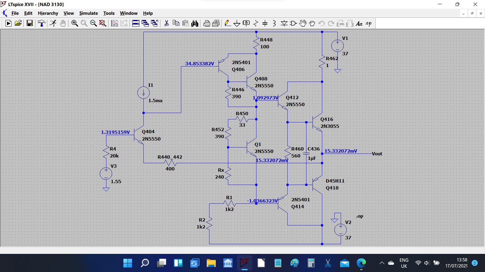

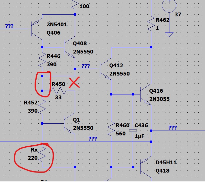

Also I made an error in the sim with connection of that 33 ohm. It doesn't affect the voltages but it means the bias set resistor needs altering on the sim. The 33 ohm is used to modify the temperature response of the multiplier so it tracks bias current vs temperature more accurately.

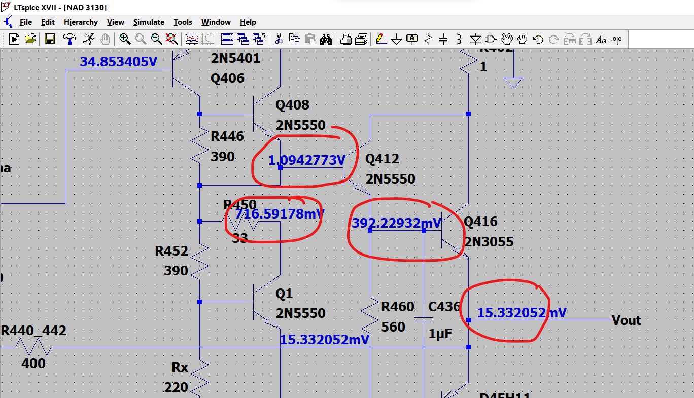

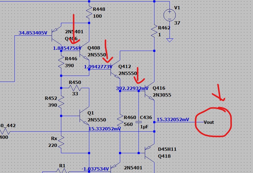

Look at the picture. If you have 2.63 volts on the multiplier collector and 0.144 on the output then I would suspect (in the sim) that Q412 was faulty.
only real difference is, if it matters is the collector voltages- on Q409 its 2.63V and on Q410 its 1.13v
also the base voltages on both of these are only 560mv
so this is the actual, as the amp is currently
ive altered the sim voltages to what they actualy are and the strange thing is the sim voltages are almost correct to what the faulty channel is, not the one that is working correctly, does that make sense

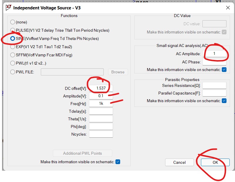

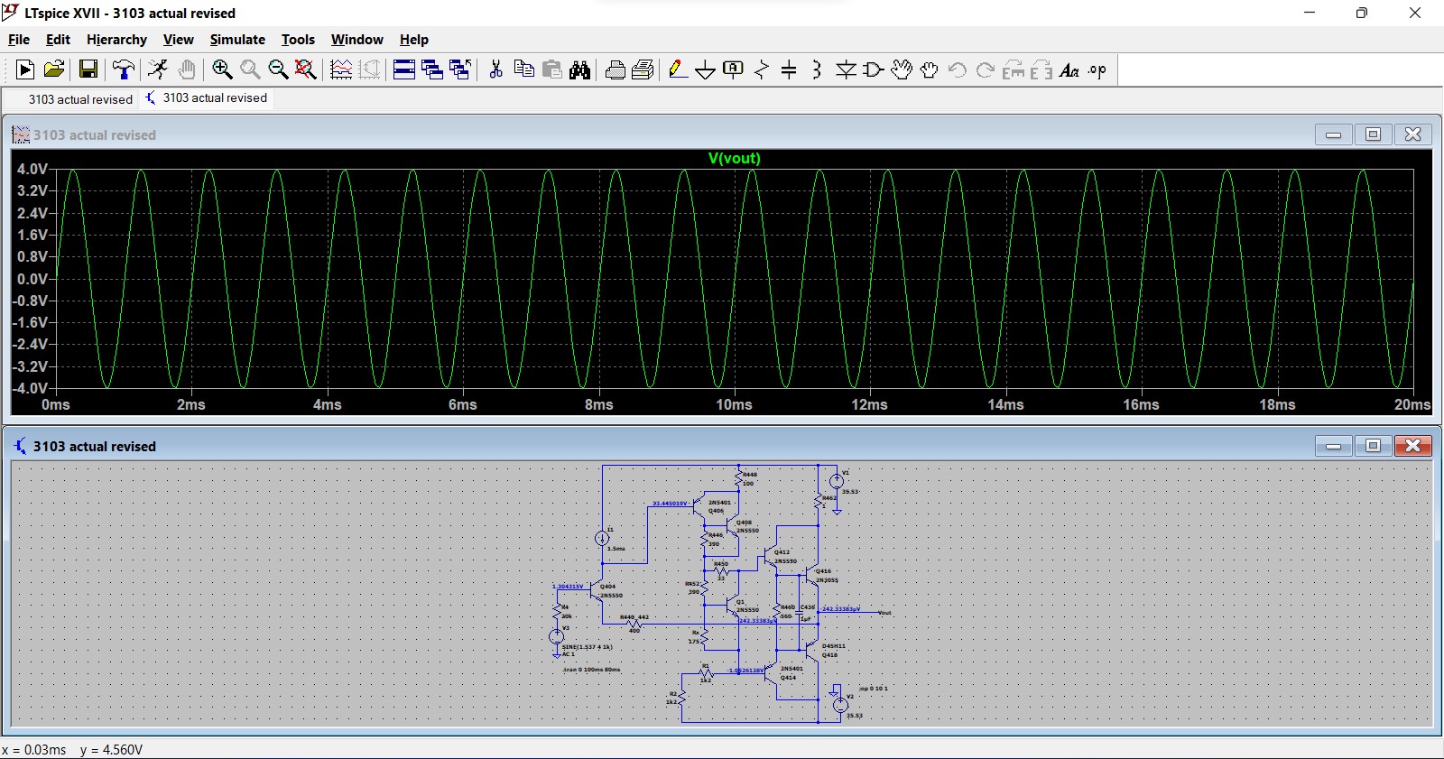

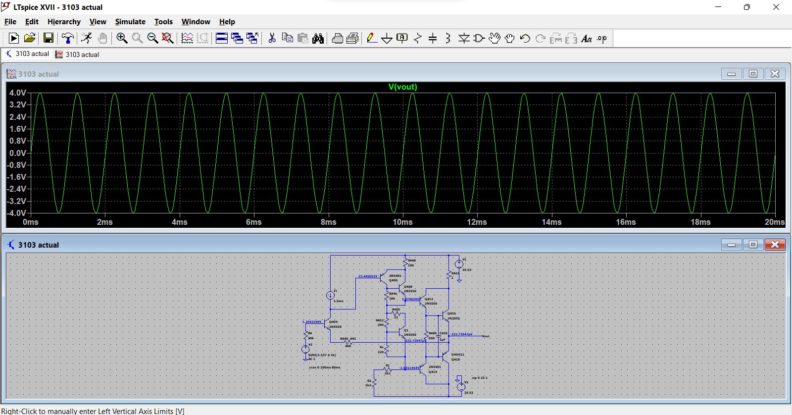

Your attached sim can be made to work dynamically. You need to change the voltage source to an AC one and tweak the DC shift of the input.
You will see that as it stands now, the voltage gain is '1'. So voltage in equals voltage out approximately.
Make the sim run to just 100ms and start saving data at 80ms.
Edit... I've made the input 4 volts here, not 0.1 as shown.

That looks more reasonable for the 100 ohm. So about 11 milliamps flowing. That is in the right ballpark given your supply and a couple of other factors (the vbe volt drops I did not include before as it was an approximation).
Transistors can do strange things when you heat them to remove them so I wouldn't be convinced at this stage.
The real test really is the voltage measurements when it is operating. Remember when I said to use the output line as a reference point at work forwards from there. That would show any problems.
If you put your black meter lead on the output and then measure you should see this progression as each reading adds a new base/emitter volt drop to the one before.
The PNP lower half would do the same except now the voltages would be negative.

does it matter that R454 (in parallel with RX2)(180ohm) is missing from the sim?
see comparison
It doesn't matter in simulation because this is a resistor chosen on test. All that matters is the value of resistance between B and E of the multiplier and in simulation will be very different to a real design due to differences in transistor parameters.
If you change the multiplier transistor in the sim you will get wildly different bias current flowing (in the 1 ohm test resistor). In the revised sim above it is set to about 46ma. Change the transistor to a 2N3391A and it falls to 3 milliamp so you would need to tweak that resistor again.
