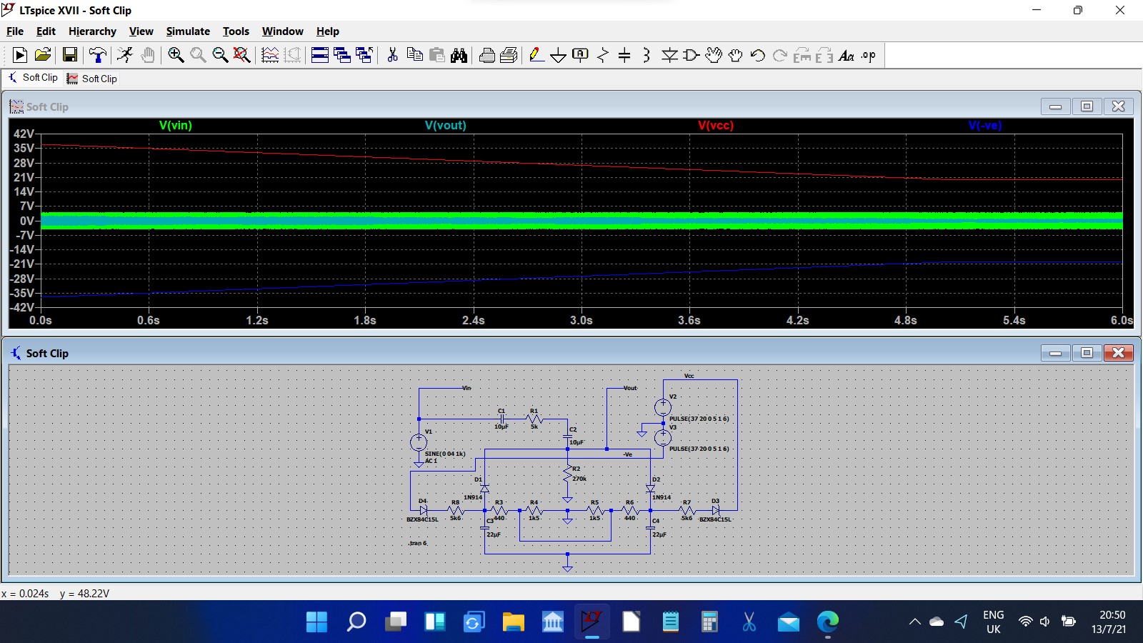

are some of the resistors purposly the wrong way round?
shouldnt the current values be the same on C3 and C4
and shouldnt the output voltage be the same as the input but clipped?

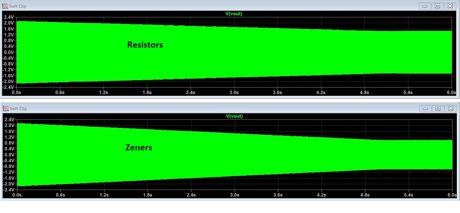

As the input voltage rises a point is reached where clipping occurs. So below this point Vin and Vout are the same. Make the amplitude 2 volts and compare. They are the same.
Now make it 2.2 and a little soft clipping occurs. The input voltage can not exceed this level and so the amplifier itself is protected from clipping.
Amplifying a clipped signal is totally different to have an amplifier do the clipping which can result in all kinds of unwanted behavior. The clipped input signal is totally valid as far as the amp is concerned.

The basic checks are to see each Zener has 15 volts across it. With the soft clip turned on check that you have about +1.5 volts on C426 and -1.5 volts on C428
With the switch open the soft clip actually still works, it is just the levels needed to operate are now so high that it effectively may as well not be there.
The 440 and 1k5 resistors just set the DC reference points on the diodes.
Make sure the Zeners are the right way around and make sure the 1N4148 are the right way around.

can you simulate checking across components on the spice sim?

The easiest way is to look at the voltages on each end of the part. For example I'm seeing 37 volts on one side and 21.7 on the other. That means there is 15.3 volts across the Zener. So all good.
LT allows you to create algebraic expressions and so you could label the ends of the diode and have it calculate one end subtracted from the other and display the result that way.

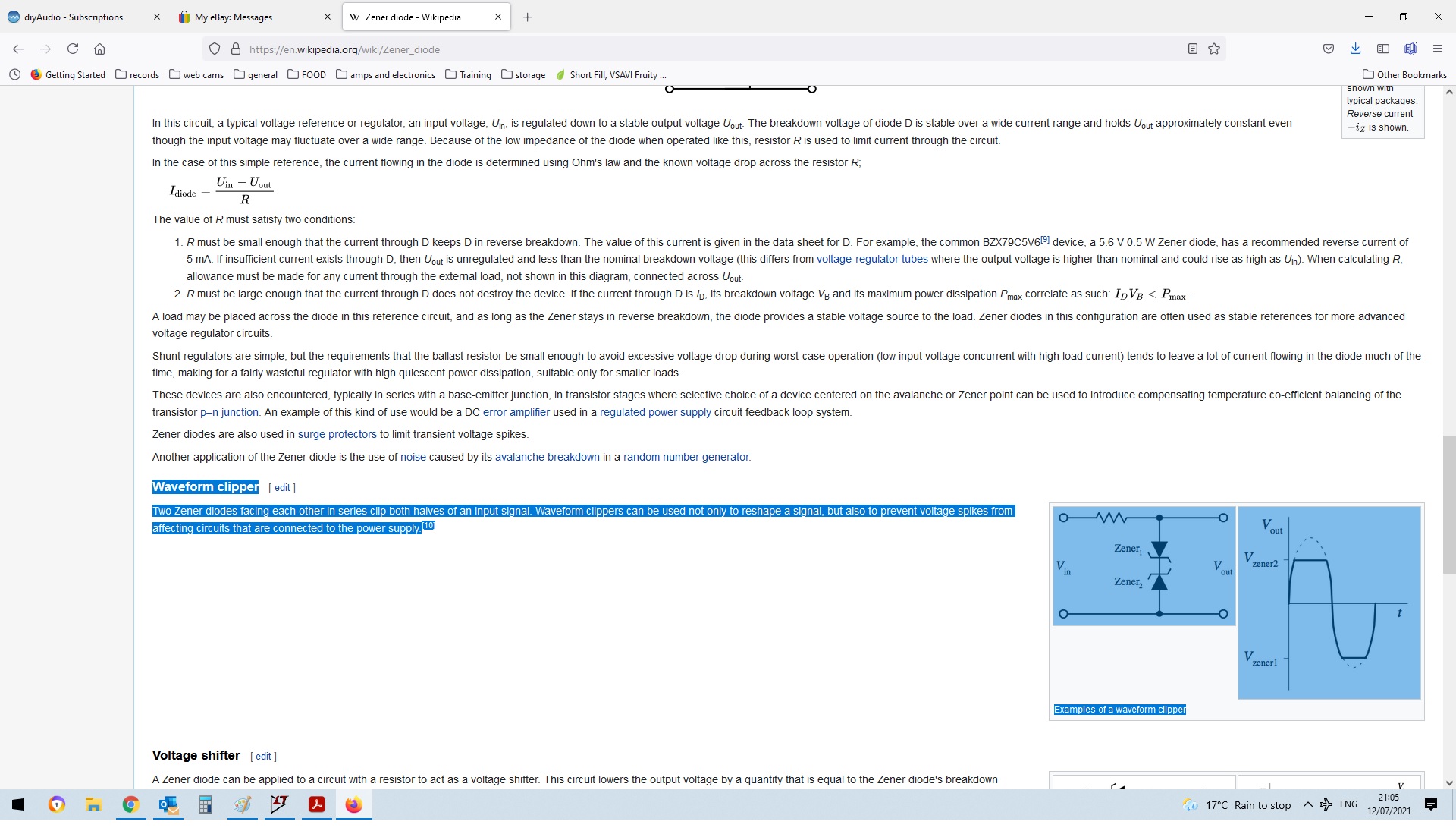

so is the attached the basis of soft clipping then
Yes, in that example the Zeners clip the signal. Your NAD is a bit different (forget the Zeners in the NAD for now) because it uses the two 1N4148 diodes to clip the signal but crucially it uses the resistor network to set a DC voltage on those diodes to 'lift' the operating point of them above the expected -/+0.6 volts they would otherwise clip at.
The Zeners appear to do a couple of things.
1/ They 'loose' us some voltage meaning the resistor network can use smaller low power resistors.
2/ They will modify the clipping in relation to supply voltage. When the supply dips under load the clipping point is lowered... neat eh 🙂
Try it. Make the supplies 25 volt and the input 4 volts and compare the clip level to the -/+37 volt supply.
