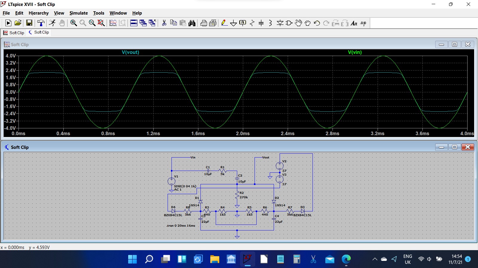

Try this and use it to look at voltages and try and figure out where yours is going wrong.
This is the soft clip from the NAD. It works by clipping the input signal and it does so by setting a DC voltage on the two IN4148 diodes. When the signal exceeds those voltages plus the diode volt drop it is clipped by shunting it to ground.
So you can see the soft clip is really a passive circuit that does not need the amp at all (although it needs the supply voltages to provide the DC reference points).

are some of the resistors purposly the wrong way round?
shouldnt the current values be the same on C3 and C4
and shouldnt the output voltage be the same as the input but clipped?

why would the voltage be lower when clipped? ,wouldnt this reduce the volume?
