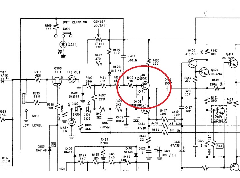

well that was also short lived.
plugged this in this morning and one channel just does not sound quite right, there is def distortion on one channel, especialy at higher volume
i noticed the Q609 collector voltage is lower on this channel (L) so im gonna work back a bit and see why
The voltages you measure on Q609 etc are not absolutes and will seem to vary, particularly when you measure using ground as a reference point.
The amplifiers DC offset will alter Q609 voltage for example and so will temperature differences.
What matters is what the bias current is and also that the DC offset is still OK. If those two conditions are met then something else is going on.
so im just going to have a look at this one after looking at the other one this morning which is ok now(see the other thread)
the bias keeps going back to zero on this distorted channel, weird(i guess why its distorted)

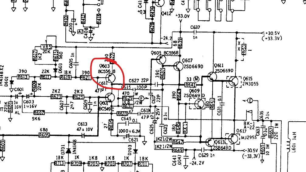

It sounds a bit of a strange one.
If the bias drops to zero then the distortion does increase but not normally by as much as you might think.
So the low bias in itself might not be the underlying reason for the distortion (assuming its pretty bad) but it is of course a measurable problem related to whatever is going on.
You could (on the good channel) try shorting out the vbe multiplier just to see what zero bias sounds like. That would mean linking collector and emitter of Q610.
Two things to check.
1/ The voltage across C and E of Q609 determines the bias current.
2/ The current flowing in Q609 will partly determine this voltage and so if there is a problem with R647 or R649 going high then that would cause the current to drop and so the voltage across the transistor.
3/ More unlikely would be an issue around Q603. The voltage across R629 (390 ohm) is a direct measure of the current flowing in that whole chain.
4/ An intermittent (dry or fault) driver transistor would cause distortion.

well it had def failed.
when i checked the centre again after trying it this morning i have 21v on the distorted channel so it was just shear luck it didnt blow the speaker up, that is why i went hunting for that one first.
i did take a few of the other transistors out ,test them then put them back in, so it could have been a red herring and 2 probs at the same time, and re soldering the transistors back in may have resolved a joint issue, that unfortunalty i will never know.

Right... so a different version of diagram to the one I was looking at.
So this would be Q603 that I mentioned but also thought unlikely to be at fault.
