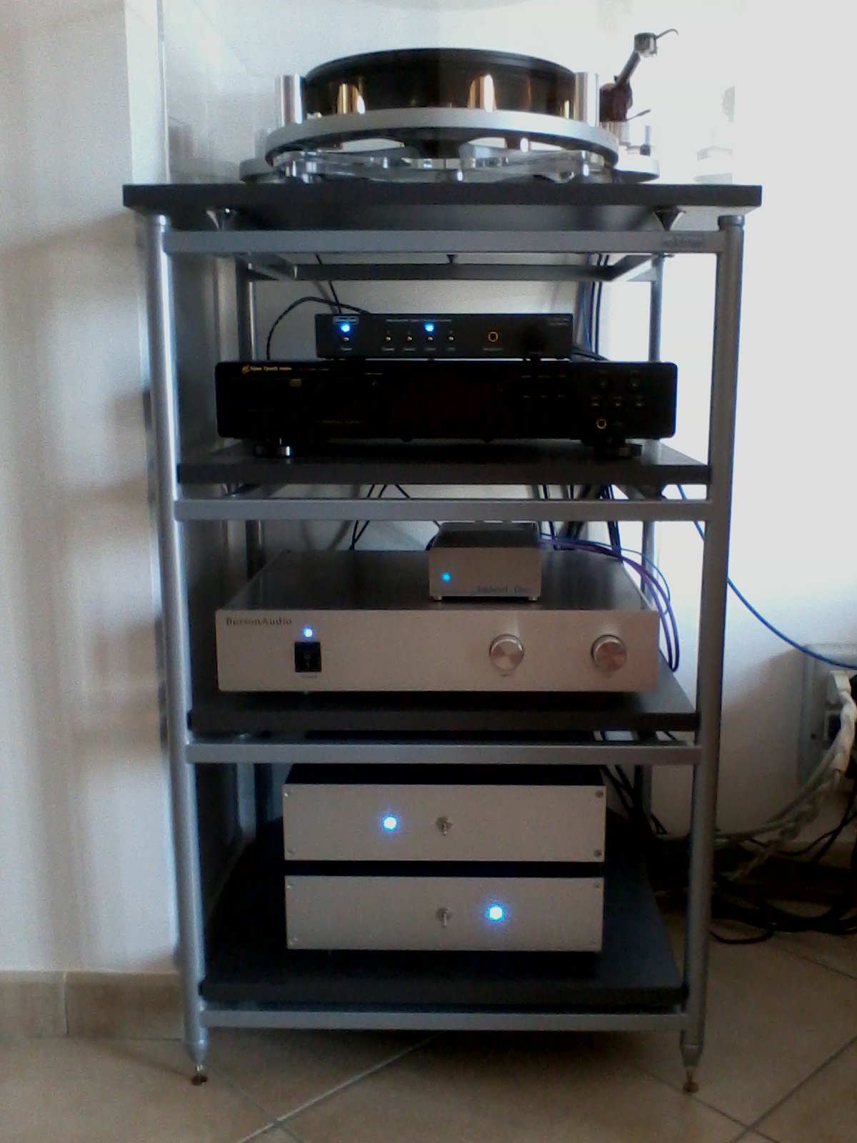

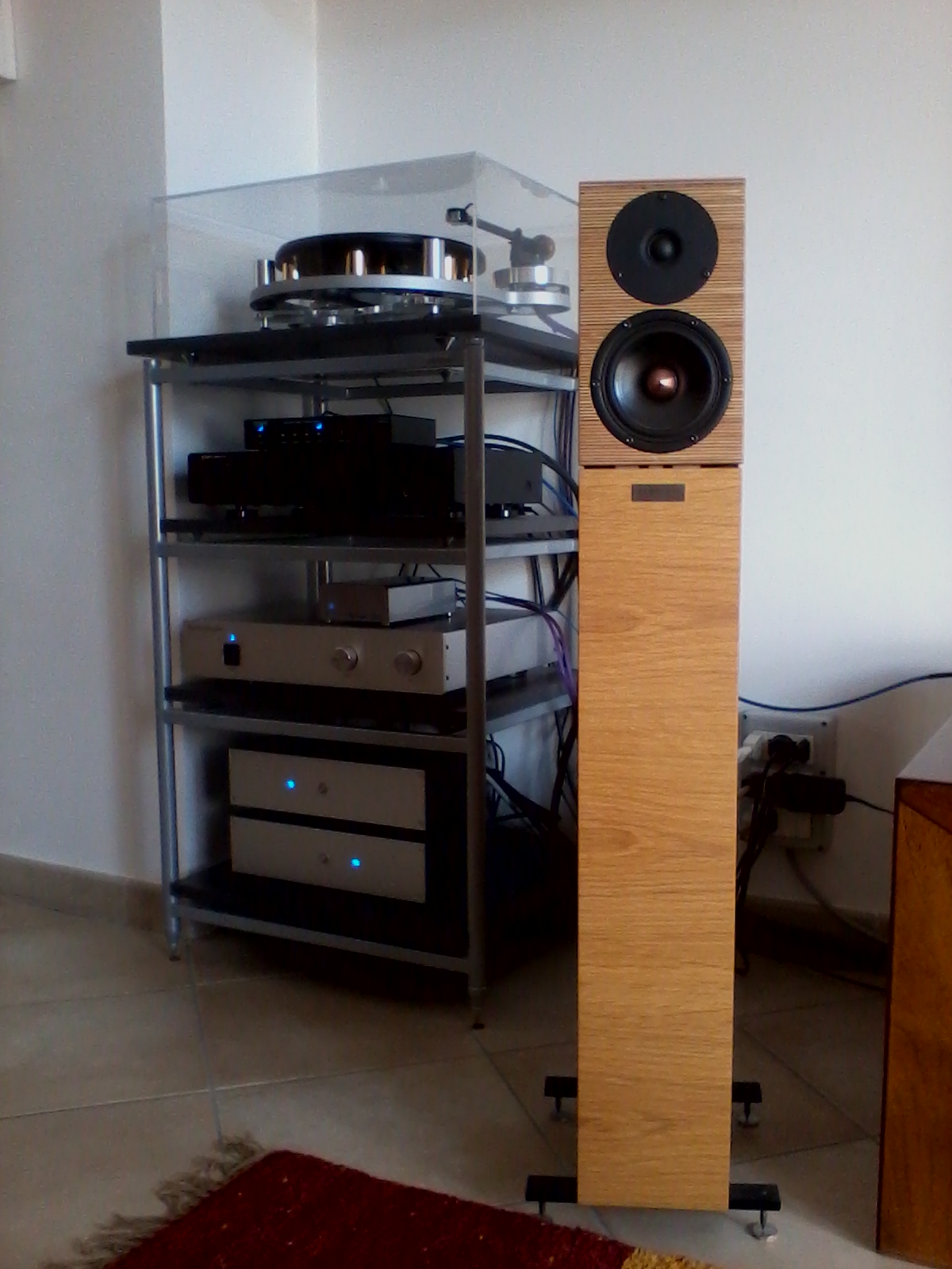

The amps are built and working from September, some photos are attached below.
They are a far cry from the gainclone I had and considering that the power stage is practically the same, I guess the project make a difference.

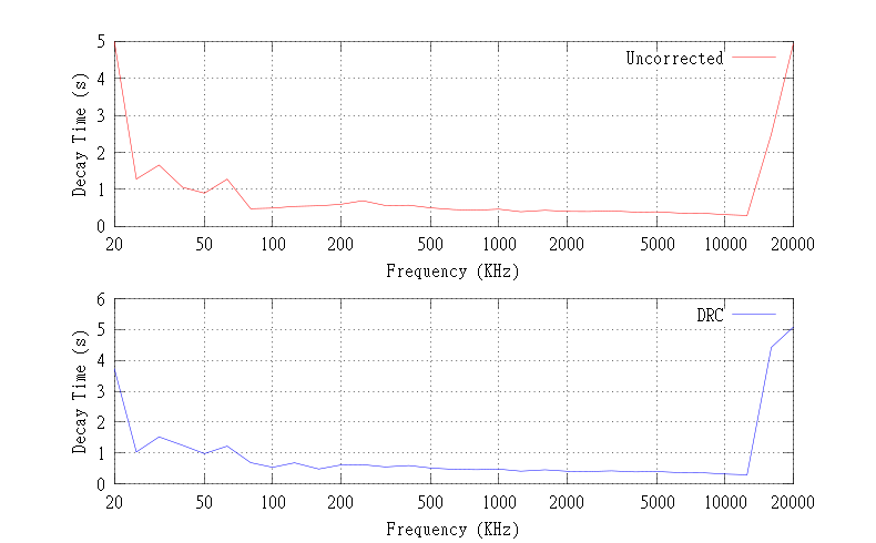

The most obvious aspect is the control of low frequencies that now are more consistent with the rest of the spectrum, before the bass*joined to standing waves of the room, making it sound very artificial.
Now the modal resonances remain, but the bass is still nice, however I would add a few pictures with the rock wool to dampen the reverberation of the room.
I've attached also a picture with a graph of RT60 of right channel (RT60 is the time required for reflections of a direct sound to decay by 60 dB below the level of the direct sound.)
