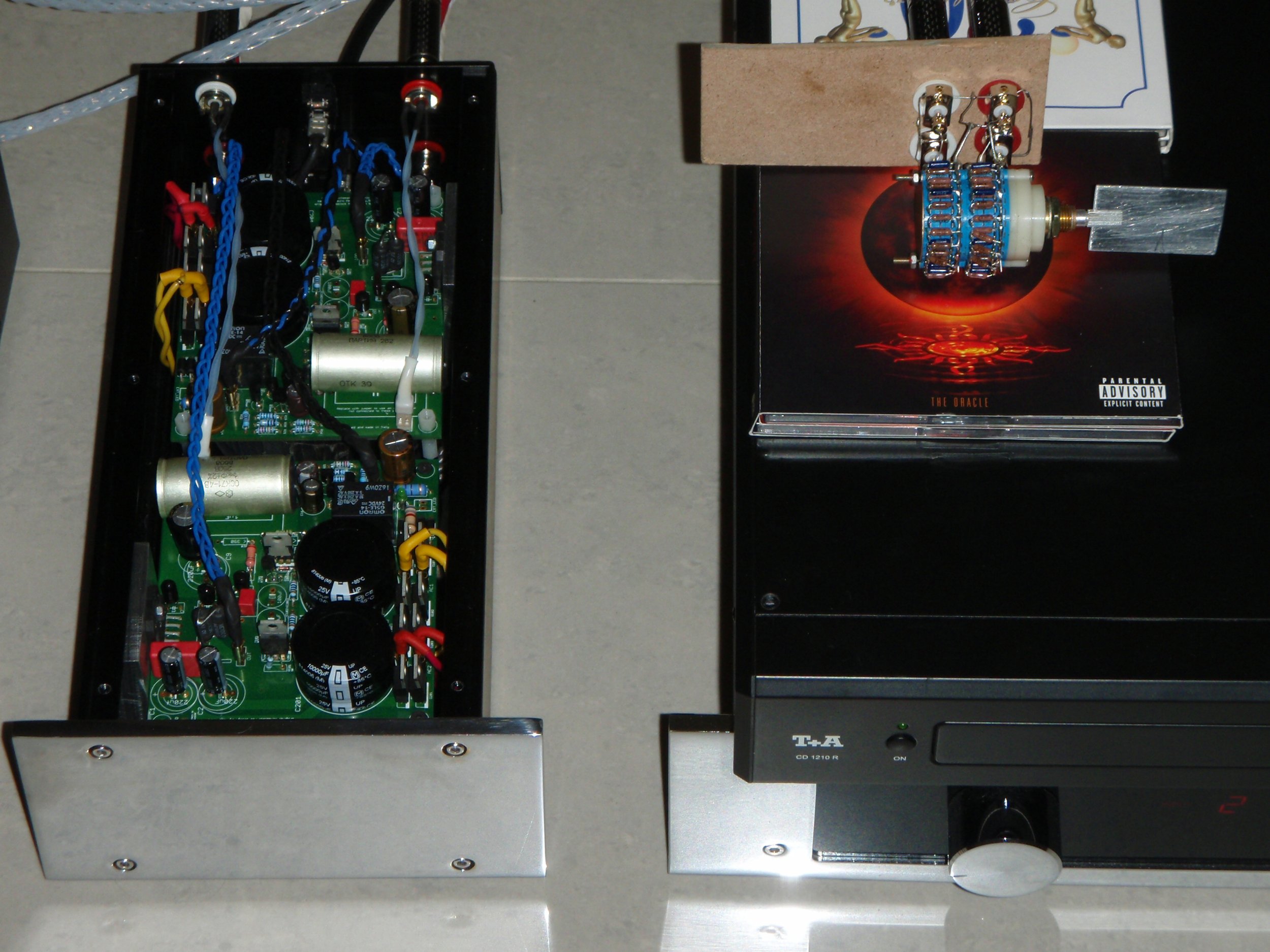

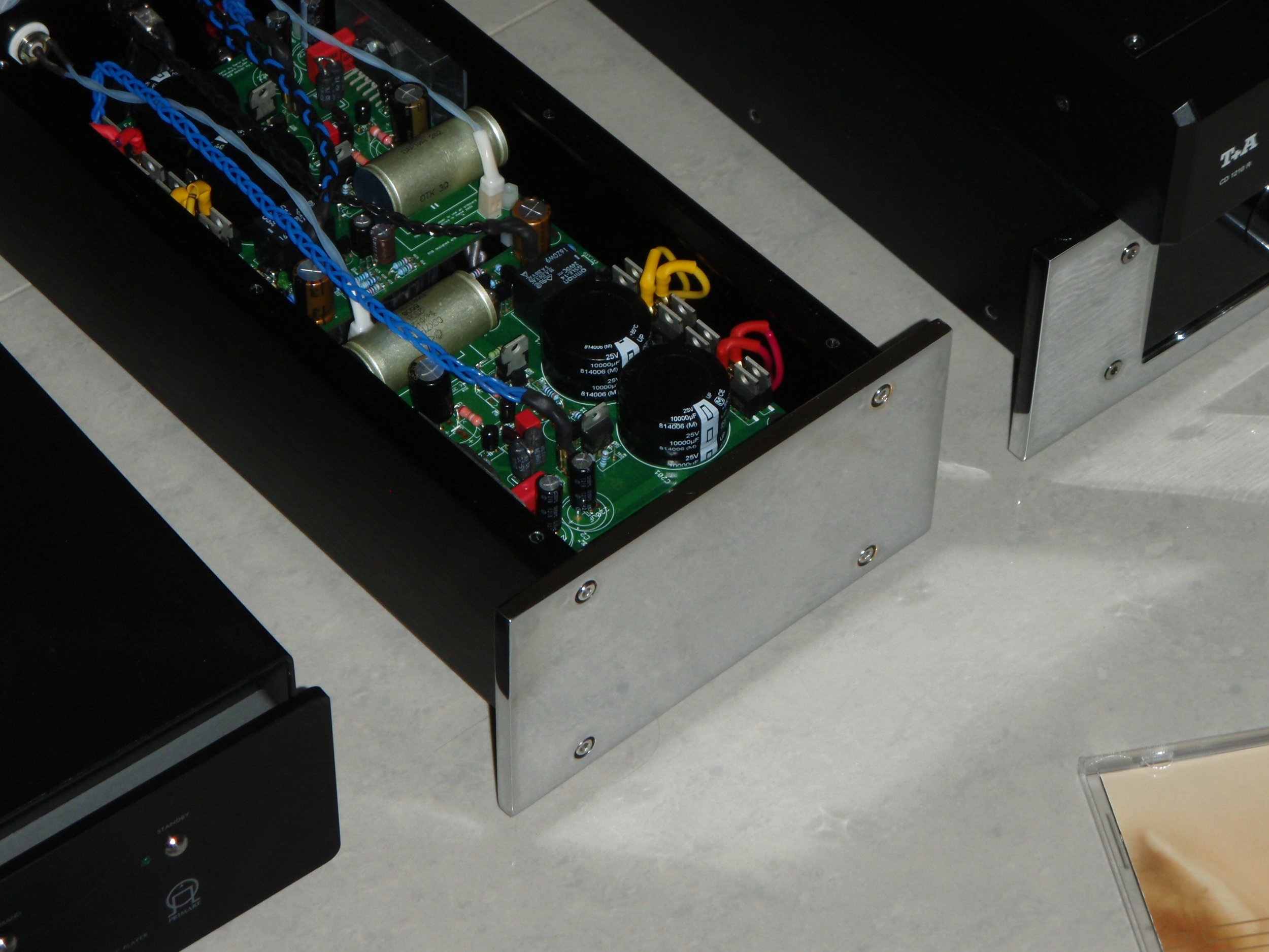

a quick update from me and my wife 🙂
FE - very detailed, analytical, pleasant and soft sounding amp
Restek - considerably more dynamic and punchy, militant and unpleasant for my wife 😀 but kind of reference for me.
the difference was quite obvious and common for both of us (though it wasn't like comparing 192kbp mp3 and then flac), however none of us could say where and which drum or bass guitar was more articulated and better placed on the sounstage... It seems to me that swapping the caps (C9) would bring very trivial difference if compared to different amps, hence I'm kind of scared in case I found no difference at all 😀 as it would take time to get up from the sofa, turn off the FE, swap the caps, turn it on and sit again already in slightly different position...😕

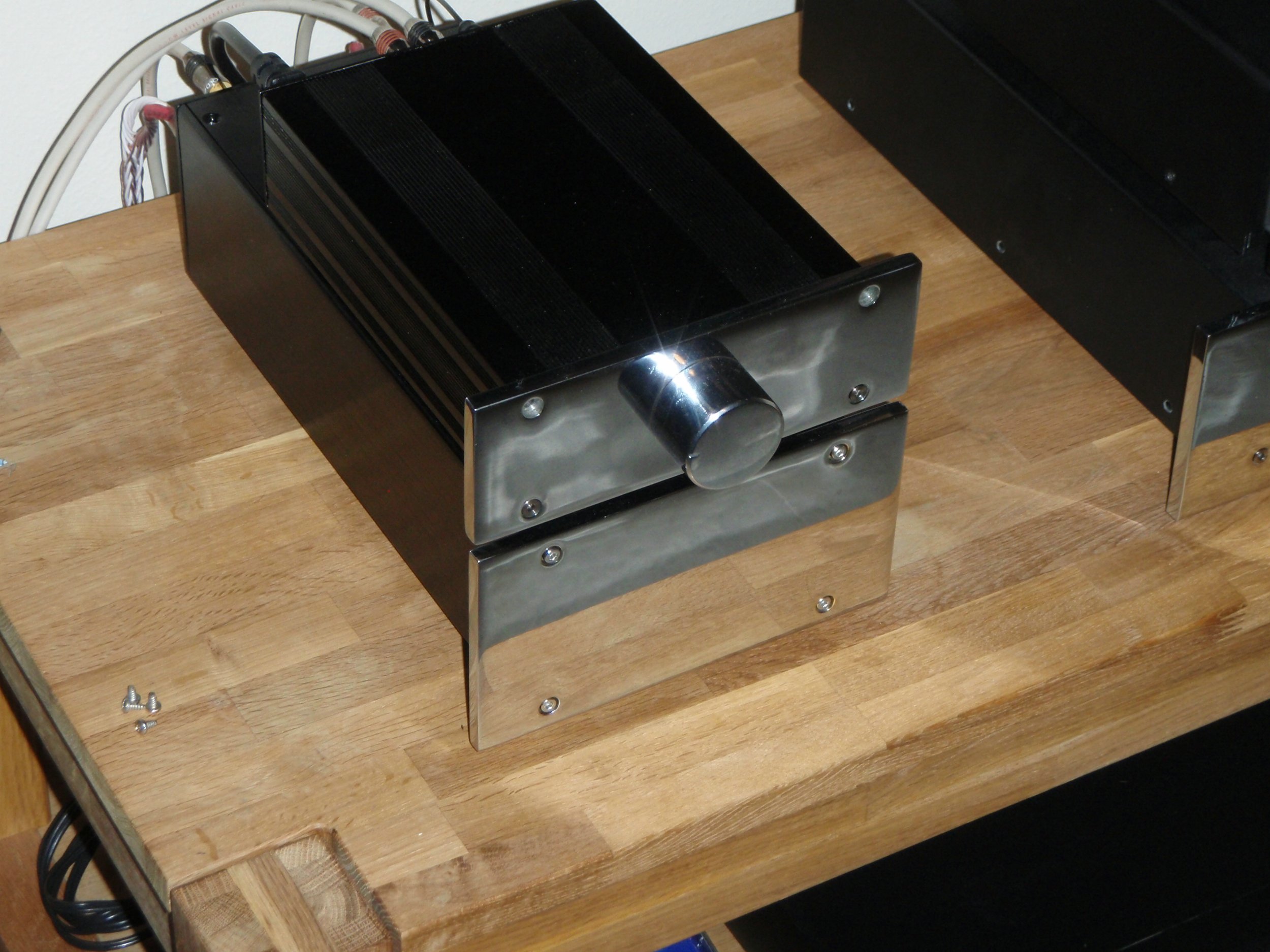

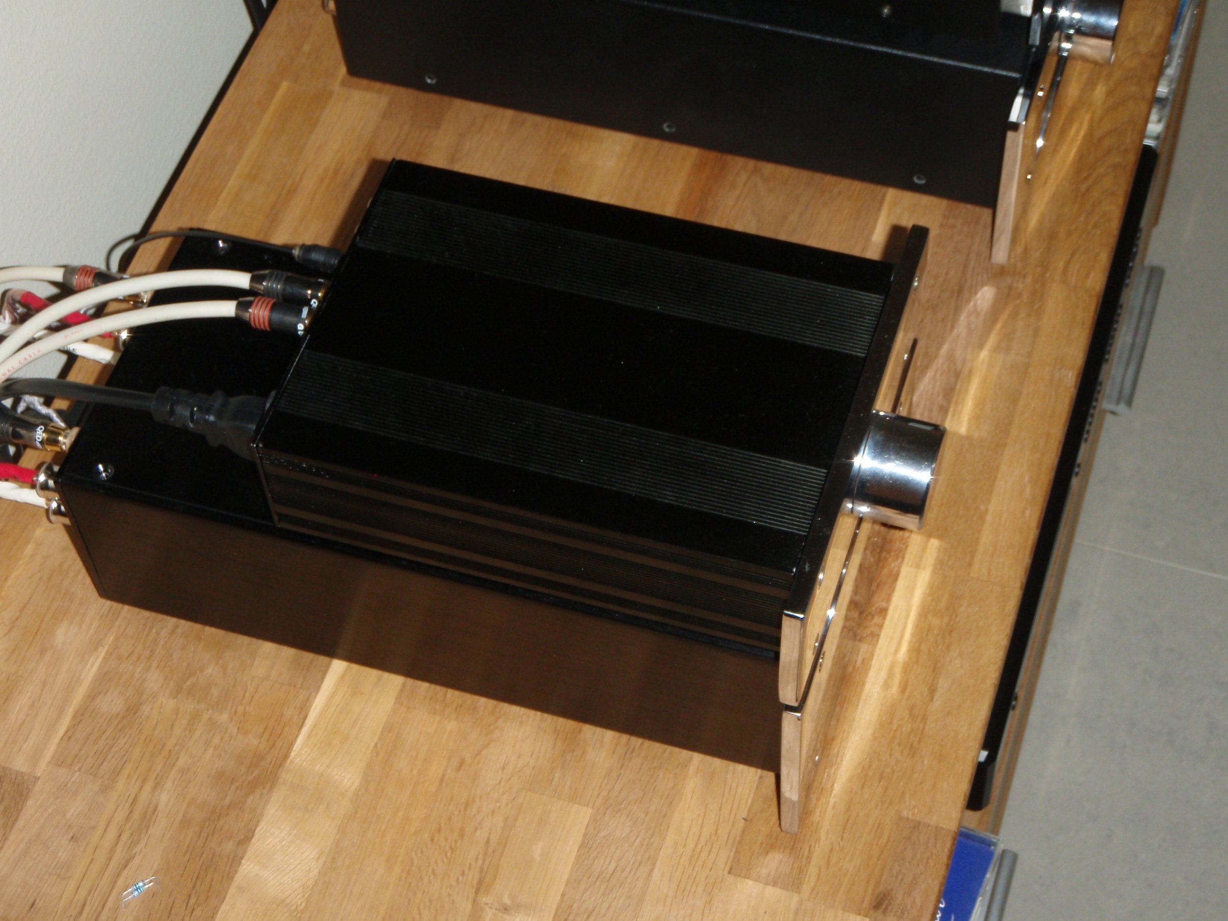

Few more pics in chrome.
All in all, I very happy with both amps:hohoho:

The chrome looks super!
I still think you should replace R3 and particularly the current settings resistors R101/R201 with Caddocks.
They make a HUGE difference.
In general, IMHO, any variation to the BOM makes sense only if you compare the alternate part with BOM's one.
Otherwise how can you say the alternate parts is better/worse/different than the specced one?
Don't do it then... simply use one of the recommended caps... PCX has last BG PKs...

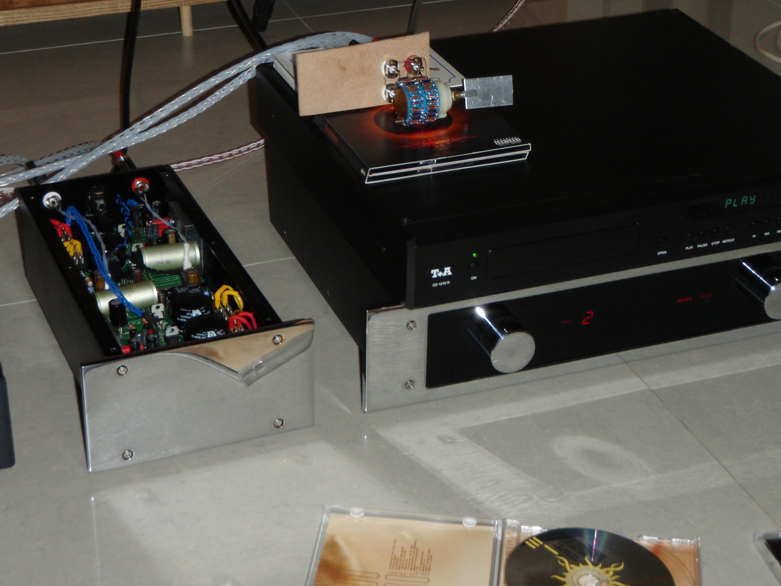

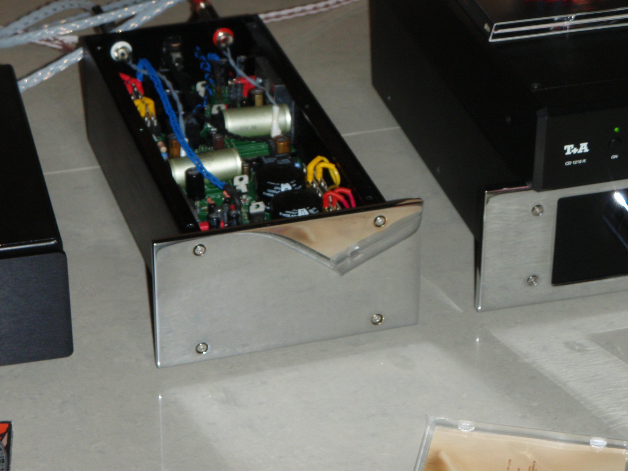

Another test was held on Sunday.
C9
Panasonic FC - slightly bright with more highs
Nichicon MUSE & Elna Tonerex - the last one is more natural with a wider soundstage than FC. I didn't like MUSE, though the difference was very negligible if compared to Elna, but the overall impression was that this cap shouldn't be placed here.
Indeed there are some differences in C9, though for me they are far less obvious and significant than comparing two different amps.
Next step would be adding copper shield, removing sockets and testing PKs.
P.S. I made it so narrow to match my DAC/Preamp but now I feel some slight disappointment and wish I chose another chassis. Perhaps it's just kind of paranoia and endless process of improving and tuning audio stuff 😀 I'm no sure! Moreover I'd rather prefer the look of naked components with their lids off then enjoying with finished products...
