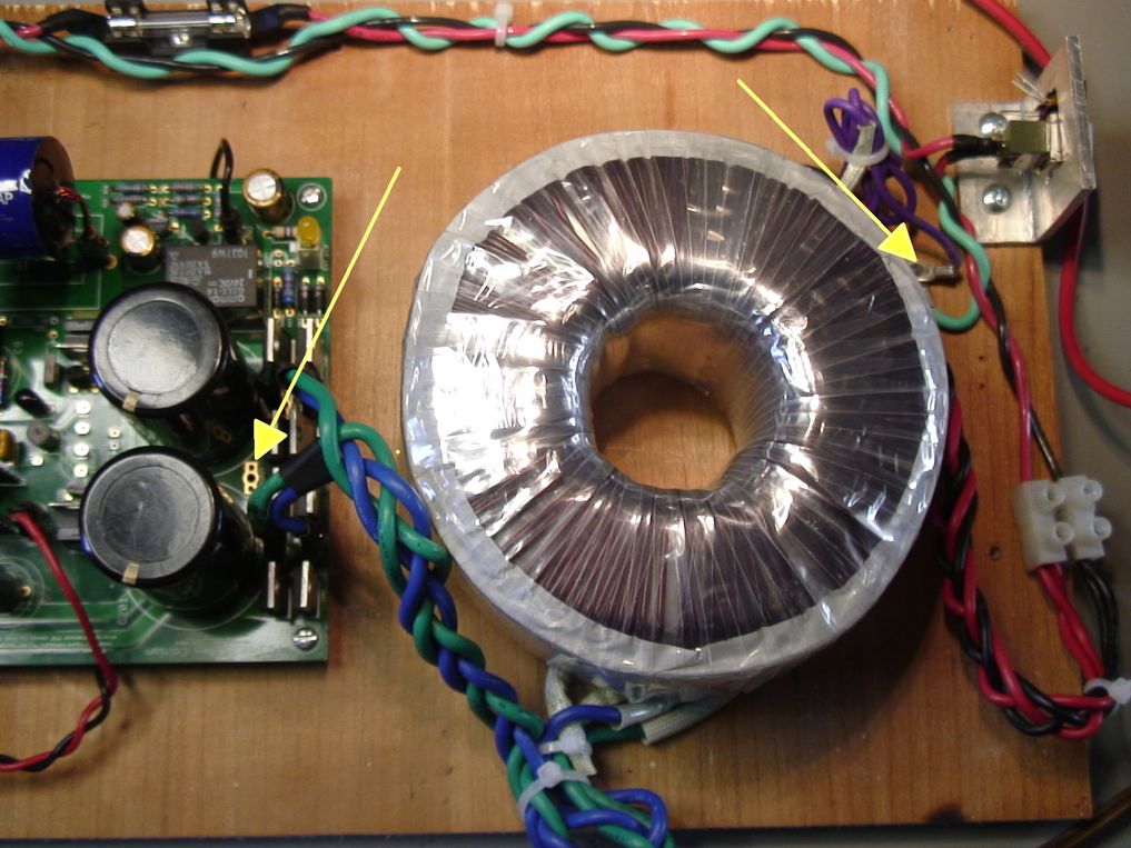

Hey, It is between PGND and Safety/Earth ground. You can measure both but what is most disturbing is the AC voltage shown there.
Got it, thanks! Well in that case i get 0 AC as my SE is not connected to the chassis yet and virtually is floating in the air. Once i finish with copper screens and front panel i'd connect SE to the case as it should be by all rules 🙂
