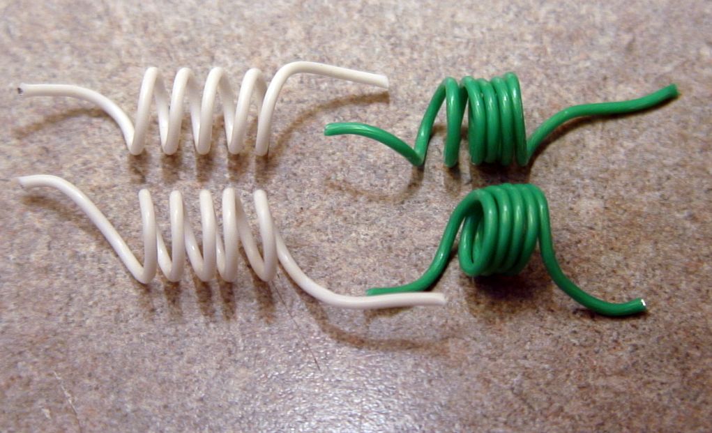

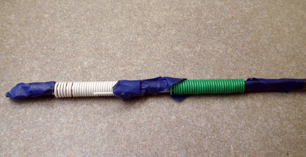

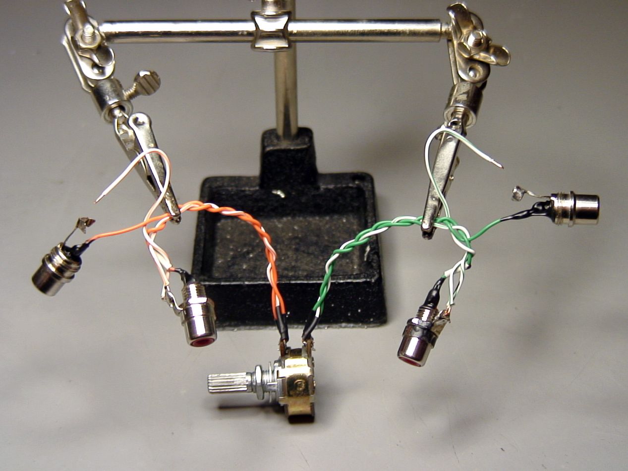

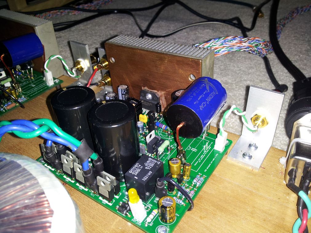

Hi Guys. Missed yesterdays conversations as I lost internet connectivity late Saturday afternoon and just got back online. It's amazing how much can be accomplished around the homestead when one is rejected by Mr. Google. Who Knew :scratch2:
I missed the the opportunity to do some of the tests suggested and I should have thought about them on my own. I did complete the socket removal but with all the mess this weekend, haven't done a whole lot of listening. Hopefully my "Audio Memory" hasn't faded completely and I'll still be able to offer some valid information later today.
Fortunately, I retained the C13 fastons because I don't want to trim and solder pot the True Coppers till after the final board/design is built and tested. I'll take Dario and Tom's lead as to whether that's a wise move. As Tom suggests, when I got the TCs I cleaned the individual strands of the Litz leads mechanically as best I could, burned them off with a small butane torch and then soldered with lots of flux and the same torch.
I will take some time and extra care to do both the solid solder and Tom's pigtail alternative tests for the C13 faston removal using the Audyn Plus caps. Probably won't get to that till tomorrow.

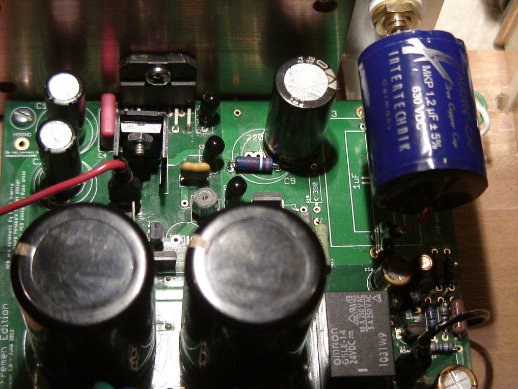

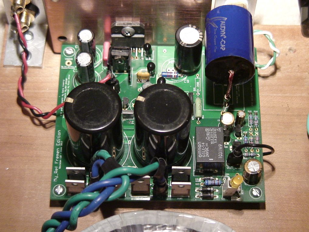

A couple interesting findings from the past few days:
1. I mistakenly reversed the orientation of C-32 when mounting without the sockets. There was a notifiable increase in bass that disappeared once I corrected the error (the writing on the Amtrans cap oriented to the label on the PCB ). Had I not trashed the sockets, (a real pain to clean the vias), I would have done more testing - but due to the more than adequate low end from the TCs, I left them in the suggested orientation. That's not something that pleased me as it just further complicates the understanding of the interplay between components. I have complete confidence in stating changes in orientation can be easily heard, but the dynamics and reliability/repeatability of such choices continues to gain complexity.
2. For the interconnect hum I get on the RC and not on the beta - there was further confirmation that it is ground related. A quick recap: Any source can be connected to the beta build without a problem. Only the Mini 2496 DAC and the battery powered Walkman - with direct connection to the RC is clean. What I found yesterday is adding the self-contained Alps pot rig i made, (with all grounds and metal case acting as one big "Star" ground), introduces the hum to the RC build. The AC powered sources all have acceptable DC readings. The alps rig does not introduce hum when used with the beta build. Still a mystery but I suspect/hope it will magically disappear on the next build.
3. I should have bought the de-soldering tool Dario recommended a year ago.:cuss:
BONUS: If you really want to jump off into the deep end of the Phantom/Real wire and metallurgy universe - Check This - A little birdie gave me the link. 🙄 Too simple and tempting to not try ???
Forgot to mention - the fastons I used for the TCs at C-13 were from the local hardware. They are branded "High Temp" and have a bright nickle/chrome surface, so I might hear something really different at final install if the various stated positions are valid.
No Sockets Transition.
This change was more significant than I would have expected. The very first impression was "muffled". I actually did that 'shake my head" thing that does some kind of ear tube equalization. Keeping in mind and trying to resist the numerous claims of "hearing what one assumes", the change in sound was definite.
I you go to a good stereo shop to audition speakers the lower priced units might really impress/grab you. As you move up the scale the improved quality seems to come from the removal of artifacts in the sound and not a perceptible increase in loudness or impact. That's what I heard with the sockets removed.
It wasn't all that simple though. I got the impression of a more homogenized and stable presentation but a bit of the shimmer and forwardness had gone away. The side to side stage felt slightly more solid and defined - not a lot but hearable. The upper end bells, cymbals, fret noise, flutes, snares and such were clear and distinct. A little more immediacy and blend was perceived in the electric/acoustic bass - kick drum area.
My test mix has two keyboard tracks that have some static at dynamic peaks that I suspected could have been caused by poor connections at the sockets. It remained with the soldered components so is clearly in the recording.
What was very noticeable was a new graininess in vocals and solo instruments. It was pronounced enough to make me suspect an incorrect orientation at C-13. Instead of rotating the TCs I let it ride, and the majority of that element smoothed out somewhere between 45 minutes to an hour. In my mind that confirms Tom and Andrews claims dealing with significant impact on sound quality from very small changes, in very small pieces of various metals in the signal path. It seems there is always an internal adjustment between/among board components - Ex: on the level of the problems CPU designers found when the traces got so small the electron flow was influenced. Don't know all the science, but I'm sure electron flow is just as important for audio equipment. What I heard from the change in sound quality in that first hour appears to support Andrew's claim that initial "forming" or "burn-in" are the most significant at introduction to the circuit.
I'll still use the IsoTek process and listen for changes over time, but I am now fully aware of how the use of sockets is truly an interim technique.
This morning I did do the C-13 twirl dance for good measure. Still the same - the orientation in the photo has less bass and impact but produces an overall smoothness that will most likely pay off with less ear fatigue.

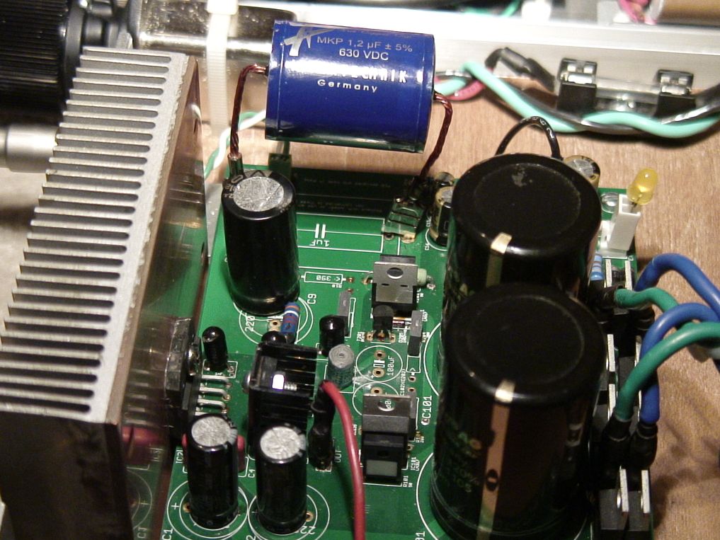

Today its Tom's "Pigtail Day" 😀
What you heard is, in part, brass signature removal.
Sockets are good for testing parts but the amp sound better without... 😉
It's the time usually taken by solder joints to settle.
Another reason against tests done with soldering/desoldering work in small intervals.

The sockets were always intended as a temporary addition for component selection,testing and tuning. It is expected that all final builds will none for optimal operation. My plan is to have only the board power connections not soldered directly to the PCB eventually.
I honestly did not expect such an overall sweetening of the amp by just removing the sockets. I ran the Isotek process a few times last night and the system is simply stunning. Just finished listening to a Yo Yo Ma / John Williams orchestral collaboration. All the nuances of the full range of the cello were perfect, and when some dude hit what sounds/feels like a 20 foot diameter bass drum - my entire house vibrated. 😀 😀
