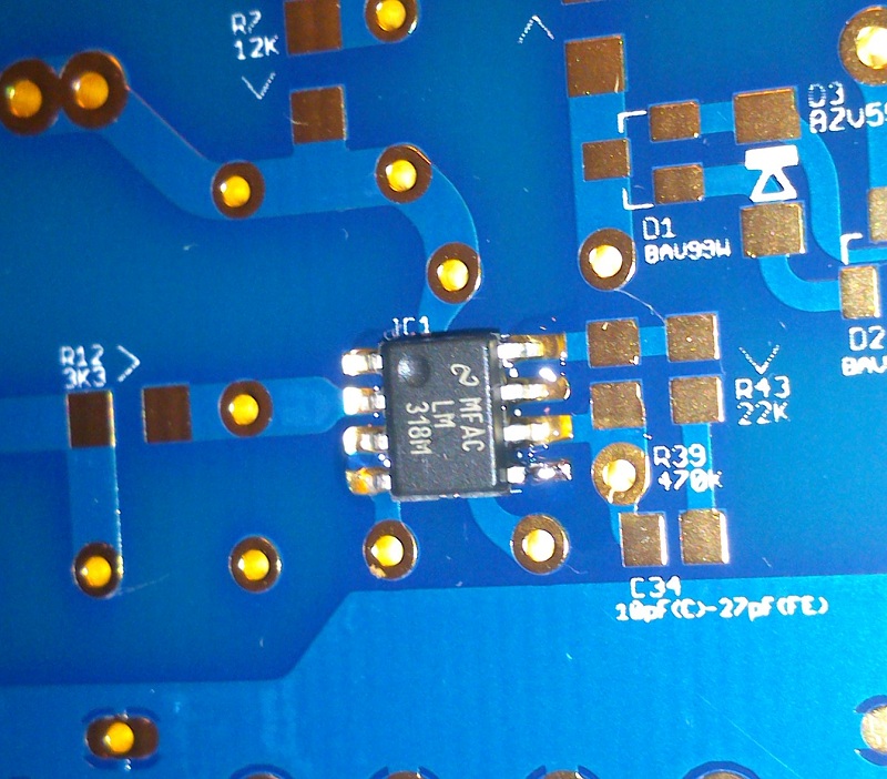

1 - SMD parts
Clean boards with alcohol.

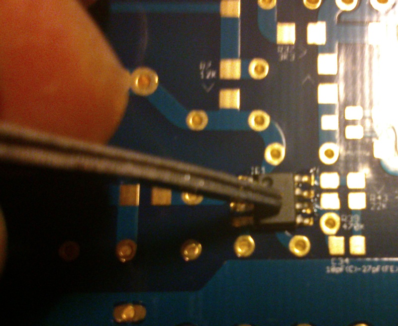

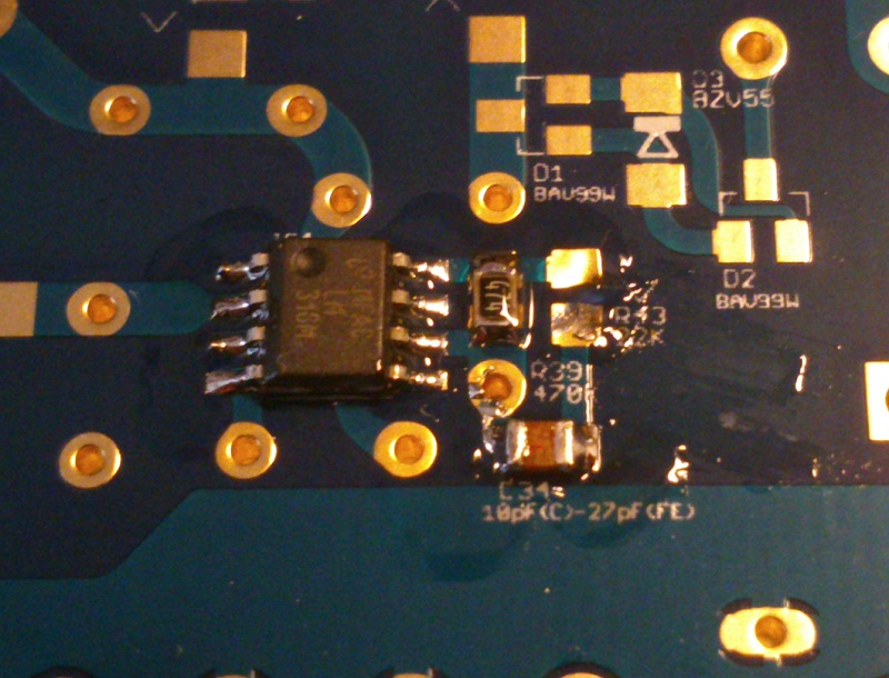

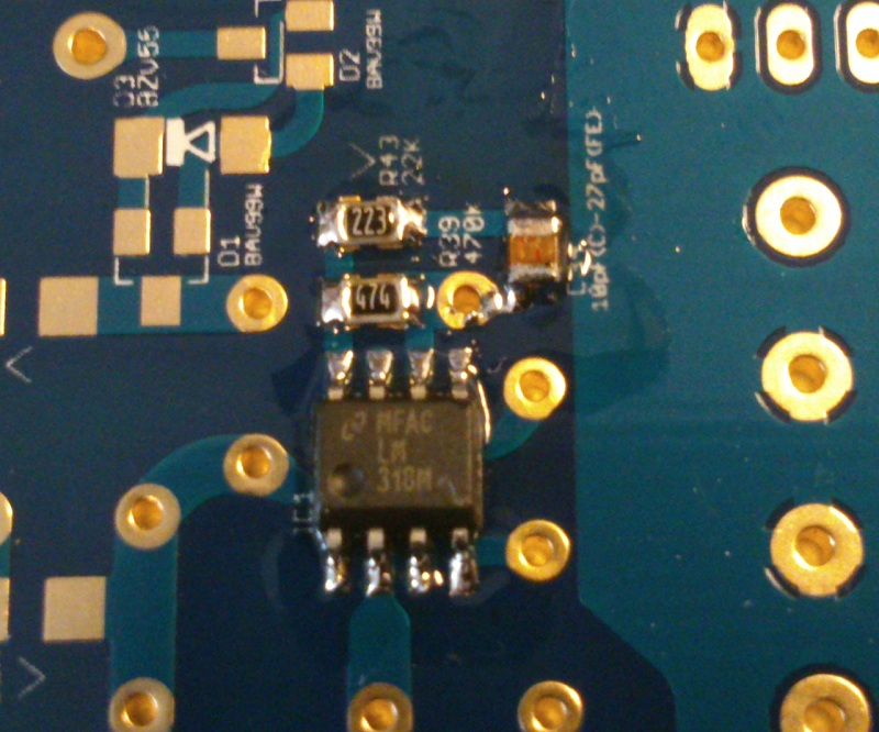

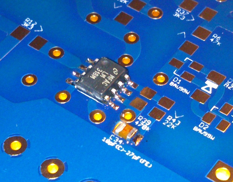

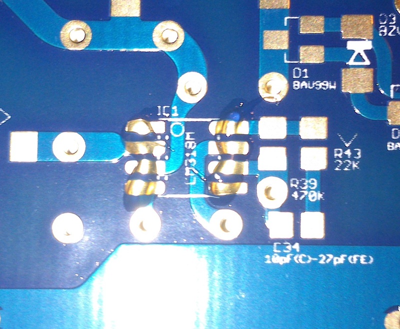

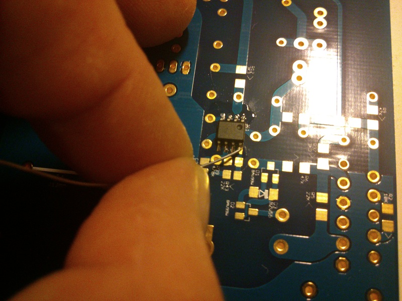

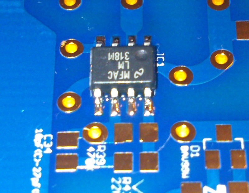

The first component we put in place is the LM318.
Apply flux to pads:
attachment.php
Then position the LM318 (take care to pins to pad alignment) and keep it in place with tweezers:
attachment.php
Apply the wet solder tip to one of the pins (the bottom one on the right is NC so it's a good one to use)
attachment.php
Now that the LM318 is kept in place by the soldered pin we solder all the others.
Just apply the solder and solder tip for 1-2 seconds
attachment.php
This should be the result:
attachment.php

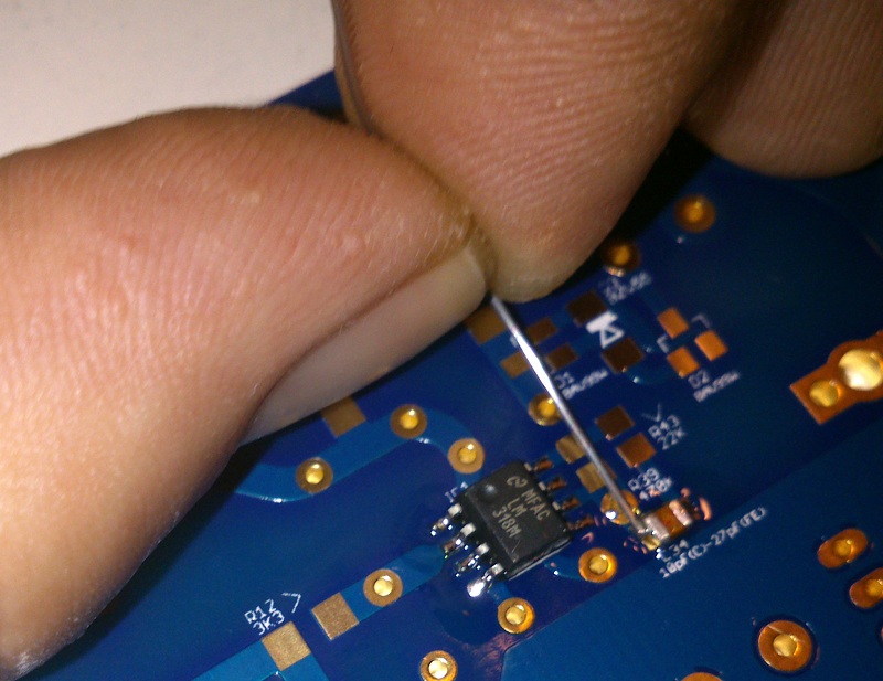

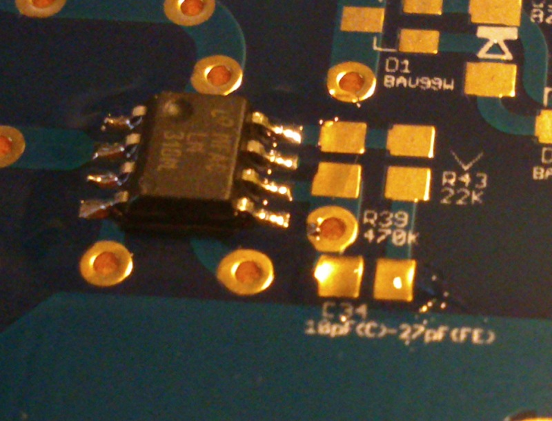

Joined 2005

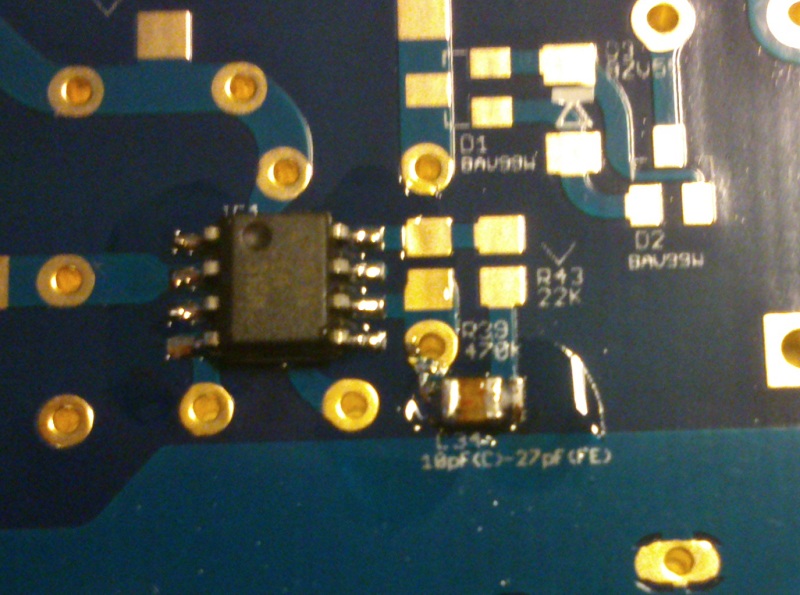

We then proceed with 0805 compensation resistors and cap, starting from C34.
Apply flux:
attachment.php
position the component and while keeping it in place with tweezers apply the wet tip to one side.
attachment.php
then apply solder and tip to the other end
attachment.php
Result
attachment.php

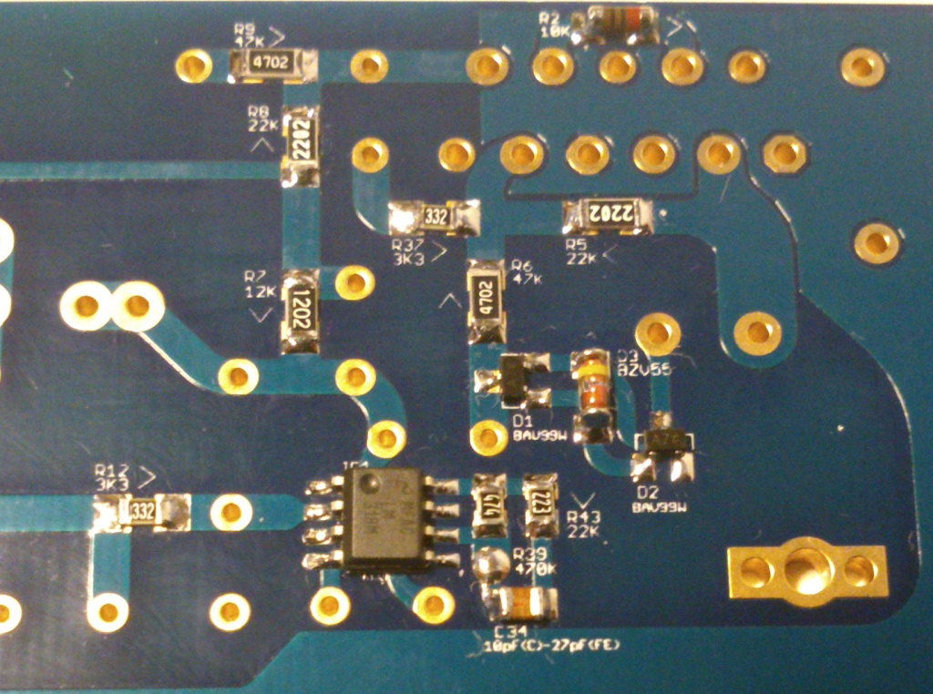

Joined 2005

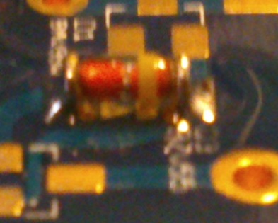

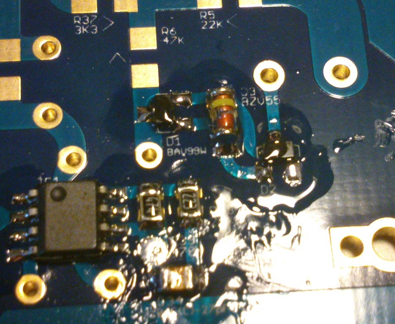

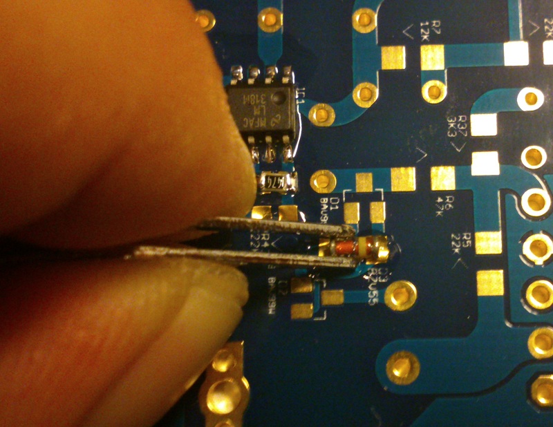

The next component will be the MELF diode D3.
As usual apply flux, keep it in place using tweezers
attachment.php
and apply the wet tip to one end (for melf you'll need a well wet tip).
Apply solder and tip to the other end.
attachment.php
Now, like we did for LM318 we proceed with D1 and D2 (flux, solder one pin while keeping the part in place with tweezers, solder the other pins)
attachment.php

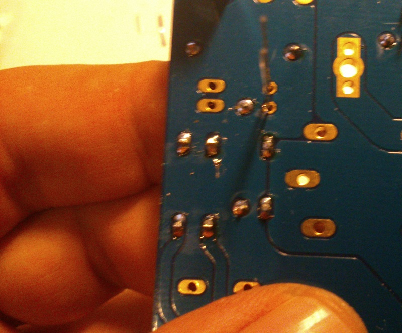

Joined 2005
Now the we know how to solder SMD parts and made some experience, we proceed with all other resistors (pay attention to orientation)
attachment.php
Note that 3K3 resistors are 0805 ones soldered on 1206 pads.
Mouser don't stock in this moment 1206 3K3 Susumus so in BOM 0805 ones are indicated.

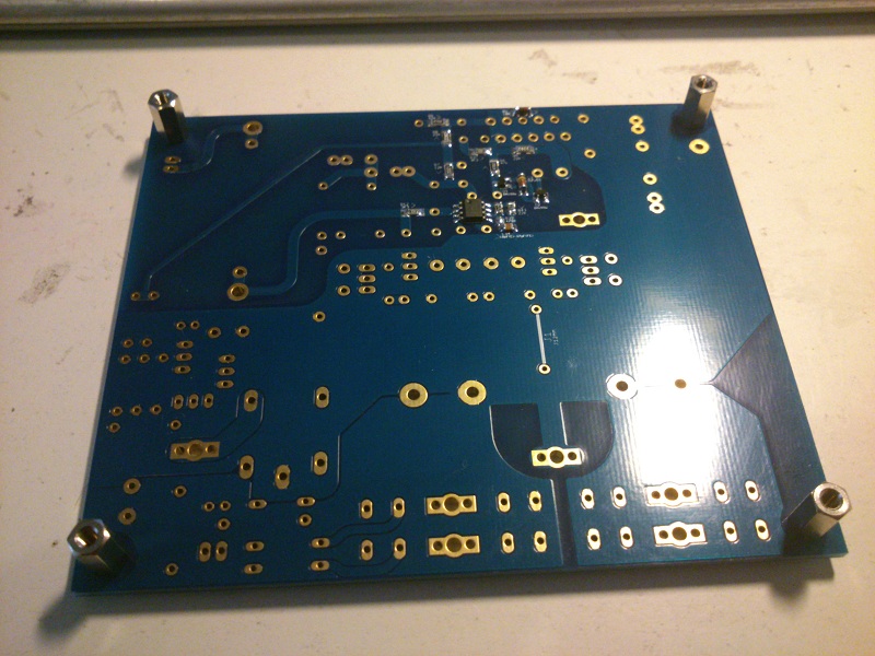

Joined 2005

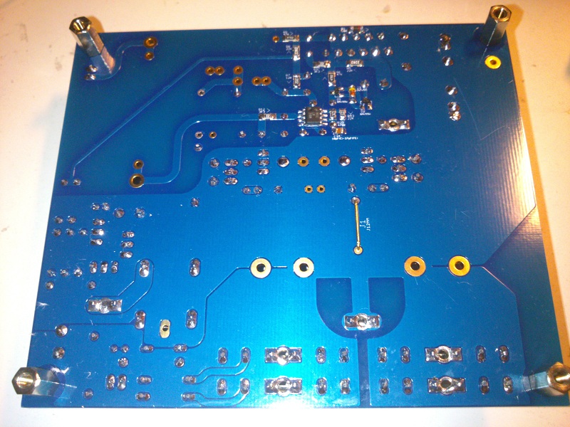

2 - Trough hole parts

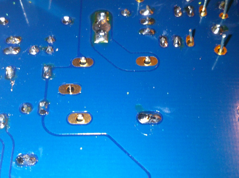

I suggest to mount standoffs before starting this phase.
Screws will stabilize board when it's reversed for soldering
attachment.php

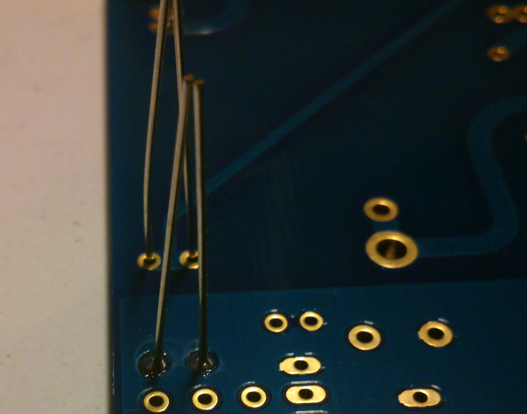

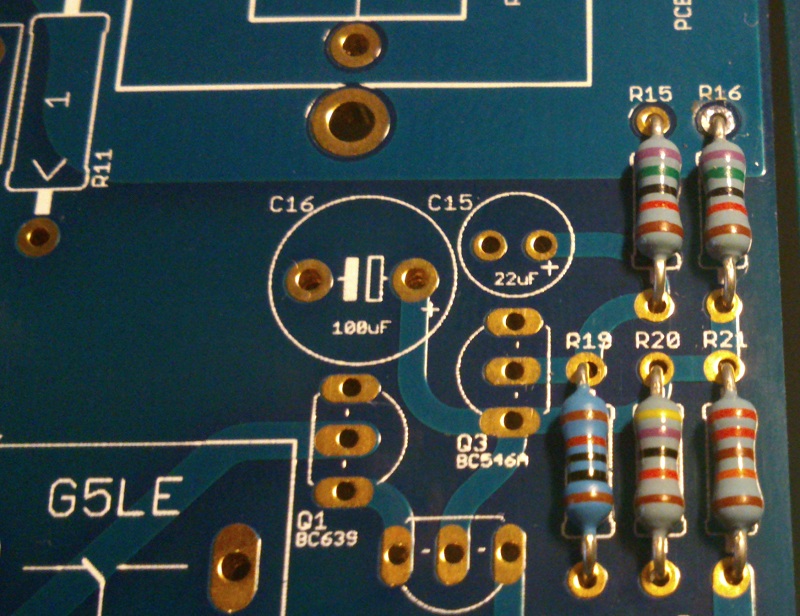

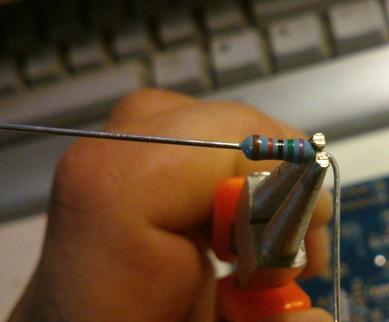

The golder rule is starting from lower profile parts so we'll start from DC protection resistors.
Using pliers to bend leads helps to obtain a nice looking build.
Solder parts on both boards, alternating them, it would be easier and let parts cool.
attachment.php

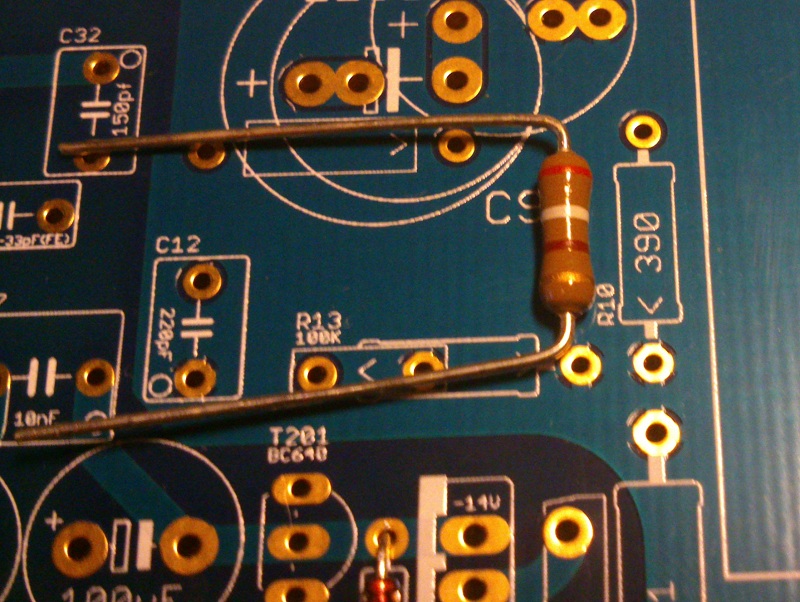

After bending leads mount the resistors in posistion and turn the board
attachment.php
Then solder first one side of both resitors
attachment.php
Then proceed with other side after the second board is done.
Proceed with other 1/4W resistors
attachment.php
Note that I've left unsoldered thermals pads, we'll do the same for all thermals so we can solder them later with a higher soldering temperature.
If possible keep same orientation, it will look better
attachment.php

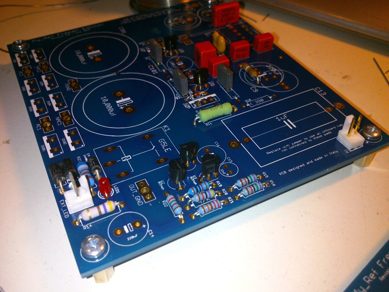

Joined 2005

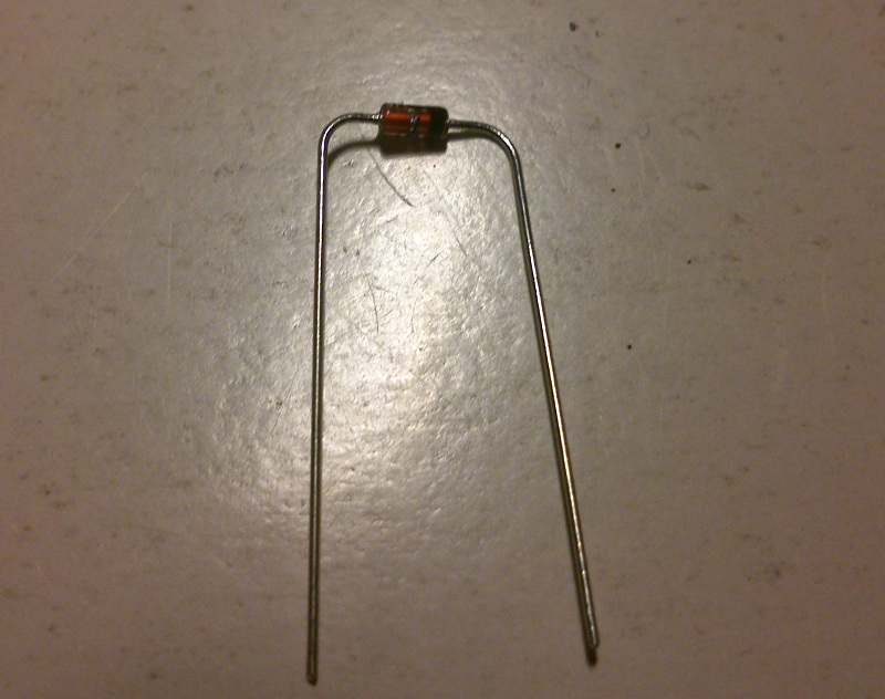

Next lower profile components are the 14V zeners, bend leads first
attachment.php
Use same tecnique used for resitors (mount parts, turn the board, solder one lead for each part, do the same on the other board, solder the remaining lead)
attachment.php

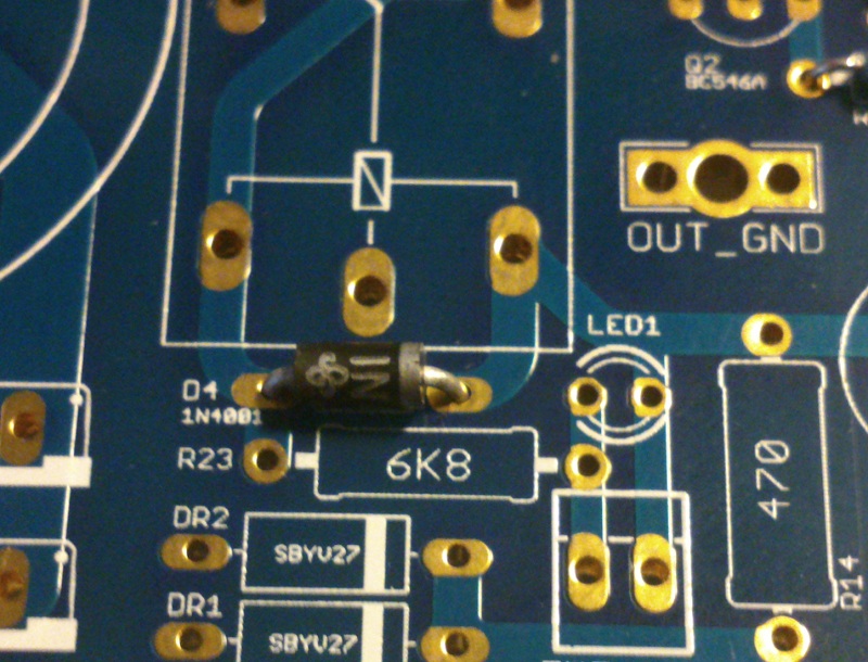

Then solder the 1N4001
attachment.php

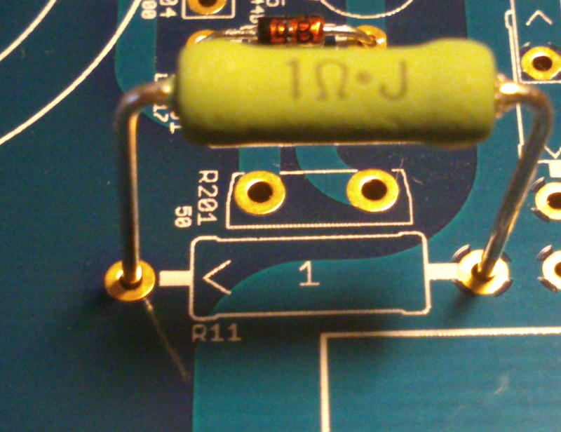

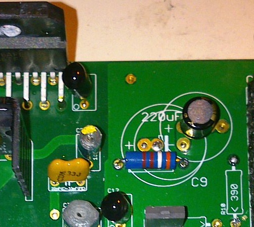

We can start with 1/2W resistors, from R10
Note in the next picture the correct orientation the gold (tolerance) band represent the point of the arrow.
attachment.php
In this phase you should choose which C9/R10 arrangement to use.
I suggest the new one
attachment.php
Note that Rikens have opposite orientation (tolerance red band goes opposite to the arrow)
attachment.php
KOA SPR orientation, note that the marking on board have same orientation of the one on resistor.
attachment.php
Note the thermal pad left unsolderd also for the KOA...

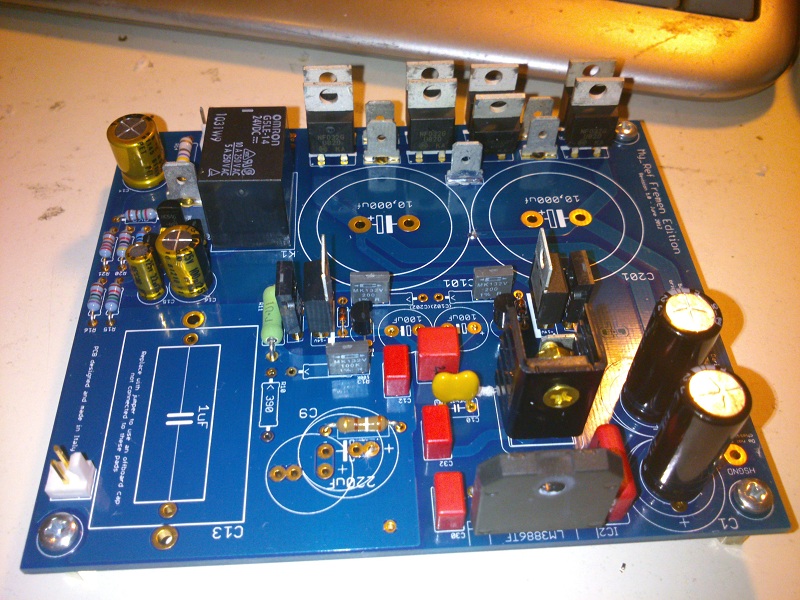

This is the lower profile parts soldering result
attachment.php

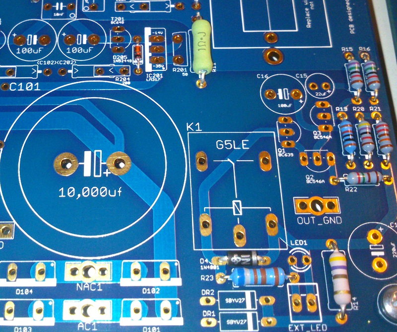

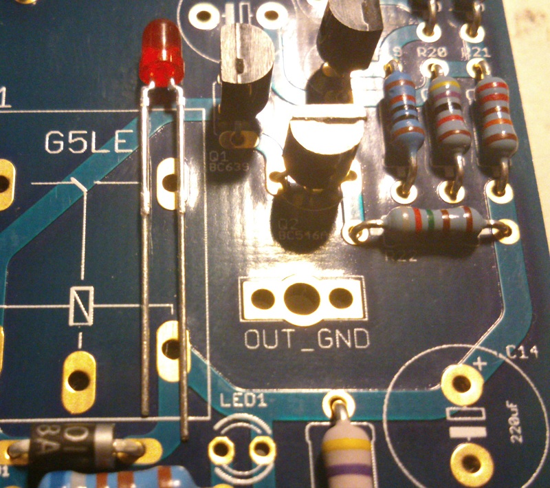

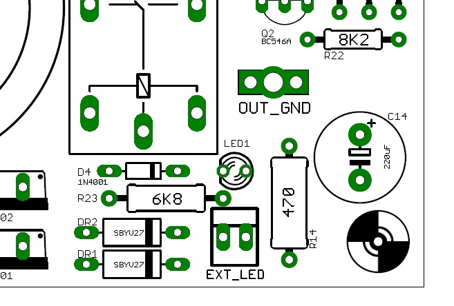

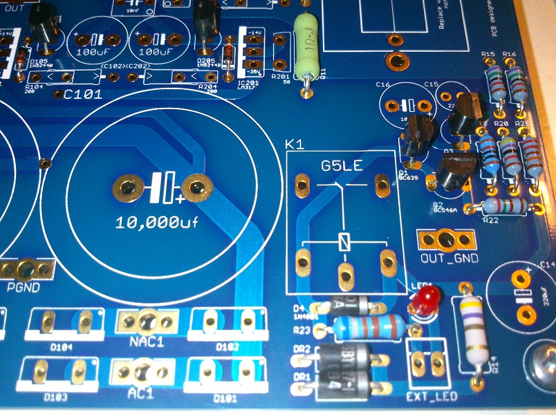

Next part to solder is the led.
Silkscreen it's not clear on led orientation, the silkscren file help us
attachment.php
Sadly the led in BOM doesn't have the dent so we should use leads leght to identify anode and cathode, the right orientation should be this one.
attachment.php
To solder it keep it in place using fingers
attachment.php

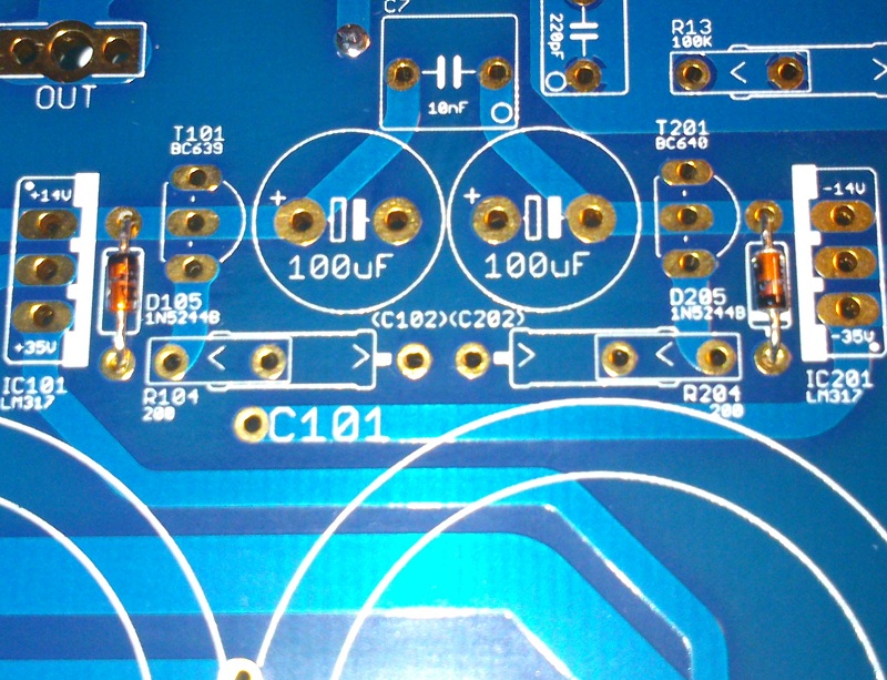

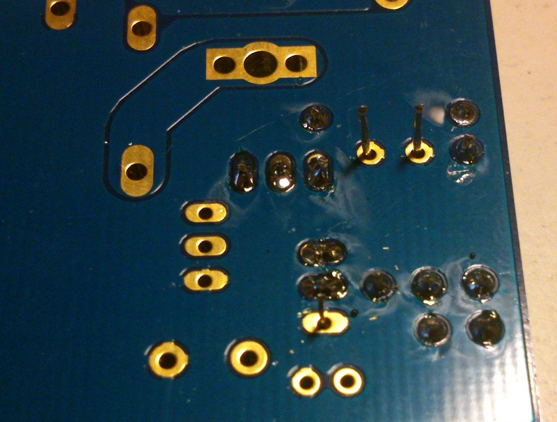

A further note on LED, traces of LED's pads and external LED connectors are parallel so for those that want to use the connector use same orientation.
Let's pass to transitors.
:att'n: there are 2 types of BC639 in BOM: BC639-16 (regulator) and BC639G
(DC-protection)
I choose to start from DC protection ones

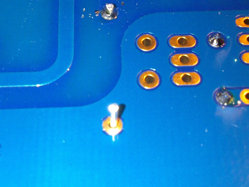

When soldering transistors solder one single lead for each
attachment.php
Then solder other leads alternating transistors so to not heat too much parts.
As usual leave thermal pads unsoldered.
attachment.php
attachment.php
attachment.php

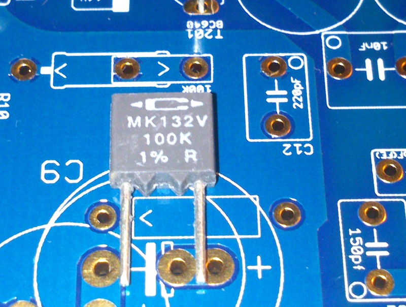

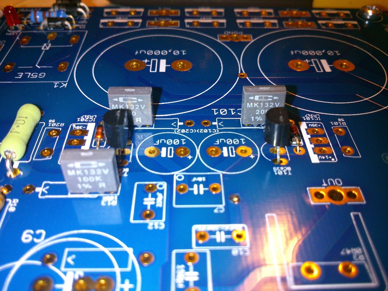

attachment.php
Note Caddocks MK132 orientation.
attachment.php

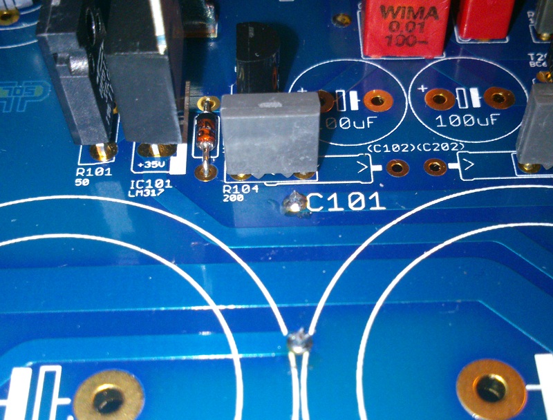

Note that R13 can be completely soldered from start even if one lead goes to ground since the bottom pad it's not directly connected to the groundplane.
R104/R204 ground leads are not soldered since on thermals.
attachment.php

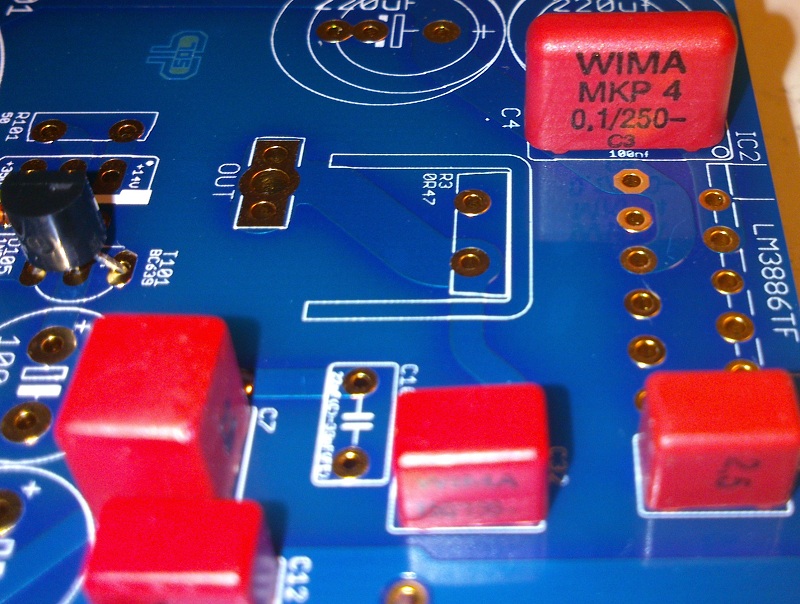

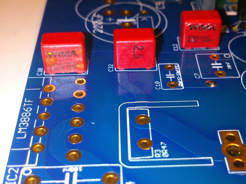

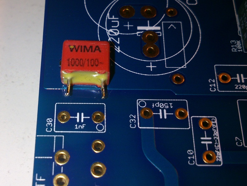

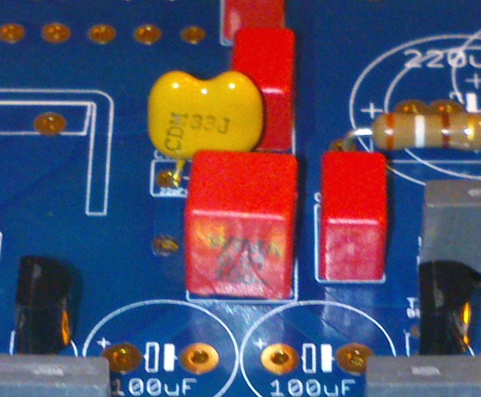

As it could be noted all markings on boards are oriented so that marked parts could be easily oriented.
See for FKP2s
attachment.php
FKP2s orientation
attachment.php
attachment.php
Then solder C10
attachment.php

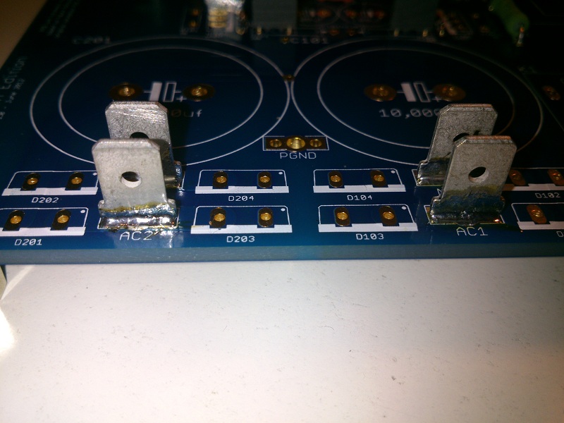

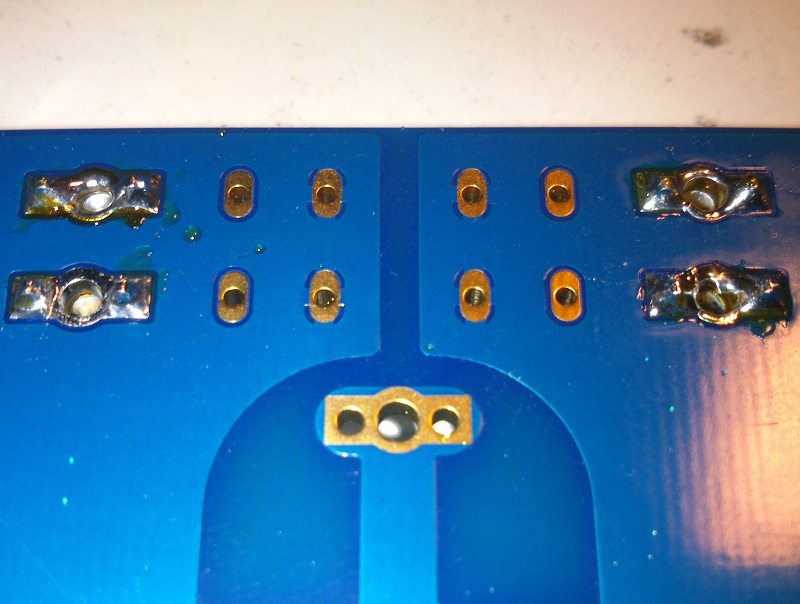

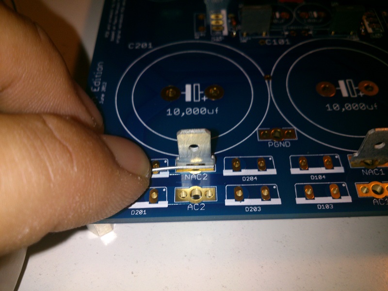

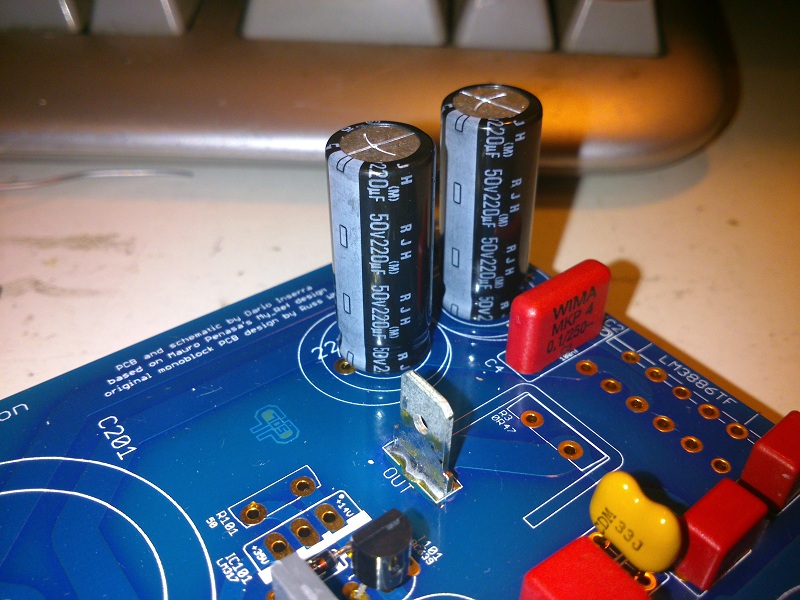

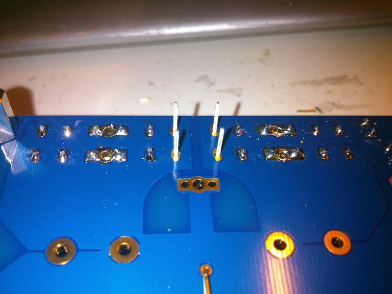

Now it's the turn of connectors.
:att'n: There are two types of Molex included in BOM tin plated (EXT LED) and gold plated (IN)
attachment.php
Then put in place faston tabs and solder on the upper side one end
attachment.php
attachment.php
To obtain this result tabs must be heated with the soldering iron to be soldered
Then reverse board and solder all the tabs:
attachment.php
A further note on faston tabs.
If the soldering temperature it's not enough to obtain results depicted in previous post defer their installation to when we'll raise soldering temperature to solder thermal pads.

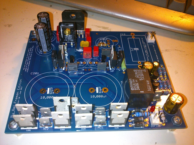

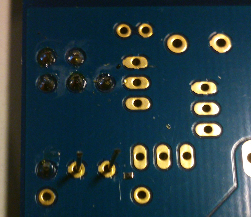

Now we solder C1 and C2:
attachment.php
attachment.php
As usual we'll leave thermal pads for later (we'll raise soldering temperature to solder all of them)

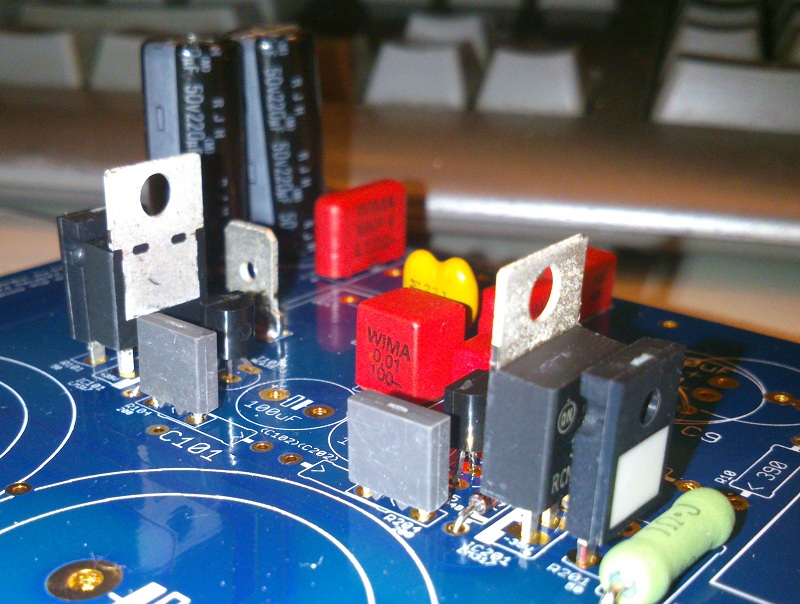

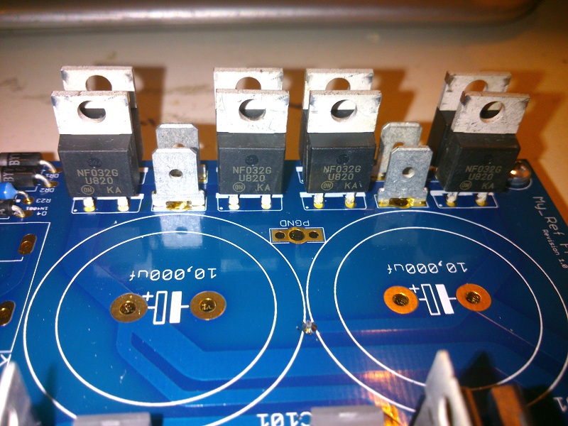

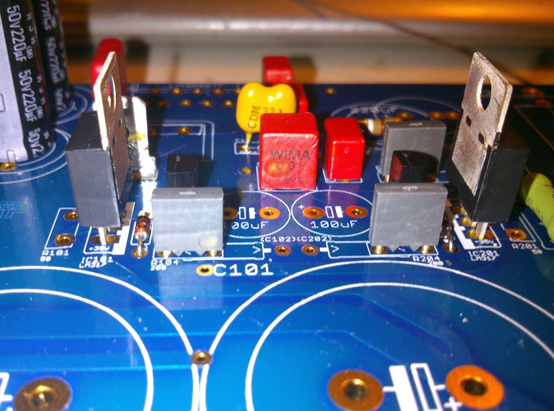

It's LM317s turn
attachment.php

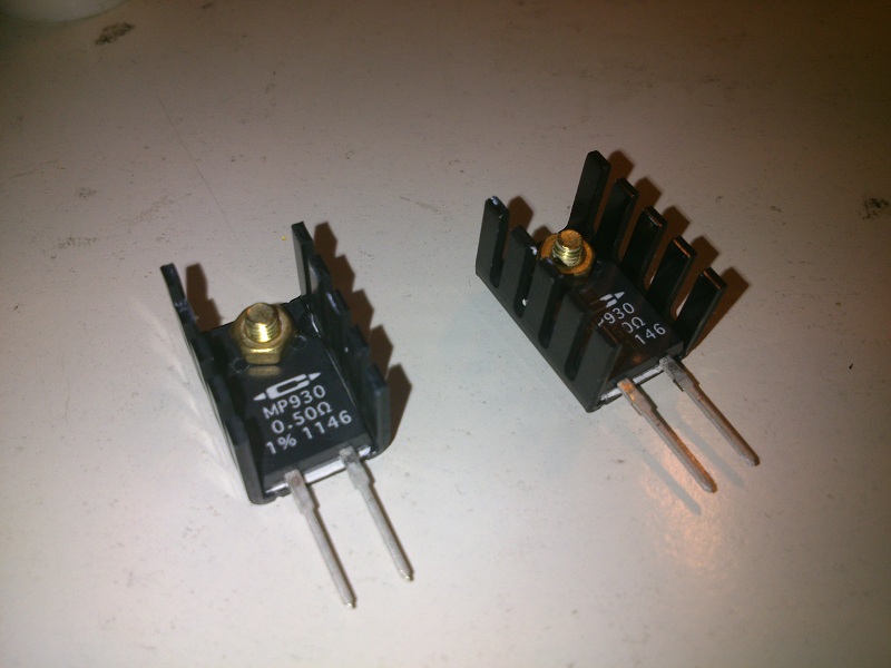

Now MP915s
attachment.php
Note that ceramic pads side goes on the outside for both.

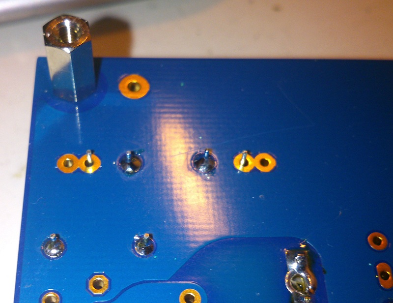

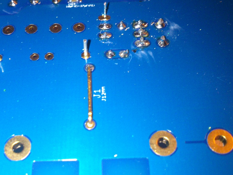

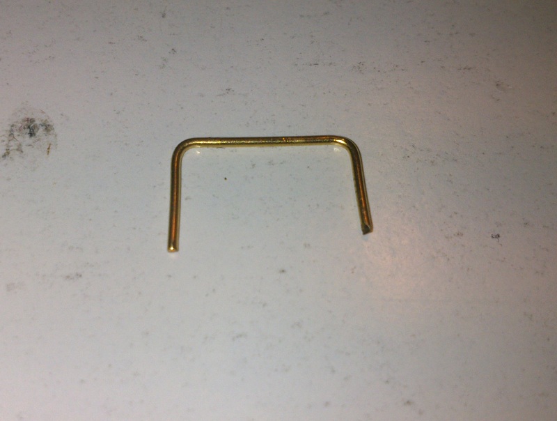

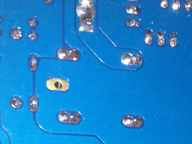

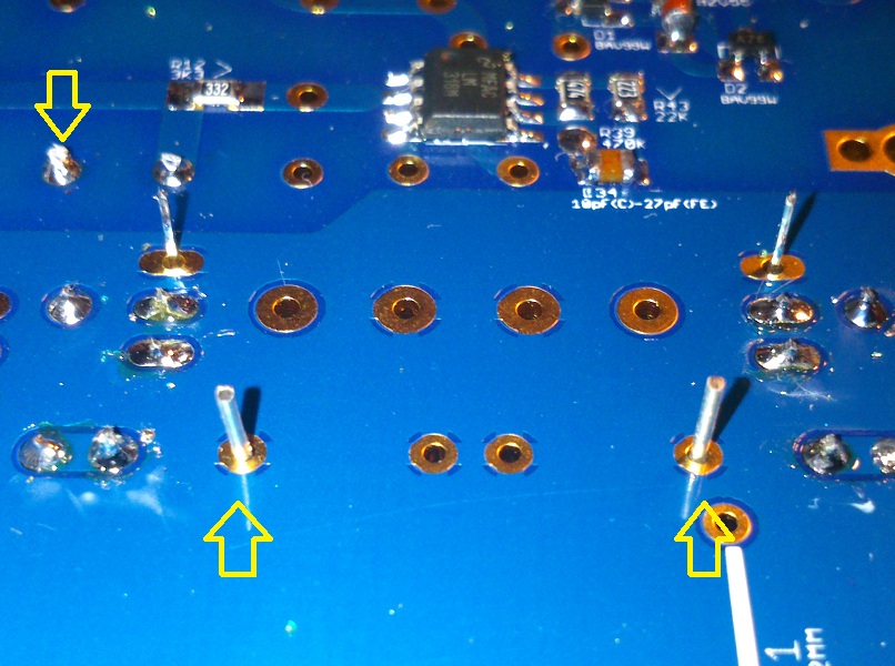

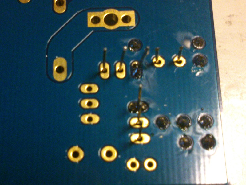

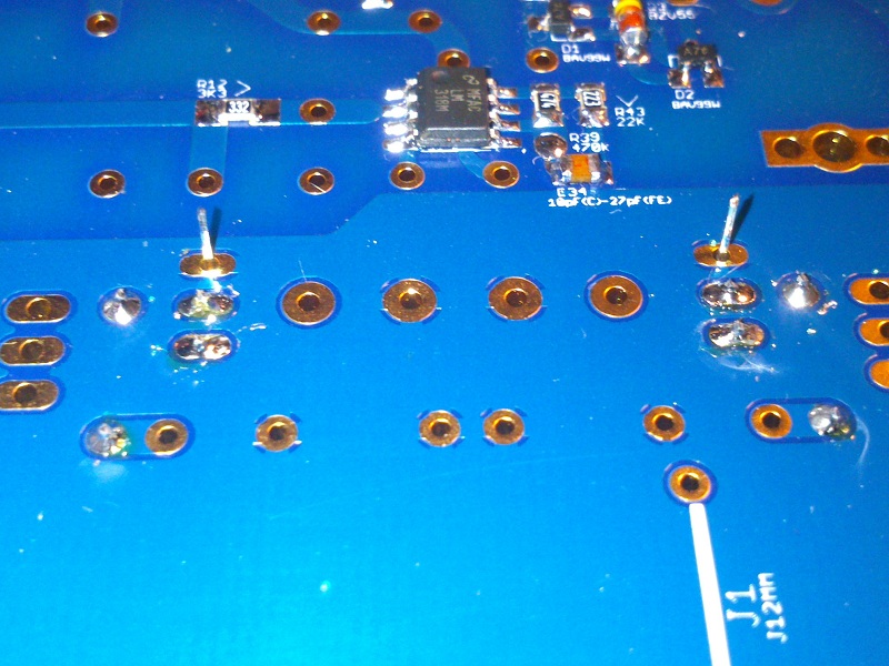

Now an essential component that could be easily forgot resulting in a not working amp or worse...
The unique jumper in the whole board (J1) which carries V-
Using pliers make a 12mm jumper:
attachment.php
If you bought Rikens you can use their gold plated leads after trimming.
attachment.php
attachment.php
Note that J1 jumper is installed in the bottom side and soldered on the upper side.

As usual thermal pads are left unsoldered.
Proceed soldering the relay, start from one or two pads while keeping it in place with fingers
attachment.php
Proceed with other pads leaving out the thermal one.
attachment.php

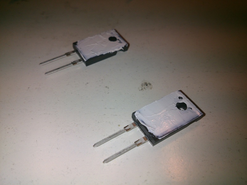

Prepare R3s with thermal compound (a thin layer)
attachment.php
And fix them to heatsinks using M3 screws and bolts
attachment.php
:att'n: M3 screws and bolts are not indicated in BOM but can be easily sourced from any hardware store. Prefer non magnetic materials like brass.
Solder R3 in place.
Now it's time to raise soldering iron temperature (min 350°C), solder all thermal pads we left in previous steps and trim remaining leads.
attachment.php
Note that in the previous picture I forgot to solder relay's pad...:eek:

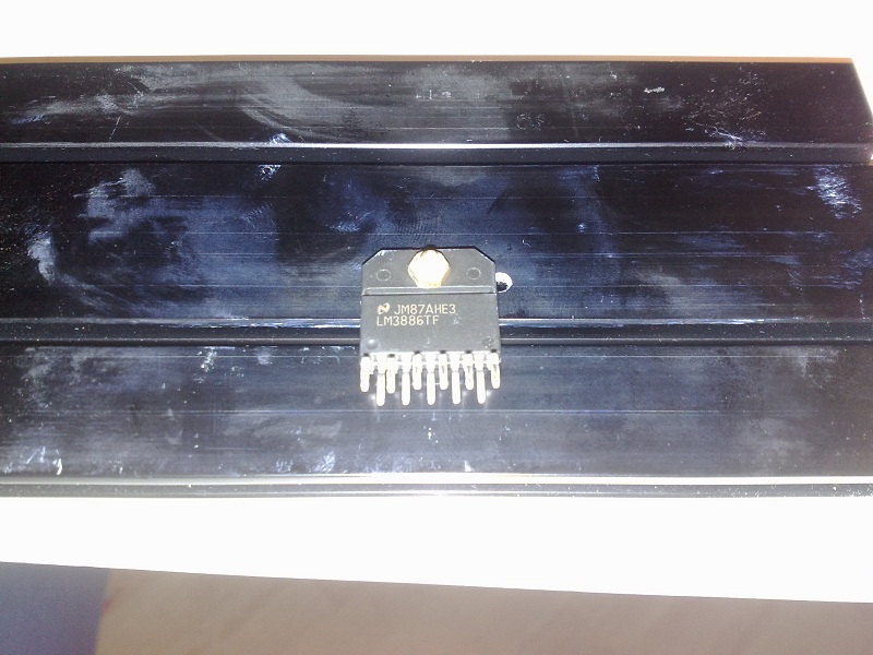

To solder LM3886TF take measures and drill heatsinks then fix the opamp to heatsinks
attachment.php
Then insert LM3886, together the heatsink, in place on board and solder a pair of pins on the upperside to keep chip in place.
Unmount opamp from heatsink, reverse board and solder all pins.
The nearly ready boards
attachment.php
attachment.php
The only remaining components, not covered here are the big smoothing caps and imput cap.

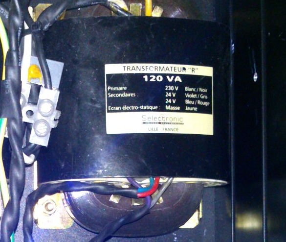

3 - Tranformers
As specced each module need a dedicated transformer to avoid hum problems.
Transformers must have double secondaries (2x25V, 2x24 also fine) and 160VA minimum rating (120VA minimum for the more efficient R-Cores).
You must find the label on transformer or its datasheet to wire them.
Selectronic R-Cores
attachment.php
With this type of label the first color in the couple is usually hot/phase, the second neutral.
So:
AC1 Violet
NAC1 Gray
AC2 Blue
NAC2 Red

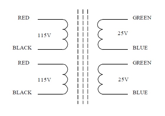

Antek AN-2225
From manifacturer datasheet:
attachment.php
With this type of label/wiring you can't distiguish visually each secondary from the other.
One way to do it is using a multimeter to measure continuity.
Members of the same couple will have continuity.
After you identified couples wire in this way:
AC1 Green1
NAC1 Blue 1
AC2 Green 2
NAC2 Blue 2
