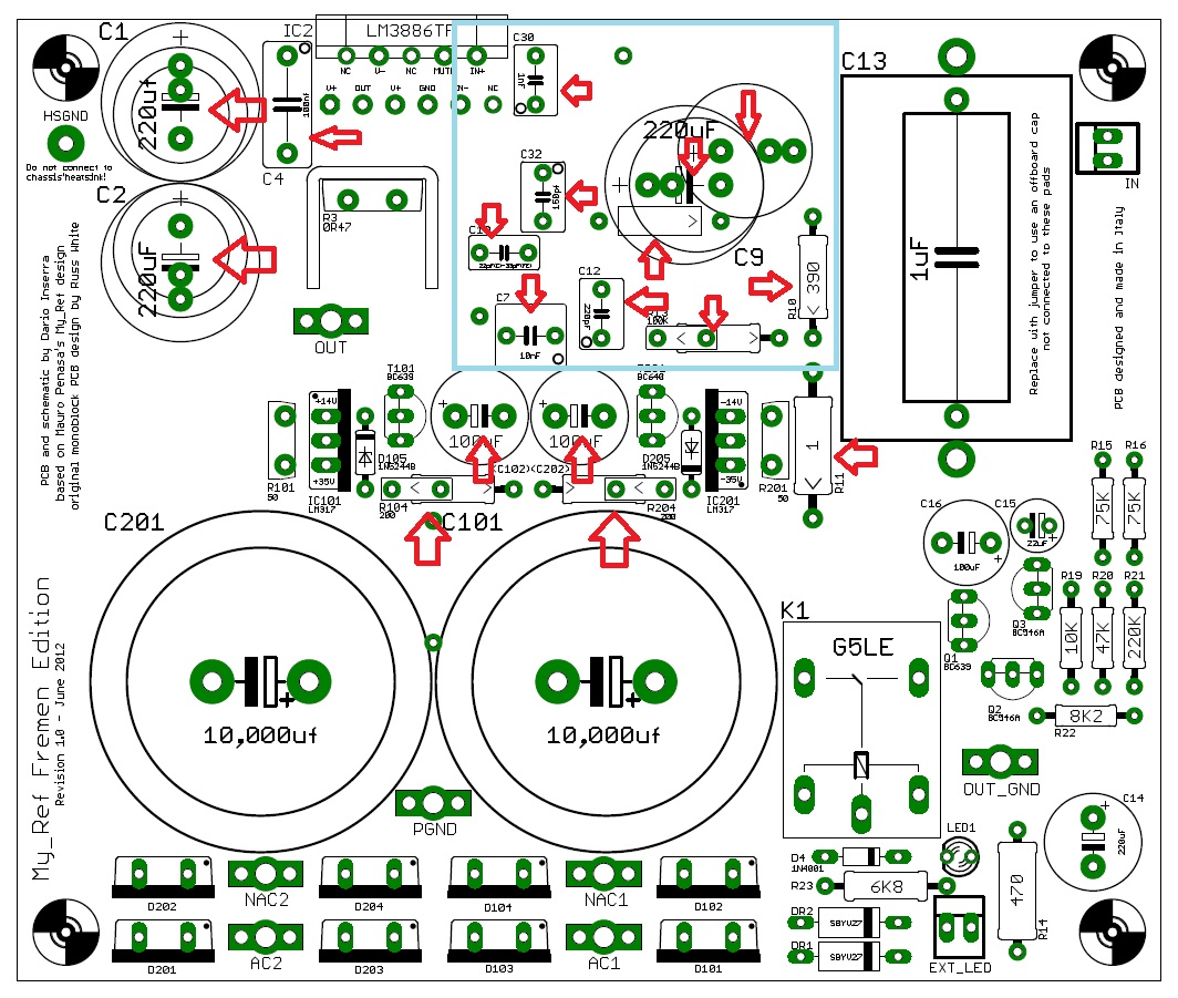

And a complete list of locations for sockets. this way a builder could lay out the socketed positions ahead of time and not have to worry about trying to remember the swap locations while populating the board. This way no leads get accidentally trimmed.
I have a list that I have been carrying around in my pocket of the locations that I have identified (it is written on a copy of the pcb) but I am sure I missed a spot or added one.😀

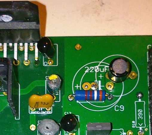

Optional capacitors
Otional capacitors C102/C202 are there just beacuse there was space for them but I wouldn't use them unless stability problems arise.
The amp sound better without.

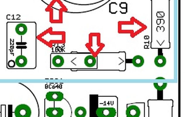

advantage and disadvantage of the C9 - R10 choice
Functionally both arrangements are identical but the new one makes the circuit less prone to pickup noise.
To my ears it also sound better... 😉
But experimenting with both arrangements is encouraged to confirm the final choice.
alternative compensation capacitors
Rev C compensation is the original one developed by circuit designer Mauro Penasa, it's a no brainer and sounds great.
FE compensation has been 'guessed' by me via trial and listen and sound more refined in the high range with a tighter bass and (much) wider and deeper soundstage, LinuxGuru simulations and several months of use proved it's stable.
FE compensation can be considered experimental but it's the one I suggest to use.
orientation of premium parts
Amtrans are oriented exactly like FKP2s
150pF KP1834 have a yellow mark (see picture)
I don't know how much it can be useful since it depends on what you want to experiment with...
BTW
attachment.php
The area in the cyan rectangle is the most interesting to explore.
The positions that should be socketed for sure are C9 and R10 to determine which C9/R10 arrangement it's the best one.
Builders that don't want to experiment are encouraged to use the alternate arrangement

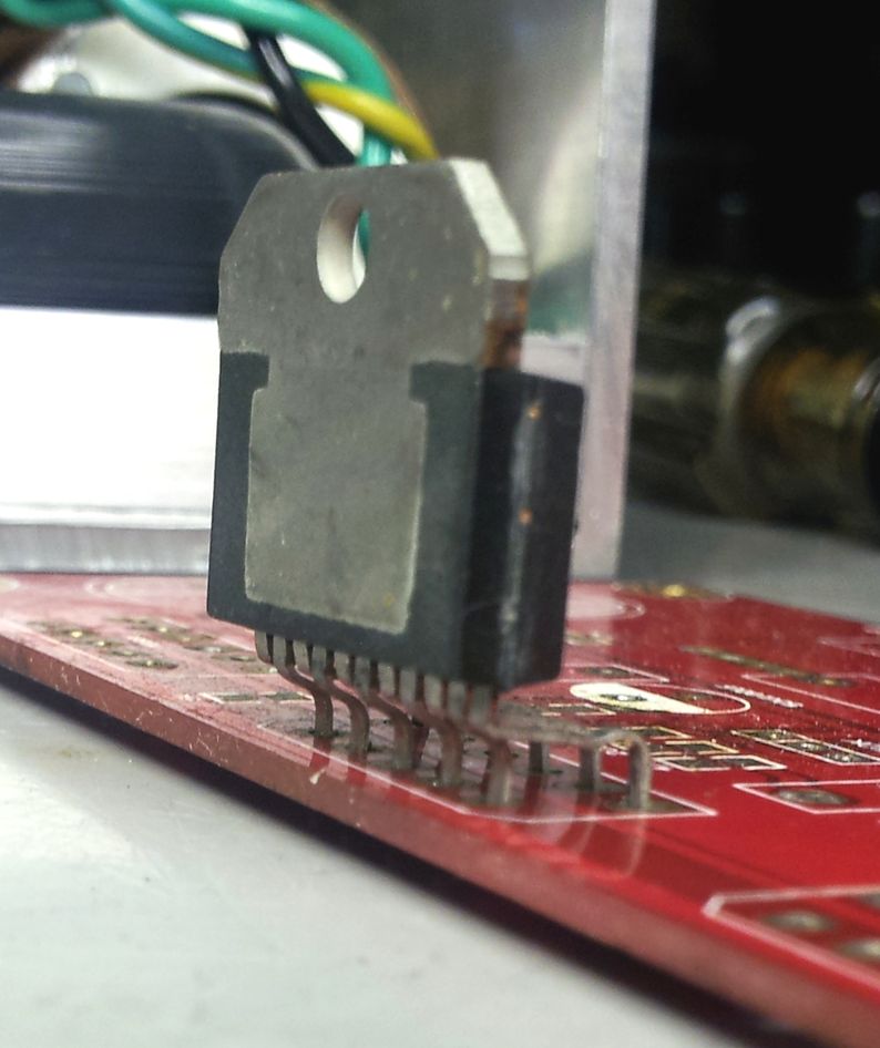

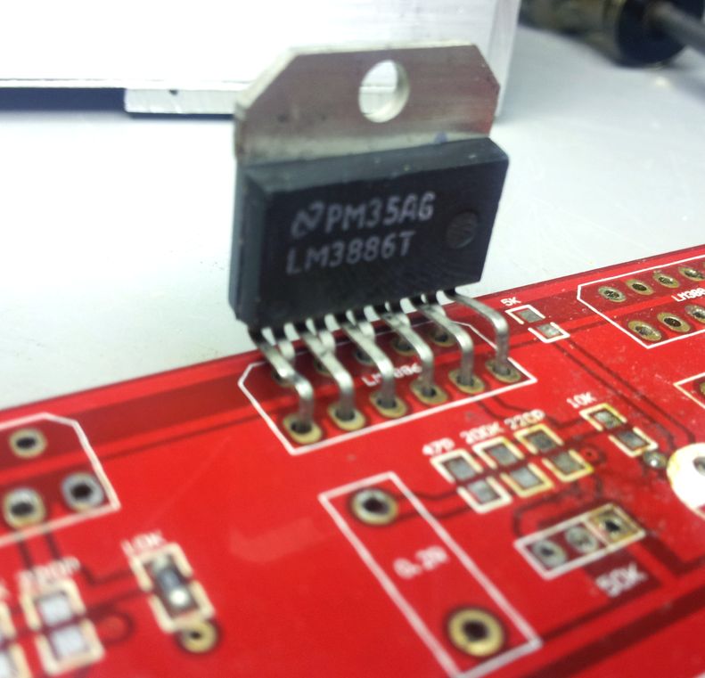

Here is a note on mounting the LM3886 as shown in post #18. This came up back in the MyRef V1.2/V1.3 threads. Minor alignment problems can be corrected by insuring there is a little stand-off from the board. When making measurements to locate where to drill the hole in the heatsink, a spacer like a matchstick or toothpick will ensure there is some flexibility on the pins - which need to protrude completely through the holes - but horizontal of chip leads should not be flush to the PCB.
Having the standoffs mounted at this step is important. Also try to think about the need for any clearance between the bottom of the heatsink (if needed) and the chassis that will house the amp. Spacers may be useful here also. Dry/cold fit everything before drilling and/or applying solder.

The LM3886 Eagle component I've used in RC boards it's a new one derived from National one, different from all previous, and have exact holes.
It will be easier to desolder the part if needed and LM3886 will slide in without alignment problems.
For the same reason the LM3886 will no more stand up without soldering like in Bob's pictures.
Also I've aligned component so that the LM3886 edge will have at least half millimeter from board's edge so that it should adehere perfectly to heatsink.

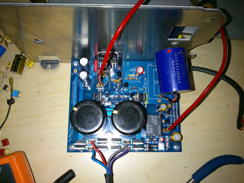

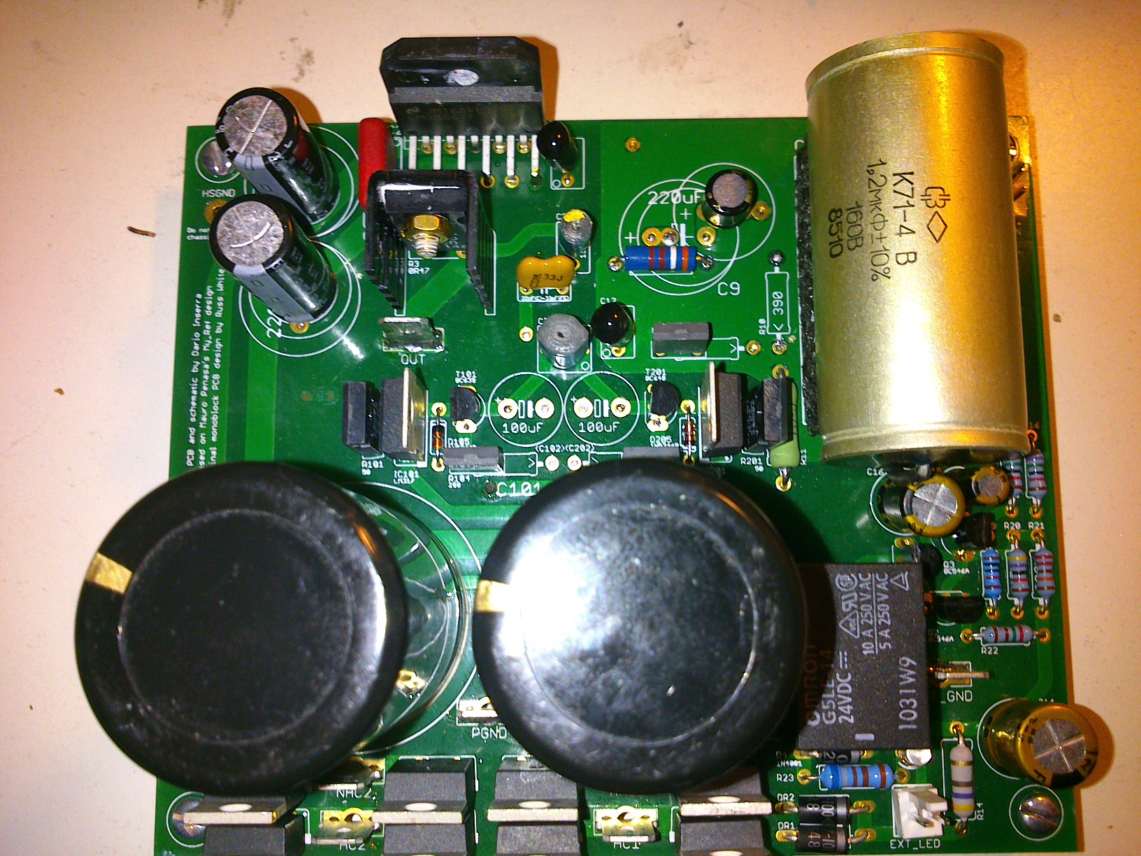

Boards up and running
I've finished my build, both boards are playing music in this moment 🙂
attachment.php

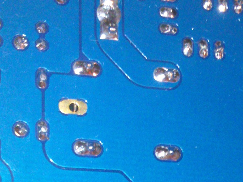

I've had some trouble with one module though...
It power up correctly, relay was clicking but it was mute....
Guess what was the cause?

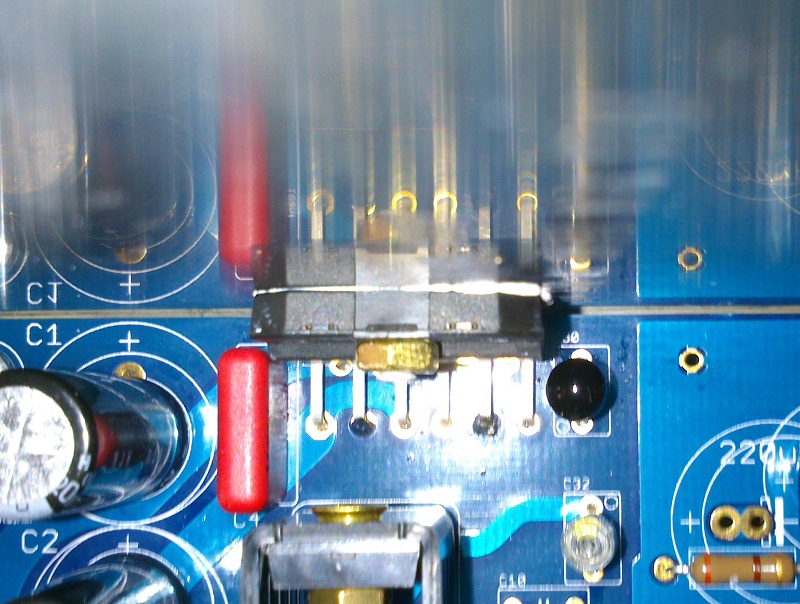

An interesting demonstration
attachment.php
As you can see, thanks to the new eagle object and positioning, there is clearance between board and heatsink. 🙂
Just to double check - did anyone buy the non-insulated LM3886? I don't know if they are even available new anymore, but could have been purchased on eBay. Those need an insulator. That is what is shown in the photo on post #29.
