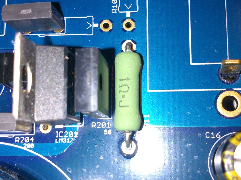

KOA SPR orientation, note that the marking on board have same orientation of the one on resistor.
Sorry Guys but this part of the tutorial is WRONG.
The correct R11 orientation is this one:
attachment.php
The markings must go in the same direction of the arrow like all other components.
Only on capacitors I've reoriented silk screen text, not on resistors.

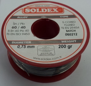

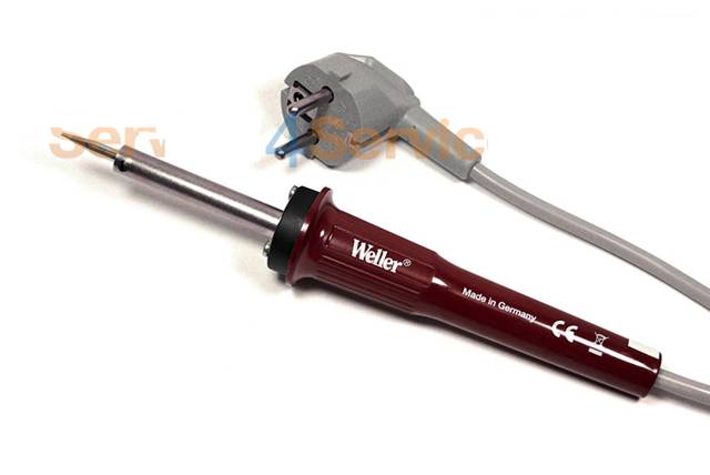

~~It is worth mentioning that excellent solder is essential~~

Actually a mix, all resistors are from recommended list, except for the 0R47 output resistor. I also used LM317TG, as you can see a MKT cap, silver micas, paper cap, etc.. I used EPCOS for the reservoir, MUR820 and SBYV27.
