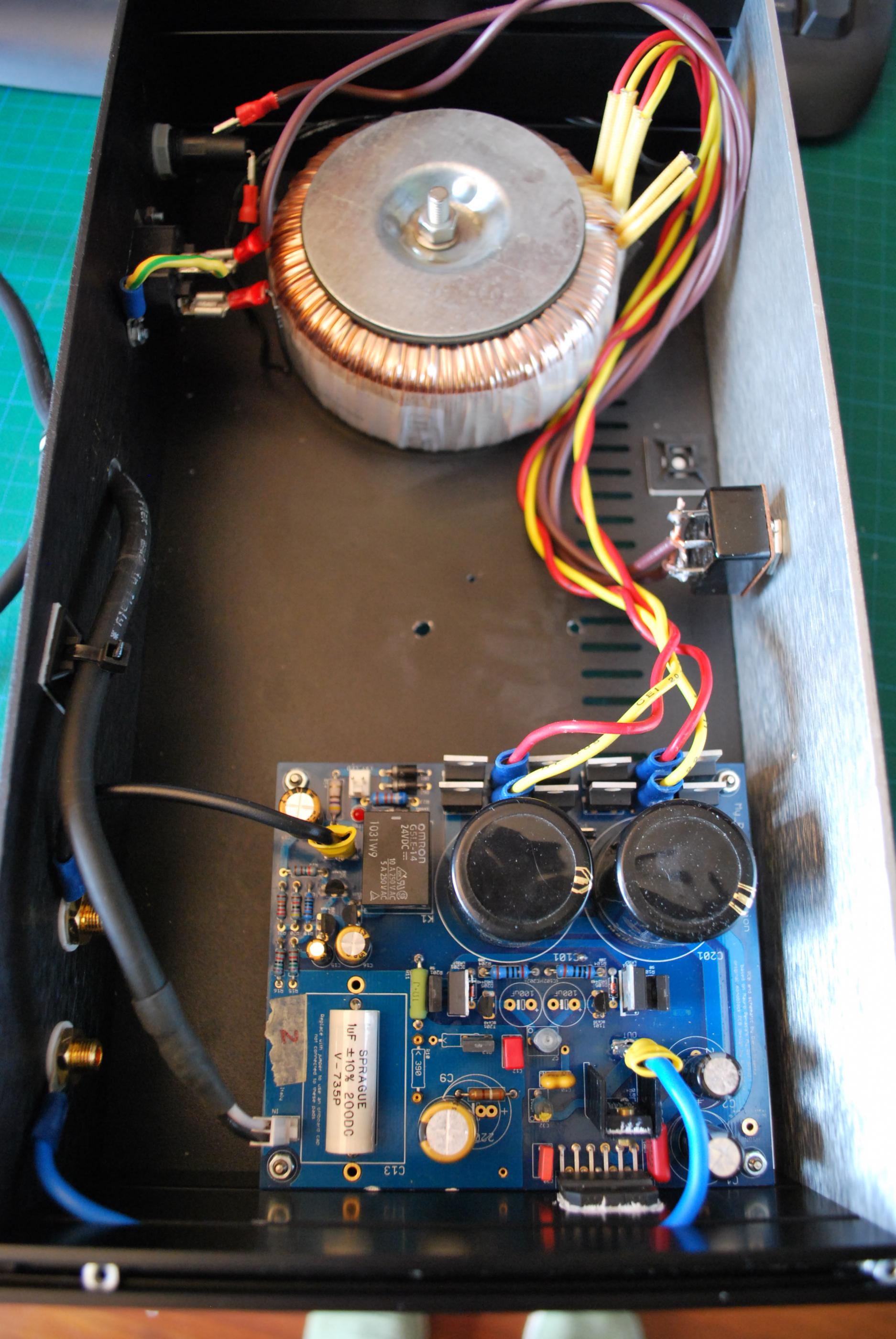

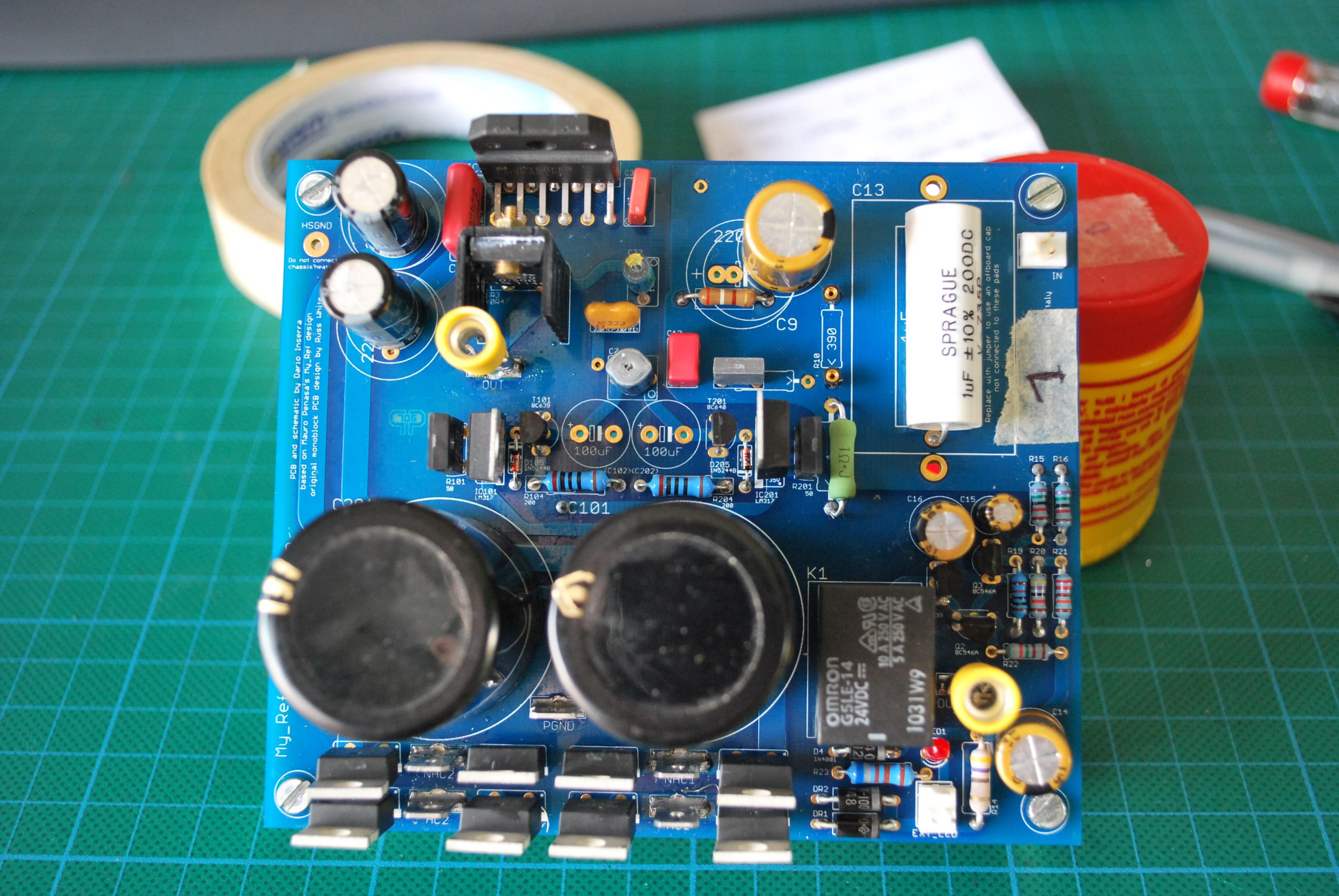

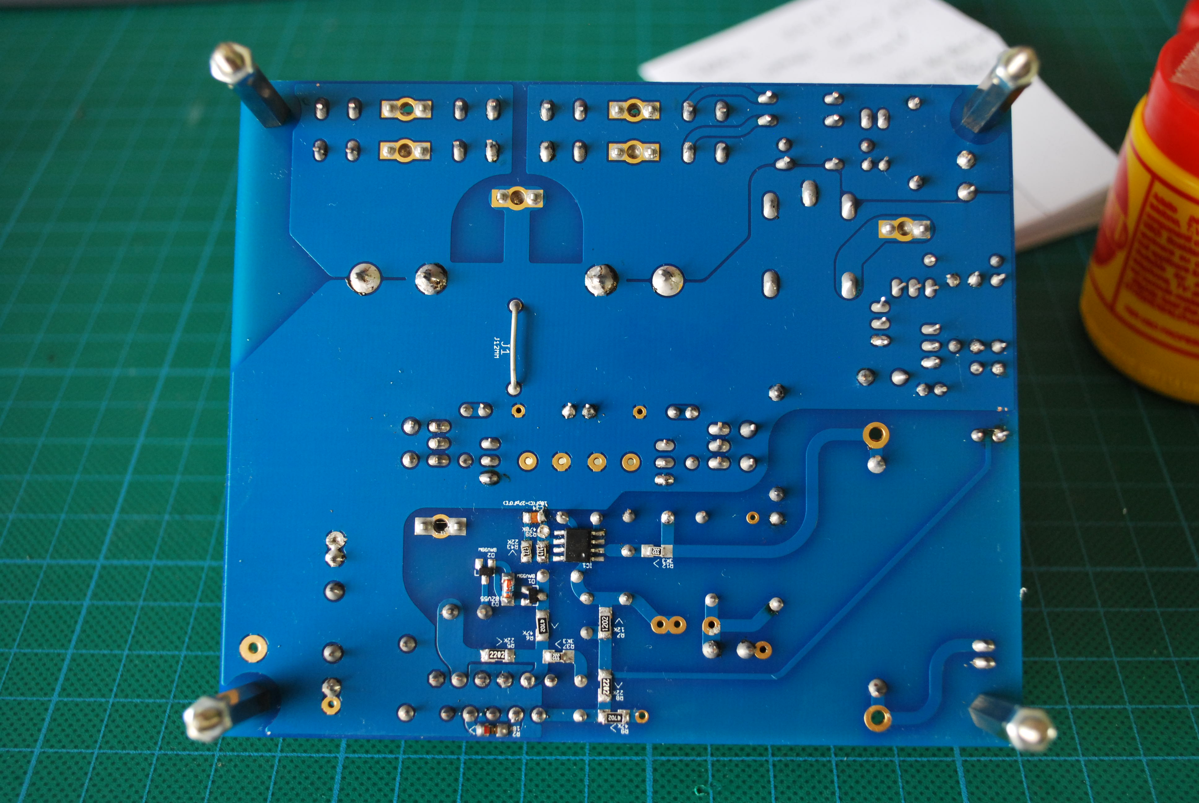

Yes, see the attachments, I've taked just before the front leds installation.Do you have any pic of the interior or of the build process?
