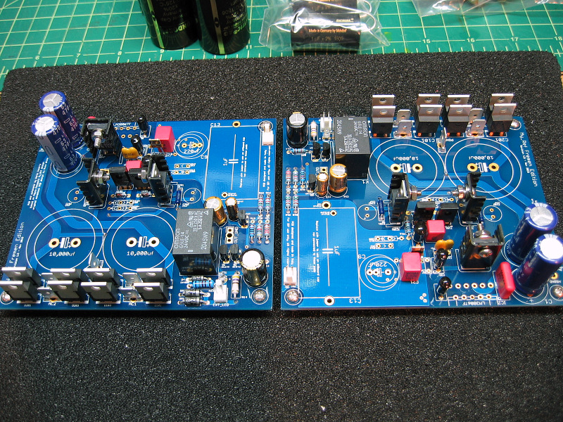

Boards from the 7th GB. Populated 90% yesterday by coincidence, so will make a few changes based on the current recommendations. E.g., RN55 for R12, R13, R104, R204 and Nichicon for C1, C2, C9. Parts already ordered. Appreciate the work Dario puts into this. I have high expectations for this build!
Nice selection
But you should have posted it on the build thread.
Thanks, let us know your impression on build thread
