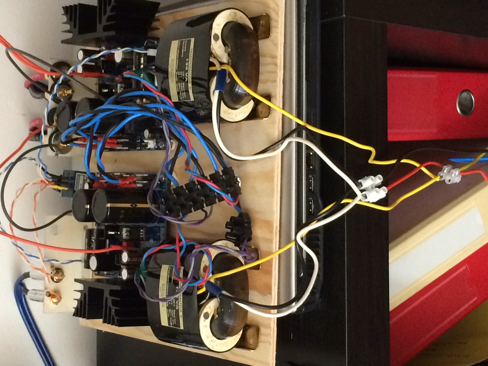

...in tested phase, cabling and case not perfect ... KZ/C9 and plays wonderfully already!

I'm curious. Why did you leave out C21?Today I've finished my test build with the plain industrial BOM:
At the times of the original My_Ref Rev. C Russ White introduced C21 as suggested by Mauro Penasa as a 'possible' improvement.
Later most builders used Black Gates that didn't benefit from that bypass.
I've re-introduced C21 on Fremen Edition boards only from revision 1.2 as a way to 'fix' the lack of availability of BGs at decent prices but neved tested it.
This time I did and found that, while it adds a tiny bit more of cleaniness it somewhat messes up sound 'coherence'.
IMHO the damage was far greater than the advantage so I've ditched it.
From next revision it will be removed completely.
