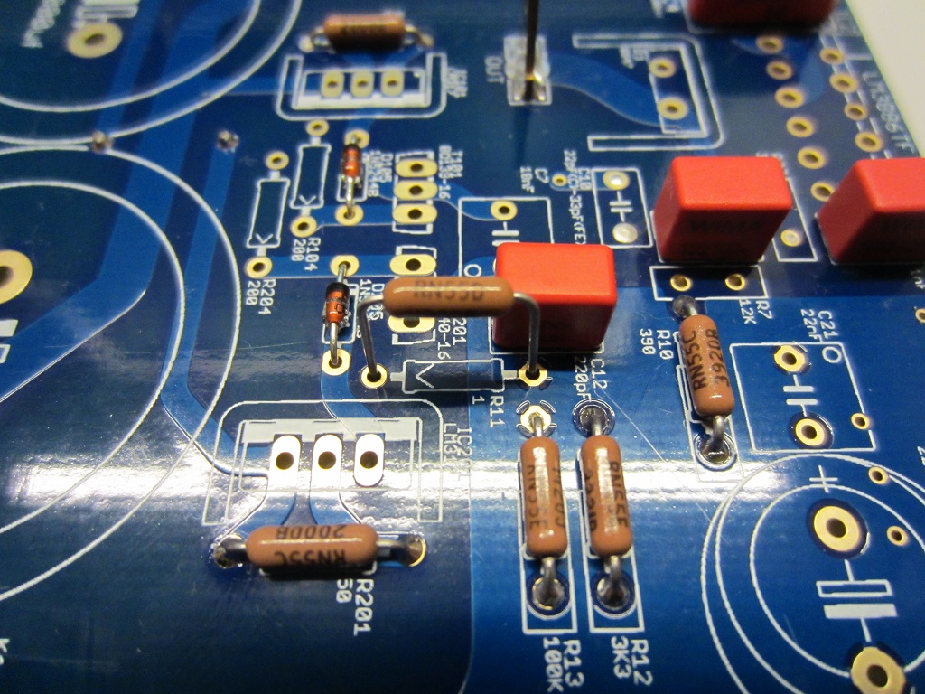

Important! (TH resistors orientation)
Until I update the tutorial with 1.5 and up images and notes one important thing.
When PCBs went to manifacturing R11 was a KOA MF1/4 resistor so on the PCB it's indicated orientation for that part.
In final BOM it's a Dale RN55, which have reversed orientation, so indication on PCBs for R11 is wrong, it should be mounted oriented this way (resistor is raised only to compare orientation):
attachment.php
Other resistors have correct orientation markings on PCBs since they were, initially, Dale PTF56 which have same orientation of RN55s.

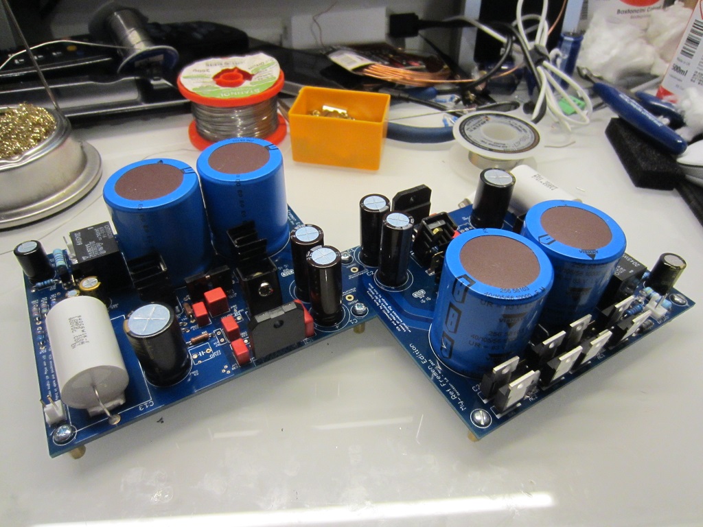

Today I've finished my test build with the plain industrial BOM:
attachment.php
It obviously works perfectly but I've had the final confirmation that there's a problem with the Mouser cap for C9...
It sounds actually different from other KZs I've at home and that I used for BOM's tests.
In particular, after burn-in, it exhibit a strange midrange coloration which make it a bit too much laid back and with a larger than life soundstage, result is still good sounding but like you're in a room with excess reverb.
A tiny hint of that coloration was present also on the other KZs but not annoying at all, with Mouser part it's sadly different.
I'm sorry but I wouldn't expect such a different behaviour, I would suggest to use alternates in BOM like Black Gate STD & PK, Cerafines and Silmics Black/Gold (NOT Brown/White).
The amp sounds really good even with the KZ but when it's replaced by alternates the difference, and added enjoyment, is clear.
