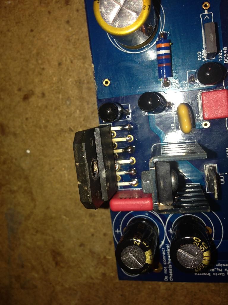

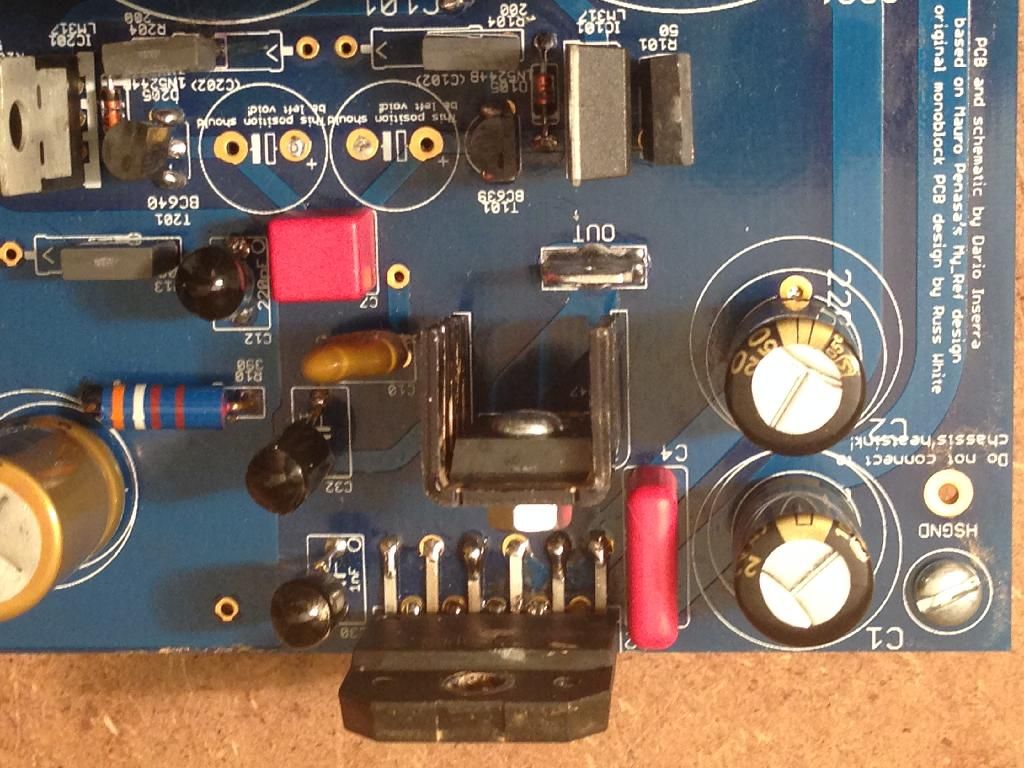

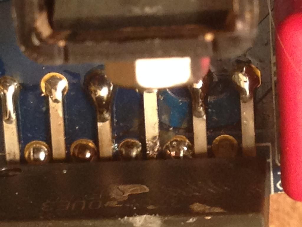

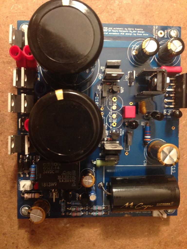

Finished building the 2 modules, 1 is good, the other wel.... 🙁
The relay kicked in and then 2 seconds later a big bang and a little spark. Immediately turned it off and inspected the board.

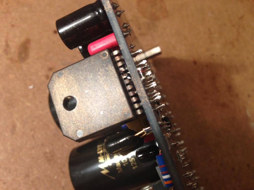

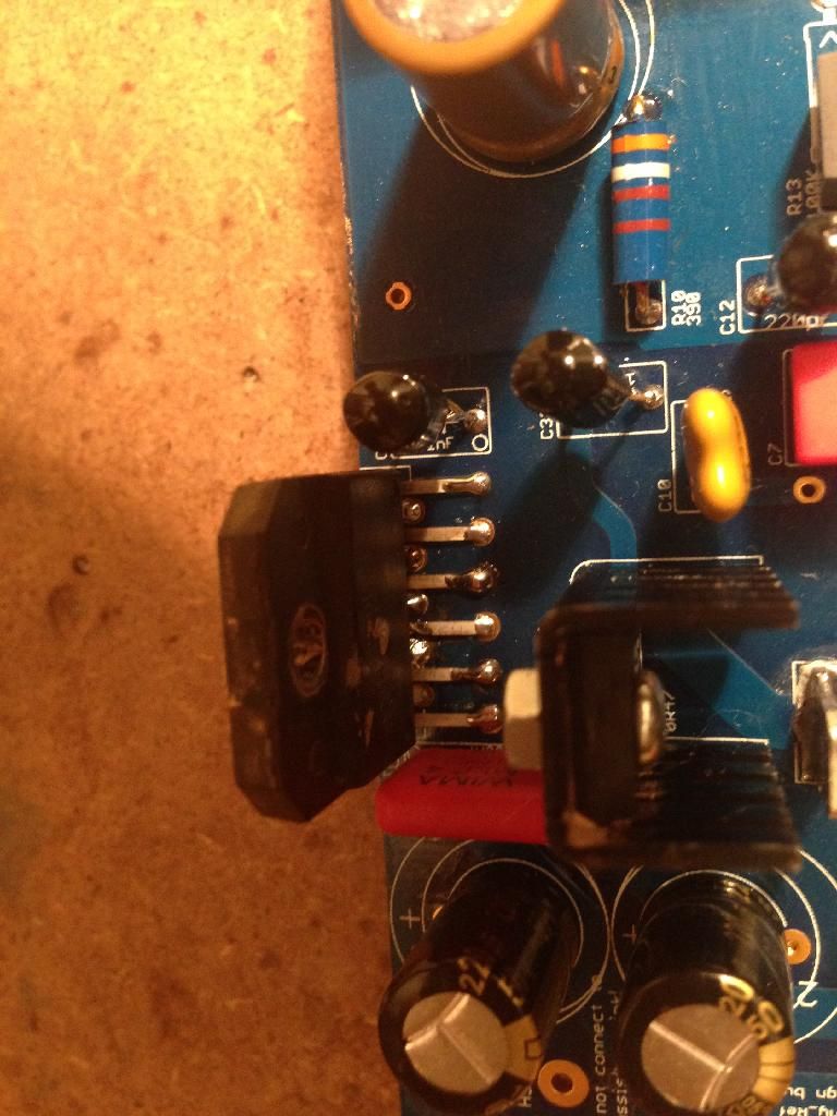

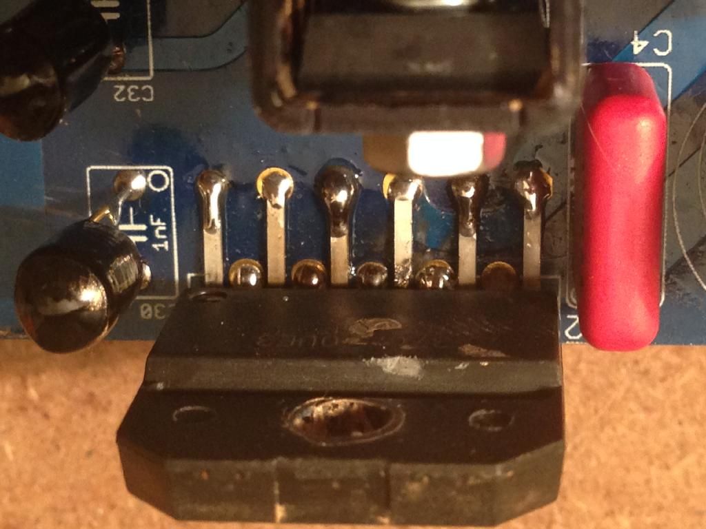

The 3886 is stuffed, pins look burnt. It almost looks like 2 pins have been soldered together. I could not tell you whether that was due to the spark or not.
Am about to order another chip from mouser, however i may hold off until someone can give me some pointers. The last thing i want to do is put a new chip in and see it go bang again.

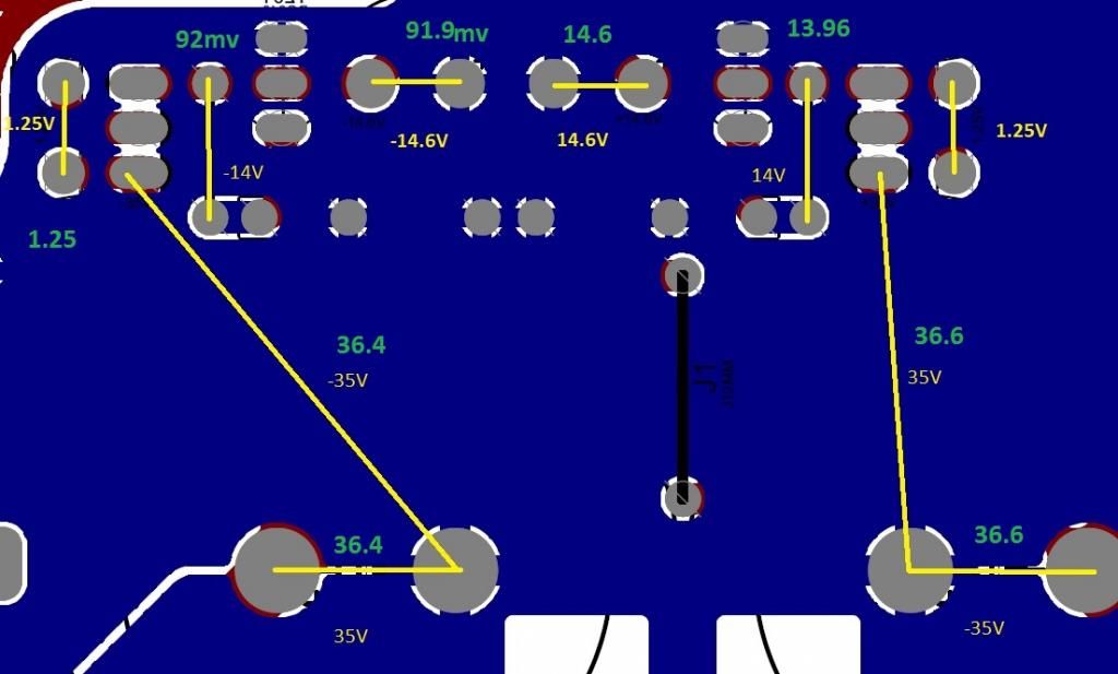

Searching through the 100+ pages. I found i a set of test points that Dario gave to Voxxonline.
Does this suggest that IC101 is dodgy.
First desolder the LM3886, repeat measure.
If values don't change, desolder the LM318, repeat measure.
If values don't change remove T201 and measure D205, if it's not -14V replace both with new parts.
Now measure again, you should have correct values.
From there double check every joint for bridges to other pins or ground plane.
Measure resistors and caps on PS and signal paths, since there are no active parts mounted you should be able to measure most of them on board.
If all seem right solder a new LM318 and a new LM3886, take care to not use too much solder, your joints are too rich.
Cross your fingers and power on.
It could be a good idea to use a Dim-bulb Radio Tester for the first power up.
Will the 1.4v difference where 35v should be make a difference?
No
....... take care to not use too much solder, your joints are too rich.
I hesitated to comment because you can't get better help than what Dario is offering. I just want to reinforce the need for great care in inspecting for tolerances. I recently discovered a long standing problem on another amp was due to a mounting screw with a wide head just barely touching the bare copper on a negative power rail pad. It was found only when the amp was tested with that PCB floating - away from the chassis. I had cleaned and reflowed the solder on that board at least six or seven times.
So please make full use of good light and a magnifying lens as you reassemble. A short or bridge can easily hide in plain sight.🙄

Thanks Dario, that helped alot.
As long as 14.6v is acceptable i just need to replace T201, LM318 and 3886. Do you think i should replace D205?
You're welcome 🙂
It should not be necessary.
But if have to pay a significant amount of shipping fees to source parts maybe it would be convenient to buy also the zener and the LM317 too.
