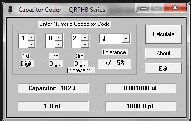

Here is a slick little tool also via Google.
  • capcoder.zip
    capcoder.zip

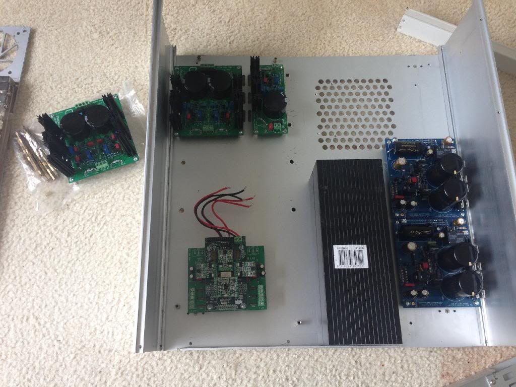

Here is my build so far, repurposed Originae X10 HTPC Case. Even though it was a horrible and loud system the build quality is amazing, front plate looks machined from a single inch thick aluminium block.
Front and back will have new plates cnc'd at my brothers work.
Original idea was to have the buffalo dac, MyRef and Tortuga pre all in one case. But its going a very tight build considering there will be 2 x shielded 225va, 2 30va and 1 maybe 2 15va transformers.
And thats just to fit it all in, i still have to worry about hum and noise between it all. Could very well go separates instead.
Cool project. Just curious, what is that black thing in the middle?

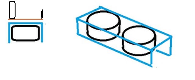

Some of the guys who wanted small cases have built their amps as a double decker. Have you considered that? It's not as good as separates for hum control but it seemed like having a "floor" between the transformers and electronics provide both space efficiency and some hum isolation.

The black thing is a fan assisted heatsink, I understand the amps are rather efficient but i needed to find a solution to cool the psu's which will be stacked. With the fan close to the psu's they should cool adequately.
There a million things that have to be done before i put this in a case/s. All the psu's are tested and working fine, the IVY stage i believe to be working fine but will soon find out when i have the dac running.
The waveio has been shipped, as for its power supplies i have options. I have a Placid HD and Placid HD BP. The bipolar can supply power to both input and output of the waveio. Should i be concerned they will then share the same ground?
The Placid HD could be used for powering the fan and with its trim pots i am able to control the speed.
There a many areas that i have no knowledge and everyone's advice will be greatly appreciated.

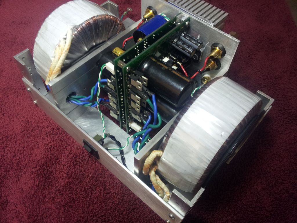

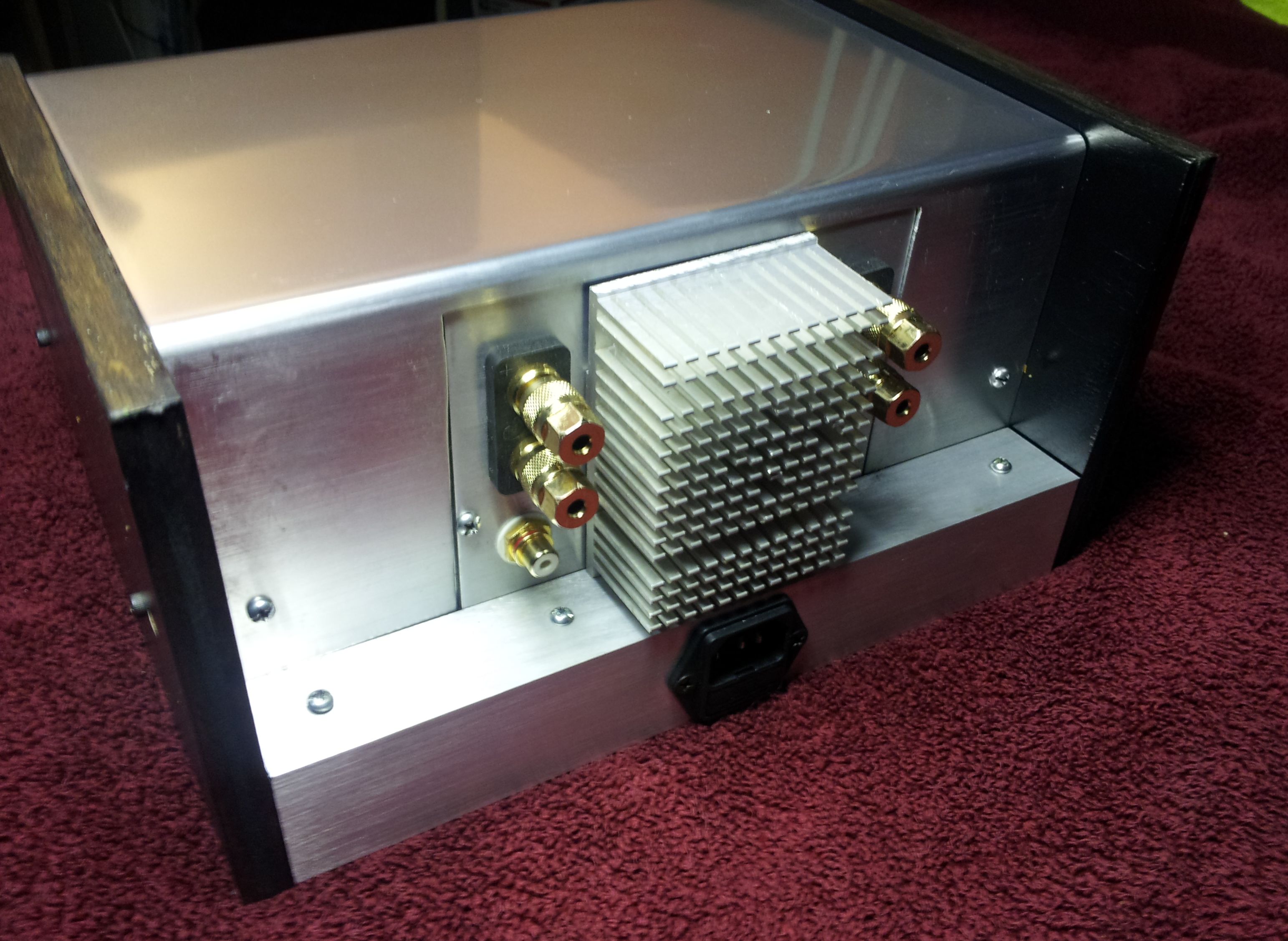

@ Feckie: Along with Jac's suggestion - I can't see how tall your chassis is, but if you have the room a simple shield for the transformers would allow dual level at the rear of the chassis only. The shield/shell if thick enough will allow threaded standoffs for mounting the amp modules to the top. I assume your brother could make that piece also at his work.
The amps require much less heatsink than most would assume. See posts #1316 - 1317 for a 3" x 4 " PC CPU heatsink that is handling two FEs. Also consider mounting the HS externally. That can be done by either making a cut-out in the back panel, or simple surface to surface with some through bolts - some thermal paste applied between the plates.
The transformers can be really close to the amps as shown in those same posts. Your wiring will have a bigger influence on hum production.

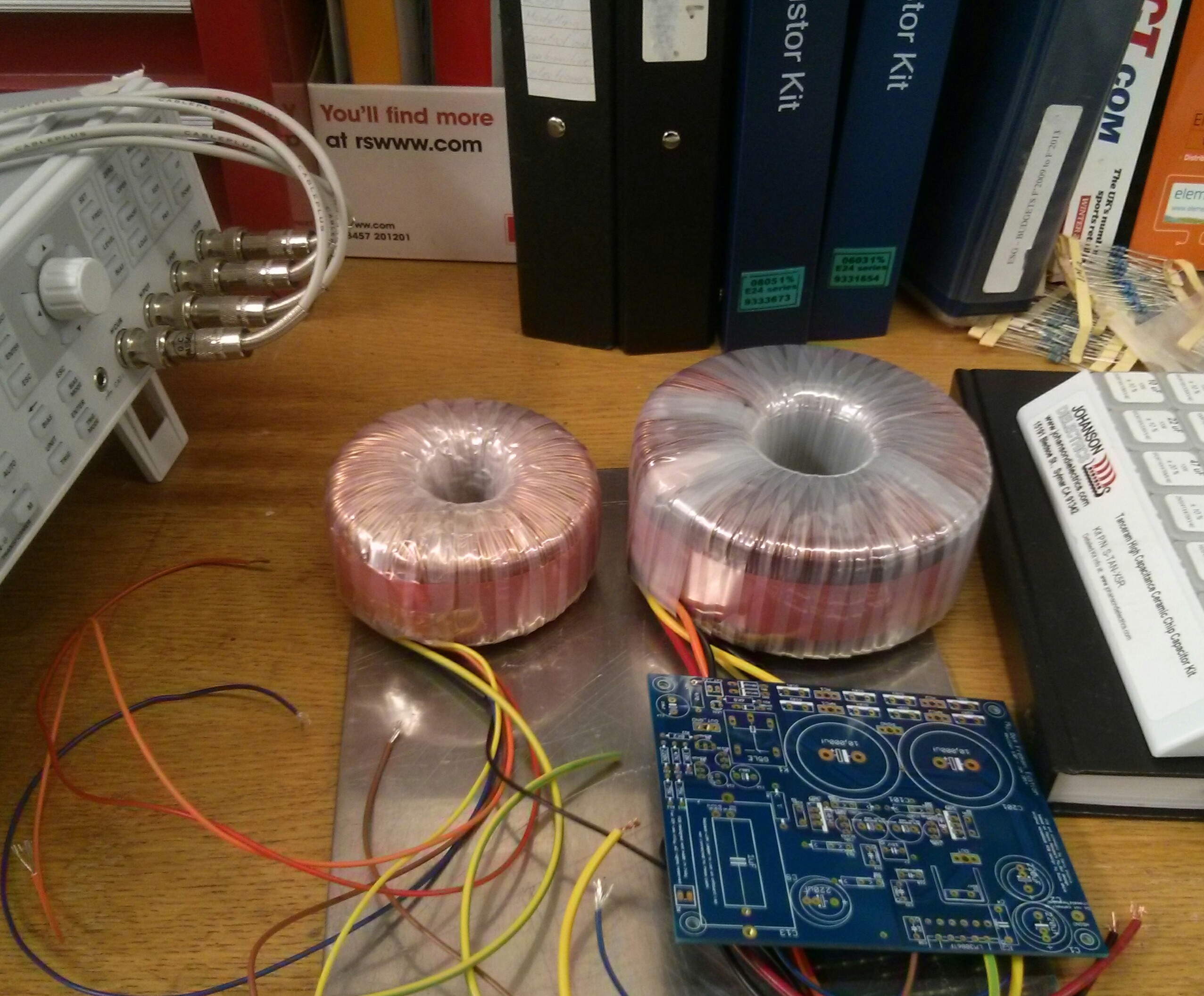

- on a simpler fun note - my bespoke transformers, (shielded and overwound on overspec resin impregnated cores) came in the other day - yippieee!!!😛

the trannies
My bad -I'm amazed- it seems adjustable wiper/pot/L-pads are actually commonly used at speaker inputs - I though you just used a L-pad calculator and hard wired them …… - seems horrible idea…
Anyways here’s my ridiculous traffo pair 😱 - 300VA mid bass - 100VA tweeter …
