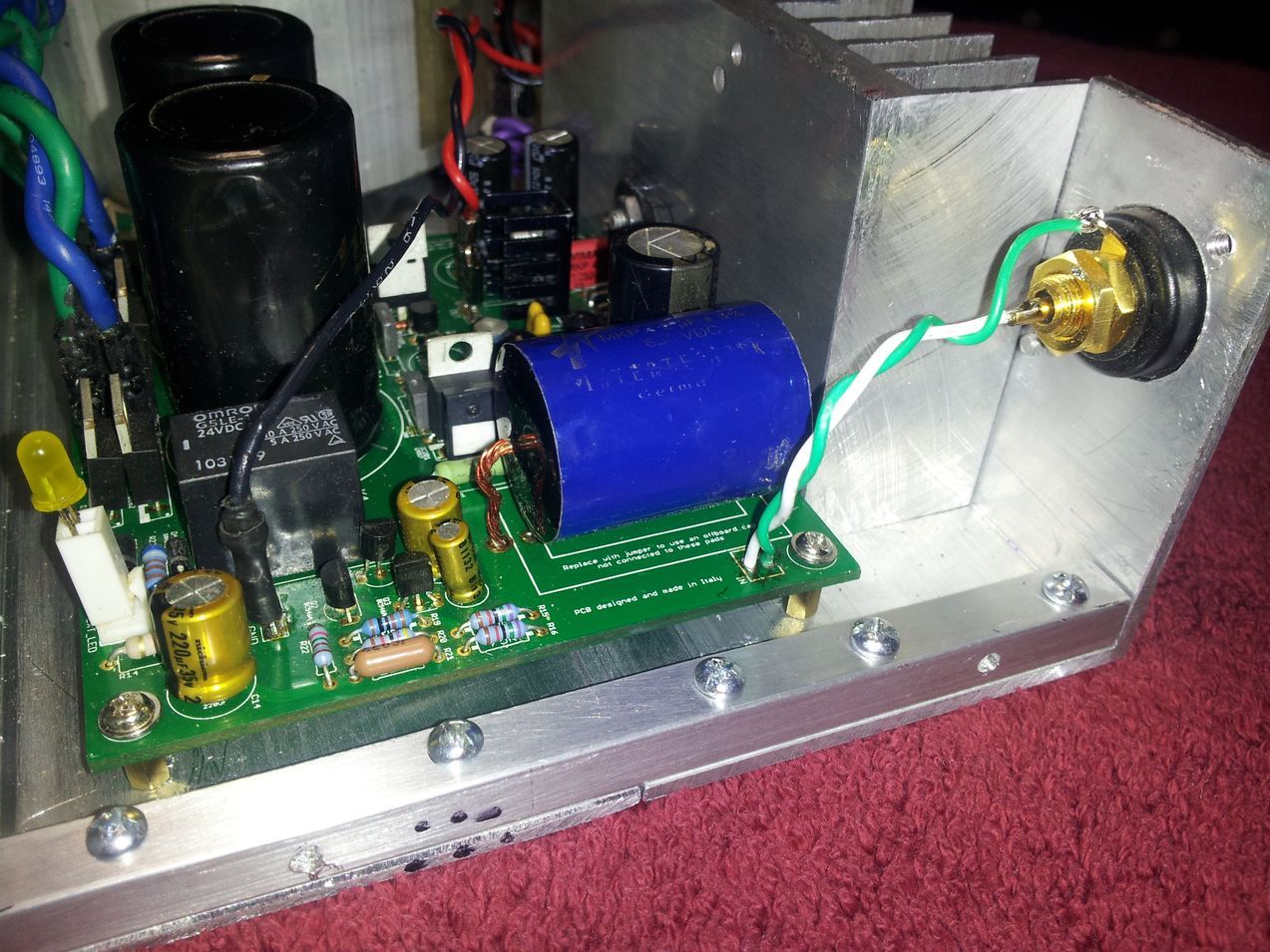

I had a similar situation where the wire separated from the female receiver inside the input molex . The fault (loose crimp) was there just about to break, but touching/moving the amp made it show up. I removed the pins and soldered directly to the board from the input RCAs to avoid that. Hope it's something that simple. :xfingers:
Hi Bcmbob,
I have resoldered all solder joints of input section. Same issue. When inputs are shorted, there is no noise. But it is difficult to listen to music if inputs of amplifier are shorted 😉
As noise already increases when I put my finger a few mm apart from input capacitor, this indicate some kind of open loop gain and behavior like of a touchless sensor.
I guess the LM318 is not working properly. Have no spare LM318 on hand to test.
1534
No, I am using Audyn Tin Foil Caps. Other channel having same type of cap is working properly. The noise \ hum is not that noise what you can hear in near range only, it is on a level that you can hear at a 15m distance.
I try to get a spare LM318. I guess there was a instability caused by crossover failure which has destroyed something in LM318 chip.

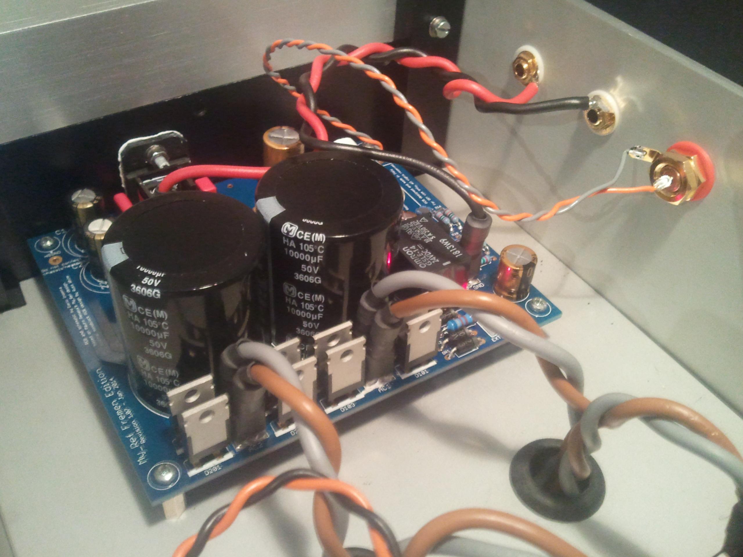

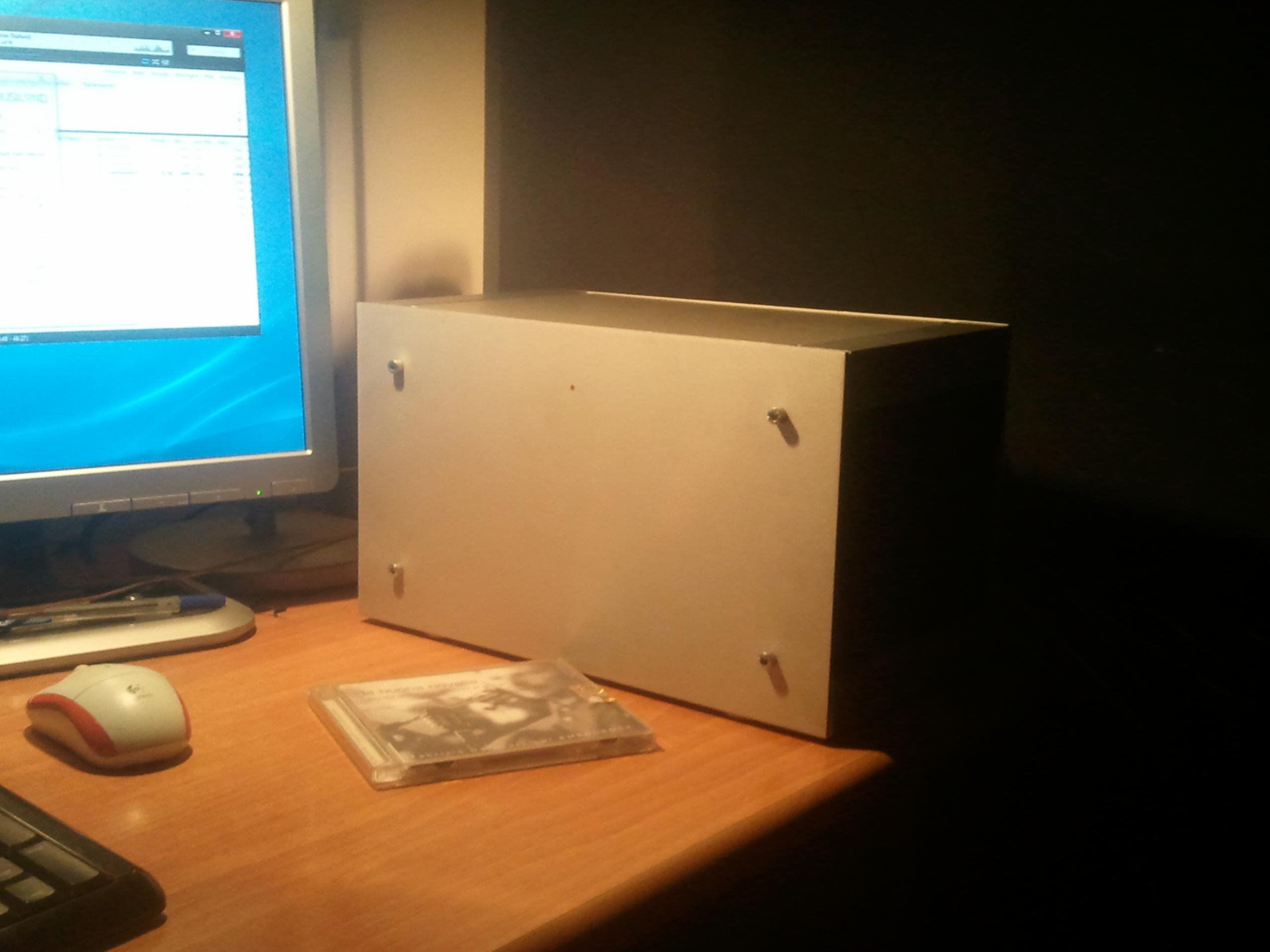

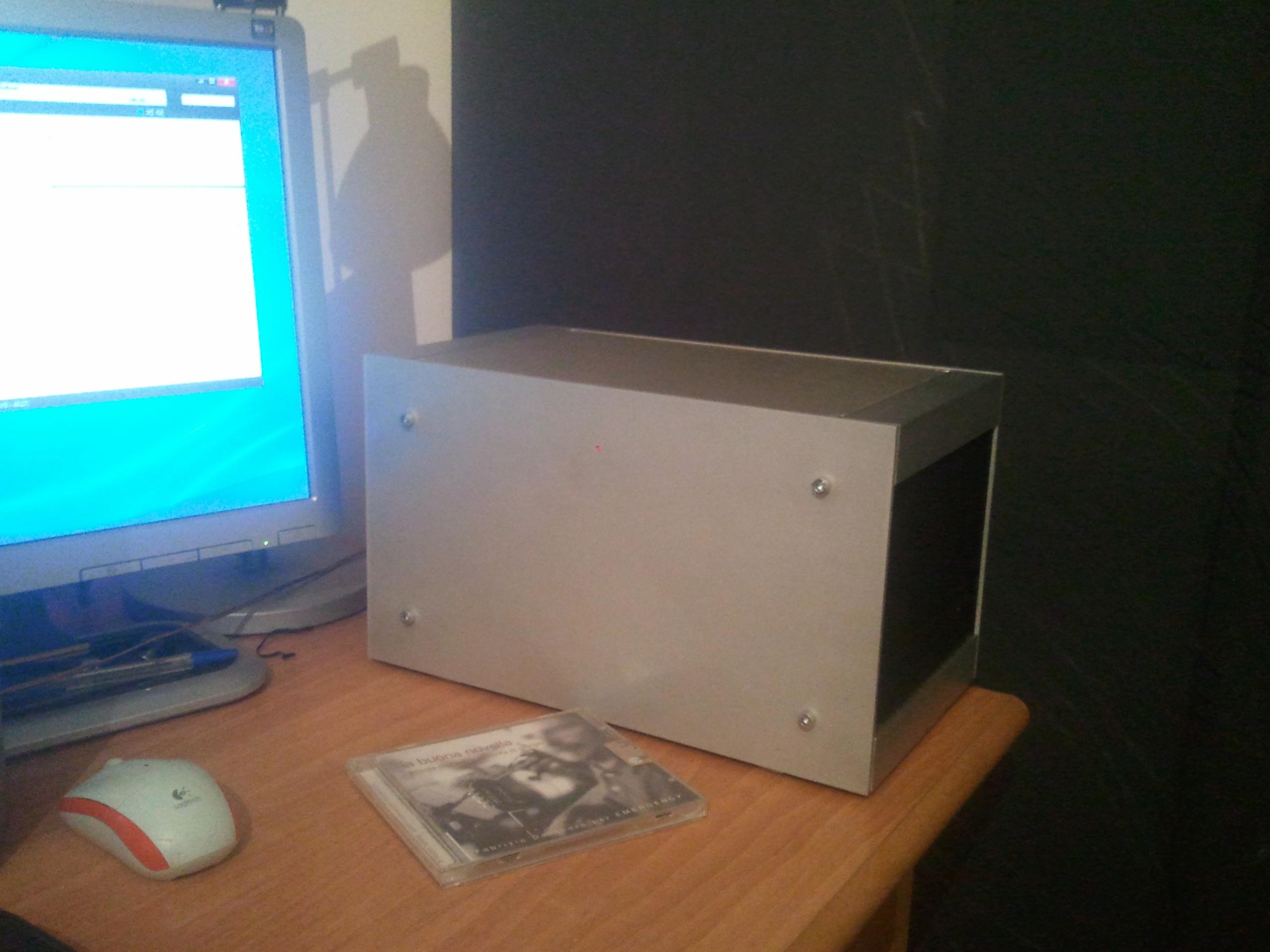

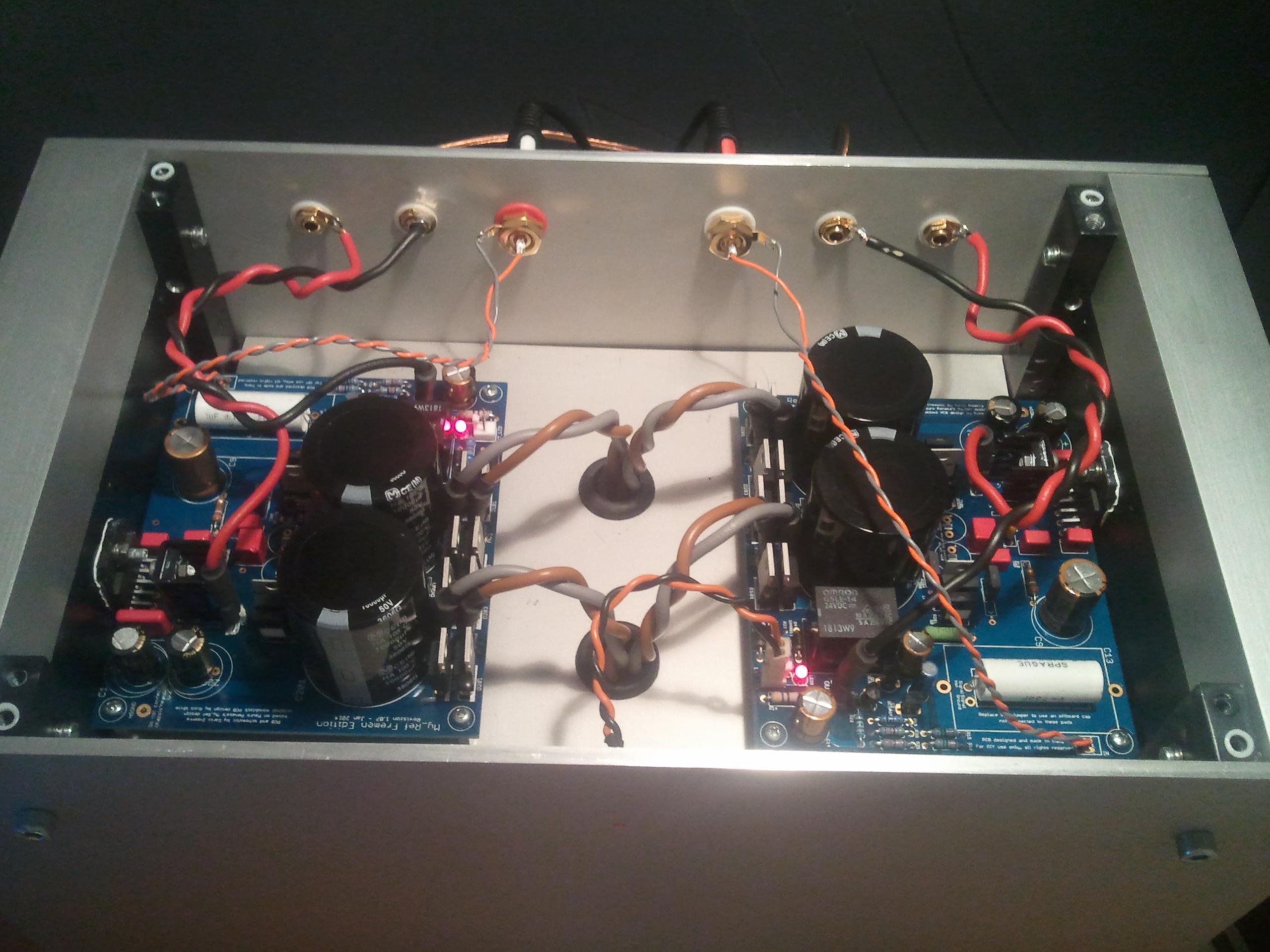

Only now I find all the limitations of my old speakers, the offset vacuum is 3.8 mV and 5.2 mV, everything ok on the first turn ... I can just place some photo assembly and houses made ​​with materials taken from the "garbage" of the lab where I work. 😀
For power I used 4 EI transformer insulation 0-24V 144VA, these recycled material, I still do not regret the torus. 😀
When I have time I make serious measures.
Enjoy everyone.
(...and sorry for my bad English)

Finally on, I'm testing now ... fantastic.🙂
Waiting for pics 😉

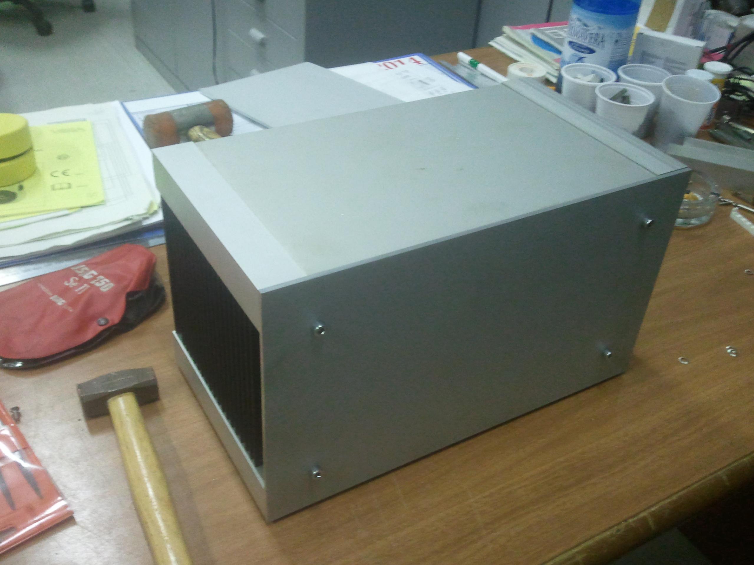

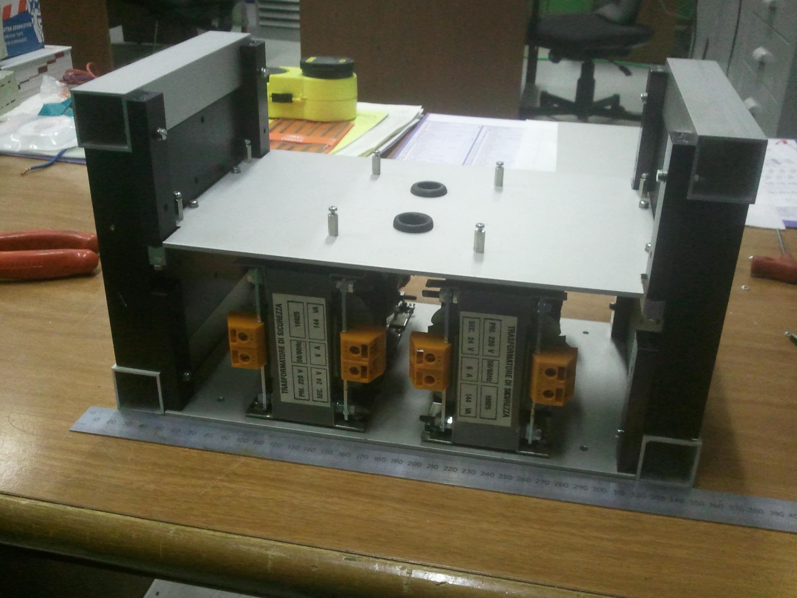

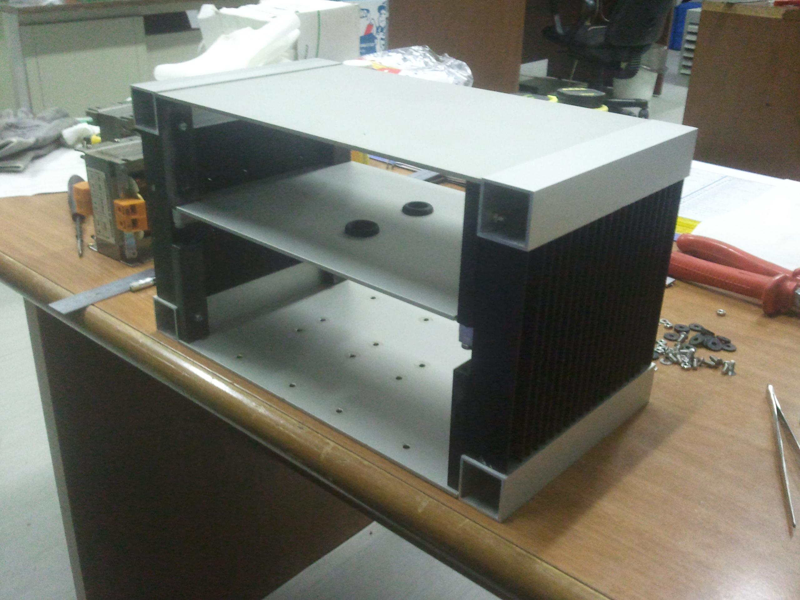

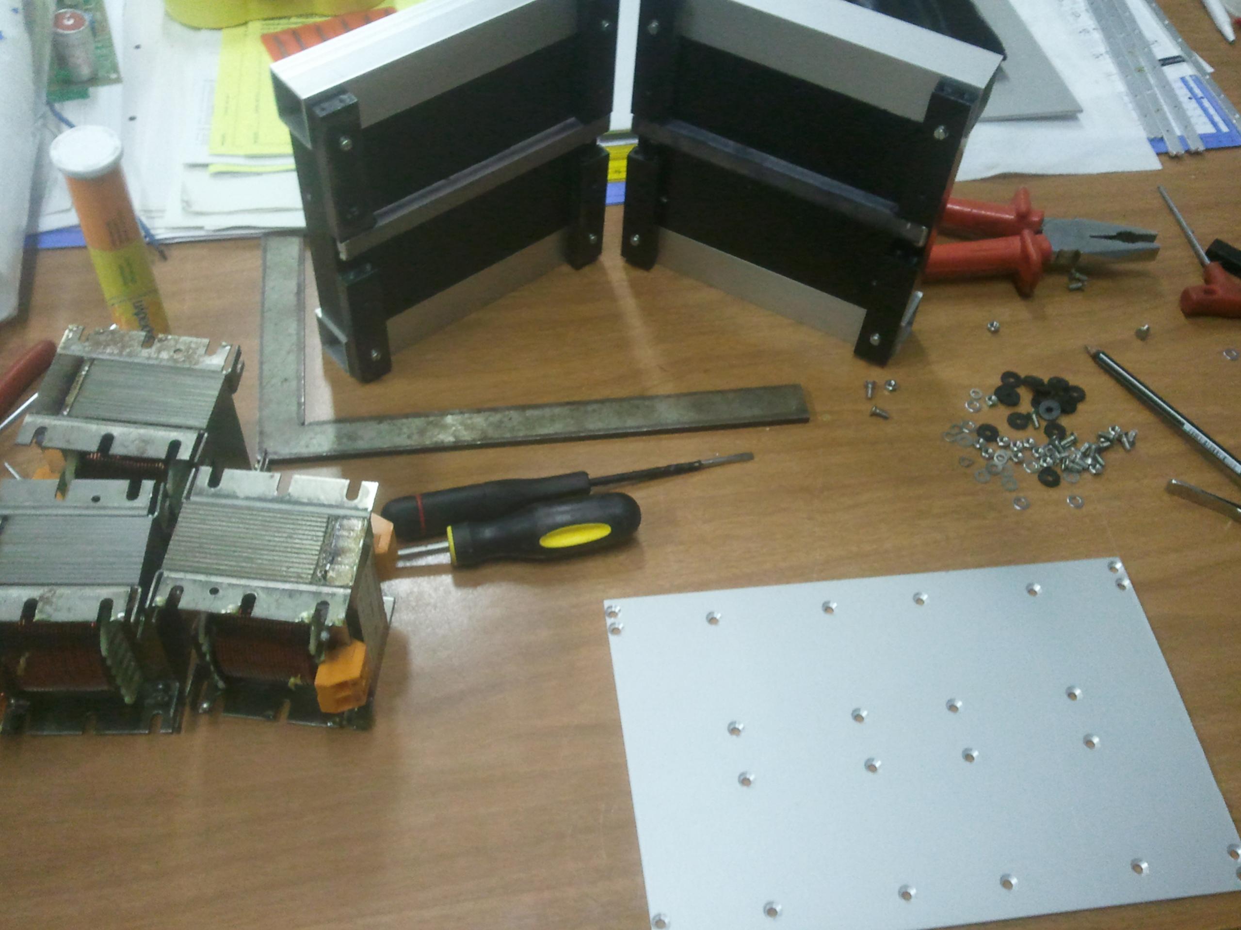

For the bottom, the central bulkhead, and the above, I used 3mm anodized aluminum recovered from a rack of automation disposed of, the heat sinks are the recovery of two industrial power supplies broken and I was bound for the size of the amp.
The boxed aluminum is 30x30mm and 172mm deep, and is the coating of the legs of my desk 🙄😀 ... ahahahahha
The front and the back is made of aluminum 4.5 mm 330x190 mm​​, this also coming from a closet automation disposed of, as well as the transformers that are the recovery of some safety sockets 24v.
For now it is a chassis provisional, but already I know that it will remain so for long.
is on for at least 6 hours on the speaker 12 ohms and it is just warm, no noise due to the processors that was my biggest fear.
As soon as I get a little sparrow of time to do some serious measuring.
Good life to all.

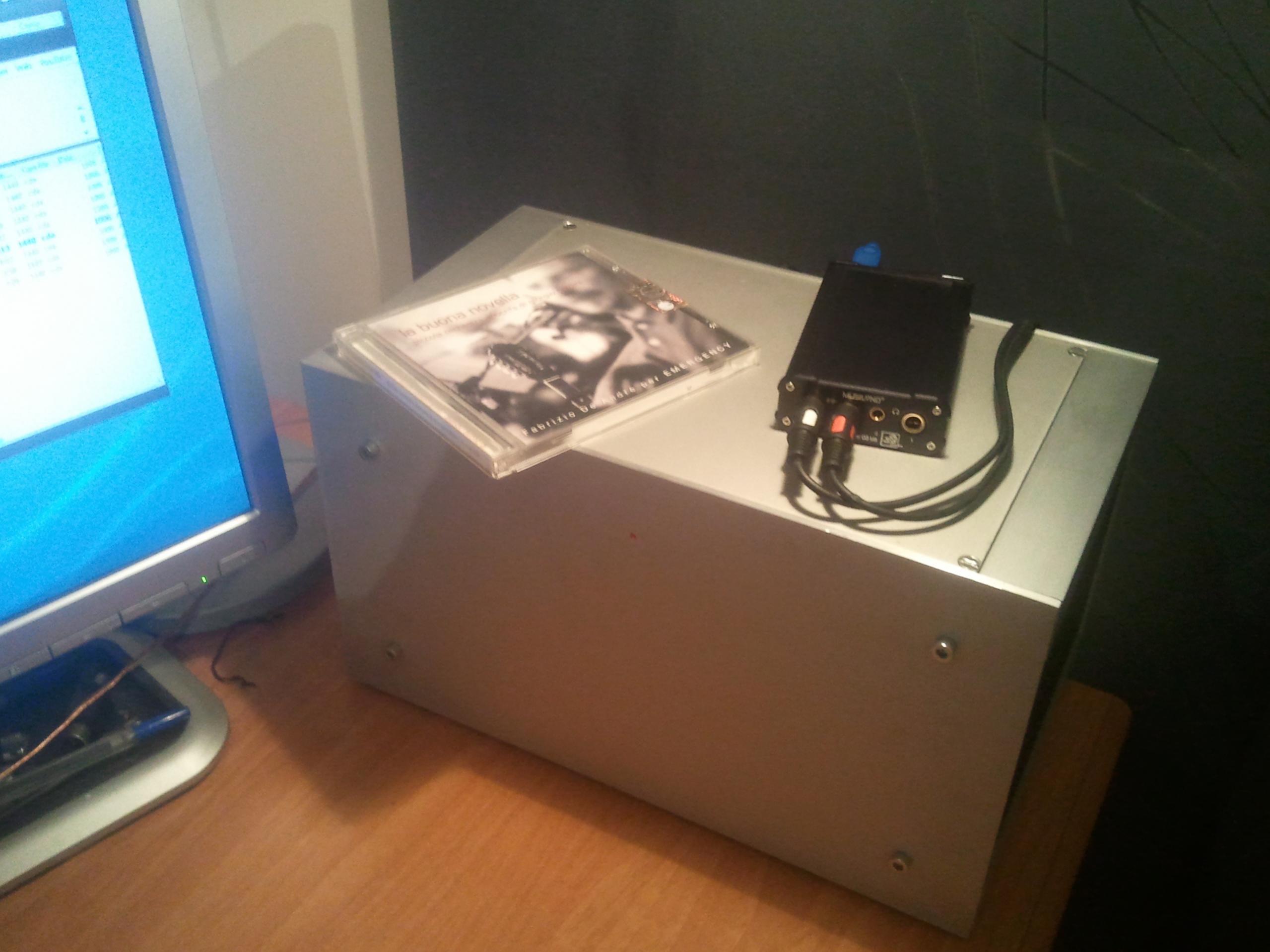

All'ascolto con jriver e il mio dac musiland....😉🙂🙂🙂
