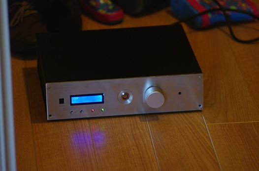

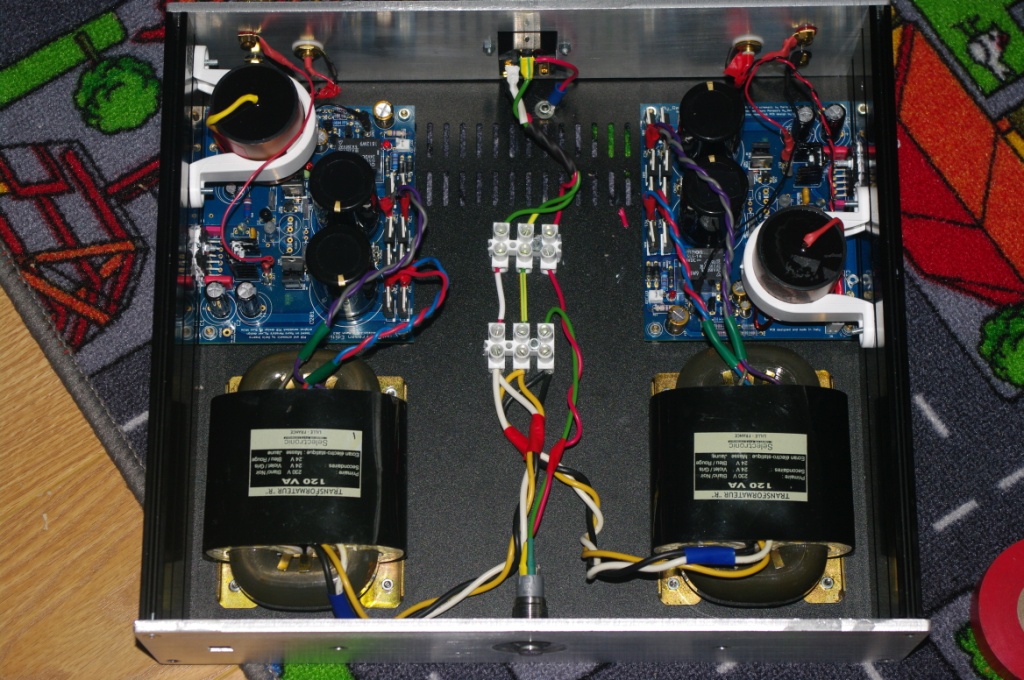

And I m again with those switches...I run live to C (common) and from NO (normally open) I run wire into transformer live ?
I promise I ll finish wiring amp today or tomorrow 🙂 it took too long to get this sorted :/
Amp was used with no switches or lights at all...
Ok, here it is
a: iec earth to chassis ground (top middle)
b: switch wiring is fine, figured it myself 😀
c: and my solution to over sized capacitors
d: switch led needs 12v but will be too bright so voltage could be lower than 9v, as well will add 2x ext led to the front panel
d: severe weather conditions 🙁
Wires will be restrained with adhesive clips (waiting for delivery)

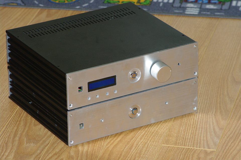

Just finished second of two new amps. These feature all premium parts with Mundorf M-Lytic PS caps, TC coupling caps, Vishay naked Z-foil's at R10 and R12, BG Std's at C9, stacked 5 and 10pF caps at C34, 33pF at C10. They have single-ended input through WBT Nextgen silver RCA's and a switch to also provide balanced input through Jac's custom conversion boards built with OPA627's. Binding posts are Vampire copper base. They sound really good, but it's hard to tell how good with the way my rig is currently configured. I am trying to schedule an audition on my friend's Eggleston's to run them full range, and I will report the results. In the meantime, just letting them play at low volume to achieve some break-in.
They are not in metal enclosures, but mounted to wood boards. Absolutely silent. DC offset of both is 1mv with open input. Can that be right?
One funny bit: while powering up the first amp for the first time, no LED lit and no relay click. I checked all the wiring, measured the power supply all the way back to the IEC inlet and got nothing, zero. Well, okay, the power cord must be bad. Smelled burning and thought I must have fried something pretty bad. Despondent, I went to unplug at the wall and saw that I had plugged in my soldering iron instead of the power cord! Check everything.

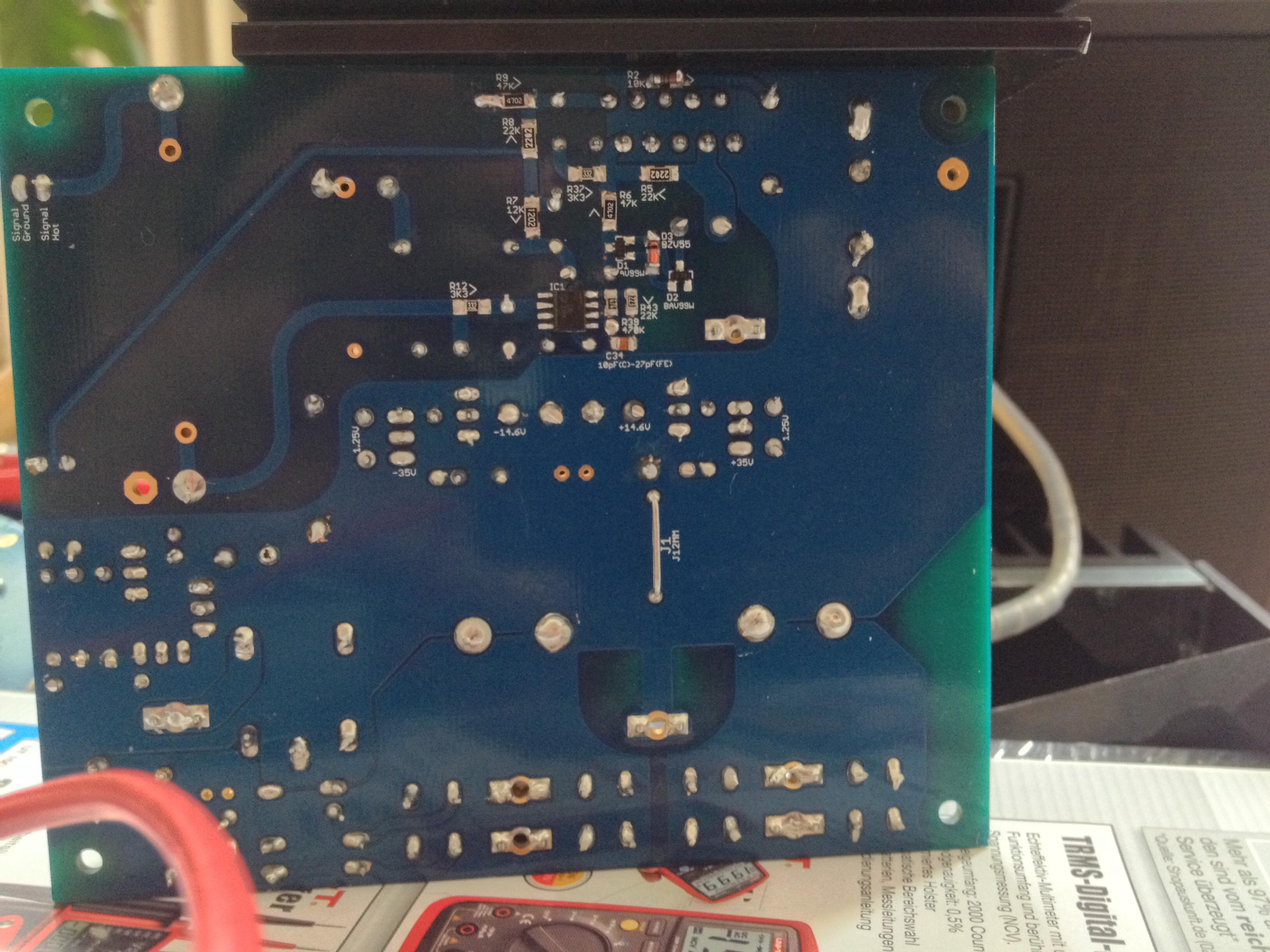

One channel starts to produce hum and noise
Hello,
There is an issue with one of the channels of my 6-ch MyRefFE. I hope someone can advise.
It started a few days ago when playing arround with crossover settings in JRiver. There was something wrong with digital signal and all channels played loud digital noise for a few seconds. I stopped and restarted JRiver. Since then, with and without signal one of the 6 channels produces hum and noise, to loud to ignore. Any idea what could be damaged? If I touch the input capacitor or move something in a few mm distance of input capacitor the noise increases. All voltages are ok, and I have checked the solder points. DC output is 4,9 mV. Find attached a picture of PCB.
Is there need to replace LM3886 or LM318?
