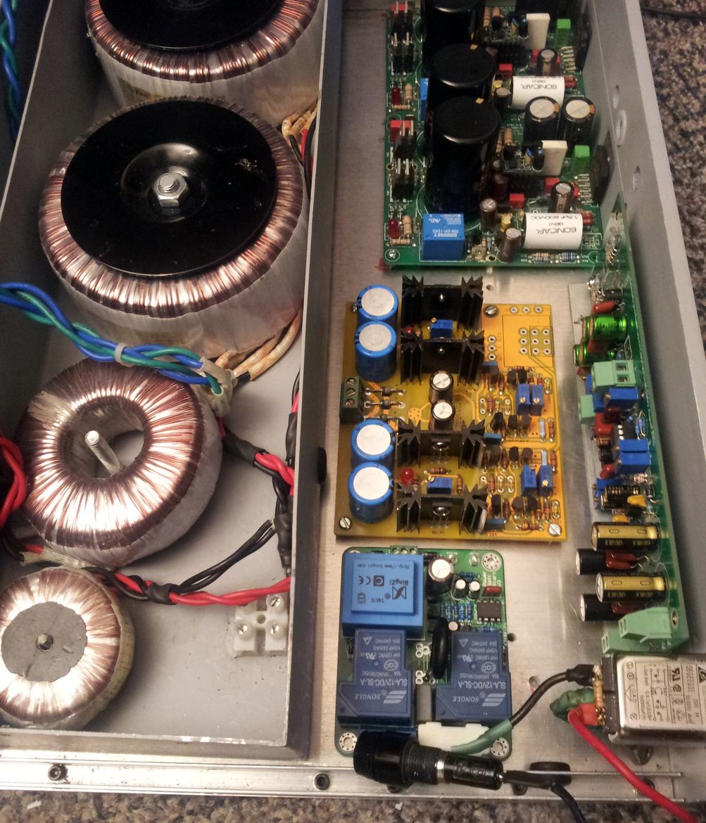

Blowing of a close rated fuse is to be expected if one does not ensure that start up current does not overly heat the fuse element.
Triple the fuse current rating and your fuse does not blow, even when the equipment is severely abused.
Fit a soft start and close rate the fuse. For 300VA, a T1A or T1.2A should be perfectly adequate.
I intend to change the transformers fairly soon to either R core or encapsulated types, either way they will be lower rated, probably a maximum of 160VA. Lower value fuses will obviously be needed but I don't think i'll bother with inrush limiting or soft start facility with such small transformers.

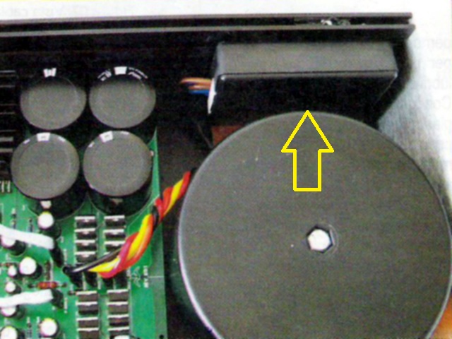

Soft start
Hello,
about the soft-start, I do think that it's useful to avoid useless stress to the transformers, rectifiers and 10000uF caps. I'm going to implement this soft-start design (just to keep the family feeling 😀):
soft-start by Mauro Penasa (in italian)
I do not know if it has been ever reported here on diyaudio. If someone is interested, I may make a short summary in english of it.
Daniele
post1510 link to Mauro soft start is a direct on line device that has ALL components connected to Mains Voltages.
In normal circumstances discussion, of all these direct to mains devices, is banned from this Forum.
But we are not in "normal" mode.
The Forum is permitting some discussion in some circumstances.
Absolutely... on Mauro project page there's clear disclaimer and the mandatory suggestion to enclose in a plastic/insulating case the whole soft start circuit.

(Image extract from Costruire HiFi magazine #116)

Here I go again. Has it been established a soft start is necessary? We went through a lot of this on the MyRef Integrated thread and a soft start was eventually added. You can read about it around this post. Though the SS does provide an element of protection, I've built amps with 125 VA, 200 VA and 300 VA dual transformers without even a CL-60 and have never experienced any problems. I may be pushing my luck, and I'm not trying discourage the use of a soft start - but how significant is it's performance with this design.
I remember seeing a photo of the components of Dario's eventual final build and I believe a SS was included. Sound like a worthy topic of discussion for a few posts.
