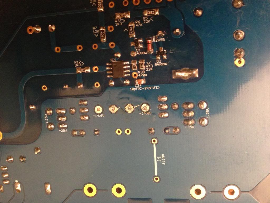

Man have i stuffed my board??
The idiot i am, wasnt concentrating and soldered caps directly where it was marked not to use 😱
So while unsoldering the caps i scratched the board and exposed copper which is now covered with solder!
Can someone advise on what to do next.
Much appreciated
Ryan

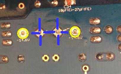

Dario is too fast for me. I was drawing a little pic showing traces to ground plane (blue) and isolation space (yellow). Note there are four traces in those two pads. I suspect even if you lost one the others would be enough.
The bubbling on the mask looks like too much heat was used. Solder wick (copper braid) really helps in a situation like this. I apply some extra Chip-Quick flux on the braid and watch carefully as the solder is transferred off the pin/pad. It is much easier to tell when to remove the heat. Done carefully and slowly from a couple angles the TH parts can actually fall off the board on their own.
Last weekend I had to remove 24 three pin pieces from a different project and learned how well the braid functions if one slows down and watches the action with a good magnifying lens.

phew!
That bubbling is the flux residue. So i am all good there. While inspecting the board i found a couple MK132 resistors going the wrong way. So i desoldered them and reversed them.
Is there any way to test the resistors to see if i damaged them while i was getting them out and back in?
