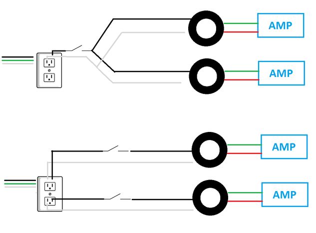

Could it be better to have two 160VA (or even 200VA) 2x25 V secondaries transformers and go dual mono? The price is similar for two 160VA or one 400 VA transformer.

Several months ago I posted this on a thread for a different amp - asking if dual mono and monoblocks weren't actually the same thing if you consider the AC feed to the wall outlet. The answer I got was "Just more parts with the monoblocks" 🙄

One cannot build a monoblock from a two channel amplifier.
A monoblock is ONE channel !
Putting in two transformers to power two isolated channels is a dual mono. That is not a monoblock.
A dual mono is afflicted with the same ground loop difficulties that a stereo amplifier has.

The post simply notes that load, common and ground (hot, neutral, ground) will resolve to a single AC feed in both dual mono and monoblock sets. On which side of the wall outlet that happens is the builder's option, but it is unavoidable. Getting the ground paths/isolation correct is of course tricky at times, but at some point even they will merge.
I'm only suggesting that from a physical construction/cost perspective, DM and MB may be quite similar, and the builder can consider whether the difference justifies the second chassis.

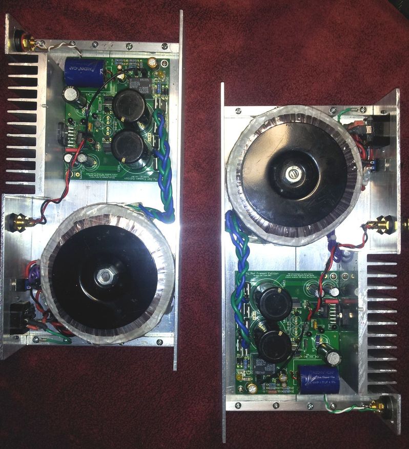

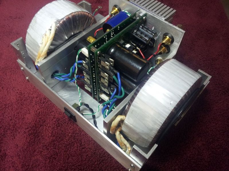

I hear what you are saying and am not disagreeing at all on the definitions and what they represent physically.
These are pictures of one (the same) amp build mounted in two distinct chassis styles. I'm merely trying to present usable construction options that may have nearly identical functional outcome to potential FE builders - not an attempt to jumble or mis-apply accepted terminology. :hug:
