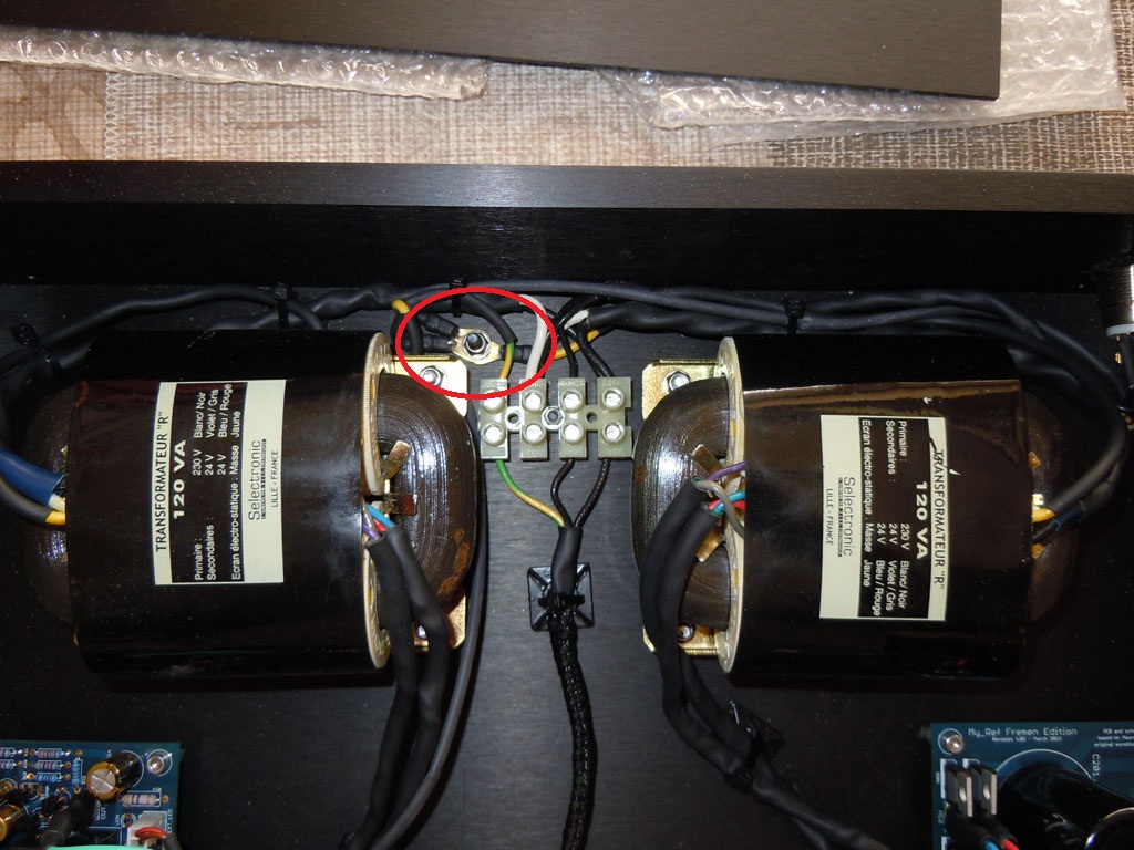

There is a barely audible buzz (sorry, i don't know if that's the right word for 'ronzio') but i can only hear it with my ear a few inches from tweeter and no music playing.
It seems to disappear if i use as source an ipod, so it could be a ground loop issue; i should investigate this, but i like so much what comes out of the speakers that I think I will listen to music instead 😉
Unless you use double insulated transformers with no mains earth connection you will most probably always get some noise, if it's not noticeable from your listening position I wouldn't bother about it. Many commercial amps also produce some hum/buzz which is audible with your ear close to the speaker. I also found it depends on what I use for a source. Enjoy your creation, the FE is a stunning amp in my opinion.

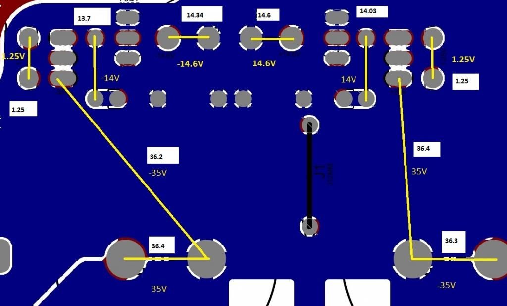

Can someone give me an opinion on the voltages below, especially the fact that i am getting 14.3 rather than 14.6.
It shouldn't be a problem, IMHO.
The zener has been replaced?

Benedetto, I can't see any link between chassis and safety ground.
I can see that transformers shields are tied together to one of the bolts.
I would connect them to safety ground, as all panels.
Grounding side panels (the ones you're using as heatsinks) could possibly fix your (slight) hum problem.
Thank you Dario, maybe it was not clear from previous pictures, but the transformers shields are tied together and with the safety ground cable with the ground bolt.
Could you please check this picture and give me your advice?
About the side panels i have scratched the contact point with the base panel, but did not check if the contact was good 🙂
Yeah Its been replaced. I Just went and replaced that entire row of components.

Fine. 🙂
It you already checked the passives and for solder bridges you should proceed soldering the lm318 and lm3886 then.
