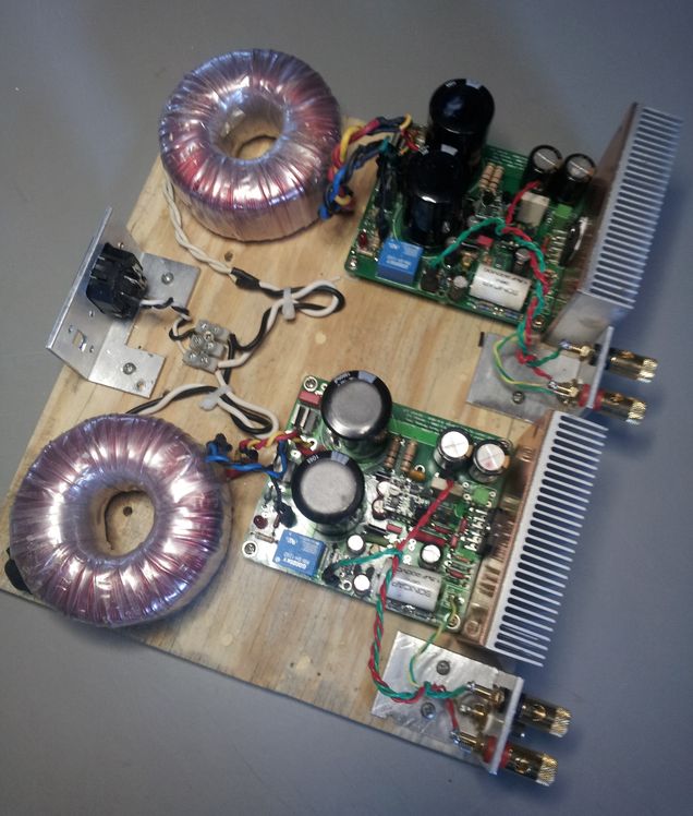

Good job! 🙂

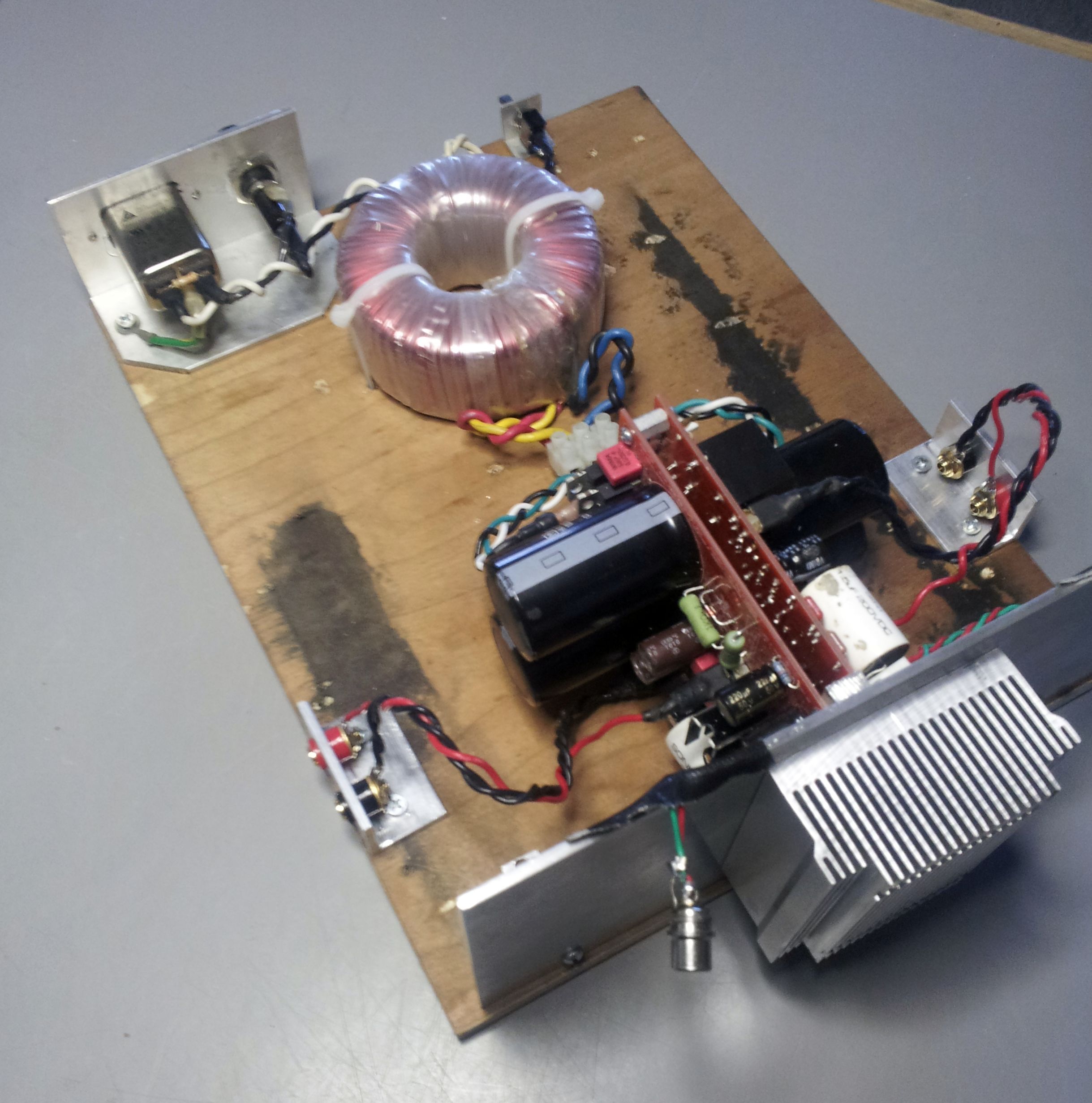

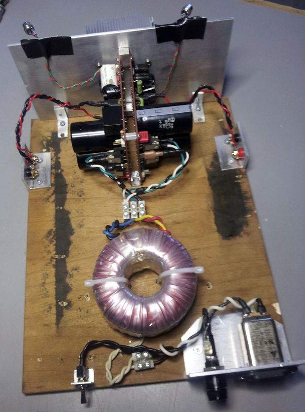

Can you share what was the problem? Transformer's wires?
Nice build, keep us informed with your impressions on audio performance.
It was all to do with the transformer wires.
The sound is impressive and was worth doing, I'm not good with describing how an amp sounds but it keeps up with my weston acoustics kt120 driving ns1000m's.
The ns1000m's are notorious for sounding harsh and unlistenable when played with mediocre equipment and I think it has passed the test.
So much so I am considering selling the kt120 and building a pair of obl-11's.
Oh and I still waiting on the tortuga ldr so it could be even better
Well done Feckie

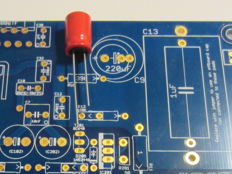

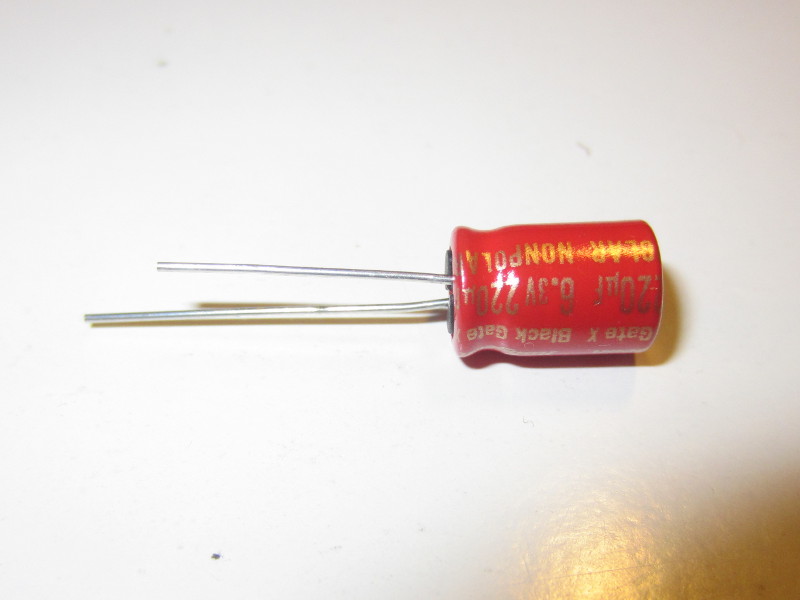

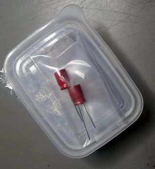

Now that you have working boards populated with really good quality parts you should consider replacing caps in C9 with some Blackgate PK 220uF/4V, FK 220uF or even better NX 220uF/6.3V, you'll have a really nice improvement.
You can find PKs from Parts Connexion or eBay for less than 5 US$, audiotuning on ebay has NX for 16.90€, a really honest price nowadays, NX are the best caps you can use for C9.
For those lucky enough
that have NX, they've a preferred orientation too:
The shorter leg goes to ground (the two paired pads, opposite to the + marking).
If you have trimmed legs the 'shorter leg' side can be identified by the 'NONPOLAR' marking:
....... NX are the best caps you can use for C9.
Hi Dario,
I was out of town when you posted this. When I got home, I was curious enough to check out NX on ebay. I found that audiotuning didn't have anymore for sale. It is clear that the NX are becoming very hard to find and expensive.

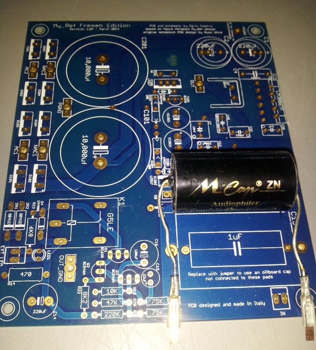

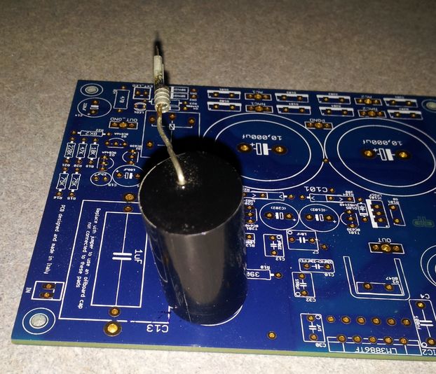

That reminded me the Bob had suggested the possibility of the Mundorf AC series as being available and a possibility for good sound in the C9 position. Like the NX, they are bi-polar and have very low tan delta. PCX has them available for $3.49, but the problem is their size and that they are axial caps. At 16 mm diameter and 39 mm length, they would be difficult to fit to the current board. Maybe soldier style would work.
Looking at the board, I can imagine a future revision of the board that could fit them. I wondered if you have considered them, even auditioned them? If not, maybe I'll give them a try the next time I place an order with PCX.
Hi Jac,
the audiotuning eBay auction I was referring to is still open and 8 pieces still available...
I don't think I'll ever do a board that can accept such large axial caps... maybe I'll add a bypass position for FKP2s or KP1830.

You picture is exactly what I imagined. I may give the Mundorf's a try since the price is not too bad.
