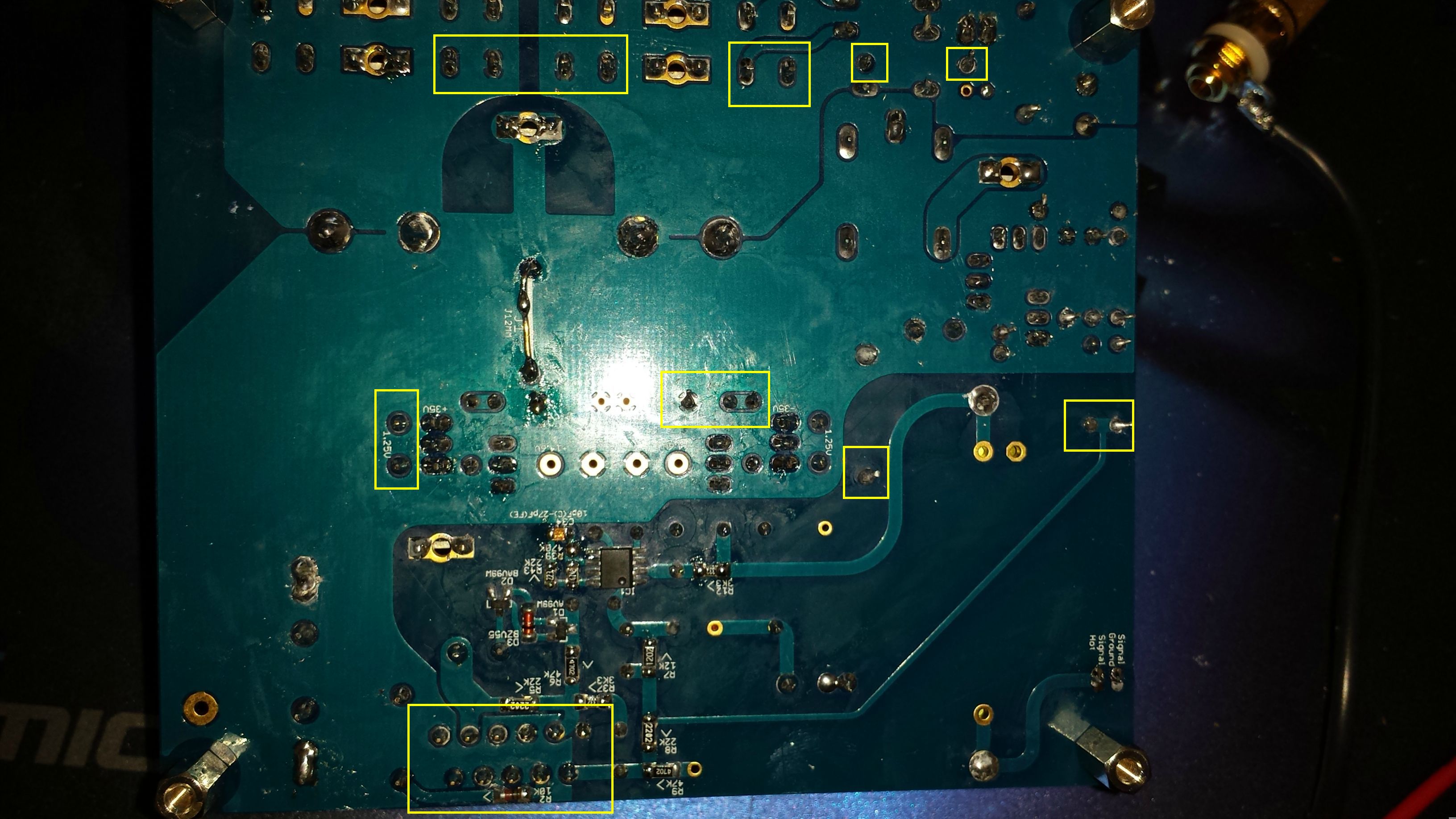

All the MyRefs will have noise with nothing at the input. The FE can operate (in most situations) without a connection to PGND. The best way for us to help is if you post clear well lit photos - both sides, both boards.
Thanks, I'd already tried disconnecting PGND but it made no difference. Here are the pictures:
First Board:
Symptoms of this board:

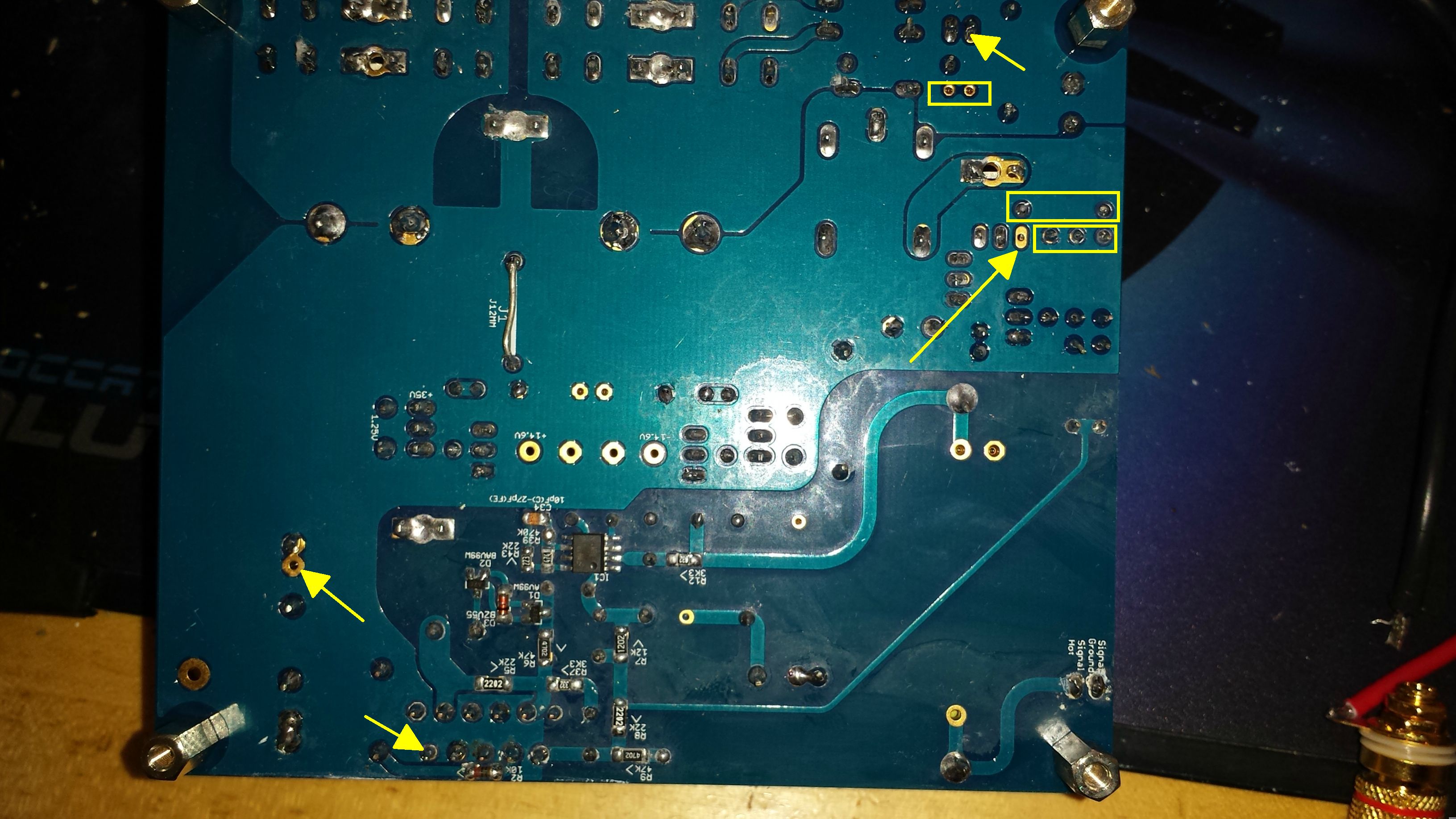

I see many places that appear to have very little solder on the pins. Those can easily hide cold joints. It may be due to the lighting/angle, but look through the FE Build Guide for joints with the proper amount of solder. You get high marks for neatness, but you may have been a bit solder stingy at some points.😉
Some places appear to have no solder at all. I'd recommend reheating everything with the aid if a good magnifier.

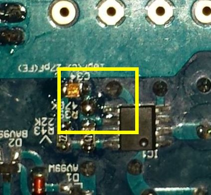

Thanks for the feedback! I was under the impression that I was more prone to using too much solder, especially on the SMD parts... The only joints where I was less than generous were the fast-on tabs (and one of the big 10mF filter caps has quite the bad connection to ground - that should have no effect on operation though, just make things a bit noisier). Nevertheless, I'll reflow all of the joints again tonight, and if that fails I'll try replacing the LM318s (oh the joy of replacing SMD parts...).
Edit: just noticed a pad on one of the small signal transistors you pointed out that I actually forgot to solder - thanks a bunch! Gonna correct that tonight and see whether it helps. I sure hope I can get these guys to work!

I should have been more specific. The thru-hole parts should be reheated not necessarily the SMD points (if they look good to you). Hopefully you have some liquid or paste flux to apply as you work. Make sure there isn't a solder bridge in this area.

Thanks for the help Dario! The unregulated rails are fine, both polarities on both boards are sitting at 32.2V from ground - I guess that means all the MUR820 diodes are fine. The one looking burned in the first pic looks identical to the others in reality - I have no idea why it looks so weird on the photo. The oversoldered SMD joints shouldn't have an effect on the operation of the amplifier, right? Fixing those would be quite the pain.
Also, I checked the zener orientations (plus all the other diodes) and they are correct, too. I also soldered the pad I'd missed that bcmbob pointed out - it didn't have any effect on the symptoms.
