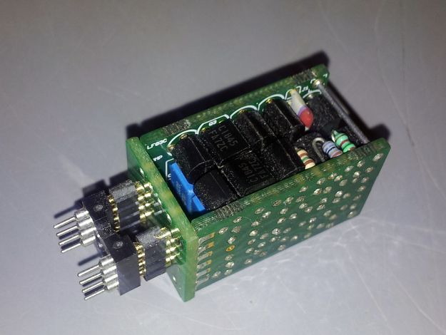

In a My_Ref, the gain is set by R7 and R10, that is R7/R10 = 12k/390 ~ 30.8:1 voltage ratio. The problem is that the LM318 opamp has some stability issues as the frequency approaches DC. To make sure that the 318 remains stable, Mauro added C9 to R10, the combination making a high pass filter that acts like an open circuit at DC and causes the gain of the circuit to decrease as the frequency goes lower. That helps the low frequency stability.
The reason C9 is added is to reduce the the DC gain, as stated. However, the main intent is to reduce the output offset voltage, which would otherwise be the input offset voltage (10s of mV) multiplied by the DC gain (~30), thus going to the 100s of mV region, which tends to reduce the long-term reliability of speaker voice coils.
Some ways around having to use C9:
1) Use a DC servo, as in the Evolution.
2) Use an external discrete LTP with precisely Vbe-matched BJTs, instead of the internal darlington LTP of the LM318. I explored this in the Rev D, but didn't actually implement a prototype. This will probably work fine with BC849c/850c from the same reel, manually matched by Vbe within a few mV of each other at some known currents (say 0.1 to 1 mA).
Bob, that's actually the dual DIP8 LF03 discrete opamp in the pic, which doesn't directly substitute the LM318 single opamp. I did build a single-opamp version of the same, called the LF03s, but it was unstable in the MyRef Rev C (like a lot of other high-performance opamps including the OPA627, AD797B, LME49710, etc.). However, PreSapian has been able to stably use the LF03 in a variant of the MiniRef 1875 (with some mods).
I'm sure some of you have bypassed C9 in earlier versions of My_Ref. What kind of bypass value is typically used with C9? I would guess something in the range of 0.1 uF?
I've determined 'by ears', some years ago, that the best bypass value for C9 seems to be 22nF.

long tailed pair, type of amp configuration
