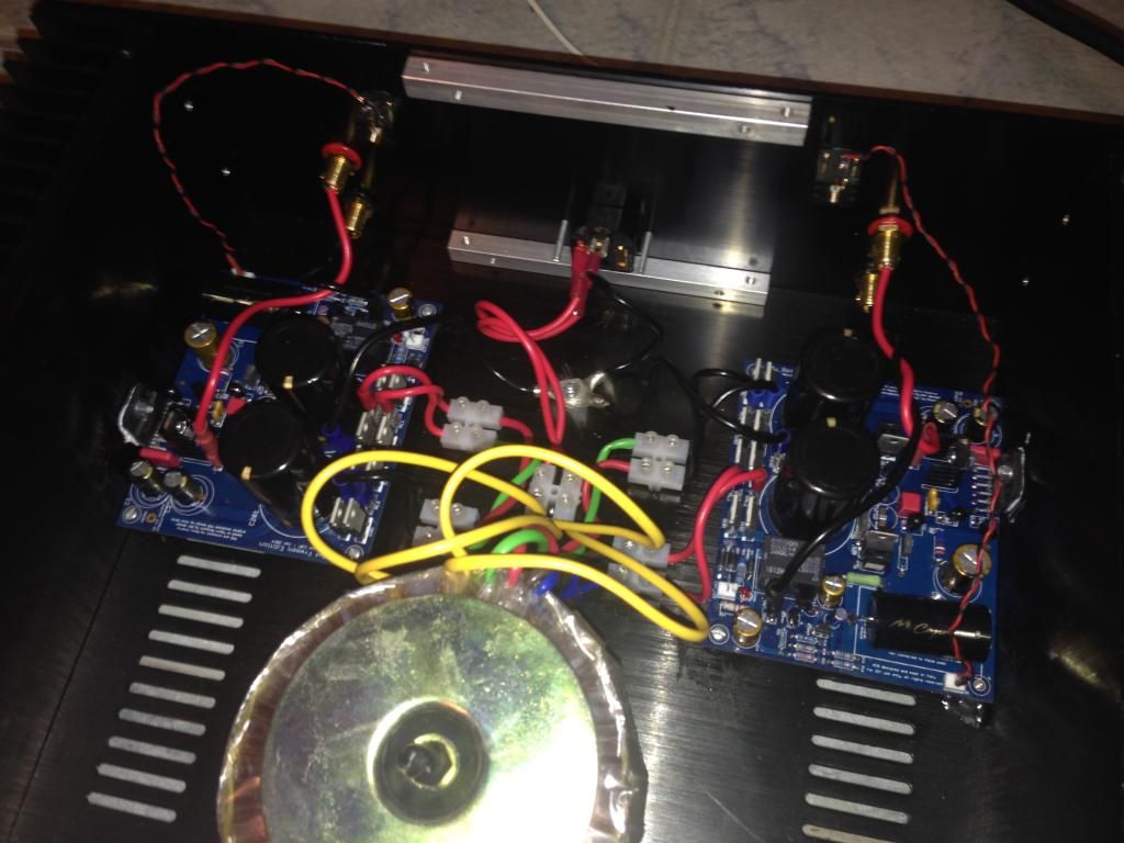

I havent measured the passives yet but i did resolder the board and something interesting happened.
In order:
1. Plugged in the board
2. Powered on and i heard the click and led lit up
3. Measured C102 and C202
4. 1 had 14.4v (cant remember exact but it was within range)
5. The other had .5v again.
6. Took off the secondaries and checked the bottom of the board and didnt see anything obvious.
7. Put secondaries on again and there was NO click or LED.
8. Played around for a while and discovered that the secondary pairs position is directly related to whether i get a click or not.
For example
set 1 (green and red) on AC2 and NAC2 and set 2 on AC1 and NAC1 = Relay and LED on
set 2 (Blue and brown) on AC2 and NAC2 and set 1 on AC1 and NAC1 = no relay or LED
Now for something that you all probably know but i dont. The secondary pairs have a protective coating on the wire, so it may look exposed but a continuity test will not beep. Tap it on the end with the copper exposed and i get a beep.

scraping off the coating I get this
C102 = 14.2v
C202 = 14.5v
Now with all that has happened have i killed the lm318m?
Could the coating problem have caused the 3886 blowing up originally?

The coating on the transformer leads is the enamel of the enameled copper winding wire.
It is pretty tough and must be scraped off and then soldered immediately to prevent a hard corrosion building up. Ensure it is scraped off all the way around the wire circumference.
You need to measure the voltage on the back emf diode to check if the relay is being asked to close or if the protection is holding the relay open.
Once you know that we can help debug either the relay drive circuit or the amplifier circuit.
We and you need to know which is causing the silence on power up.

Just to be clear one pair of secondaries wasn't giving any power at all because of this coating. After scraping it off it powered correctly.
I had soldered on the 3886 thinking i had found the problem, i didn't turn it on because as i wanted to get a confirmation from here. No probs i will take it off and get the measurement for you.

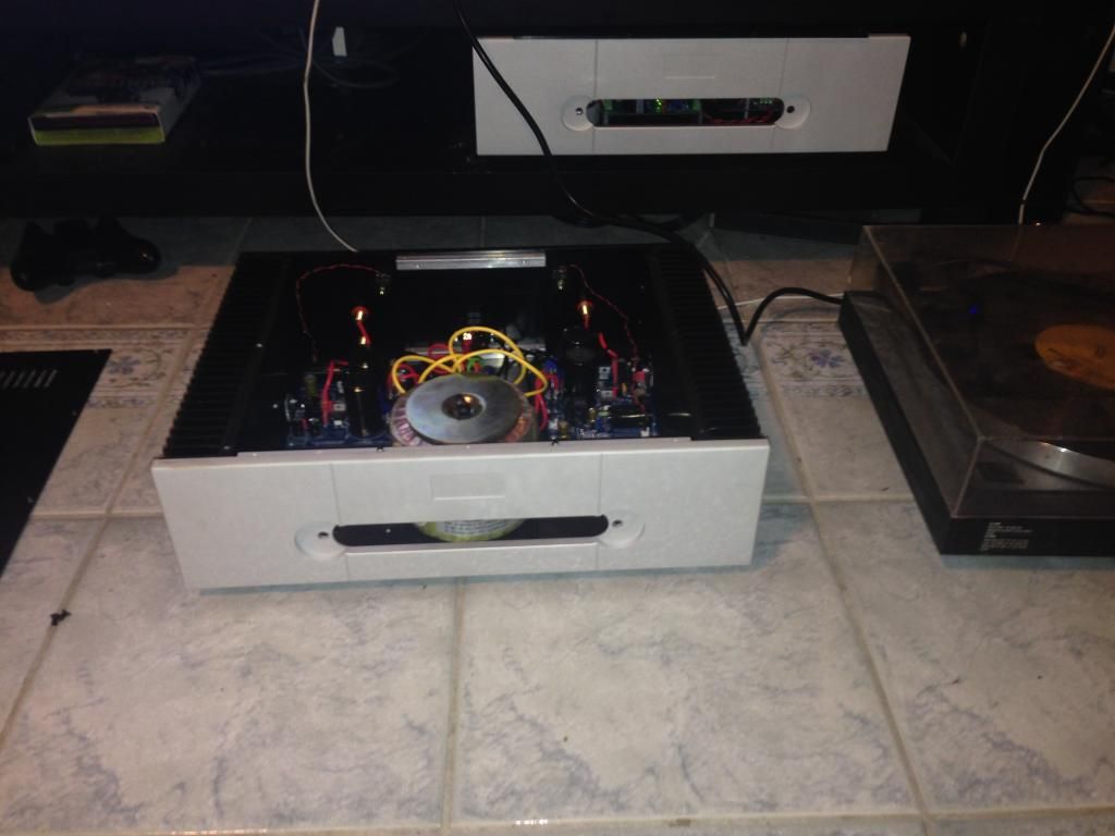

Well the amp works!
Good job! 🙂
Can you share what was the problem? Transformer's wires?
Gotta say it works very nice, just need to install the power switch and some cleaning up of the internal and external and i am done.
Nice build, keep us informed with your impressions on audio performance.
