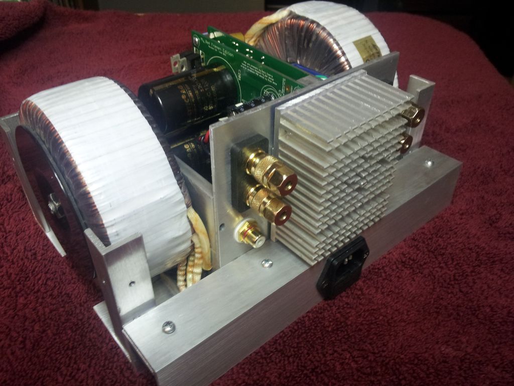

At last my amp is singing 🙂
I've had a few problems with one channel, a solder bridge under the lm318, but reading the previous pages of this thread i found the solution.
I wish to thank all of you guys, and especially Dario, for his work and for sharing his experiences with us.
A few pictures of my build...
