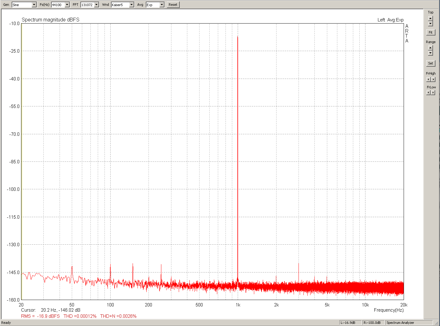

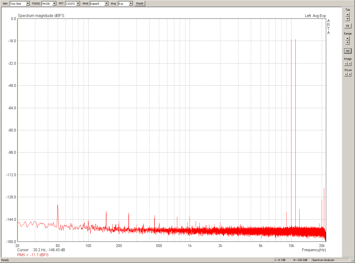

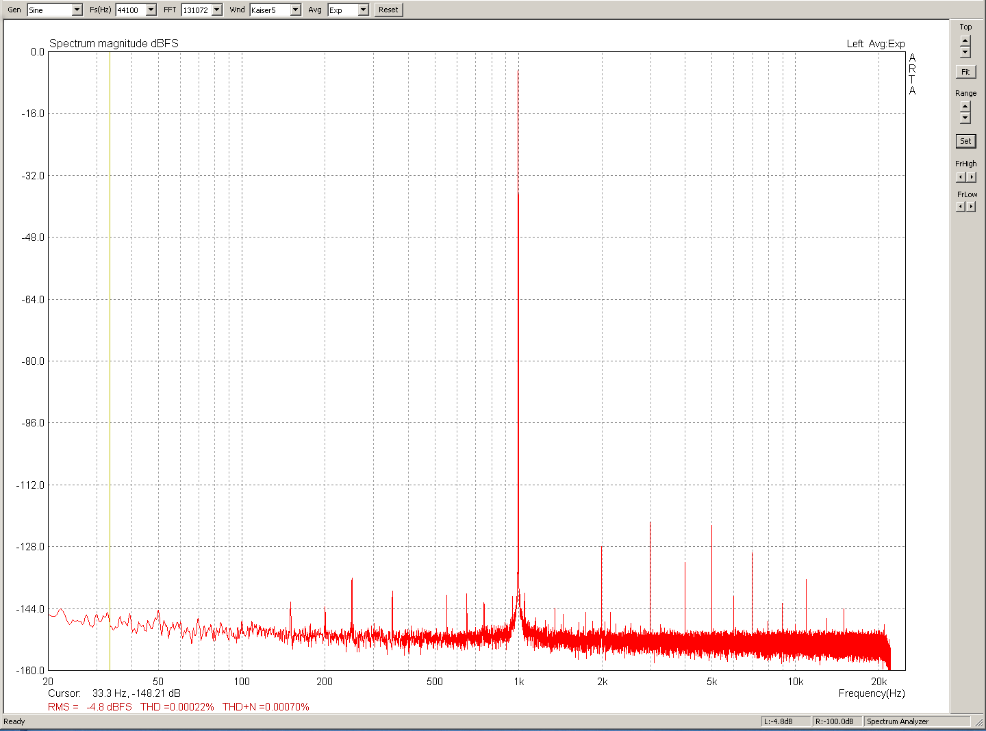

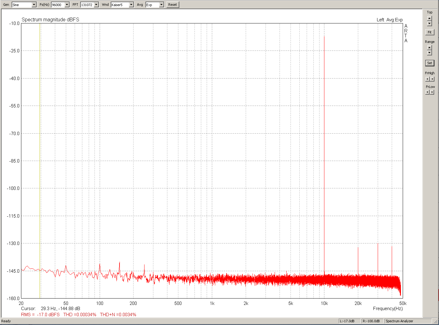

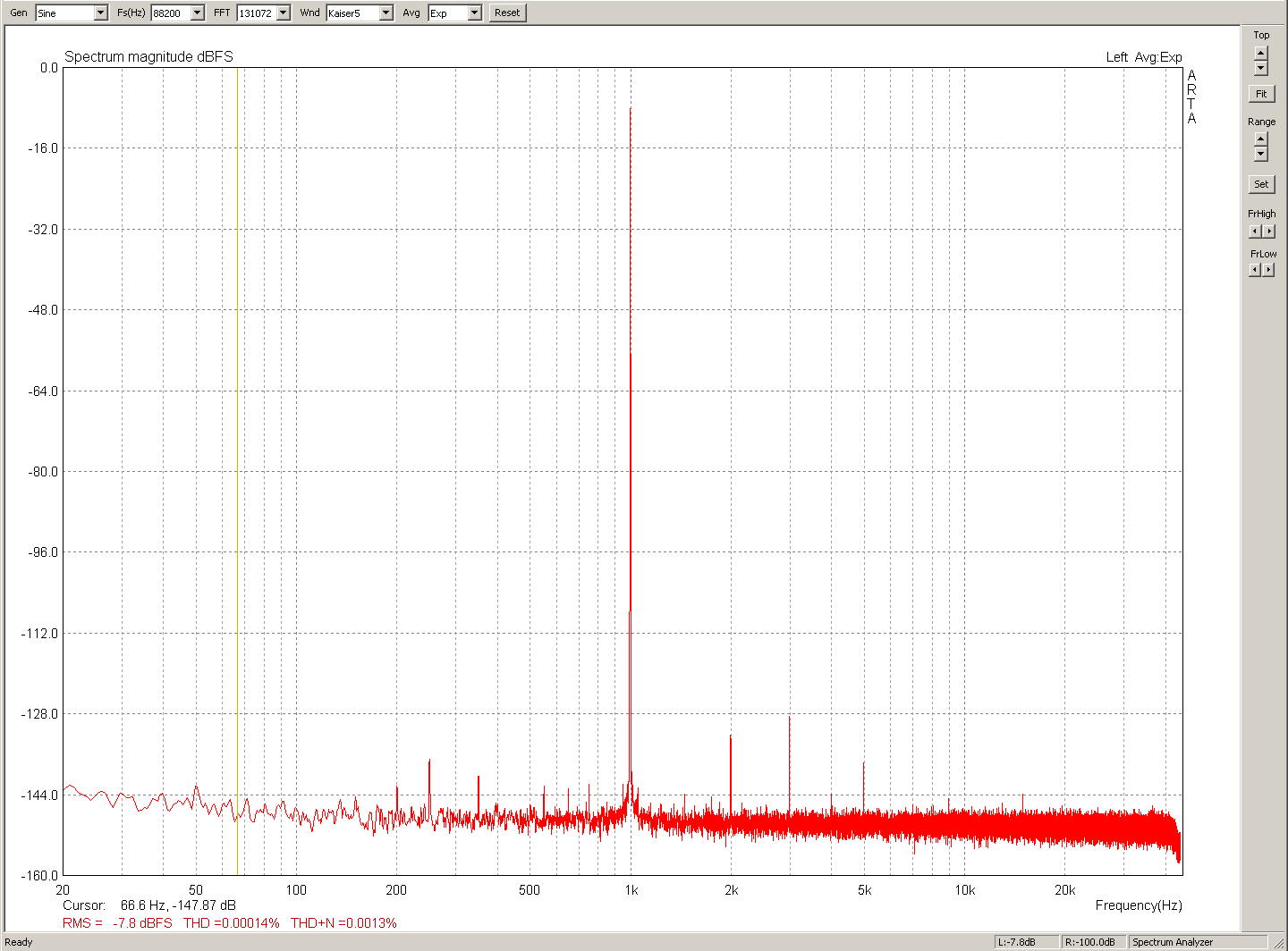

My_Evo measurements
Hi all,
It's a time that I had been playing - and enjoying much - Mauro's original Evo design. In the recent times we, in a small group, collected 3-4 units and played with some little mods, tweaking the sound.
In this process I had executed a series of measurements, too. Mainly for assurance that the mods did not destroy the performance.
I have noted that there might be some interest in measured results in regard the Myref topology. Mauro had done it originally, but with a bit less resolution.
I'm posting it here, because I deem this group the most active and maybe interested.. 🙂 No, I do not have Rev-E measurements.. yet.
The measurements were made with my EMU1616m soundcard, with the Evo amp inserted in the loop. I have tweaked the card settings to be around the sweet spot, so the amplitude readings are only always relative values. The real amplitude was always measured independently. The load is 7 ohms, because my old faithful 60W load resistor have that value.
So, here it is the first series:
1KHz/1W/7ohm ; 10kHz/1W/7ohm ; 1KHz/14W/7ohm ; 1KHz/25W/7ohm

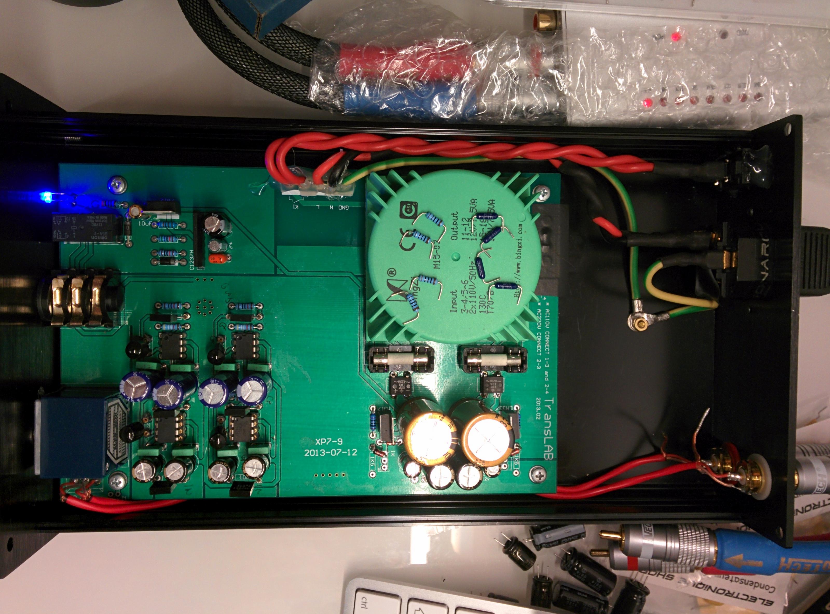

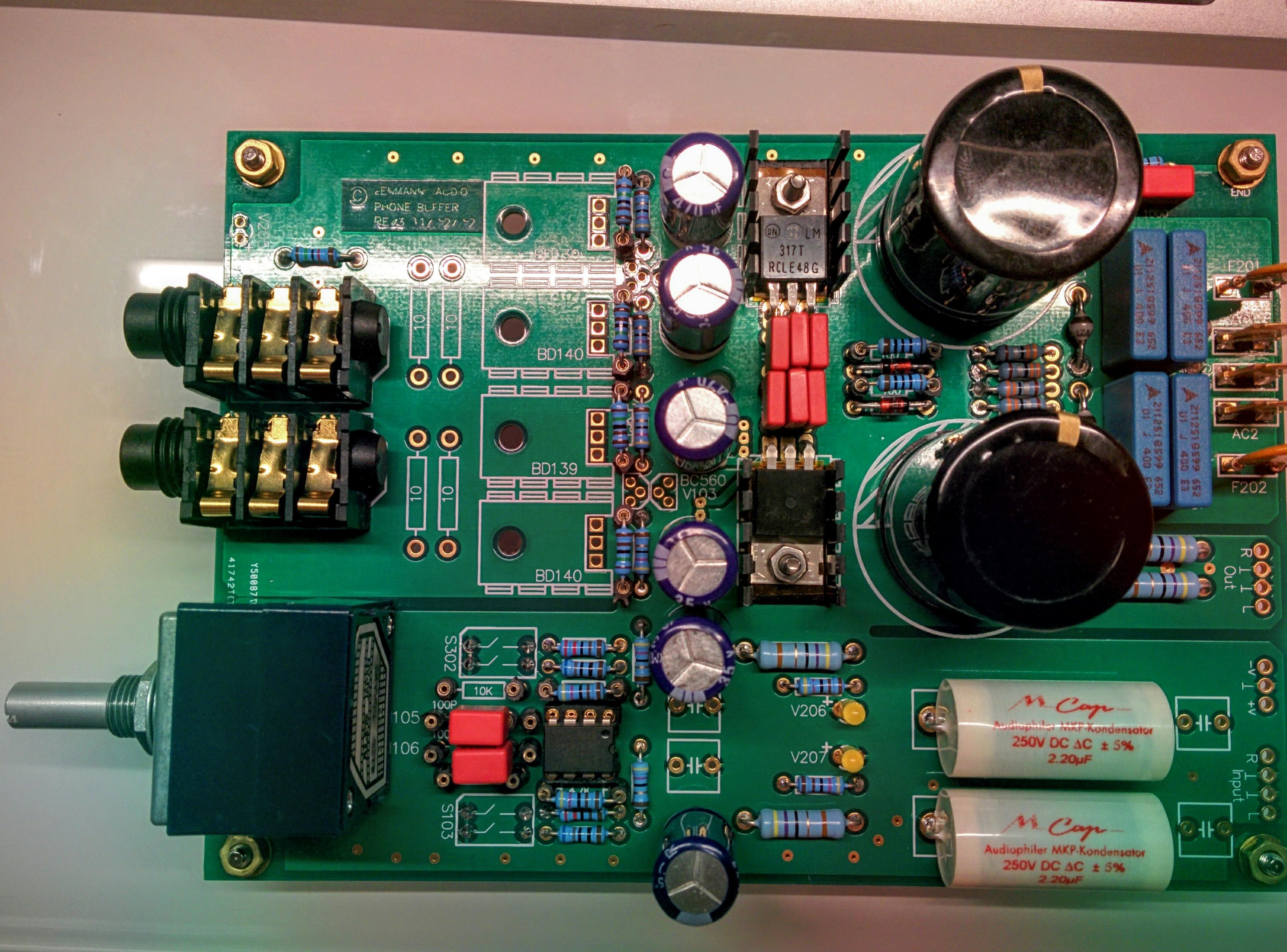

What are these PCB's? Headphone AMP? Are they available? What thread?😕
Both are headphone amps, chinese clones of the Lehmann Linear and the Emmeline XP-7.
If interested you can find them on eBay or AliExpress.
I'm thinking about open a thread about them but I don't know if it's fair, since they're both clones.
Just one thing it's sure, don't buy them with parts, better the PCB only and populate them with quality parts.
Both are great sounding amps.
