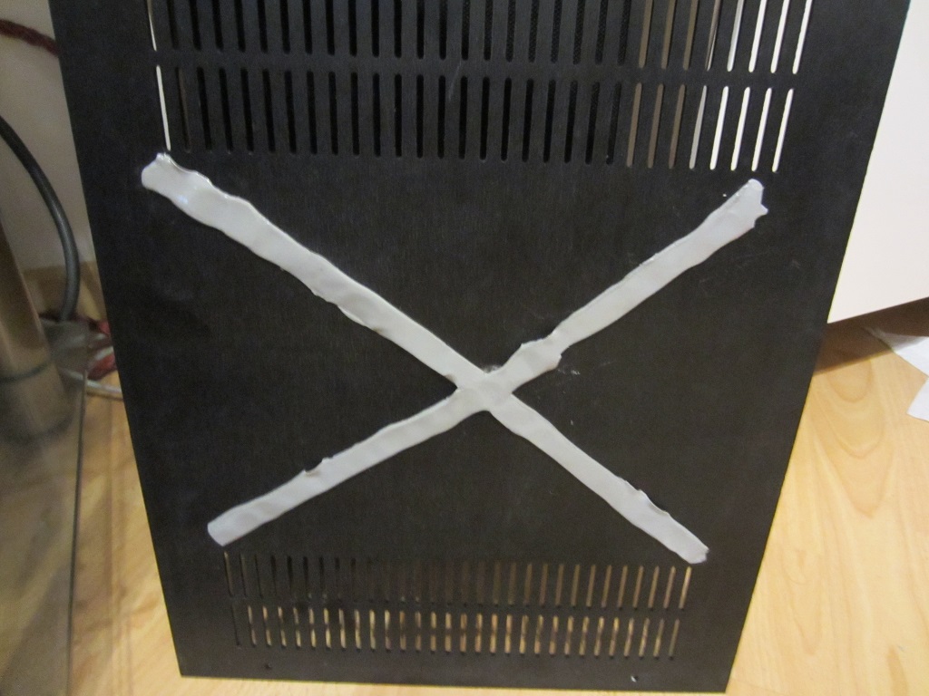

I think just having the cover on the enclosure reduces air borne vibration.
I think too that the cover reduces internal airborne vibration, at least by some amount.

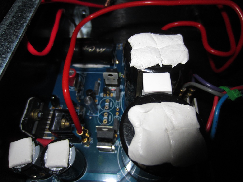

Dario, good idea to damp the caps.
I never thought of the big caps.
I've simply touched every surface hunting resonance, when I've touched the big caps... wow!
BTW, to sense it by touch I've had to use a very high volume, at disconfortable level.
Probably at lower volume the effect is much lower.

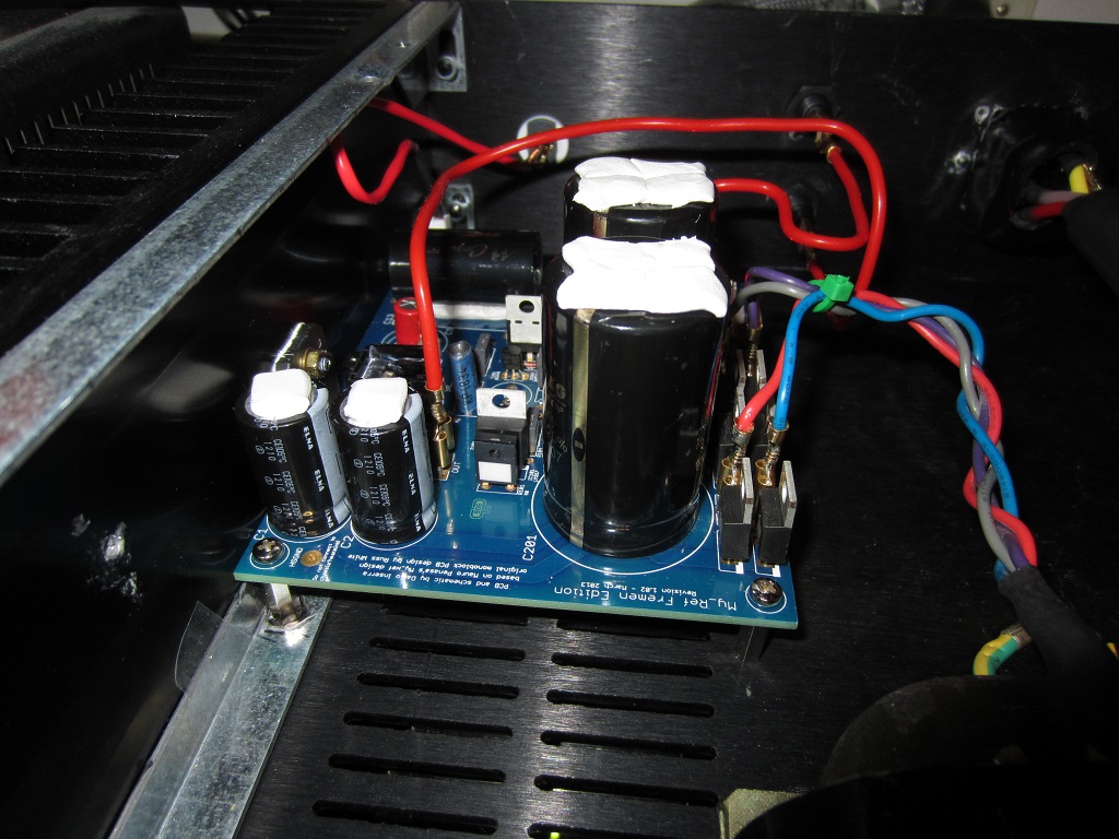

I've attached some pics more.
I've also added a small piece of rubber between big caps, another improvement.
I suppose that hot glue doesn't adhere very well, but I always thought that hot glue would be a good damping material is I could figure out the correct way.
Yes, hot glue works pretty well, I use it on my cross-overs
Are your big caps the snap-in kind or the ones with the sticky foam pad? I had hoped that the sticky foam pad would have helped in this situation, but perhaps not.
They're the foam pads ones but I never glued them to allow reuse.

I prefer silicone window sealer as a glue.
Compared to hot melt, it holds stronger, it is more resistance to peel, and it is softer and thus less likely to vibrate and may damp other vibrations better.
I would not cover the exposed metal in case it interferes with heat dissipation.
I actually glue that exposed face to the chassis base plate, thus using the coolest part of the chassis to help cool the capacitors. This also leaves the leads available for connecting by hardwiring and as test points to check voltages and ripple via a scope probe.

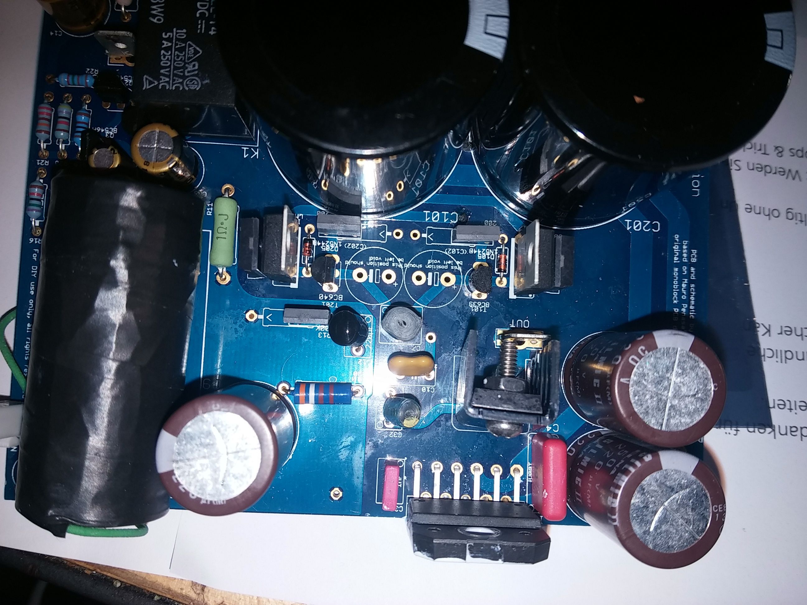

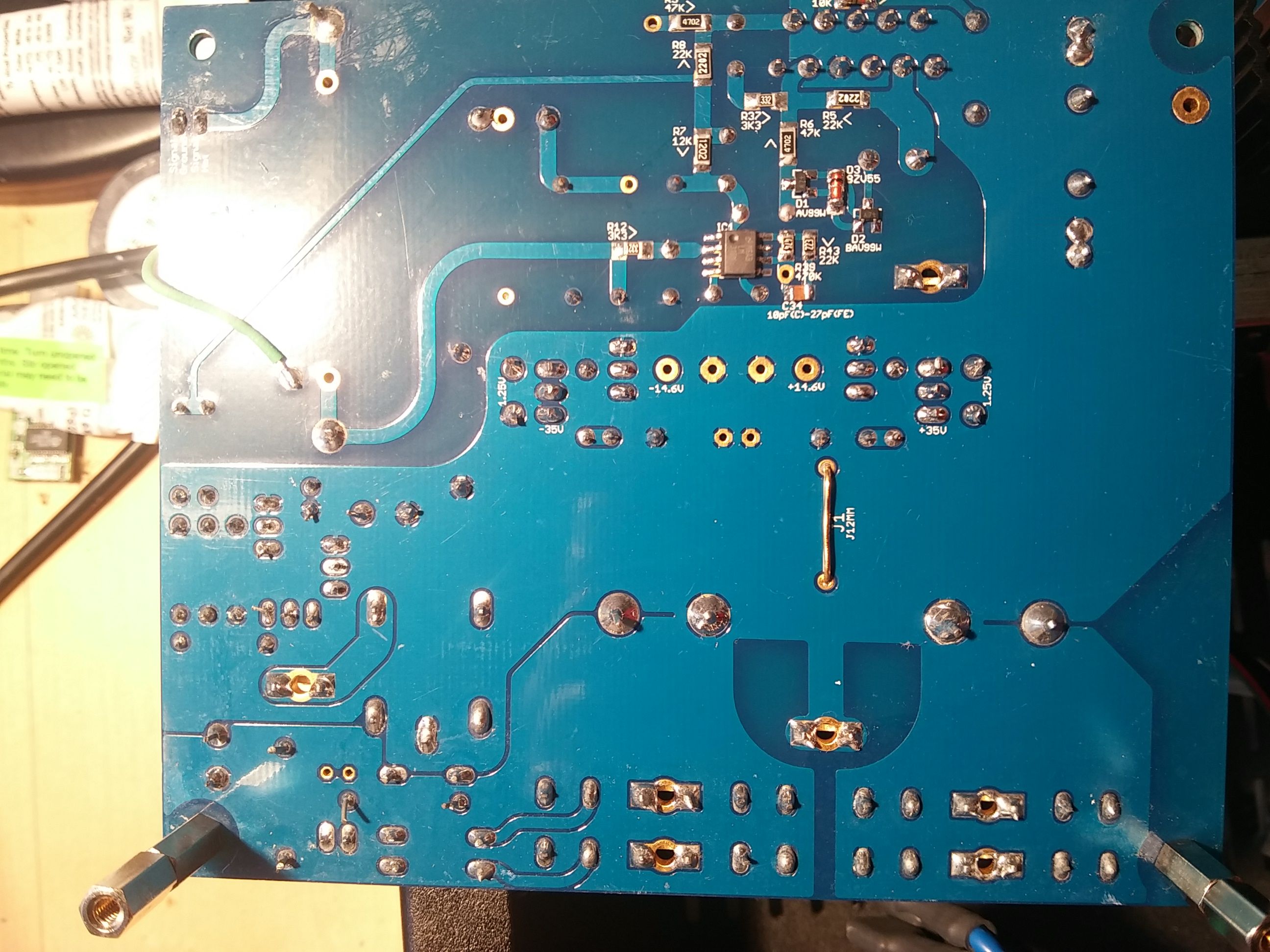

Hi everyone,

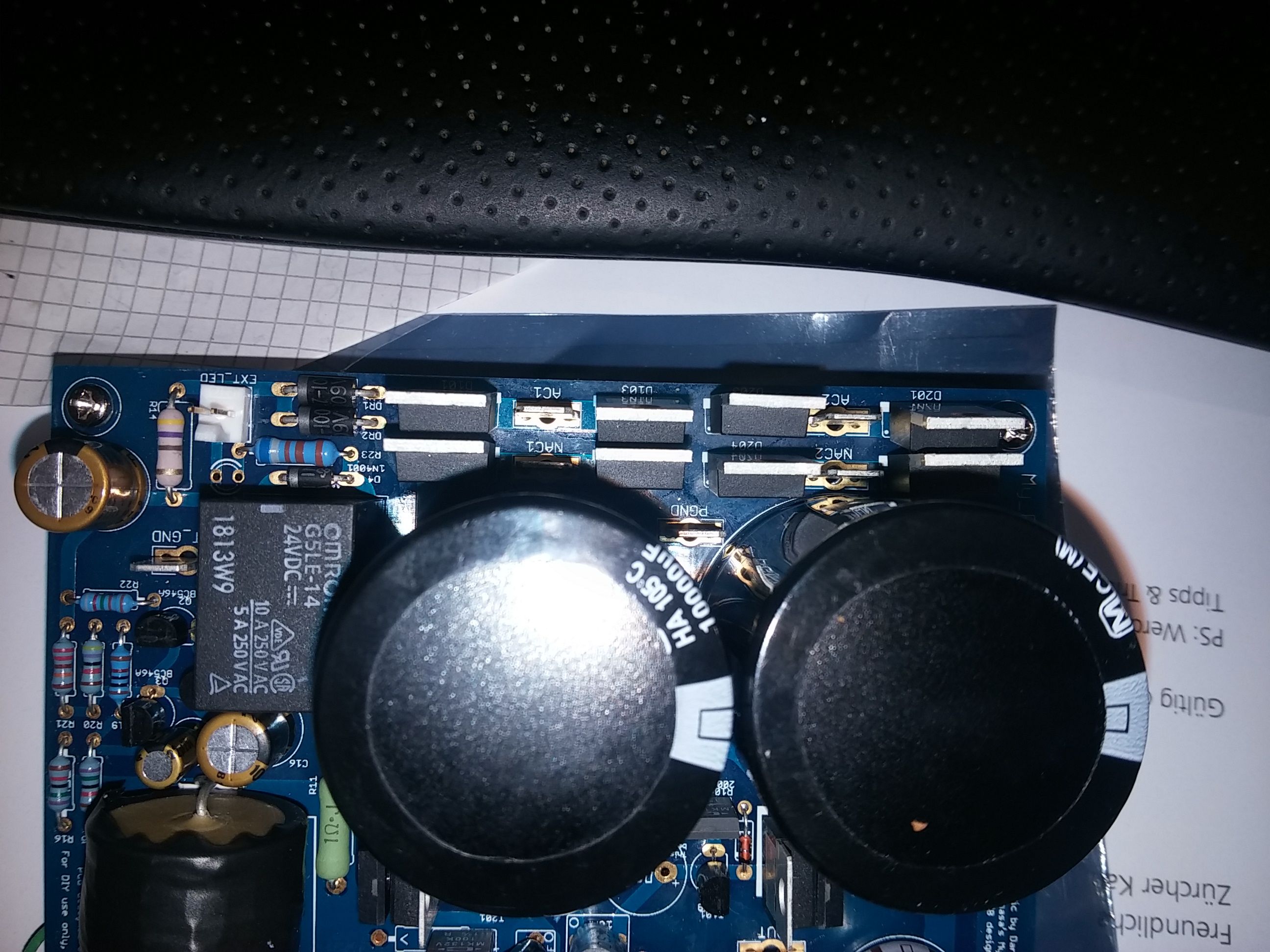

I'm back with a new, troubled FE build. I assembled the boards a while ago, cleaned them thoroughly afterwards and on the first power-up, I was ecstatic to see them both power up as they should, relays clicking simultaneously and all. However, when I attached a speaker to the right channel, with shorted inputs, I noticed that there was a faint but distinctly noticeable 100hz (at least that's what I think it is) buzz present that isn't there on either my previous build or the corresponding left channel, which is working perfectly. I've already tried cleaning it a few more times and I've also replaced D1 and D2, to no avail. The channel plays sound fine, it's just that the buzz is always there as well. The 14 rails are at -14.71 for the negative side and 14.40 (a bit low, no?) for the positive side - the working left channel has 14.65 and 14.5 respectively. Any ideas what might be causing the buzzing?

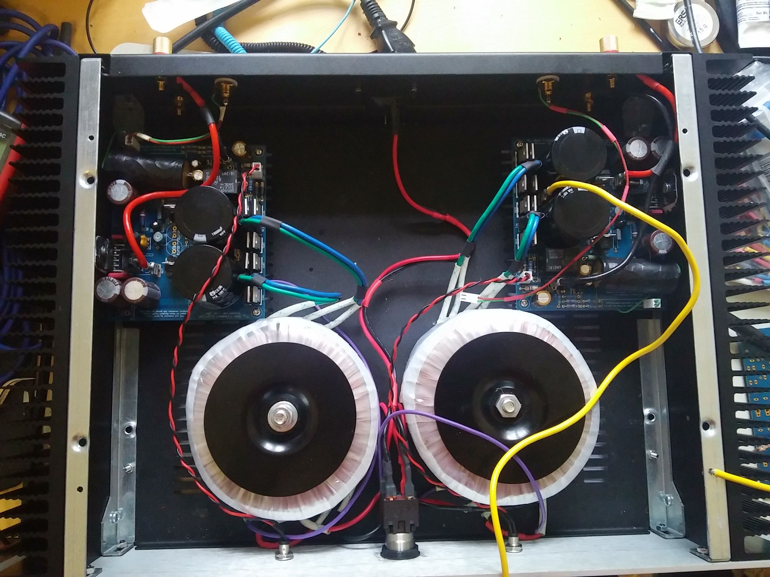

The input of right chanel is too close to Transformer,tray too move board away of transformer and see the result.
You were right - turning the transformer so it stands on the side fixes the buzz! Now the only problem will be finding another, more distant spot for the transformers such that the layout in the case is still symmetrical...
Thanks a lot for the help, I'll try out some different mounting positions and report back!

One other question. What is the green wire that appears to run from the board edge of C13 to somewhere under the board? If that has signal or signal return in it, it might be the antennae that is picking up the transformer noise. Perhaps shorter somehow?

No, the problem was definitely the transformer placement on the right channel, I moved it a bit and the buzzing disappeared. I think I'll have to mount the right transformer between the two boards to avoid the noise.
The green wire is for grounding the metal casing of the input cap - it can pick up some noise when it's not grounded.
Understood. By the way, what is C13? Is that the Vishay 735P under there?
One thought on the transformer location. I have had the transformer about 50 mm from the FE board without noise. Since these things don't need much heat sink, it would probably be possible to put both boards on one heatsink and the transformers on the other side. That might get you more space and not require the mu metal shield.
Just a thought.
Jac
I would use one of the signal ground pads on the PCB for that.
