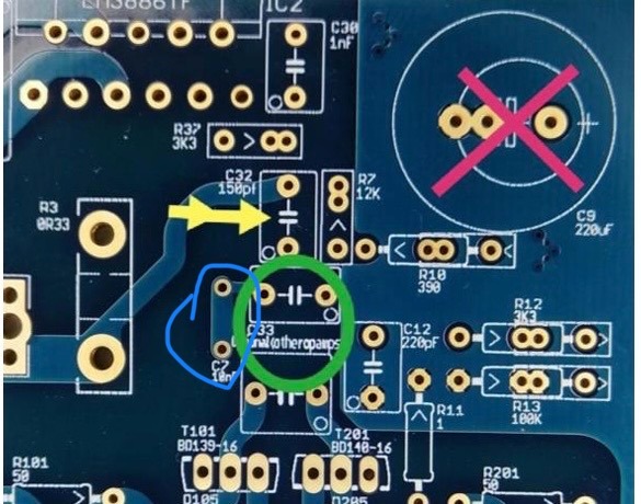

Dario, or any builder of V1.8 boards, does anything get placed in the spot that I've circled in blue or is that used if one wants to implement the resistor placement Joseph K was addressing in Post# 4959? I'm using ADA4627 as my opamp for information sake so a 5pF cap will be placed in C33 while R43andC34 will not be placed.
Cheers, Pete

Turion, the trace circled in blue for me is the trace which connects the opamp output pin to the local feedback capacitor (5pF as you named it). It should be left as it is.
For the rest, may I ask your intention? Do You wish to implement the series resistor (1k) tweak? Then the cut should be executed on the opposite layer, on a different trace(not on your pic)...
Thank you Joseph....I'm not going to implement the 1K tweak. I had tried it before (see #5010 and slightly beyond for discussion about my results) but I did it on v1.72 boards and wondered whether the circled blue area was put in place (on v1.8 boards) to avoid the tract cutting that was necessary.
So, nothing is placed in the blue circled area, correct? I was just wondering why it was placed on the v1.8 boards.
Cheers, Pete

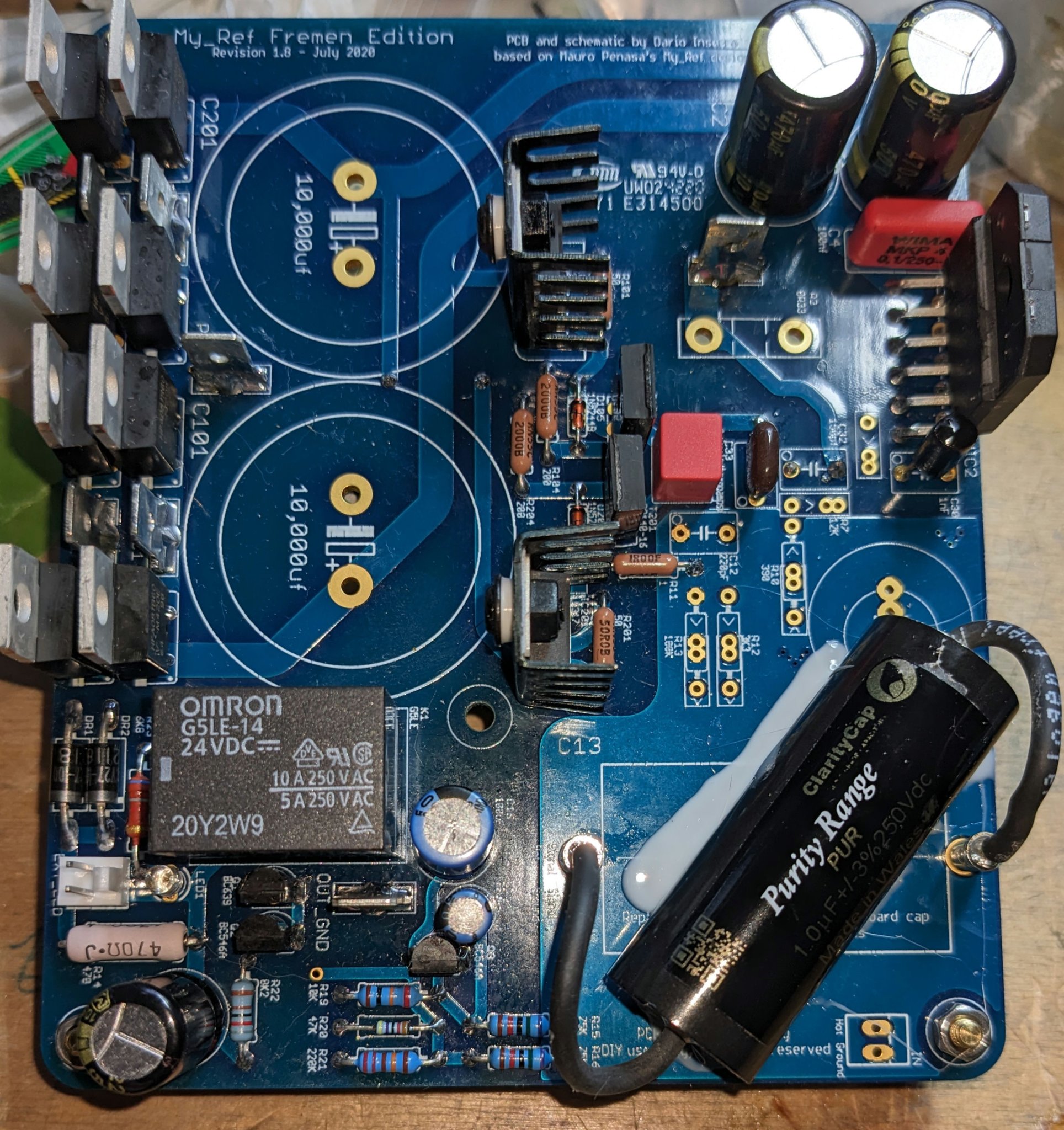

Well, finally got around to building up my boards from the 14th GB (v1.8) and wanted to show folks what to expect if you planned on trying PUR ClarityCaps (as suggested as a possible upgrade by Dario). All the three voltage variations are 45mm long so they don't fit in the space provided on the pcb (~35mm long) so you'll either have to off board them or use creative orientations. Since I'm using ADA4627 opamps I had the C9 position free so I adjusted in that direction. The wire leads on the PUR caps will have to be thinned out a bit (to fit the openings on the pcb) or you can, like I did, use Mill-Max 0490 receptacles (which still had to have their diameter filed down a bit to fit the holes) and just solder the leads into their openings.
My Z-foils, from Texas Components, should arrive today so I can finally finish them up & test them out. Will try both Mundorf MResist Ultras & Isabellenhuttes out in position R3.
Cheers folks
