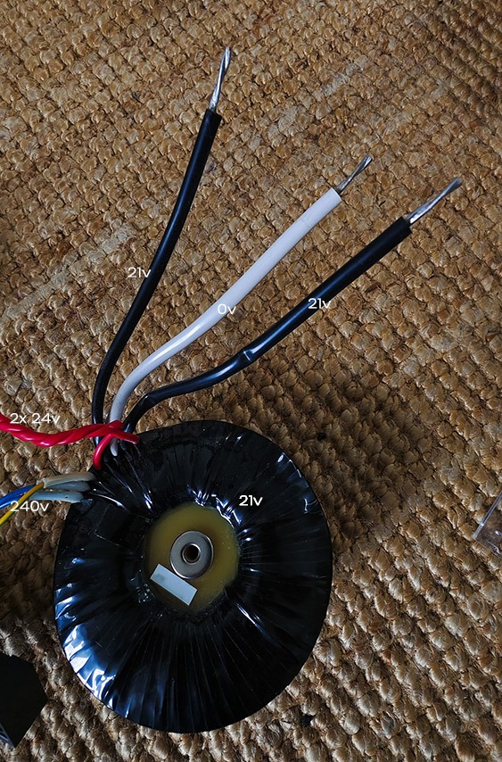

Quick question, how do you connect toroidal transformer when you only have 3 wires 21v - 0 - 21v ? can I split the white wire and connect it to NAC1 and NAC2, and take the 2 black wires and connect them to AC1 and AC2? My PCB is Rev. 1.7.
Sorry, you don't, they're not compatible with double bridge rectifiers.how do you connect toroidal transformer when you only have 3 wires
You need dual secondary transformers not a center tapped one like the one you have.
