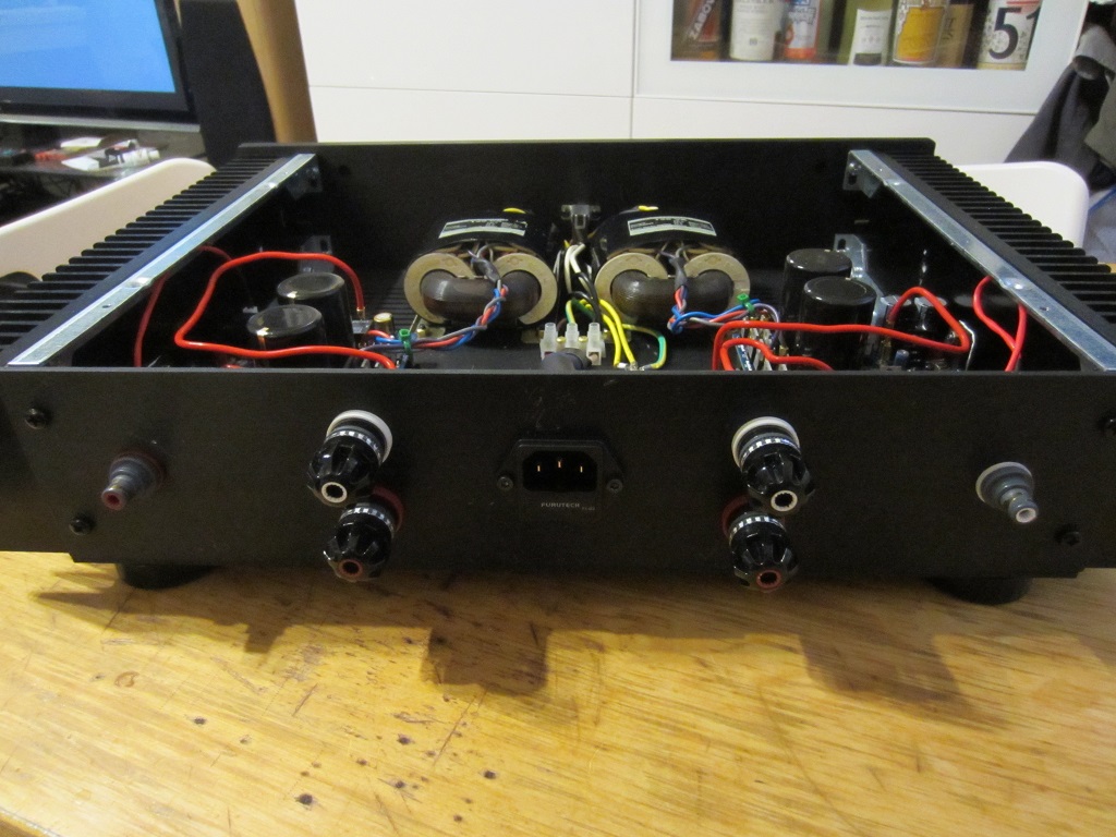

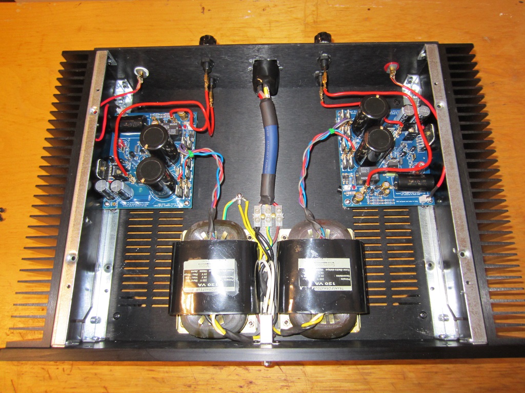

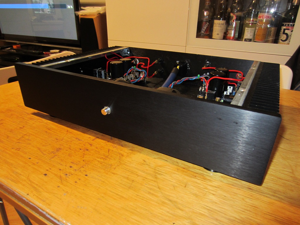

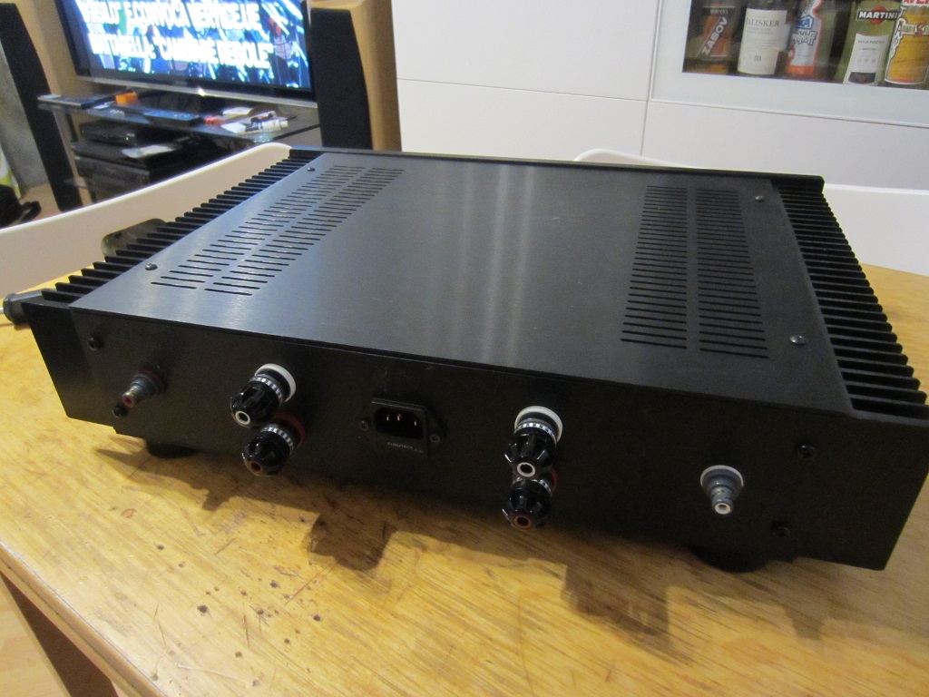

Finished my build... finally
Jac, maybe you'll be happy now... 😀
Dario,
Quality build, as we would expect from you.
Try putting some damping material on the floor of the enclosure, especially around the PCB standoffs toward the center where it is not supported.

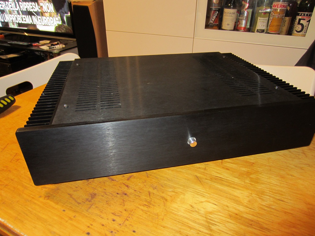

Thanks, Tom 🙂
In reality it's not completely finished, I've yet to mount a relay based switch for power on/off and also the PCBs are going to be replaced with a new improved version which will be in the next GB.
Experiment with damping is one of my next goals.
Dario, It's beautiful.
I should never tease you about this. My first build for my main system is still on the board. My preamp is on a board too. What is that, 3 years now?

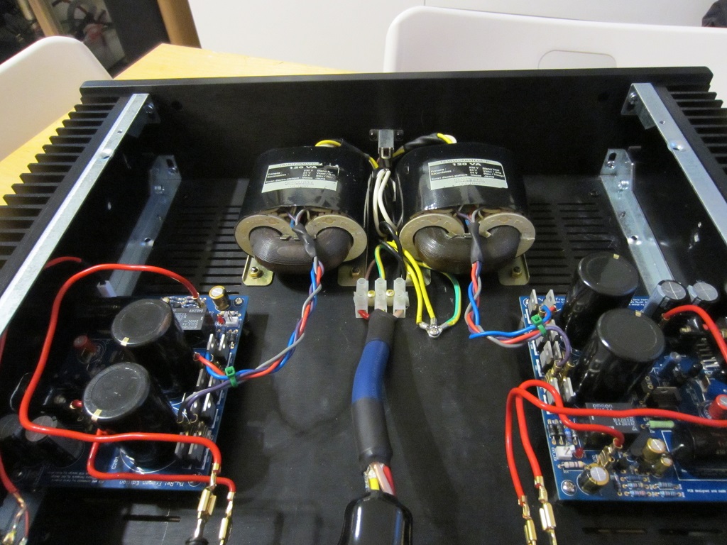

Just curious. What is the blue tube around the mains power wires in the middle of the amp? Is that electro-magnetic shield, vibration damping?
Jac
Thanks, Jac 🙂Dario, It's beautiful.
Why? It's been fun 😉I should never tease you about this. My first build for my main system is still on the board. My preamp is on a board too. What is that, 3 years now?
Yes, I think I've bought the chassis 2 or 3 years ago...
It's just a small piece of a shielded power cable (Furutech FP-3TS20)Just curious. What is the blue tube around the mains power wires in the middle of the amp? Is that electro-magnetic shield, vibration damping?

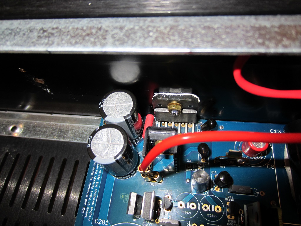

Today I did some tests with damping and discovered that the thick power cable somewhat dampens the back panel... It seems that no damping is needed there.
Space between boards seem to need some, though.
I've dampened the top panel, a small improvement.
What seem to need damping are the caps... Particularly C101 and C201 and to a lesser extent C2 and C4.
The improvement is interesting.
Did you damp the PCB or the caps themselves? I have often considered applying some sort of damping or stiffening to the center of the PCB. It's pretty big and unsupported in the center, right where some of the most sensitive components are located. Any vibration there is likely to add distortion. Those big caps might be "dancing" to the music.
Please tell us more about the "interesting" improvements. I have always noticed a better focus of details, sometimes making highs clearer while simultaneously reducing brightness. Too much damping, however, seems to deaden the sound, moving it back to inside the speakers.
The caps. I've put a bit of 'Blu Tack' over them.
I think the problem are the caps themselves, testing by touching the PCB does not resonate, while the caps do, particularly the big ones.
