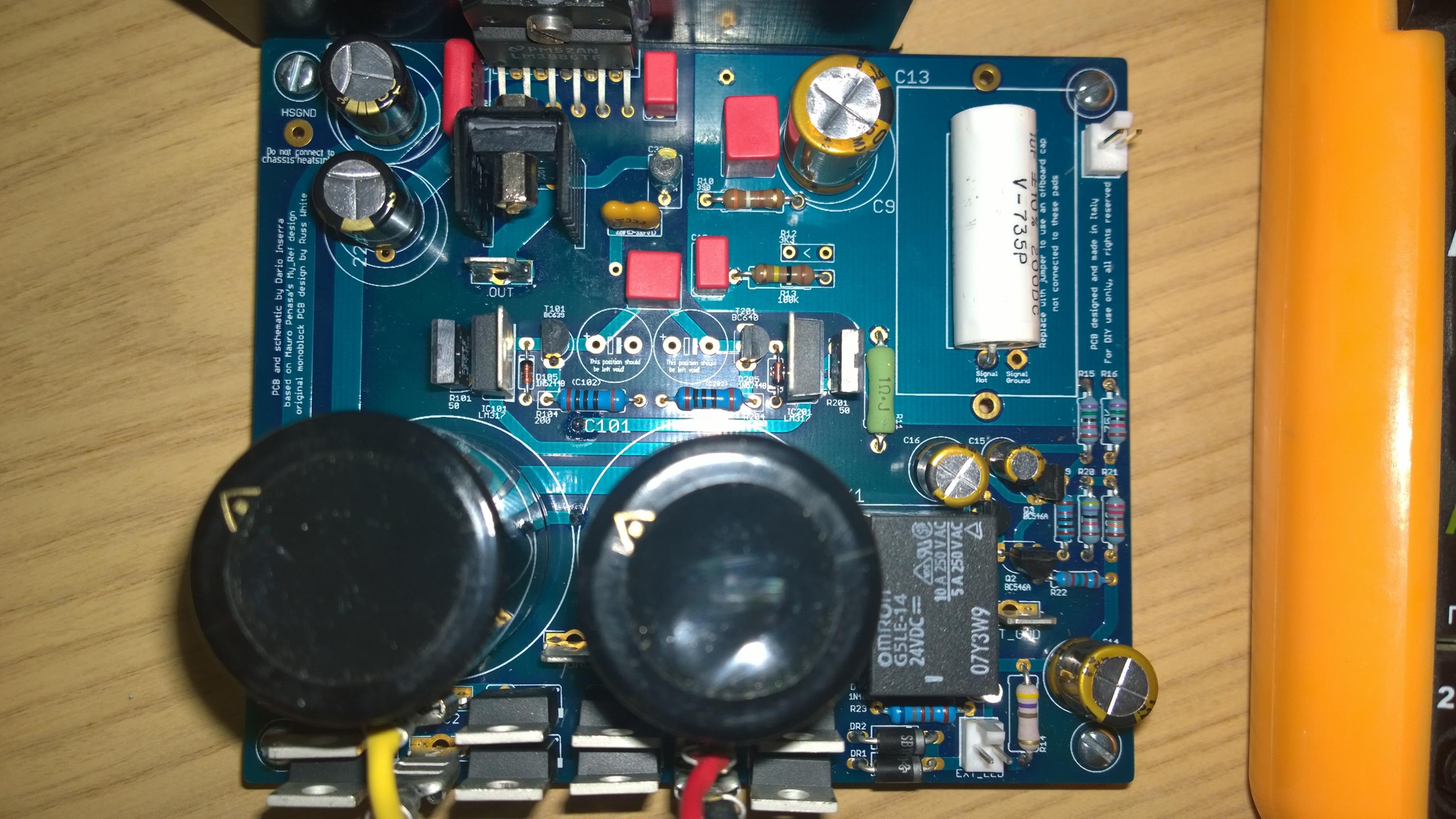

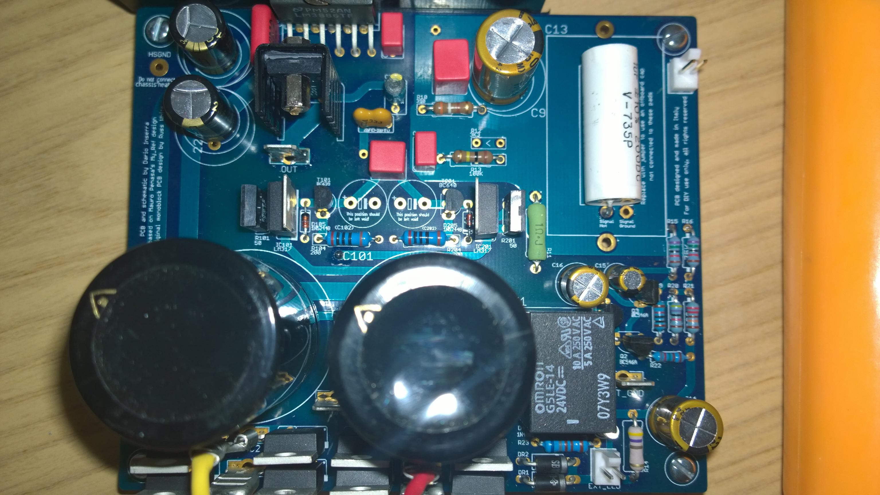

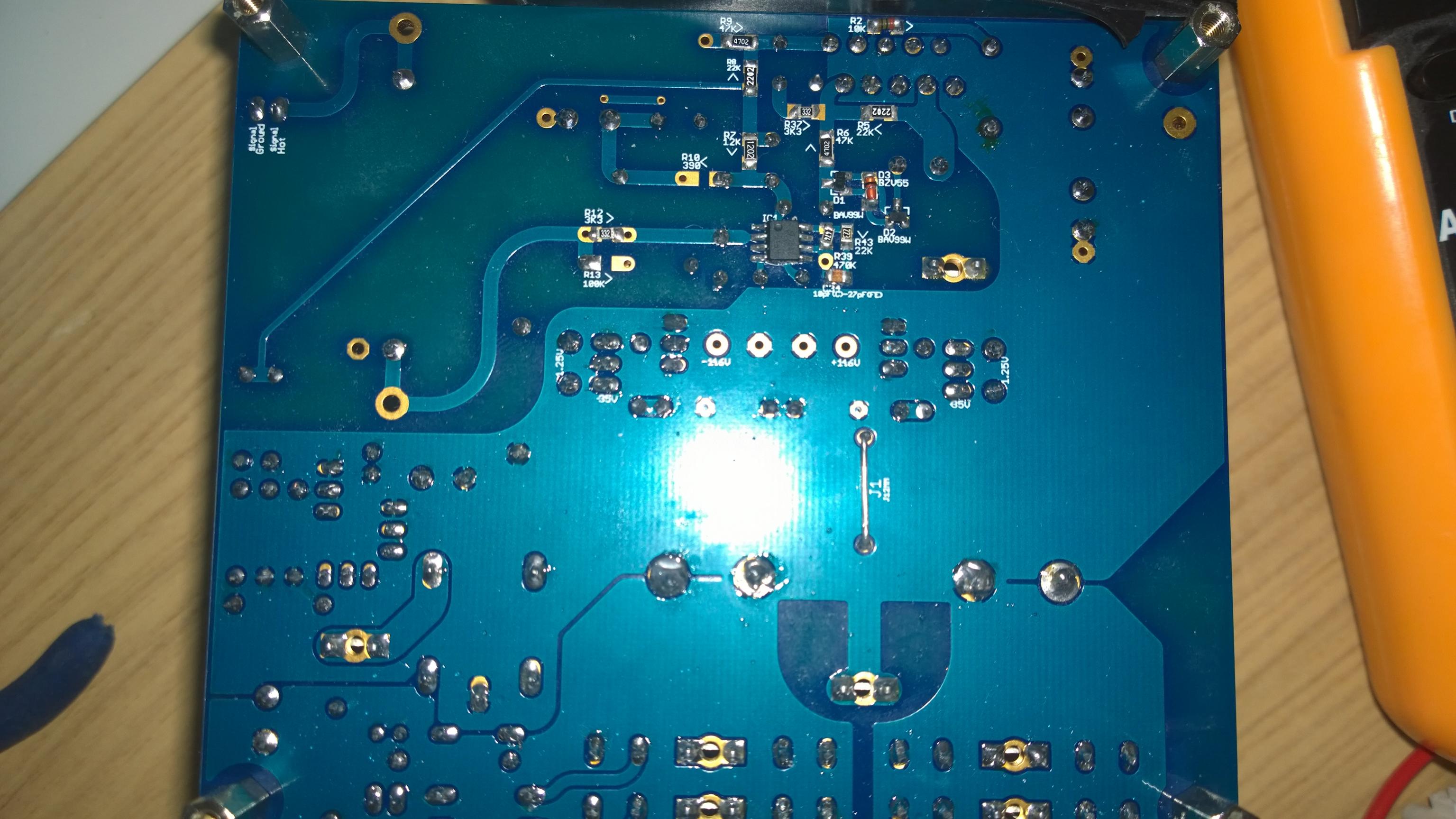

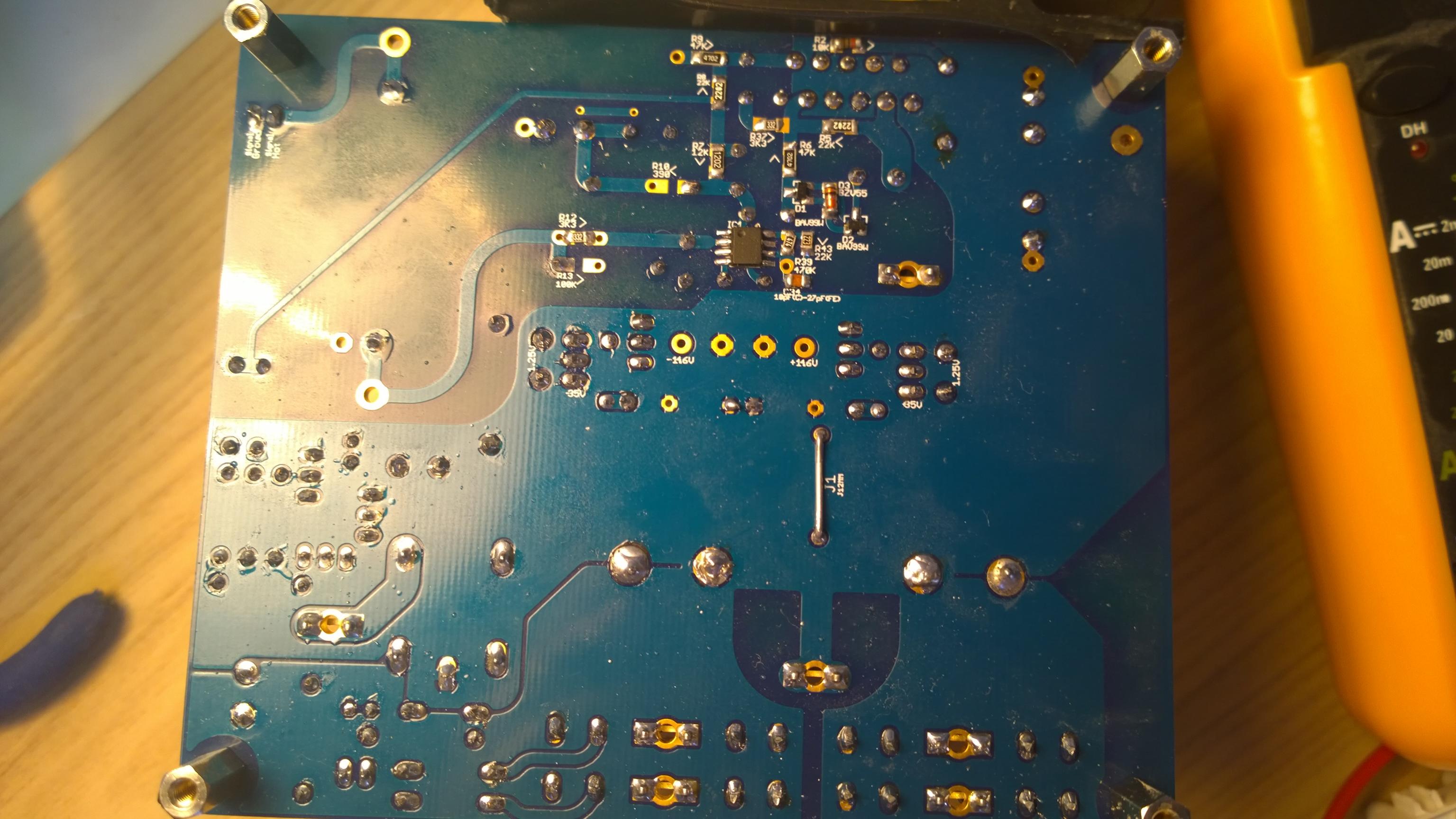

hello,

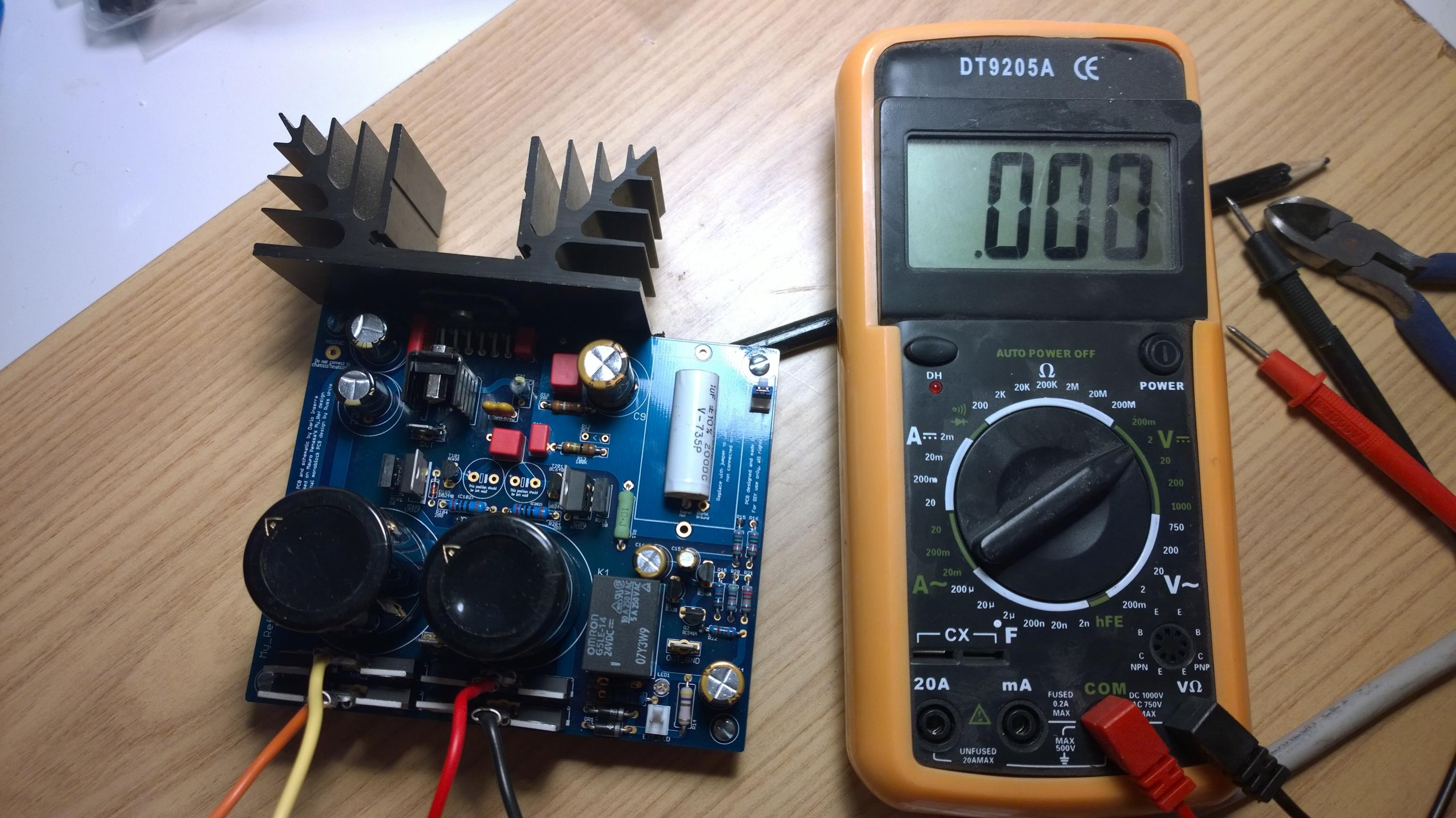

here are the pictures. However I also have doubts about how use the tester: I put it in AC or DC?

Good evening everyone and thanks for the support. Proceeding with the measurements I note 1,261 and 1,257 ( correct is 1,25). Between -35 and +35 points I 67.8 Between -14.6 and +14.6 i have 1,81
Between -14 and +14 i have 0.636.
I noticed that LM3886 not very hot (despite the small heat sink) while the two LM317 heat up a lot (I can not keep my finger on) I hope I have correctly detected the measure.
I hope I have correctly detected the measures, I performed with inputs and outputs disconnected and not shorted. I hope for your help
Ivan

I've re-done the measures with the tester by inserting a tip of GND and one on the various points, here is the result:
where should I have + 14.6V instead 1,05V
where should I have -14,6V instead 0,835V
where should I have -35V instead -34,2V
where should I instead have + 35V + 34,2V
Look a your help

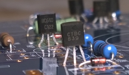

Hi square, Having read a bit of theory, pages and pages of posts and old books (at least to avoid stupid questions or trivial) last night I debugged the PCB. Since the problem was "close to the LM3886" I checked carefully in that area and so I saw the blunder: The BC639 traded places with the BC640.
After a difficult repair provider and to take measurements:

Hi Ivan,
good job, from the pics we will never discovered BC639 and BC640 were swapped. 🙂
