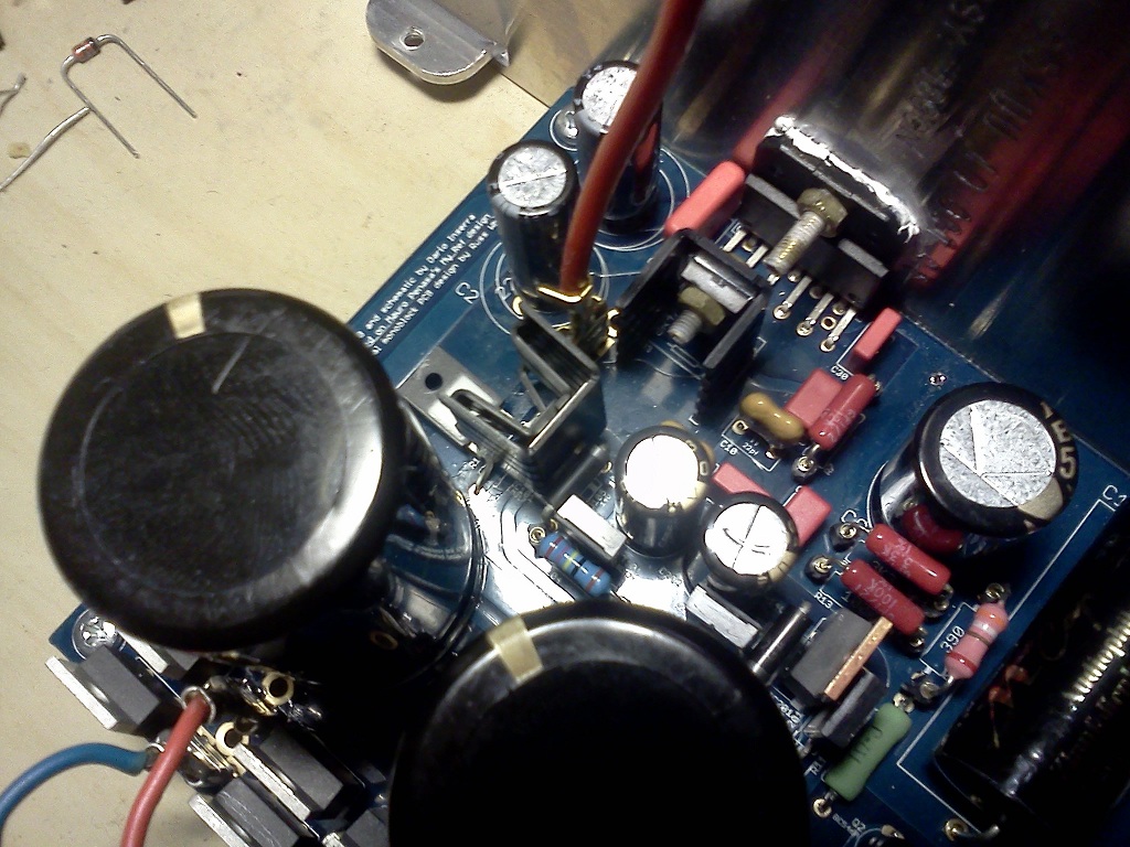

Hello,
I started to populate the board, obviously with many difficulties (it was my first time with the SMD).
Now I have a doubt about the direction of R13, R104, R204; because the tutorial shows the Caddock but not the KOA.
I looked for photos on the forum but I see that they all use the Caddock, not available on Mouser ...
thanks
Ivan

Hi Ivan,
I will let Dario respond on the direction of the KOA. I'm sure the KOA resistors will be fine, but if you get the urge to go for the Caddock's, Parts ConneXion has both R13 and R104 values. In Europe, HiFiCollective has the R104 value available. Of course, there may be other sources.
It's too bad that Mouser dropped them.
Jac
Jac
It's not so... but maybe it's not so clear
On tutorial's page 16 it's explained how to determine direction for axial KOAs (talking about R10), the tolerance band goes toward the direction of the arrow indicated on PCB.
Two pics from the beta thread:
As you can see the brown tolerance band goes in the direction of the arrow.
Are there resistor that have direction?
No, as obvious, resistors are not directive, they work in both directions.
But, according my listening tests, they sound differently according direction. Some a lot, some a very little bit.
Usually in one direction sound is more 'impulsive', bigger soundstage, super-dry bass, in the other more natural, fuller and with a rounder bass (the latter is the correct direction).
Obviously we're talking about a maniacal optimization...
