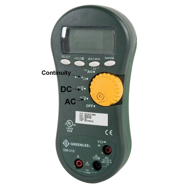

That's what I did when I lost the working channel, Heatsink on the table, boards up to measure. Wonder if my 3886 has a cold joint ? I don't completely understand my DMM. It has two V settings. One is V~ 200 & 300 and one V --- with a line above the dashes. I think the continuity setting looks like a diode symbol ->l so which one should I use ? Which setting should I use for DC offset ?

V~ is AC and the other is DC. Everything before the power enters the PCB is AC - after is DC. Continuity looks like a horn bell or a speaker and should beep when you touch the probes together. Can you post the brand and/or model number of your DMM?

I have a Ryobi but it is functionally identical to yours. The three with arrows are all I use 90% of the time. There should be an auto-range option that takes care of the values without the need for user selection. The select button should cycle through the options for each item on a position of the yellow dial by showing the matching icon in the window.

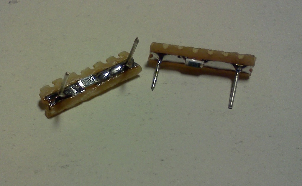

Maybe I can get some Caddock to replace the 68R and get some Susumu in place of the PRP I have now. If it only adds a few dollars to the order, why not ?
You can't mount permanently the Susumus on the beta boards, to test them I've used an home made adapter.

V~ Everything before the power enters the PCB is AC - after is DC.
I'm sure everybody knows this but just to be double clear...
After the diode bride voltage is DC.
I went and refreshed my understanding of bridge rectification here.
Rectifier circuits : DIODES AND RECTIFIERS
I hope I'm not being too pedantic I know this is real basic stuff, but it helps me to go over the basics.... electronics is still all mystery and magic to me 🙂
Why ? silver

See the attachment, I'm not sure you can solder that thing... but you can try 😉
