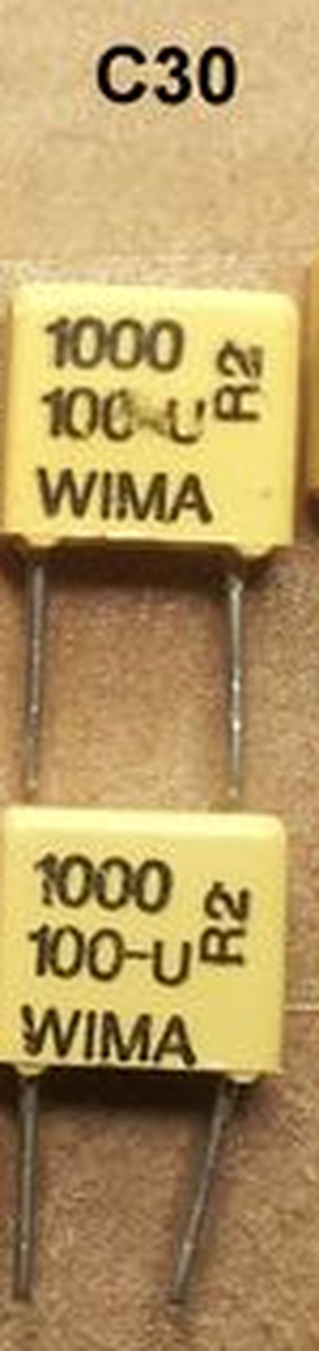

I guess I should comment on some mistakes I made. Somewhere in my messing around in the past few days I attached non-paired leads (secondaries) to the power tabs on one amp. The fuse blew with no damage to any component. Yesterday, at the end of the swapping session, I left C30 out of both amps. When I powered up again all manner of lights, clicks and hisses scared the heck out of me. Putting them back in and using the dim bulb, all came back to normal operation. Don't know what could have happened but those two screw ups demonstrate to me good stability and protection in this design.
Huh, C30 is pretty much the main compensation capacitor (in fact, the real deal is R37, C30 just blocks DC and audio frequencies). If omitted you get a perfect oscillator. 🙂

Test #4 - C30 - Wima FKC2 1nF. The orientation effects the width of stage just slightly.
I then went back to the Euro KP1830 and can confirm the Euro is cloudy and dispersed - more difficult to pick out individual voices/instruments. I them went all the way back to the stock Wima FKS2 from the BOM. I would call that the most musical with the FKC having a slight edege in clarity/shine. I would not special order the FKC as opposed to some other parts. Not a whole lot of significant change here, other than a thumbs down on the Euro.

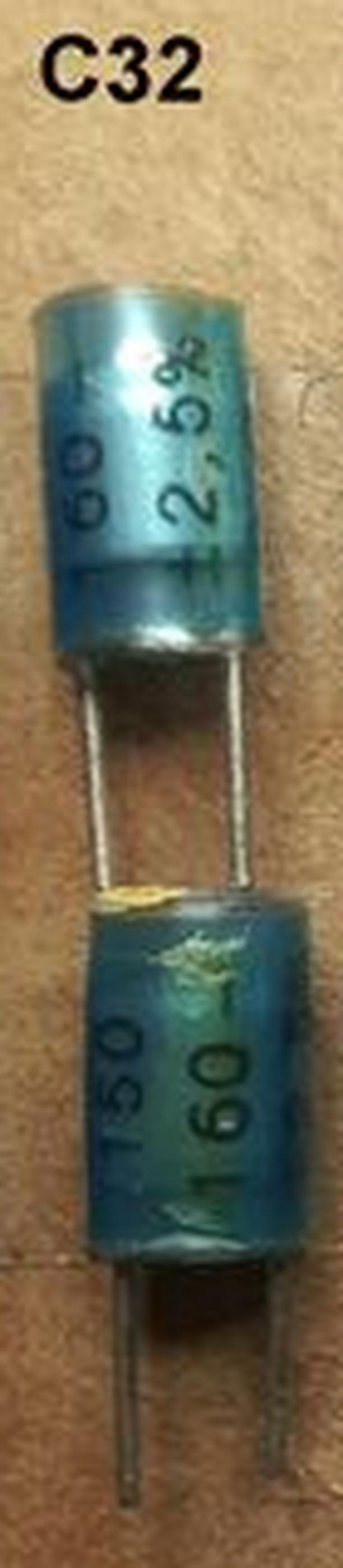

Next up C32
Next up C32

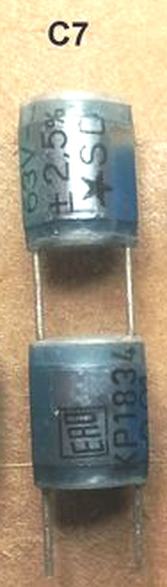

Quick test #5 - Euro KP1834 150 pF
A definite keeper. First impression was depth of stage improvement - that ambiance extension. Very musical and clean image. Great detail and separation. The trumpets have a real nice bite without sounding piercing.
Unfortunately, I believe these are among the group of no longer manufactured caps and are hard to find. If you see some and the price is right - grab them.
C7 next.......
C7 next.......

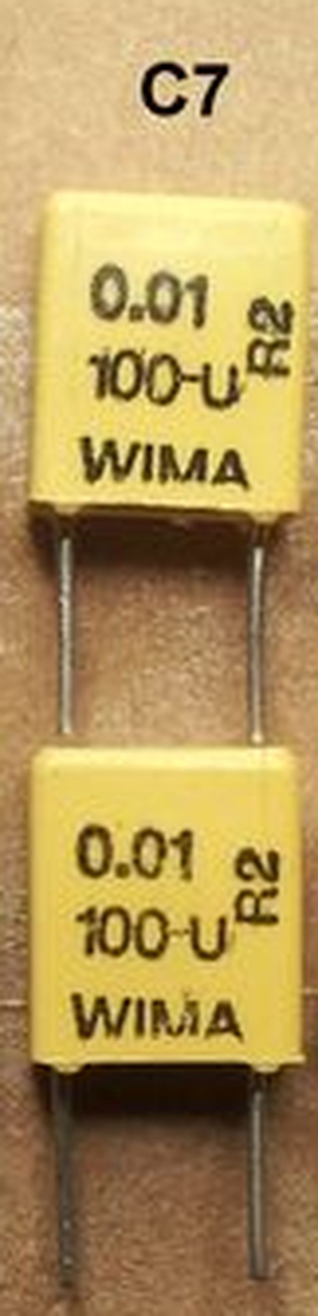

Quick test #6 - C7 - Wima FKC2 10 nF Poly-carbonate film/foil.
Now we're getting into the good stuff. This one has that "lifted a thin veil" effect. It retains the musicality and bumps up the "realistic" image. Can't quite tell if the front to back is better but it certainly didn't take anything away. For orientation - there is slightly more punch and bass (including control) with the writing facing away from the LM3886 chip. This one actually made me smile.🙂
