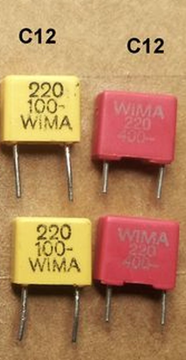

Addendum - I neglected a very good option, Wima FKC2 220 pF Poly-c flm/foil for C12. There is a very clean image with this cap (yellow) that just beats out the FKS2. A very smooth & warm character with good 3d presentation.
The orientation was interesting as I heard more and deeper bass - less kick drum on the Big Band part with the writing side toward C13. Reversing it switched the prominence of those two. That's nit picking for sure, but demonstrative of how a builder can customize to their liking. For me the FKC2 stays in.

Dario, the original sounds good but to me, not quite as transparent and a little less warm. They are all close and I think this spot will take more extended listening to confirm what I hear.
