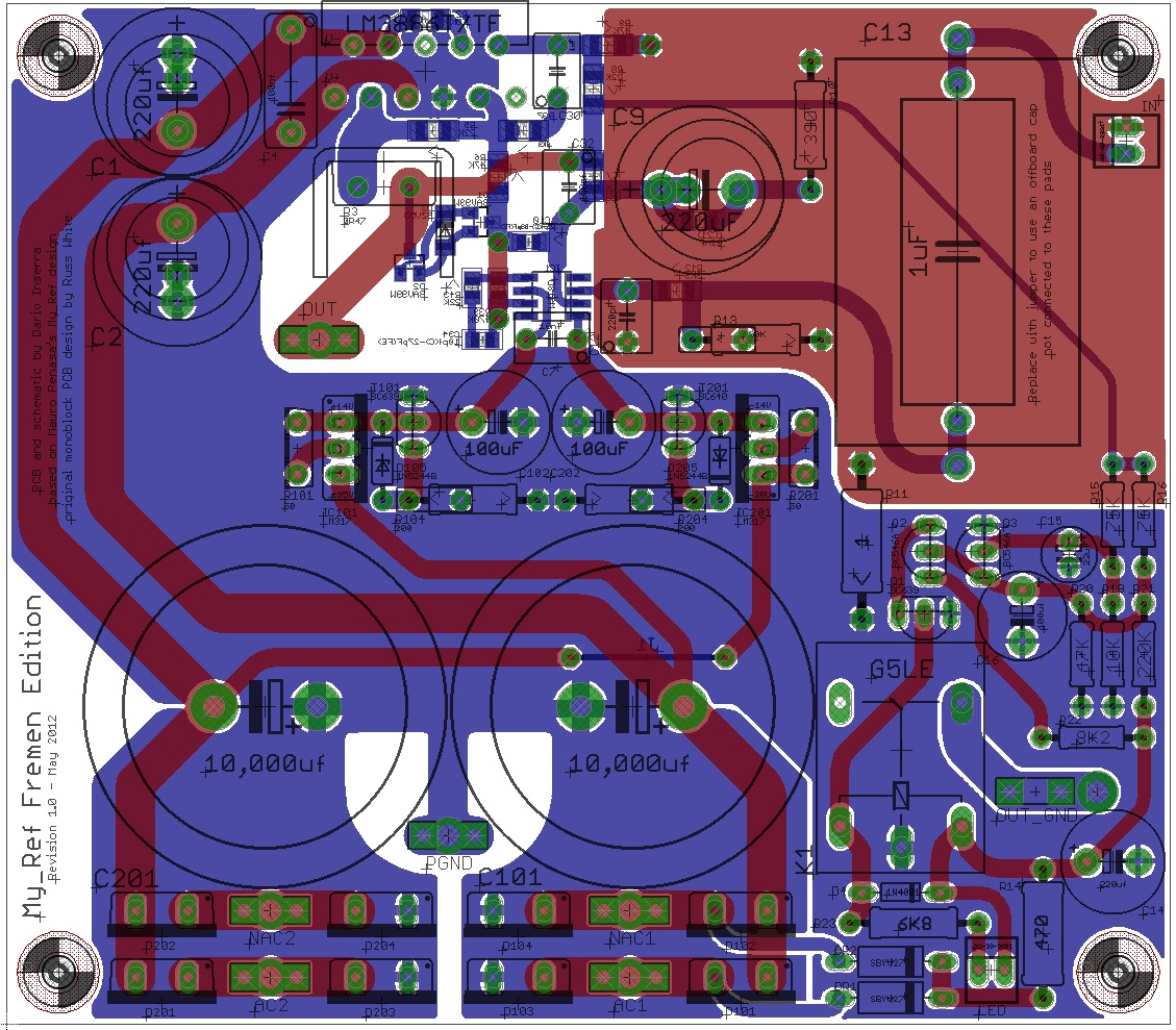

Release Candidate PCBs and schematic
I've attached the first version of the Release Candidate PCBs layout, schematic and preliminary BOM.
Rev A/B compatibility has been removed.
Main changes from beta boards:
  • R12 and R7 are now SMD to use the superb Susumu
  • R13 is a Caddock MK132 (the position fits both Caddocks and 1/2W resistors)
  • All Caddock MK132 positions can fit less expensive 1/2W parts
  • LM318's compensation networks now use SMD parts only
  • All boxed capacitors have indicated outer foil (direction)
  • All signal resistors have indicated direction.
  • C13 is now Audyn True Copper or Vishay/Sprague V-735-P
  • Big smoothing caps now can be 35mm
  • All faston positions have an integrated wirepad
  • LM318 PS now uses LM317s for both polarities (better rejection)
  • Thermals have been reduced by 20% for easier soldering
  • Clearance between pads and ground planes has been increased from 12 to 16 mils for easier manifacturing.
  • All holes are aligned to a 10 mils grid for easier manifacturing.
The BOM is final (maybe... 😉 ) for the Mouser part, still in progress for the 'Suggested Best Part' AKA audiophiles/boutique parts.
Comments and suggestions are welcome 🙂

Hi Dario - looks nice! I do have some suggestions (which may look a bit radical, but are actually fairly simple to implement - maybe 1-2 hours work at most).
1) Make both ground planes on the same layer (bottom).
2) Shift all the tracks in the small-signal area, as well as (almost) all the SMD outlines, to the top layer. Only a few components like C7 and C32 have to be shifted slightly to prevent mechanical interference with the SMD components.
3) A few tracks (1 or 2) in the small-signal area (which cross tracks on the other layer) go to the bottom layer.
What it achieves is that you can use a single silkscreen on the component side only, which allows the use of high-volume PCB processes which may reduce costs by half. When two silkscreens are used, some processes (including PCBPower's Verified flow) cannot be used, and a more expensive flow like Verified Plus has to be used.

Hi Siva,
thanks 🙂
Using standard production processes PCBCart difference between two side silkscreen and one side only is 1.2€, PCB-Proto (the Italian manifacturer) carries 18€.
It translates in a difference of 0.45€ per PCB (0.03%).
Not worth the effort... 😉
In addition having SMD components on the upper side has a major drawback:
If you need to replace for whatever reason a SMD part (like I've had to do to replace a defective LM318) you need clearance and you have pratically none if you mount SMDs on the upper side.
My 2cents, 90% of all the problems I have had with all my LM3886 (other than not paying attention to detail) are due to the loss of vias (metal sleeve passing top to bottom of PCB) on thru-hole and/or the loss of a pad due to excess heat.
Unless a builder uses sockets this problem may be somewhat significant for tweakers. IMHO, the elimination of as many as possible of those via spots would be beneficial.
The solution may just be in the manufacturing process/specs - but I for one would pay a few dollars more for a board crafted to lessen the possibility of thru-hole gotchas. :2c:
Mmh, this problem is common on all PCBs in general, even in single layer ones it's possibile to destroy the PCB...
I can't see how to improve it in layout... do you have some specific ideas on places to be revised?
The solution may just be in manufacturing process/specs - and I for one would pay a few dollars more for a board crafted to lessen the possibility of thru-hole gotchas. :2c:
This is already in project specifications (2 Oz copper) and depends also on the quality of materials used.
The use of 2 Oz copper (needed to offer more current capability to traces) also results in a PCB that is more resistant to misuse.
BTW the best way to avoid such problems is the use of proper tools like a desoldering station...😉
Agreed on all points. However, many amp builder may not have, or don't want to, or can't invest in some of the better tools. My comments were not directed toward any specific PCB (the beta FEs are in fact some of the best I have worked with) but just reporting my general frustration with what I see as the weakest area in DIYing.
I am not technically savvy enough to propose specific item recommendations. I'm only attempting to express a concern to all who are considering board design and component placement, particularly with the novice builder in mind.
