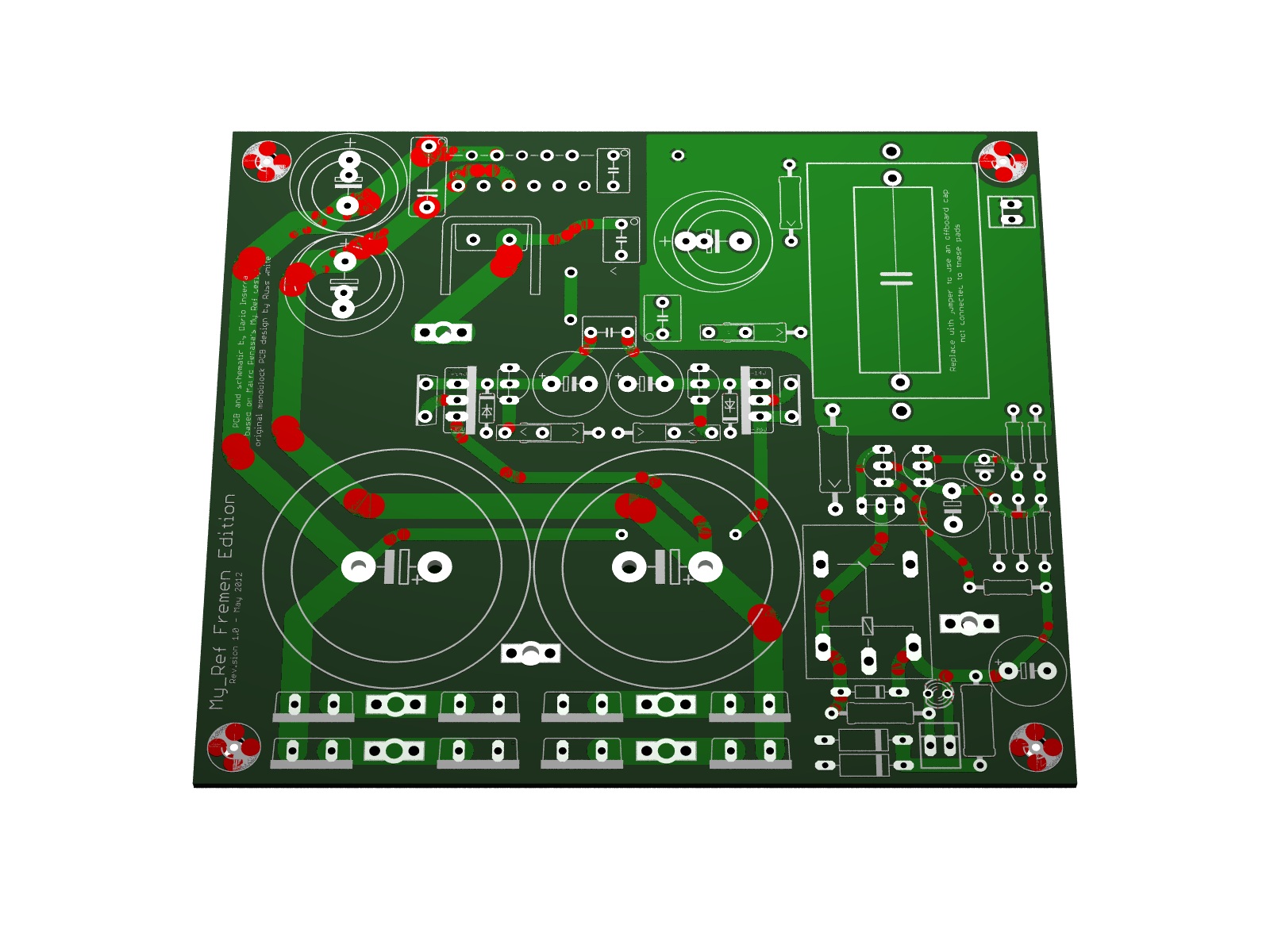

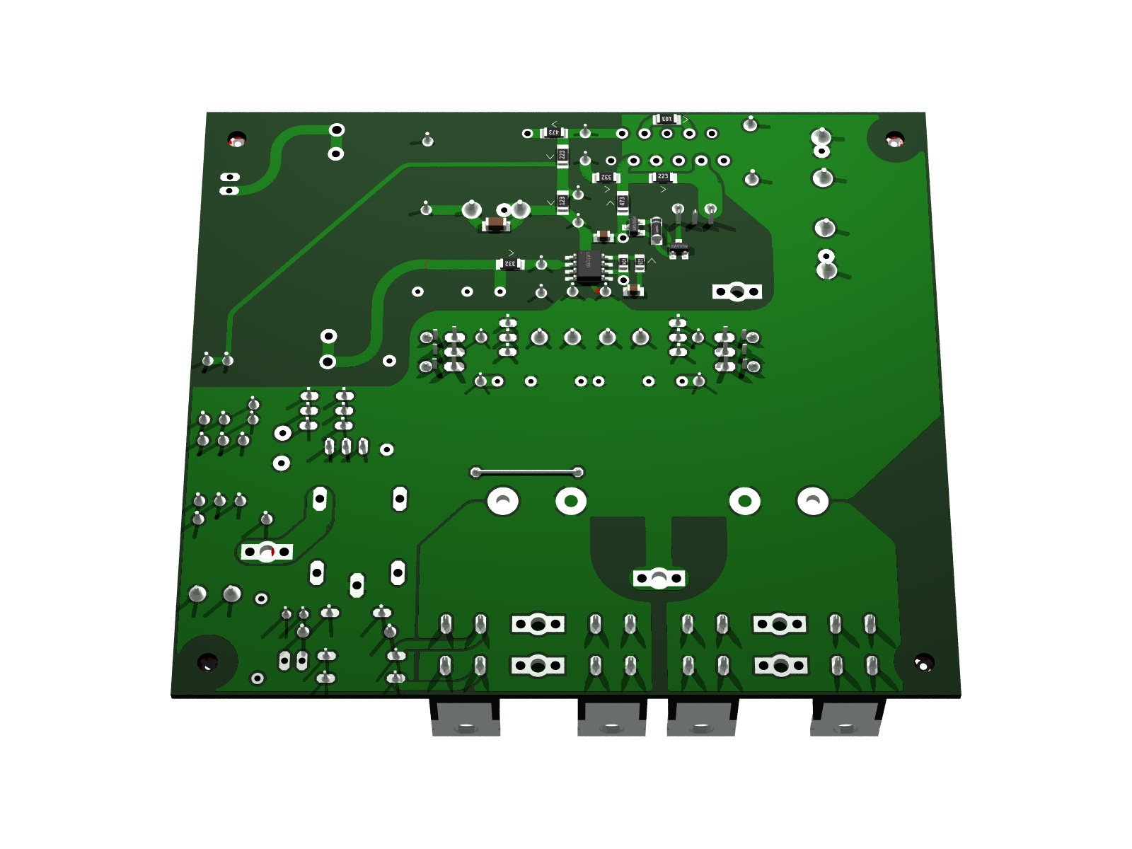

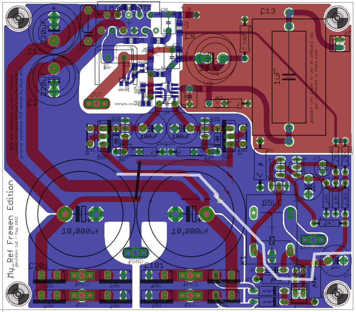

I've attached some renders and PCB layout.
During the forthcoming week there's still the possibility to made small adjustments to the PCB, post any desiderata/improvement so that I could evalute and implement it.

Lookin' Good
The renders look great. They help a relative noob like me better visualize what we are doing here. I only wish my solder job would look as good as the renders.
It doesn't mean much, but I'm happy with the direction you are heading.

Dario,
Well, the grounding scheme has room for improvement, as the star point scheme is not truly implemented.
The reference GND point is between the two 220uF's, all the smothing cap's GND returns should route to one side of that point while the load return should route to the other side and the small signal GND should return again a bit farther away. See the conceptual schematic from D.Self's power amplifier book.
In your current layout, the ripple current in the big 10mF's flows through a route that is shared with signal and load GND, the signal sensing point is the low end of the 1R, just on the opposite side of the PCB and the load GND is the GND contact of the relay. I've never been a friend of those 1R's "isolation" resistors anyway, especially in a dual mono approach they are never needed IME and only will cause trouble (any voltage drop accross them is an input signal).
I prefer to place the power chip in the center of the board and use a L-shaped aluminum profile to mount to the heatsink, this gives much more room for proper layout.
Also, some series resistors and smoothing caps before the LM317/337's would to fine to get more PSRR on the small signal supply. Further, a ballast resistor between the LM317/337 outputs could help increase current through them for better regulation (100mA++ is what they like best) while keeping the current in the shunt regs low. Does not work with dual LM317 approach though.
Finally, I'm not a big friend of individual bridges on the secondaries, I found center tapped to work better (less disturbed leakage current) and I often use a series resistor in the center tap as well (0R47 is OK).
BUT me thinks, all this would be such a major redesign effort for bascially non-system-critical issues (as the design is working in the real world without big trouble as far as I can see), both conceptually and in layout, so that'll be better done in a new, seperate project....
... maybe except for the GND thing.
I can't open your EAGLE files as I'm using an older version but I'll try some photoshopping to illustrate the point.

Wow Klaus!
this is the sort of feedback that was needed in the design phase but it lacked a bit...
In fact the circuit don't have a star ground, it rely on the ground plane.
Previous versions had an hybrid approach (star ground/ground planes) but some forumers suggested to rely on a single big groundplane.
That approach seem to works pretty good, though, it's even more quiet than a stock My_Ref.
I'll see your photoshop work with interest.
If you want PM me your email address and I'll send you 5.x Eagle files of a previous version (which is pretty similar), or you can download Beta version Eagle files here.

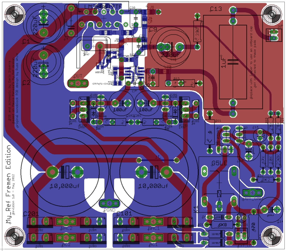

OK, here my suggestion :
attachment.php
Because of the dual bridges the ripple current in the big caps probably is not that much of an issue (decoupled returns there already), but I found a little bugger that has its ripple current going right through the signal/load return path, C14.
If rewired for center tapped transformer the issue would be bigger, that's why I extended the slot a bit to the left to keep the cross currents away.
BTW, what's the reason for the PWR_GND tab? I would think it is not needed for anything other than center-tapped. But, then the relay supply would need a little change, too....
Regarding large GND planes, those can be dangerous because they can pickup magnetic fields which will cause rotating eddy current that in turn will create small voltage drops. A test is to use a tape head demagnetizer (or a loaded EI core transformer) and check if hum levels increase. With 70u or 105u copper one can lower that with brute force, though, still broken/slotted planes are the more clever approach (but can easily go wrong if one has overlooked a current path).
