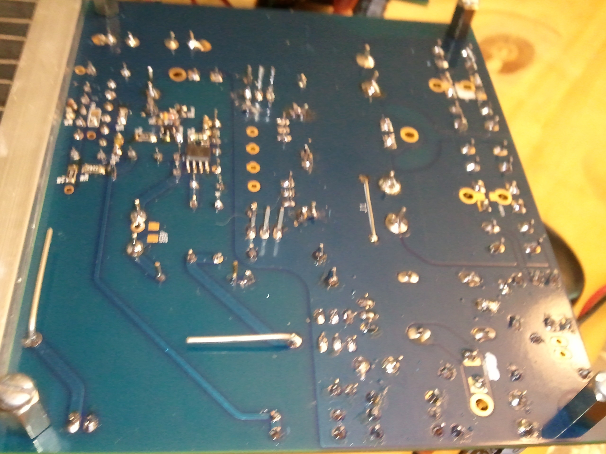

Here are pics of the solder side of the two FE boards.
With my Greenlee DM55 DMM set on V~200 one Antek measures 25.8 and the other 25.9 With the bulb tester inserted after the fuse 0V , turning the switch on the tester, still 0V. Oh well, I built it out of junk so that's what I ended up with.
Reason I wanted to re-flow is I soldered in three sessions. First, the SMD and 318. The joints were smooth and shiney. Next day, the resistors and small caps, same results. Daze later, the Harwin spades, C3, C8, C9, C13 and R3. I think I was at too low a temperature during this. Especially the Caddock, the legs seem to be of a different material and I had to stay extra long to get the solder from the leg to the pad. The Black Gate at C9 seemed to have a cold joint too. The panny HA joints were rough textured. I re-flowed one channel and powered up again.

Glad you're making progress! So you are getting the relay click and the LED light on that amp?

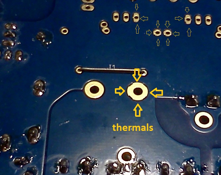

Heating some parts was difficult till I realized larger pins that connect to large ground surfaces suck up a lot of heat. I have often intended to ask if there was even something inherent in the construction of the large caps that influences heat absorption. One leg solders rapidly while the other on the same cap takes much longer. I've adjusted accordingly. Thanks for the photos but can you post some of the top side also?
Reason I wanted to re-flow is I soldered in three sessions. (...) I heard music ! Not pretty music, but it does function.
OK Joseph, you're right, from pics some solder joints really need to be reflowed (big smoothing caps, C9 for sure)
Reflow all suspect joints and for this turn avoid semiconductors (opamps, transistors).
All pads connected to the ground plane needs to be solder with a pretty high temperature.
First warm some seconds the pad, then touch also the lead and apply solder.
Let us know how is doing.
It's normal, one pad is alone, the other is connected to PGND's ground plane via too large thermals (in RC boards I've reduced thermals traces widht so it should be less an issue).
I've reported that problem in one of the first posts... 😉
The ground plane connections are more difficult to solder, thermals width too large (it will be fixed in the final boards). Use a higher soldering temperature on those.
Joseph, reflow also the solder pad of LM3886 ground.

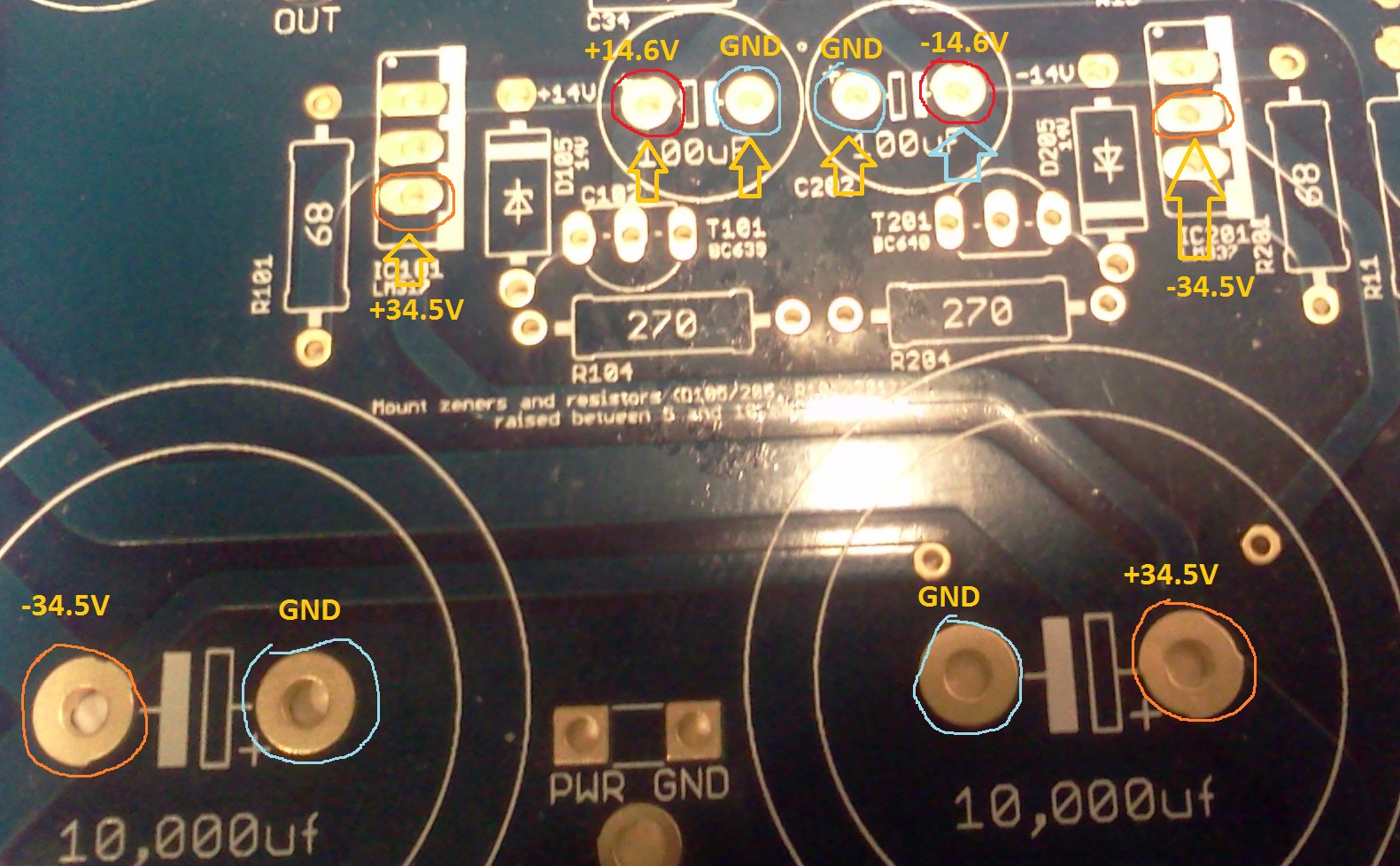

Fine so you have one working channel (sort of) and one that just clicks (it's the relay, isn't it?)
So on both you don't have DC at output, good.
Probably the LM318 is gone but before saying so it's better to measure rails and regulator output (and 1R resistor too).
See attachment for reference.

Just something general like this I believe. Iv'e used them on the Mini DAC.
Gets a little tricky, but you can also check for continuity through the board on all the leads you can reach by placing the board virticle in a small vice or use masking tape.
I have found a solder bridge under some small caps from excess solder that flowed up the leads and caused a short that was hidden. Also check for solder bridges around the SDM parts.
