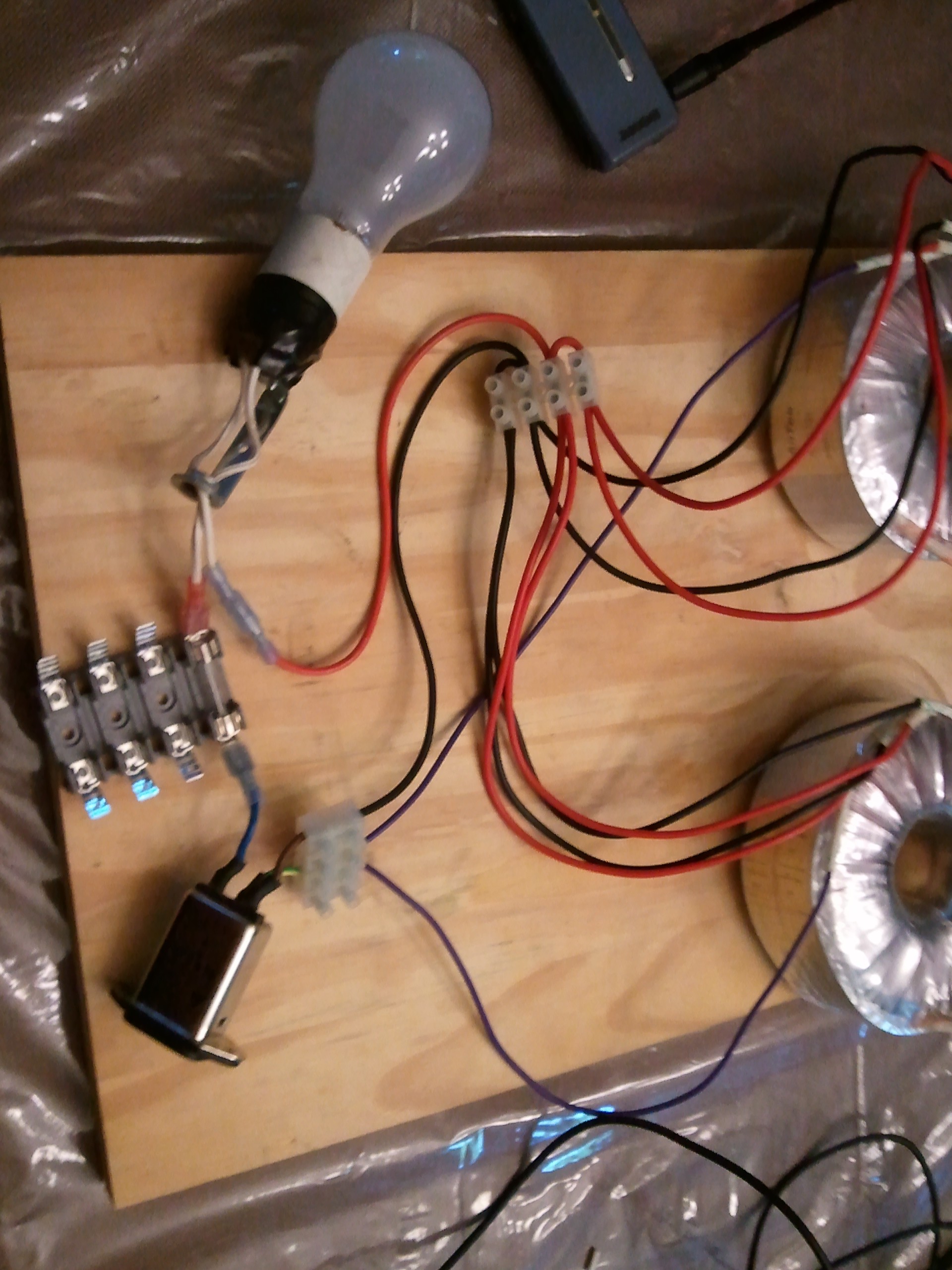

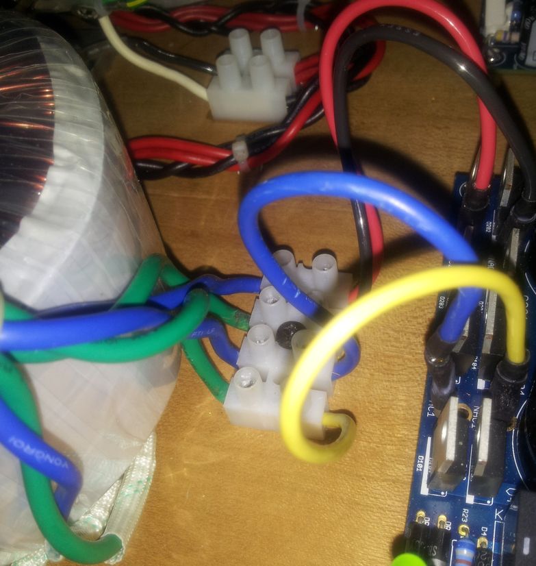

Hey Bob, Dario, I need some advice. I'm hooking up a pair of Antek AS2224 to the FE. http://www.antekinc.com/pdf/AS-2224.pdf
I have placed connectors on the Blue and Green secondary wires. The PDF does not indicate which is + and - but the tag on the side of the trafo has a dot by the Blue. Should I assume the Blue is + ?
On the AC side is two Red and two Black. Can I assume Red is hot and black is neutral ? Should I hook only one pair to mains (the other Red,Black unused) ? Should the Purple (shield) wire go to Earth (Chassis ground) ?
Blue = AC1 Green = Nac1

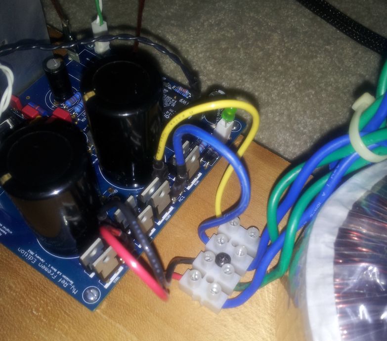

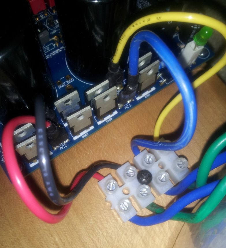

There's no + and -, we're talking about AC. 😉
The dotted wire is Hot/Phase, the other Neutral.
So Blue is AC and green NAC.
Pay attention to keep together the blue/green couples (one couple to AC1/NAC1, the other to AC2/NAC2).
If you need to identify couples you can use continuity check function of a multimeter, members of the same couple will have continuity.

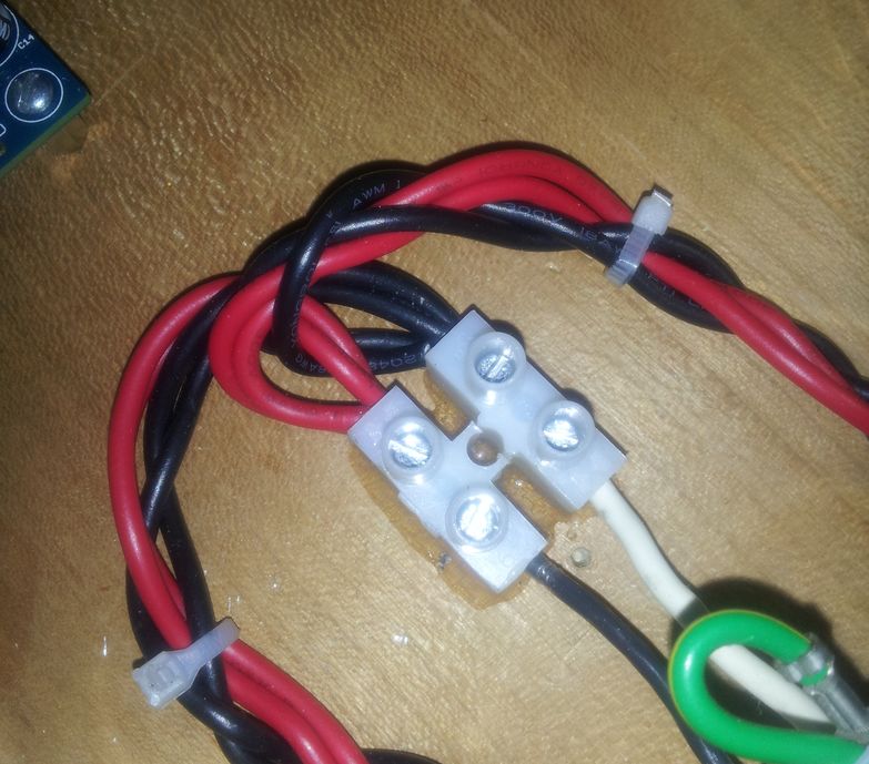

Yes but you should wire then in parallel (for 110V operation like in USA): red with red and black with black
Yes

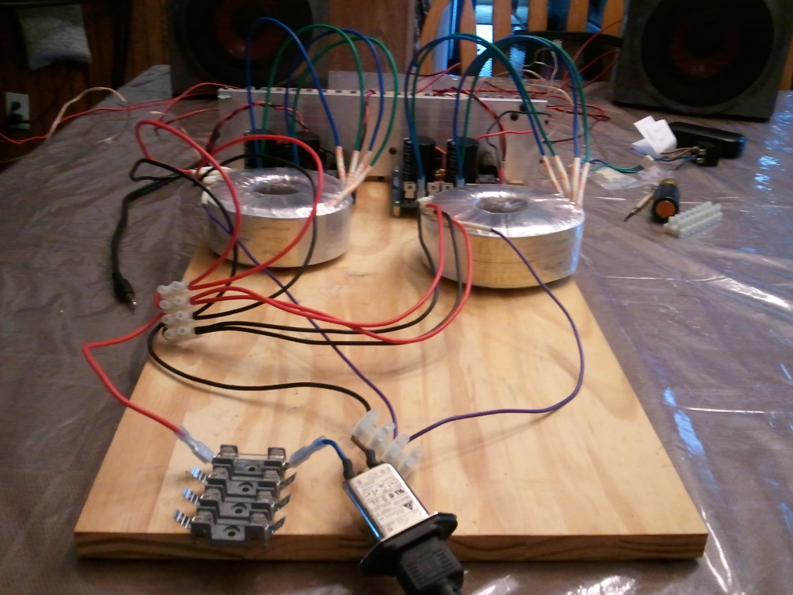

I didn't change the short leads from the ApexJr toroids yet - need more fastons - but this is how I did my dual Anteks. You should be able to follow the paths. In my service box black is hot and white is common/return - 2nd pic from left.

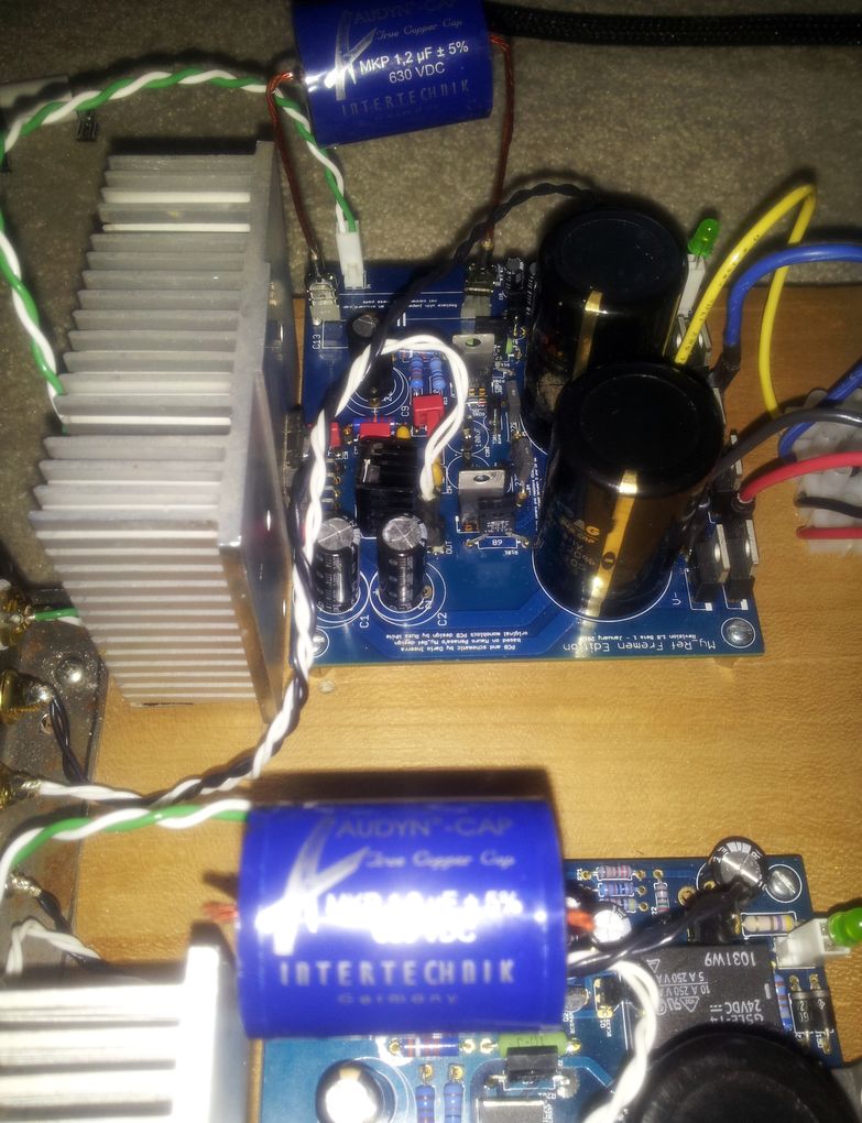

Well Mr. SolIl4x4, here I go again. 😀 The Audyn True Copper caps in C13 are simply stunning. The improvements in the width and 3D sensation of the stage brought a big wide smile to my face. These are the most expensive parts on the board, but at first audition, are a significant boost for those who have been bitten by the Audiophile bug. There seem to be many more qualities to report, but I'm running a couple passes of the IsoTek process before I dig in.
To Tom E. for digging hard for top choice components - :worship:
.....more to come !
Squalor, Your fuse should be on the hot side - is that what you have. I don't see a dim bulb tester. I don't power any new build without one. It is worth a trip to the local hardware.
Here is a simple one. Just put a socket in series on the hot leg. The switch on the socket isn't necessary - just what I had on hand.

Isn't phase reversed on that line filter?
Usually brown is hot and blue neutral.
BTW whatever phase is it should work, power on with speakers not connected.
If both relay clicks than measure DC offset, it should be less than 20mV (mines are 14mV).
Then power off, connect your speakers and, hopefully, enjoy music. 😉
Or you can use a light bulb tester (ask Andrew or Bob, I never used one) to be absolutely safe.

Maybe this pic is better. Sorry to be sweating this so much but I killed my Kookaburra by hooking up a transformer wrong.
The blue wire of my IEC corresponds to the (left) longer prong, the brown lines up with the shorter prong (right).
I now have a bulb tester inserted after the fuse, a 3 amp Slo-blo.
Please jog my memory, what is the bulb supose to do ?
My test speakers are junky; I don't care if I lose them but yes. I will test DC offset. DMM set on 200mV to read correctly ?
Hit the switch ?
