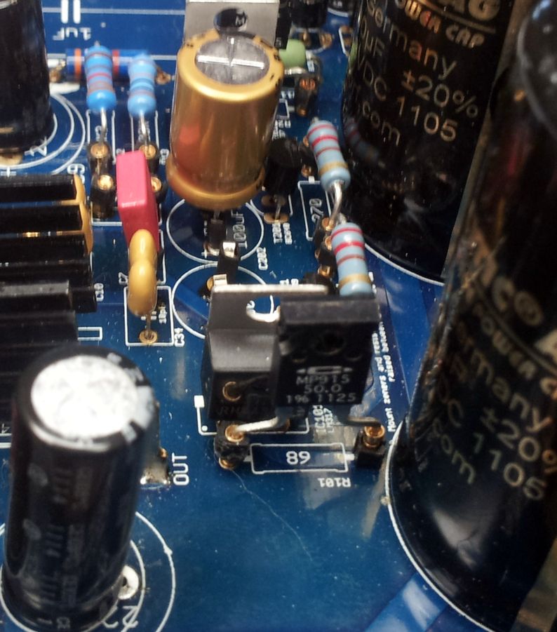

With much fear and trepidation,I fired up the FEs with nothing in C102/202. It sounded surprisingly good (though not as refined) with more impact, cleaner definition and an apparent wider stage. Voices sound more forward and might need a lower volume setting to avoid overstatement.
It's late, I'm finished for the day and will listen more tomorrow -but- What's going on here Mr. Inserra ??? Maybe I should pull out a bunch more stuff for even better performance.

Yes, I like very much how it sounds without caps.
Those caps are not needed by the regulator for stability but they reduce a bit the remaining ripple.
Usually those decoupling caps are used on chips to give a low impedance supply, improving stability and performance.
Also those caps impart their sound signature to the opamp.
In this particular case the regulator already have a low impedance output and PCB traces to the opamp are very very short so they could be omitted.
Stability should be checked to be sure they're not needed but I don't have an oscilloscope to test it.
BTW it don't give any sign of instability.
The resulting sound is free of the sound signature of those caps.
I've been inspired by LCAudio's ZapFilter where a similar approach is used.
Maybe I should pull out a bunch more stuff for even better performance.![]()
Absolutely not!
It's a very specific case.
could i try the same for myrefc boards or was the network changed for the fe?
It depends on how you routed connections but I wouldn't.
The FE boards have constant impedance traces that may have a role in stability

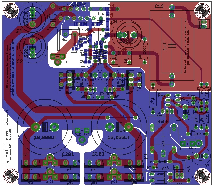

Finally received the True Copper caps (C13) yesterday just as I finished adding sockets in all the appropriate spots: C7, C10, C12, C13, C30, CC32 - R7, R12, R13, R101/201, R104/204. My intent is to test each location one at a time, note the change and report back if and when we (me and the amps) survive.

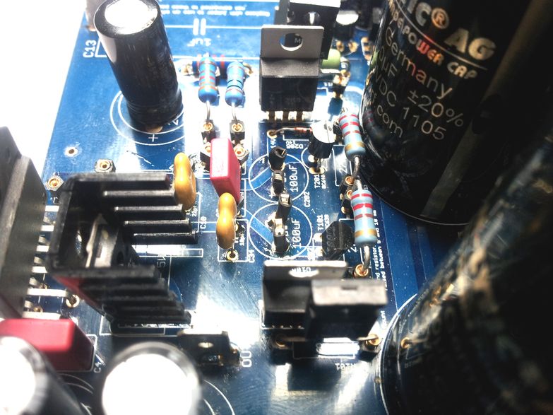

Also, I was still eight sockets short so I took Andrew's idea one step further and added a retaining sleve with some heat shrink tube. Still somewhat delicate but they work just fine.

Finally received the True Copper caps (C13) yesterday just as I finished adding sockets in all the appropriate spots (...) My intent is to test each location one at a time, note the change and report back if and when we (me and the amps) survive.![]()
Don't worry.
The only delicate positions are R104/R204 (you should wait a couple of minutes after power-off to let caps discharge), for all others as long as you swap components with the amp powered off
I have all the 100uF power decoupling caps removed from MyRef board.
So I suppose you verified that the LM318 was stable in TP boards... but you're using a SMPS.

You can also reuse sockets that you're using for the two MP915, you can solder them, they're the absolute best there.

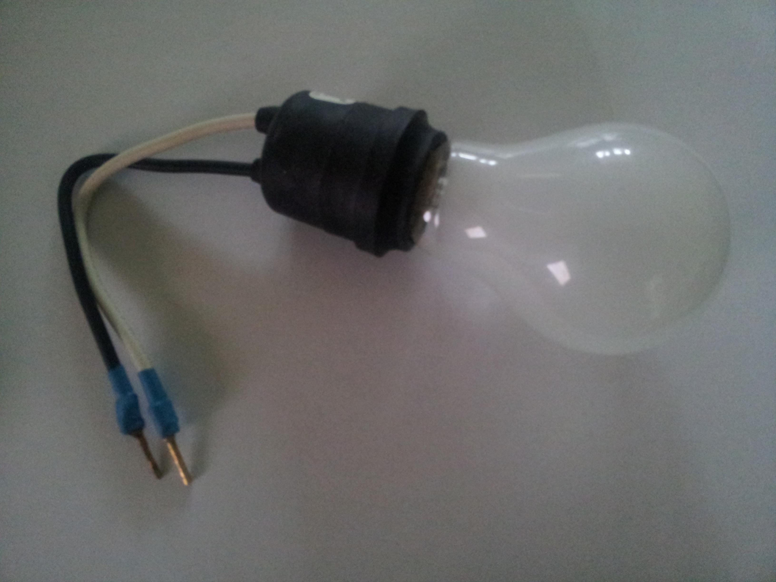

I've still got my safety rig, but thanks again for the warning.
You don't need it for those components swap...

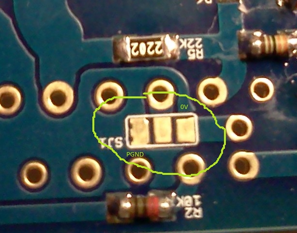

Packages shipped.
You'll find, apart PCBs, Elnas, zeners and partial kits (for whom asked them) also some thin solder (Sn/Pb/Ag) for SMD soldering.
I've highlighted with white paint the manifacturer 'fixes' on PCBs, take maximum care on that sections, consider them as without the solder mask and after soldering check with a multimeter for shorts.
The ground plane connections are more difficult to solder, thermals width too large (it will be fixed in the final boards). Use a higher soldering temperature on those.
Don't forget to short LM3886's ground to PGND or 0V using a solder bubble on the solder jumper (see attachment).
Please let me know when packages arrive.
which side is PGND ? Which one are you using McBob ? ( or should I say BayCity, next he will call me JoeBama)
