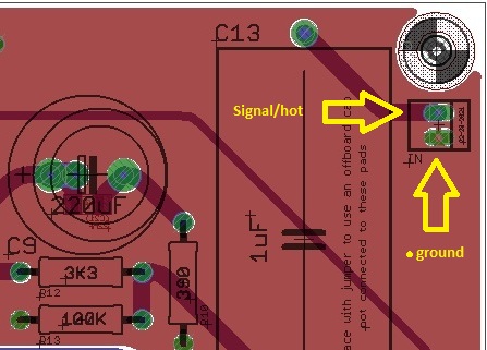

I powered the amp without the tester, speakers hooked up. There is a light turn-on thump from the speakers but no sound. My source is a Walkman with a 1/8 stereo plug to two RCAs. The hot of the RCAs runs to the right of the fast-on (closest to the HS).

There is a light turn-on thump from the speakers but no sound.(...) The hot of the RCAs runs to the right of the fast-on (closest to the HS).
I can't understand (my fault) if you wired correctly the input.
See the attached picture for reference.
A reversed connection can do strange things.
